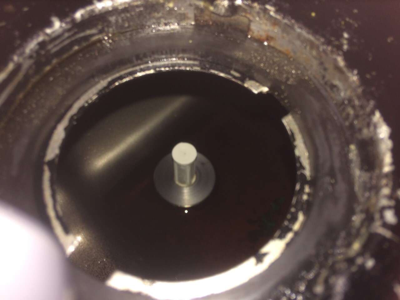

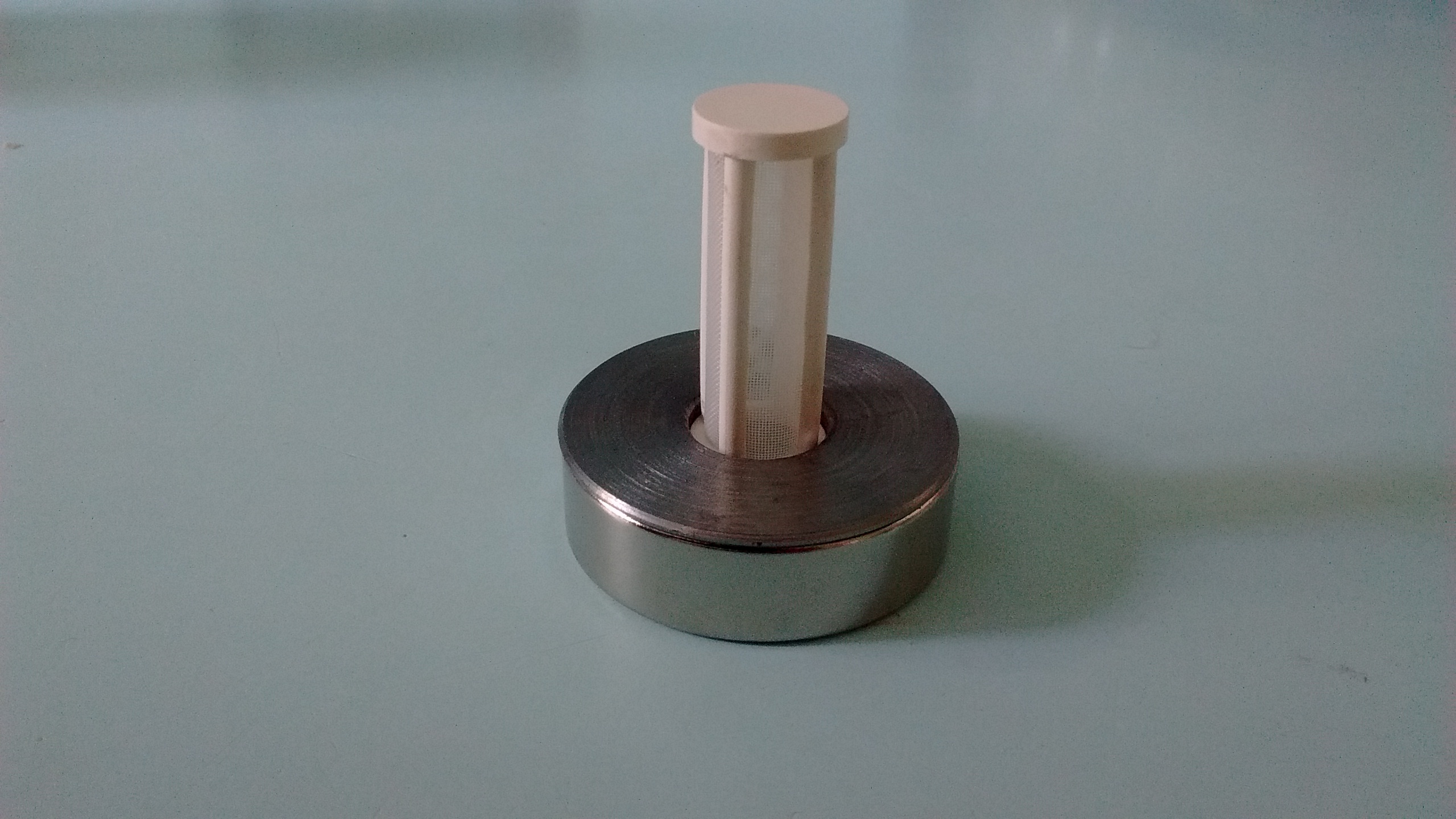

      Could always fit one of my in tank fuel filters before refitting , plug plug!
      Click image for larger version  Name:	Filter in place.jpg Views:	0 Size:	130.8 KB ID:	11702Click image for larger version  Name:	IMG_20181013_131240141.jpg Views:	0 Size:	836.4 KB ID:	11703
