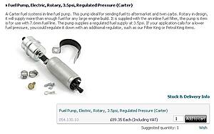

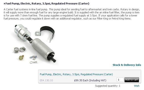

    My own presonal prefernece is a Carter inline rotary pump, proven by thousands of miles for me on VW based cars (real pre-80s VW's not new junk) .
    Nice, quiet and just works.

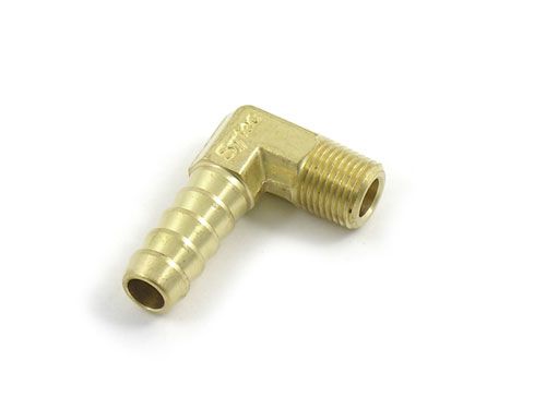

    First to fit it I use a 1/8 NPT to 8mm right angled connection to exit the tank, this removes the 1/8 7/16 transition fitting to make space.
    Thread s need sealed properly using thread selaer
    Second the fuel pump, the pump body is isolated so will do + or - earth.
    https://www.machine7.com/product.php?xProd=12704
    It is about £90

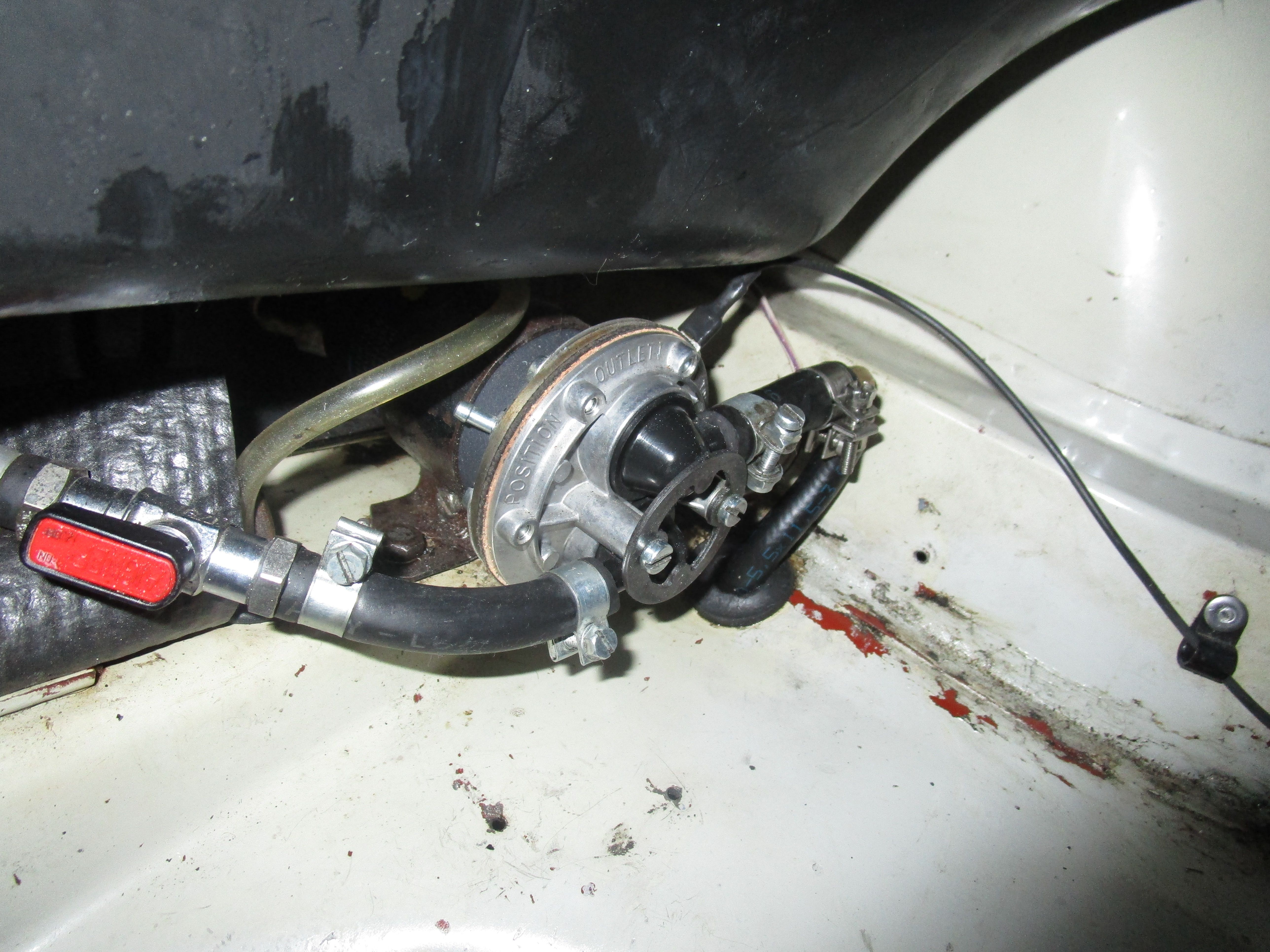

    My preference is SU pumps . you can fit these either in the engine bay or by the tank . Engine end ones are known as LP ( low pressure ) , tank end are HP ( High pressure )
    I use and engine end in one car and a tank end in tother .
    Tank end are hardest to fit but neater , engine end easy to fit but dont look as neat . As above you need to wire in a inertia cut off and a manual switch .
    I use AUA66 for the engine end and AUF214 for the tank end , neither require a regulator , you can get the old points based ones or electronic ones ( state positive or negative earth as these are polarity specific - points based ones dont care and will run on either

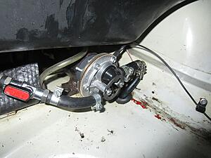

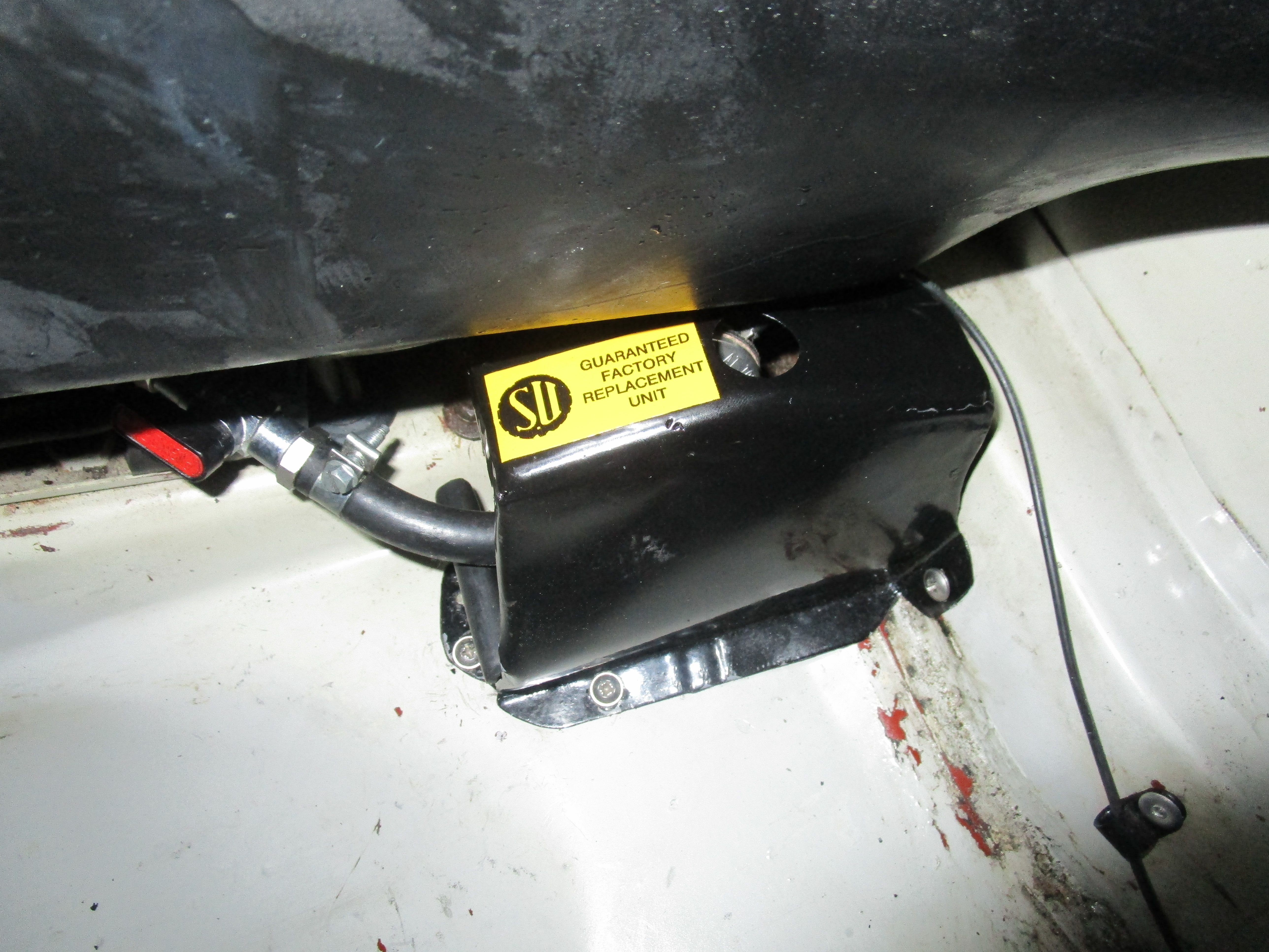

    Tank end
    I fitted a cover over this to stop junk in the boot whacking it one

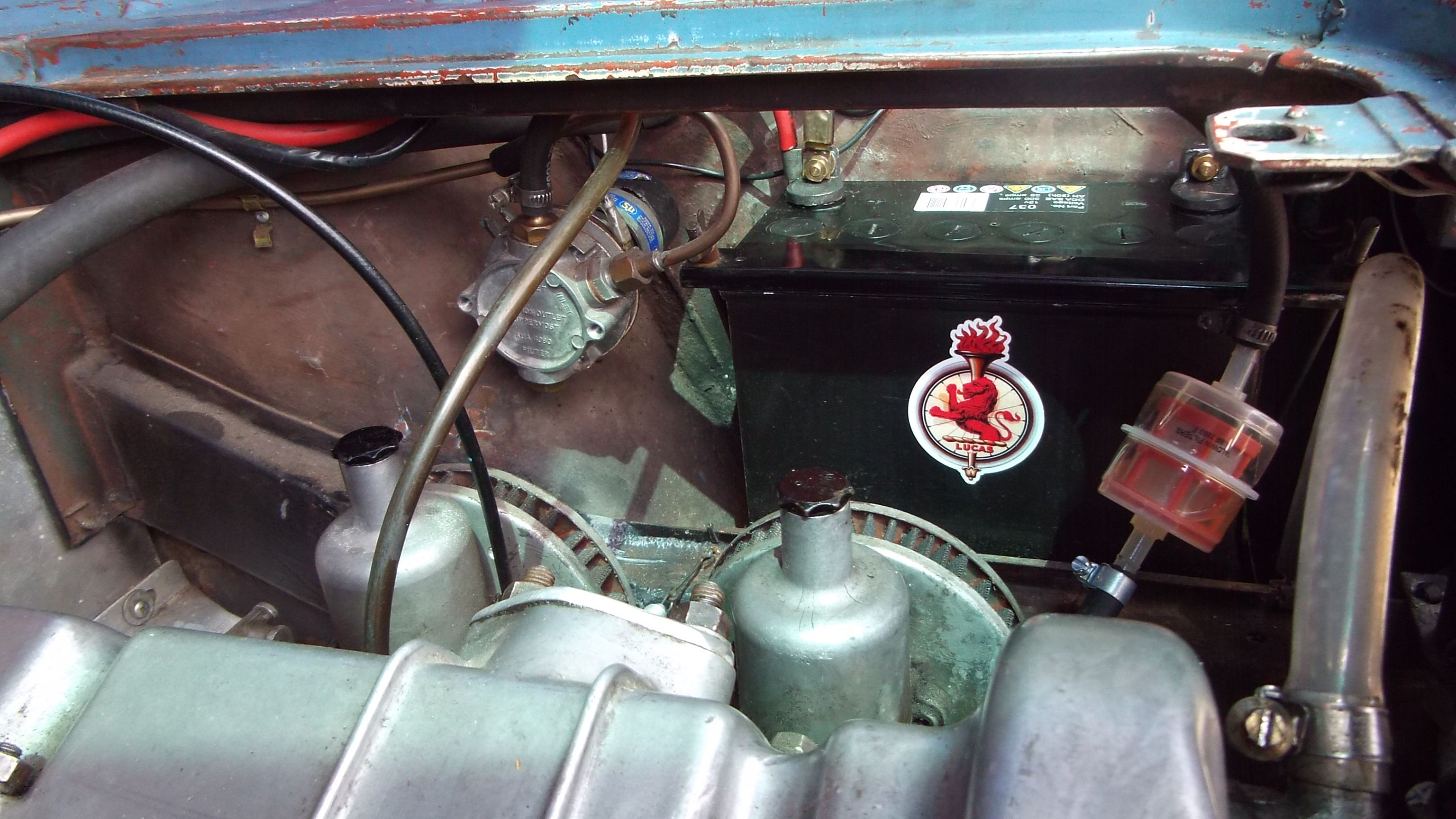

    Engine end
