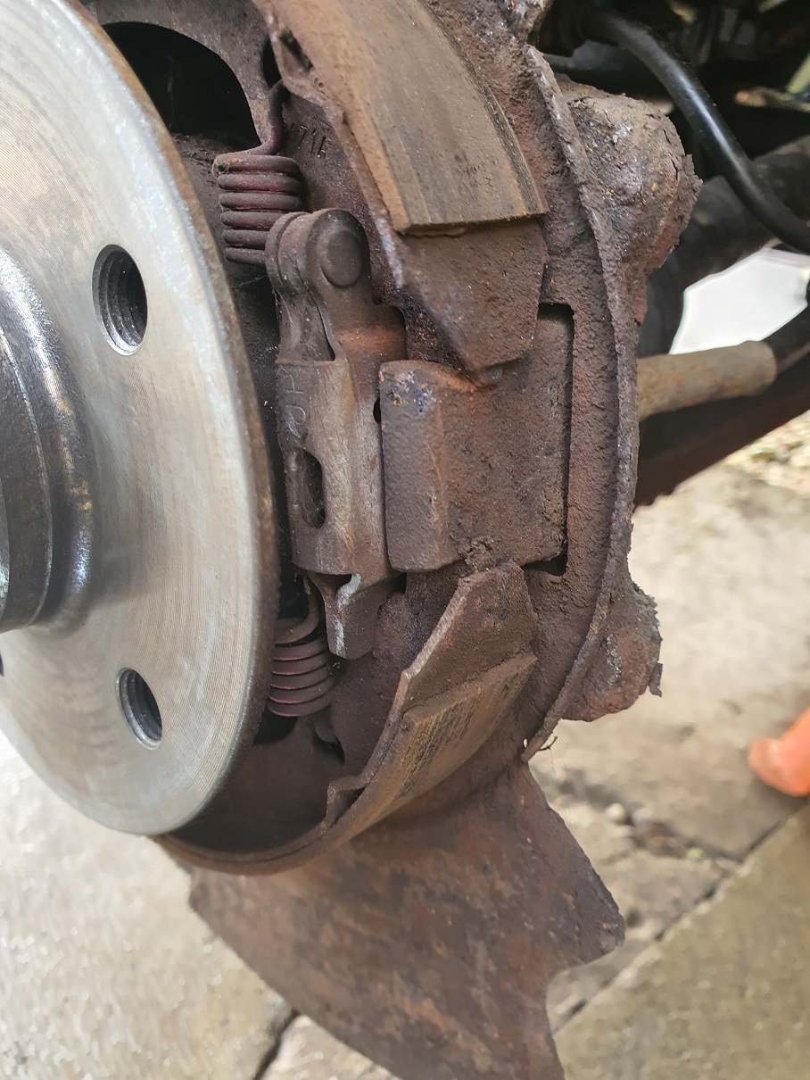

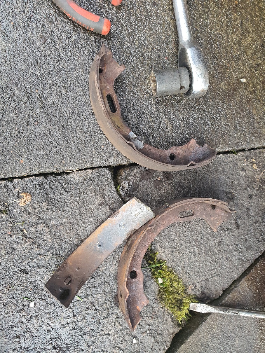

    When folks complain abouut imp handrakes spare a thought.
    This is typical state of Mercedes handbrake rear shoes (sit on inner of disc) and they seem to fail even at low miles due to the intermittent use by owners who prefer the transmission park position.
    Afraid to say I am guilty as charged m'lord....
    This is pretty benign, the ones on my E250 were worse and those had only done 30k since new, again I never really used the handbrake so can only guess the linings hate that and fall off, the bonding agent must be complete crap.

    Oh dear !!!!!
    Never really thought about NOT putting handbrake on ,even though both our cars are automatic
      Yes both Mercs here are automatics and I just put it to park and leave it. They really dont like it apprantly. Its only one foot presse to puut brake on and pull on switch on dash to release but I dont see the point when they are laid up.
      The E250 not moved since last Nov.
      Will see what deal is tomorow with bits to see if it gets parking brake shoes or parking brake shoes, new discs and pads but I hate spending money on Mabel
        I've been telling John for yonks to use the parking brake. ;)
        Those shoes look pants though, I'm guessing cheap tat similar to the pads I removed from another car a bit back.

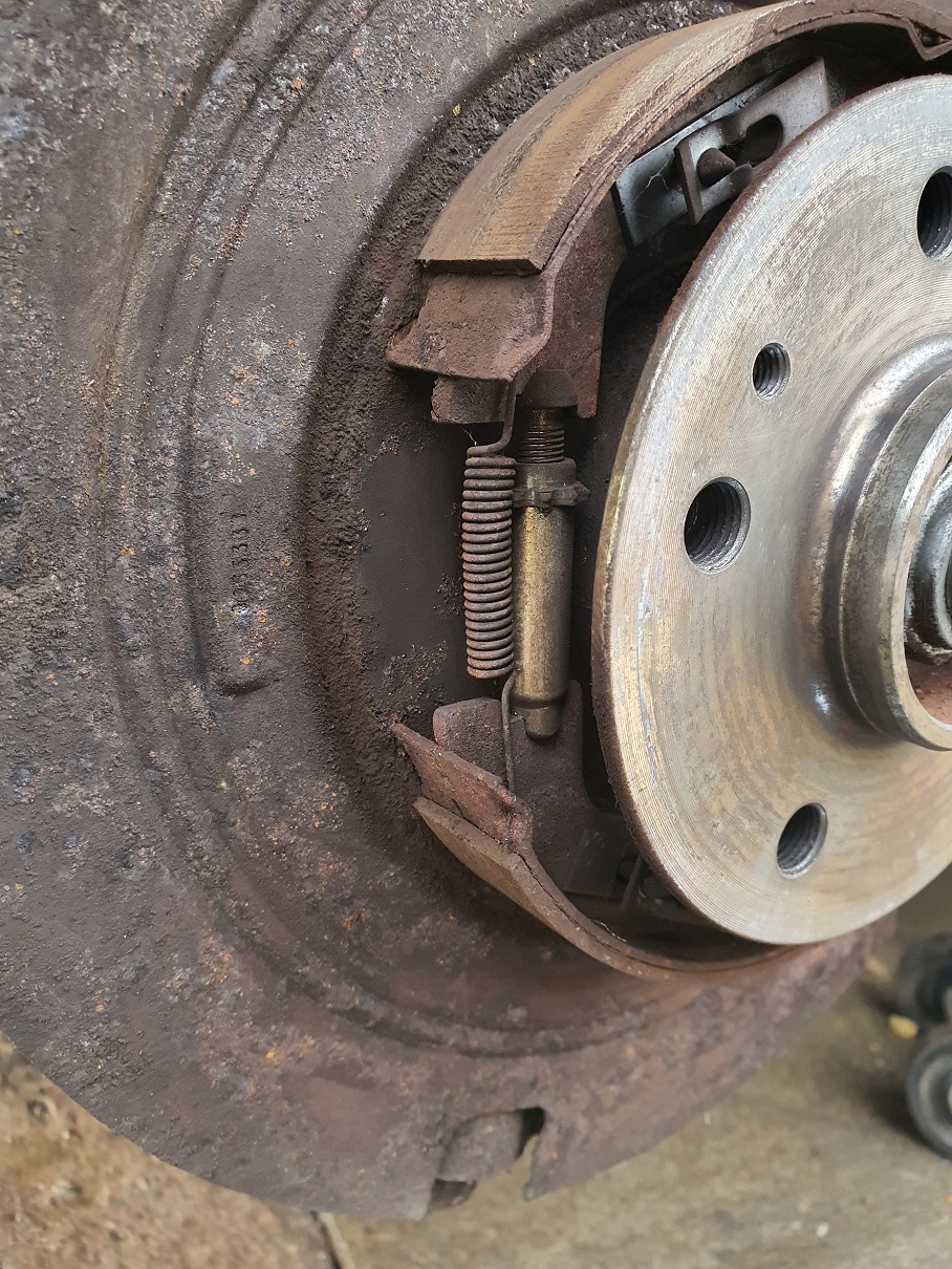

        Click image for larger version  Name:	20201205_192412.jpg Views:	0 Size:	286.1 KB ID:	11879
          Miles left in those Pat, wot you on about
            There is loads left, they have just fell apart though. :)
