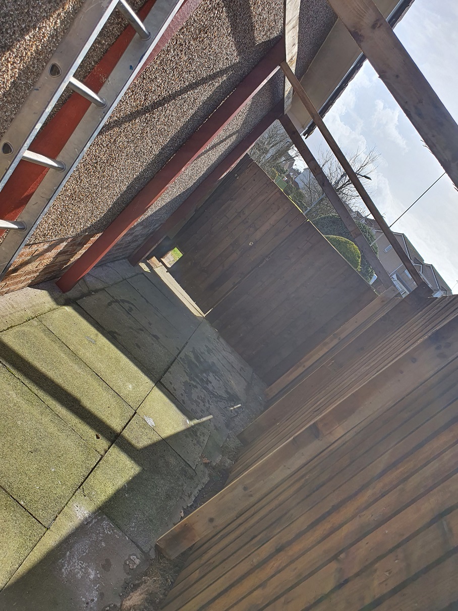

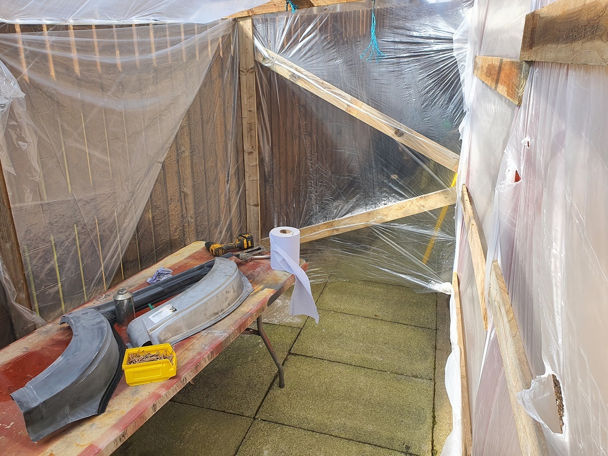

    No place to do it at home so improvising.
    Lean some old fence posts and polythene at side of house,
    Paint panels while being heated by the sun which that bit gets all day. Cant say no to free heat
    At least I am outside nbreathing some fresh air ! but completely knackered
    And the poly tunnel is done

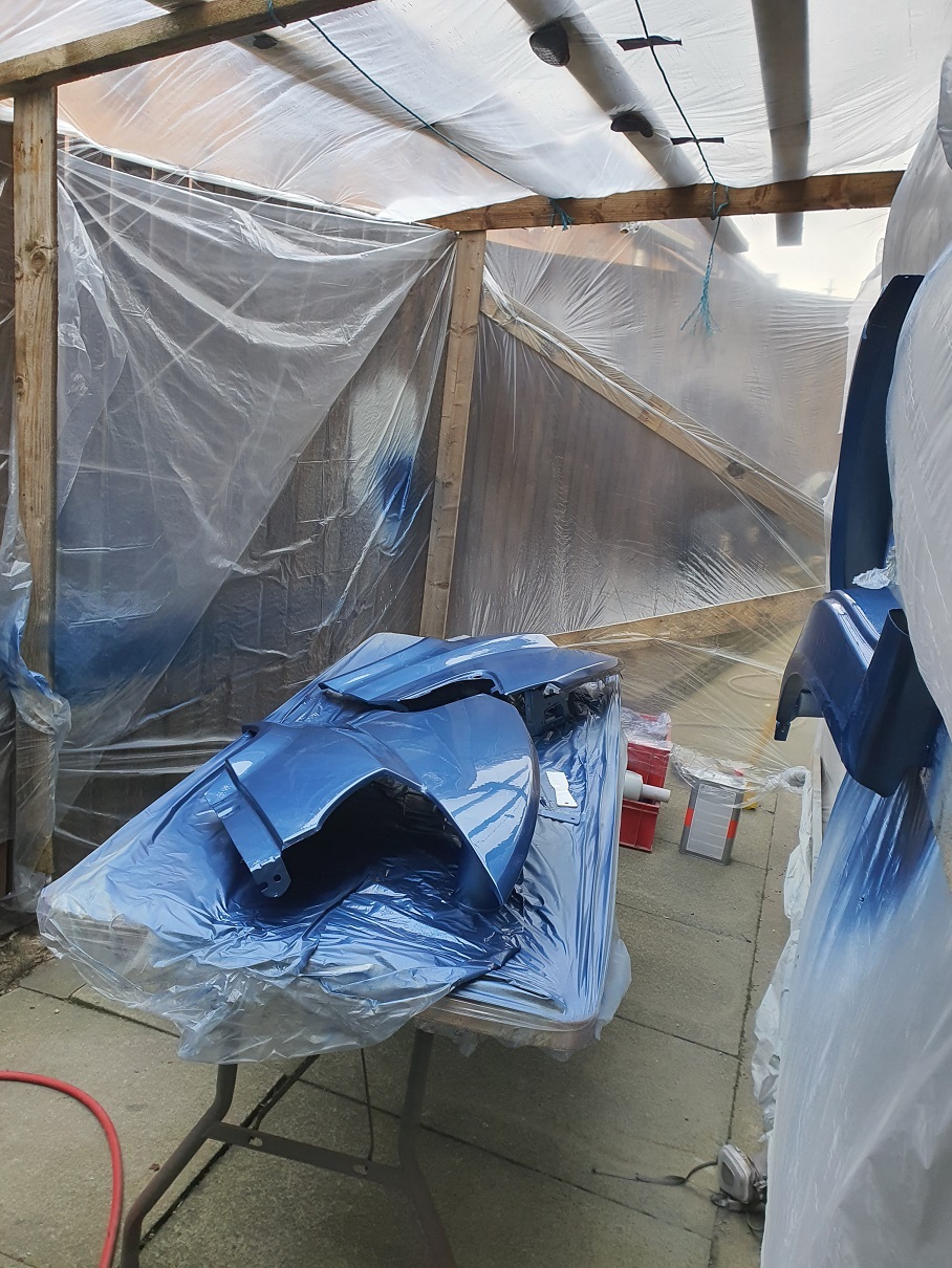

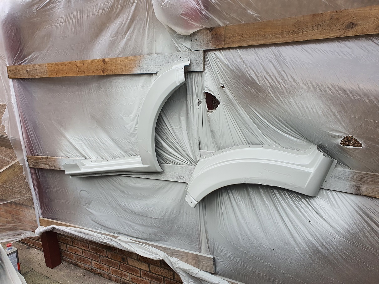

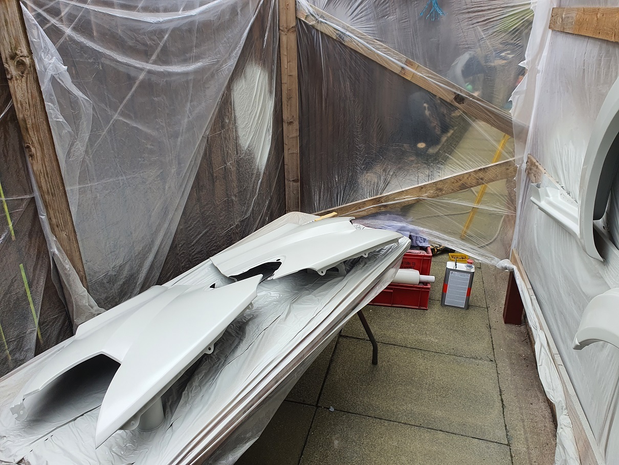

      Panels prepped and primed

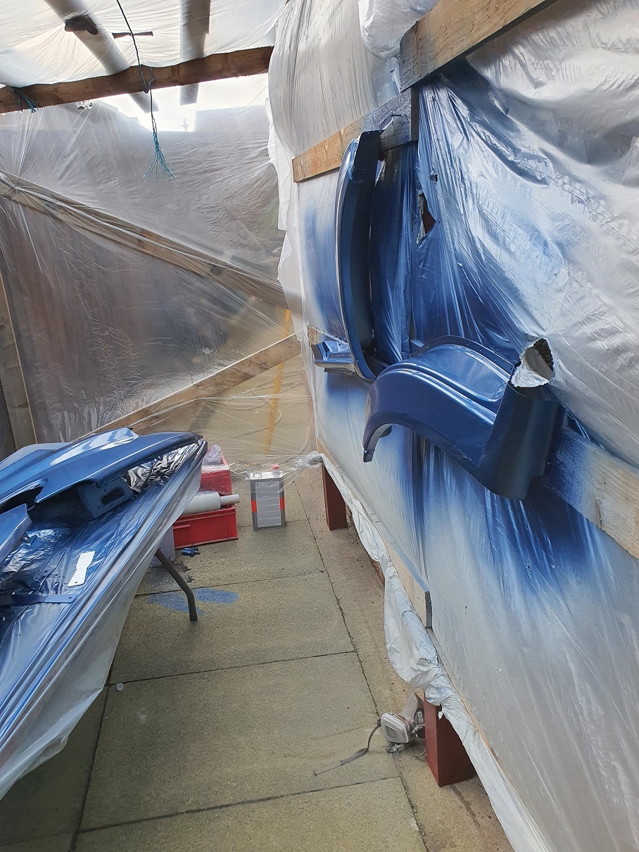

        And all looking good until you tuirn around, the feed to my air fed mask comes loose and wipes itself over the wheel arches
        I was going to do wet on wet so they would be primed, coloured and clear coat today as I doubt the tunnel will last any rain or wind, but oh no.
        Now I have to fix my screw up

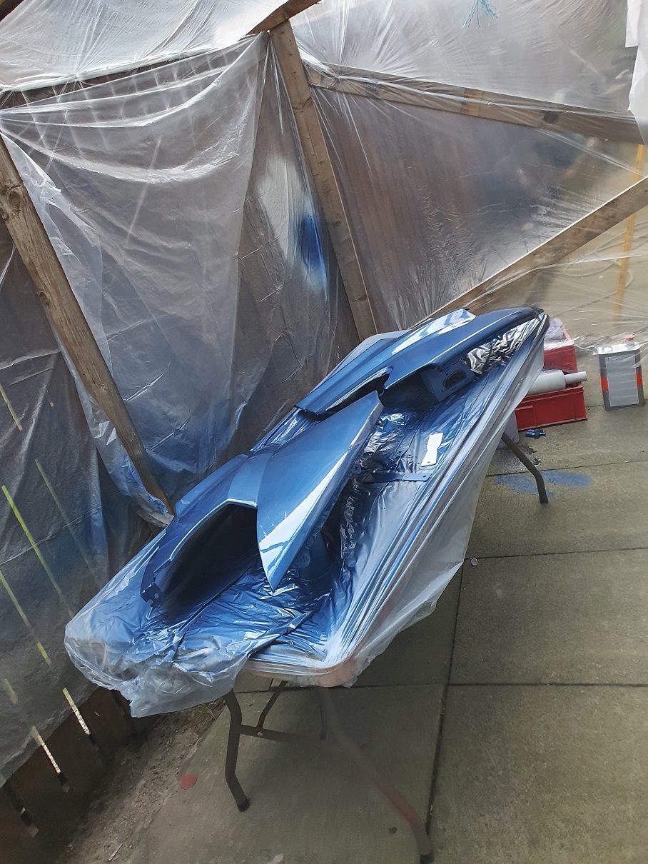

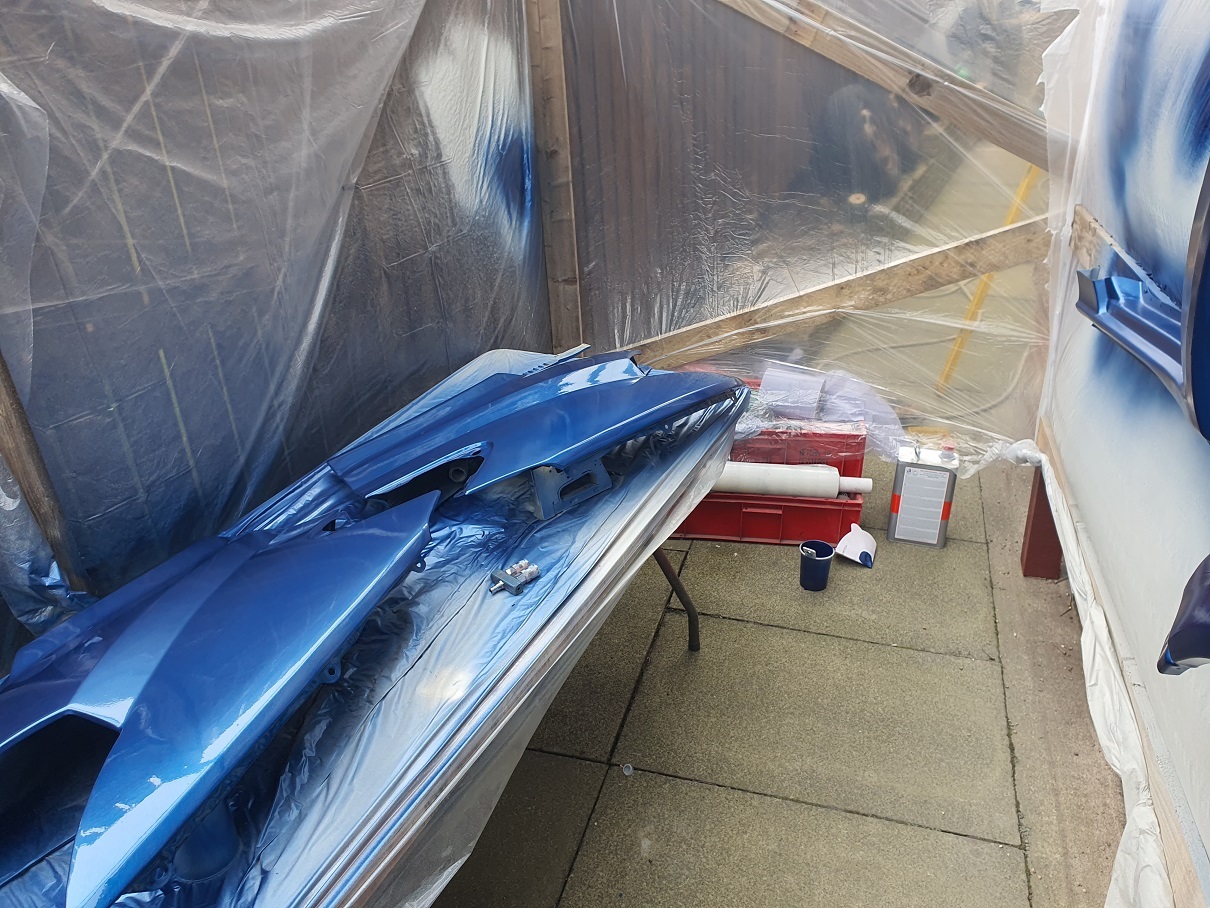

          Well decided I will sort the bits out with a rattle can later
          So base coat and clear now on, bit of a run on one wing in the swage line as I must have got a bot close with the clear coat other than that few bits of dirt but its all blue now

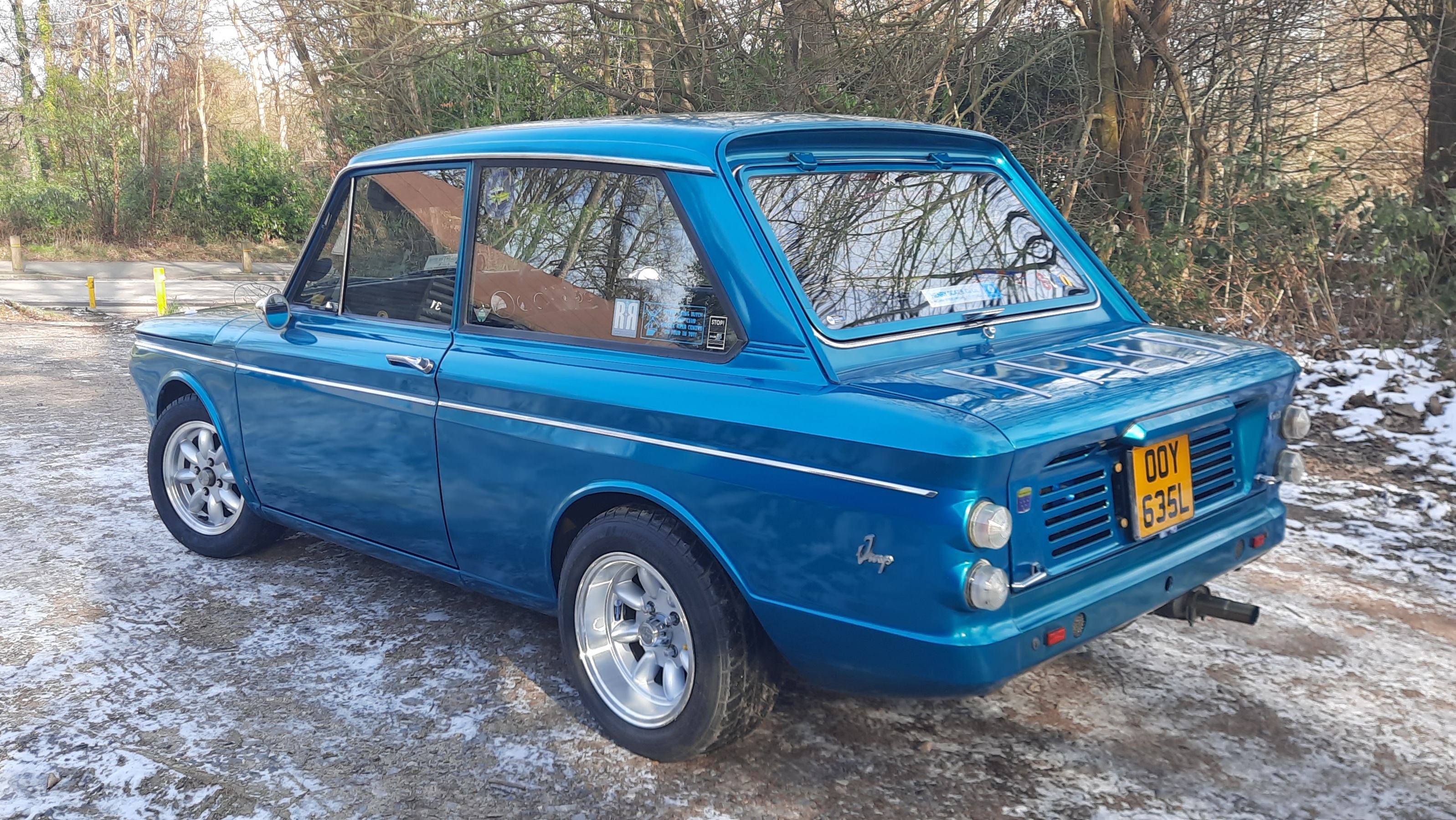

            Uncle Henry must be close to colour of stan ? you had him out lately ?
            • Uncle Henry
              • 116
              Hi John. Stan is Aquarius Metallic. Had him out today for a brief sprint the long way round to Sainsburys. And the long way round back again takes in a few miles 9f motorway. Last time previous to today was 13th of February in the snow. Cheers Andy Click image for larger version

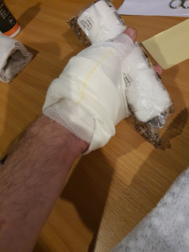

                          work suspended for the forseeable to utter stupidity in trying to do to much too soon. never get dizzy with power tools in hand
                          onehanded computer work for next 3 months by looks of it.

                              Utter stupidity. Thought i wa being responsible and get all my bloods for the liver and db clinic all at same time to cut down trips. it was a fair bit of blood but nowhere near the 500ml they normally drain every two week on some ocassions.
                              Felt ok, went to cut bits off seat runner on imp, bent over, dizzy, slit disc jammed and shattered and took out the gloves and my hand.
                              Had surgery yesterday to see what can be recovered, surgeon was optimistic as long as no infection set in. wont know for few months.
                              Wil be 8 weeks min now before can assess. Cant use hand until then, well its in a cast splint now so cant anyway and thats me not able to drive anyway according to dvla.
