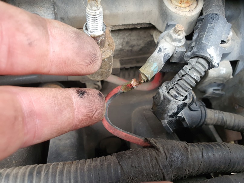

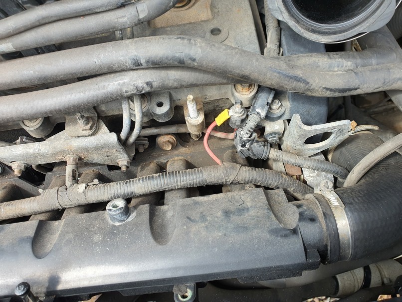

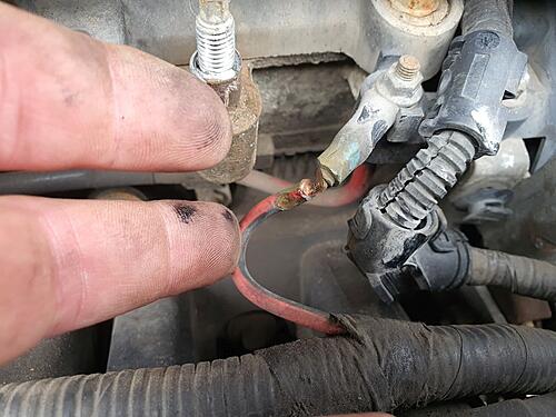

    What lies beneath, wondered why the cold start was sometimes iffy, never let us down but here was teh supply for the heater plugs reduces from 30 strand to 3 by looks of it, surprised it never melted, clean worn through as the air box must have been rattling on it for ages with no bushes.
    Click image for larger version  Name:	20210713_131507.jpg Views:	37 Size:	124.2 KB ID:	15872
    Click image for larger version  Name:	IMG-20210713-WA0001.jpeg Views:	6 Size:	1.39 MB ID:	15873

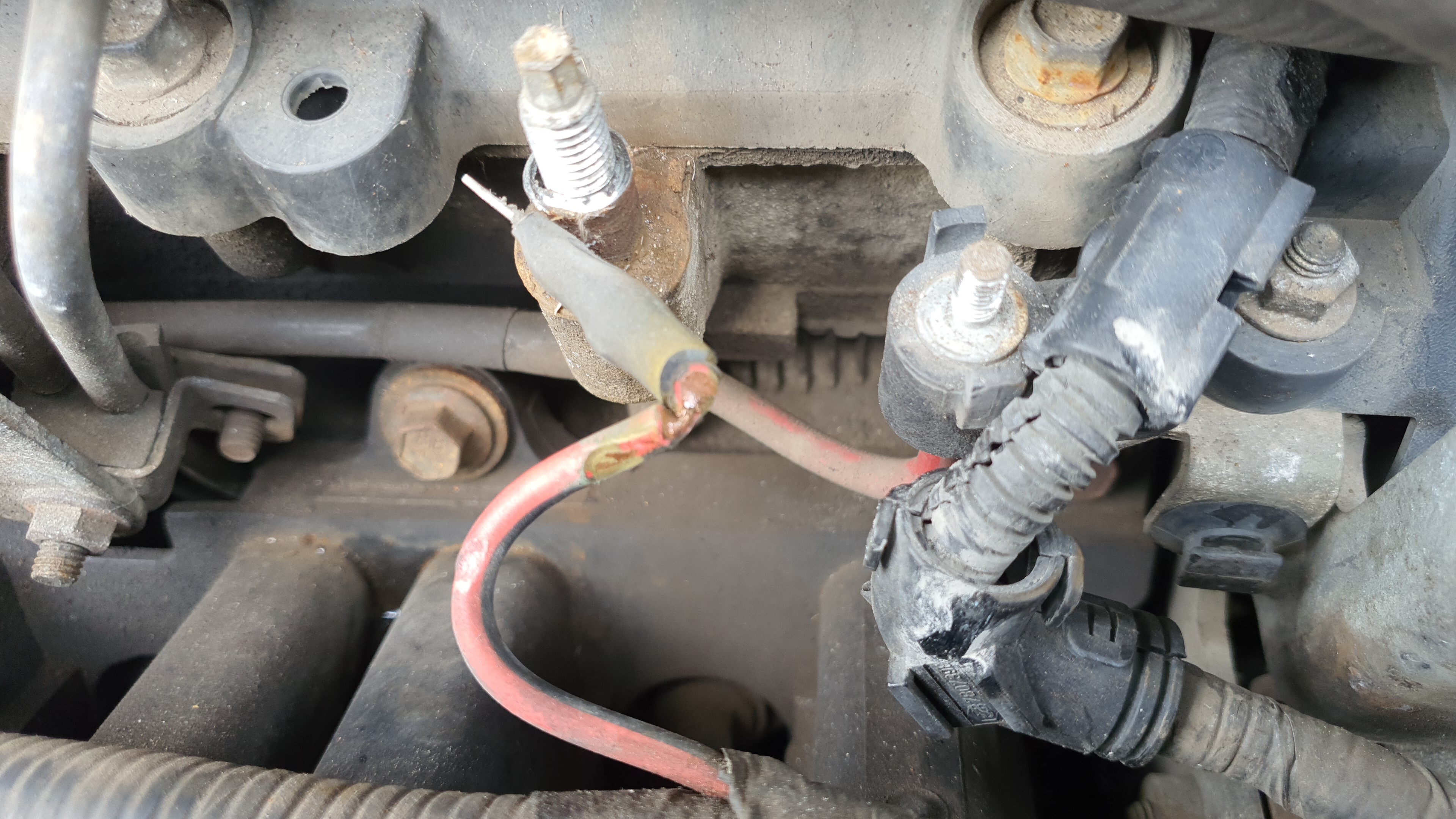

    Now fixed and the cables that should have been tied down now are
    Click image for larger version  Name:	20210713_134145.jpg Views:	5 Size:	176.3 KB ID:	15874
