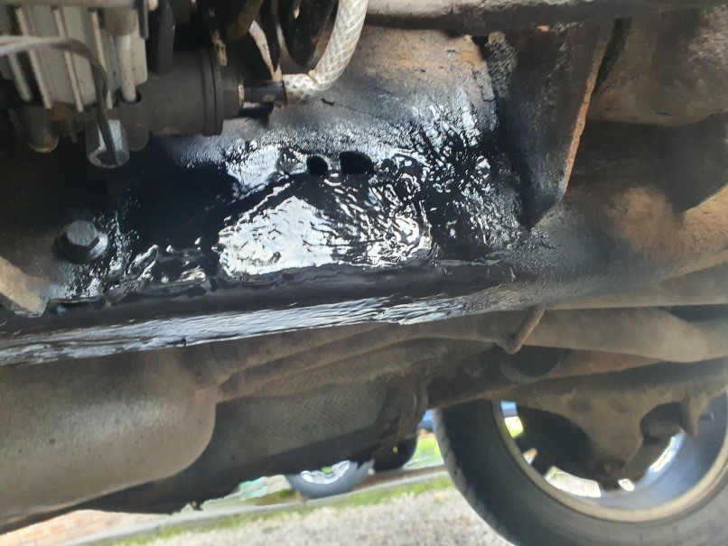

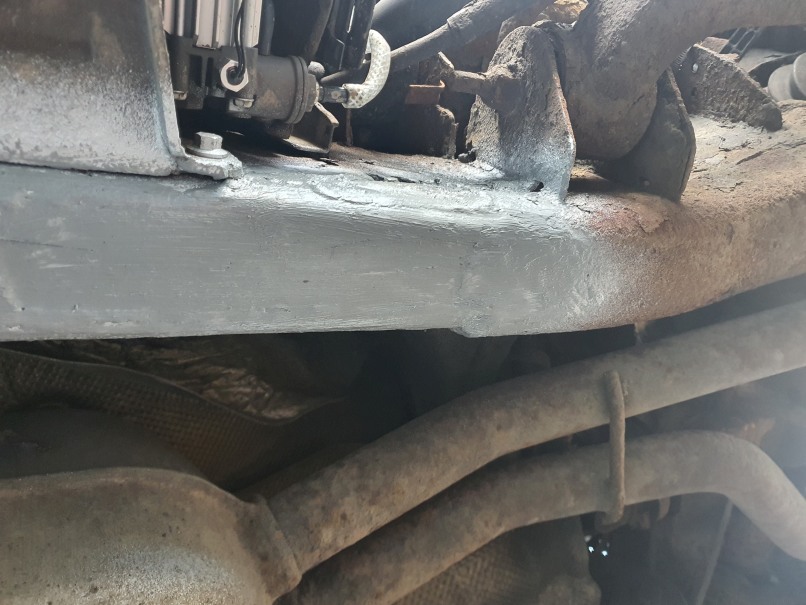

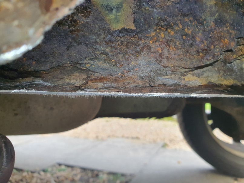

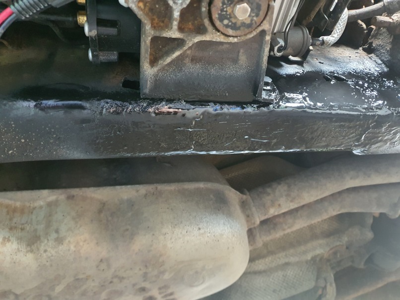

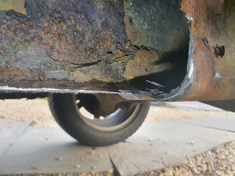

    A mate of mine had an axle stand slip and popped the chassis leg a little and look a bit crusty.
    What was a 1/2 inch crack turned into replacemnt of nearly 200mm of chassis section on the Landy TD3
    All cut out still a tad crusty but rest was solid when hammered and ground back, getting thinner but plenty meat on whats left

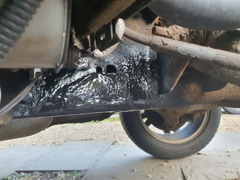

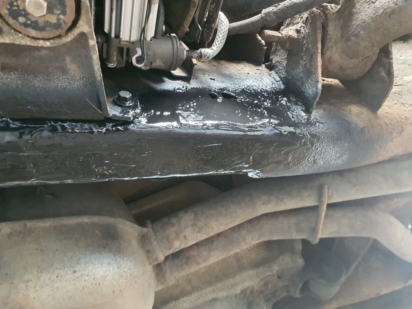

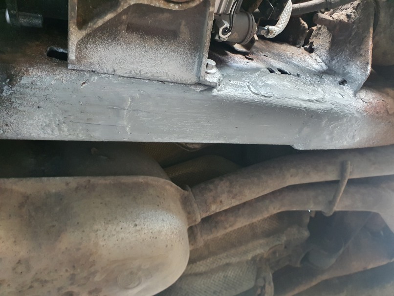

    And plated up and coated

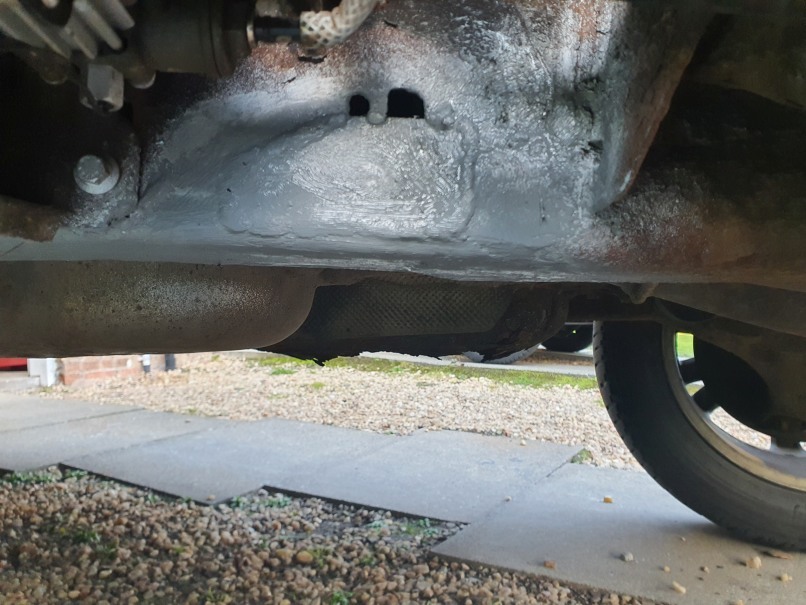

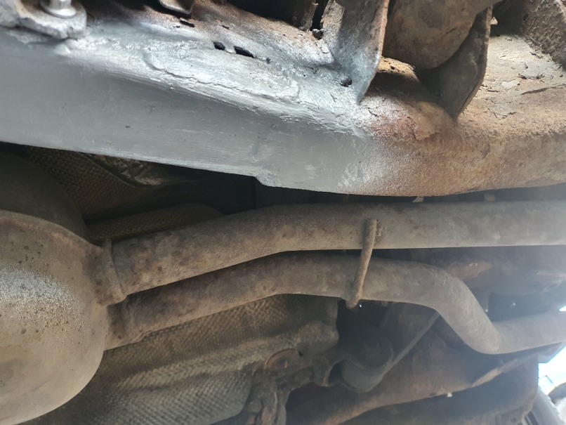

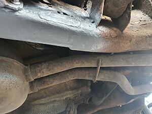

    And the coat of Ed Cs repair solution and job is a good un.
