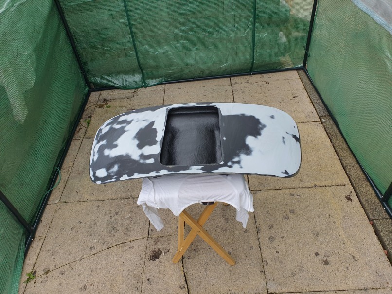

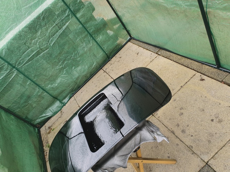

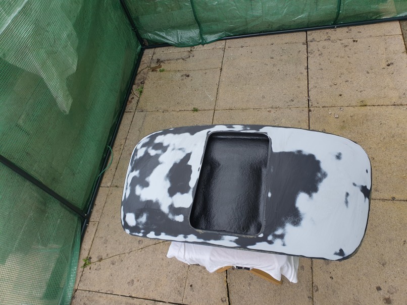

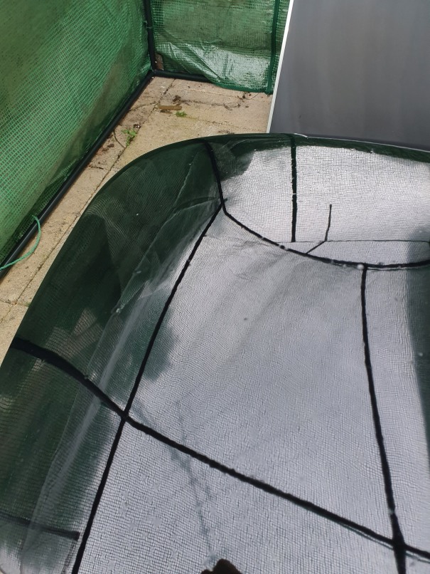

    Well it was looking like a lovely black mirro but I miscalculated the accelerator and it started to go off on last pass and the gun fired crap. I am hoping it only settled on the surface as it was going off quick and I can polish out.
    Still the whole purpose was to test paint compatability as I had no idea what was used for gel coat, primers or any of the layers exposed.
    Glad to say the acrylic produced no reactions even on some bare fibreglass I exposed on the underside
    Happy days that £60 Homebase closing down sale outsuide house did well
