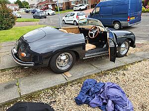

    Due to having to be stored outside this one will need some love this year. When it starts it will be given some modifications and upgrades similar to imps and well neded after the years.

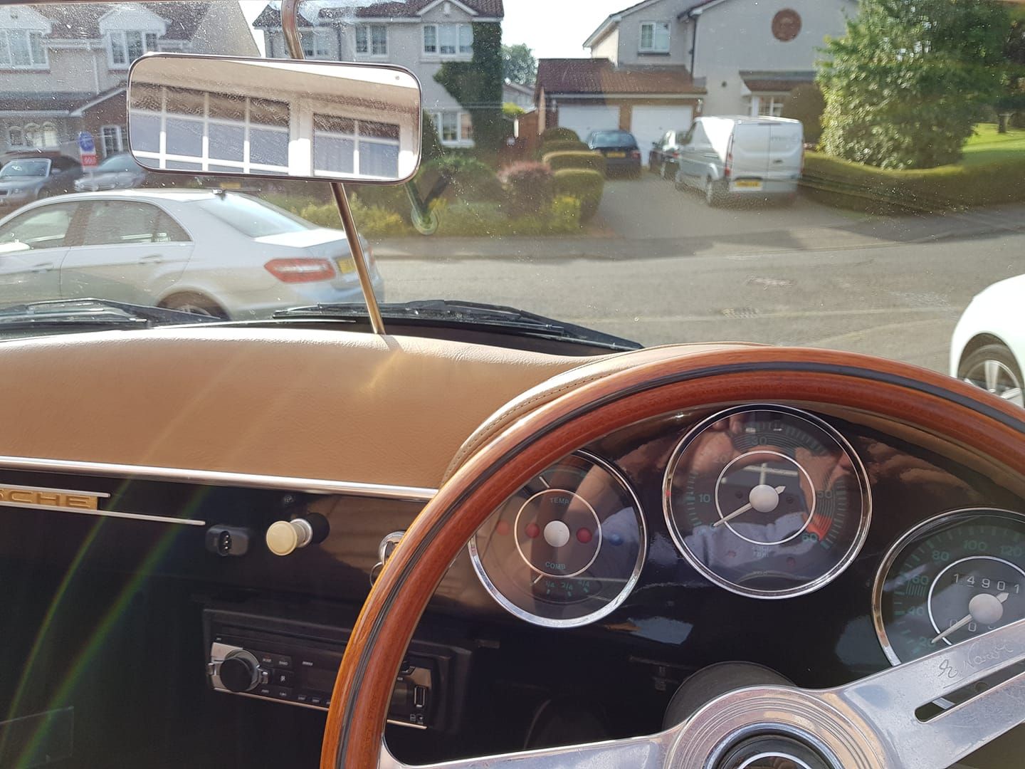

    Some of the original parts such as the speedo and instruments will need rebuilt, something i enkoy, these are all original 356 parts and the new digital ones simply look too shiny.

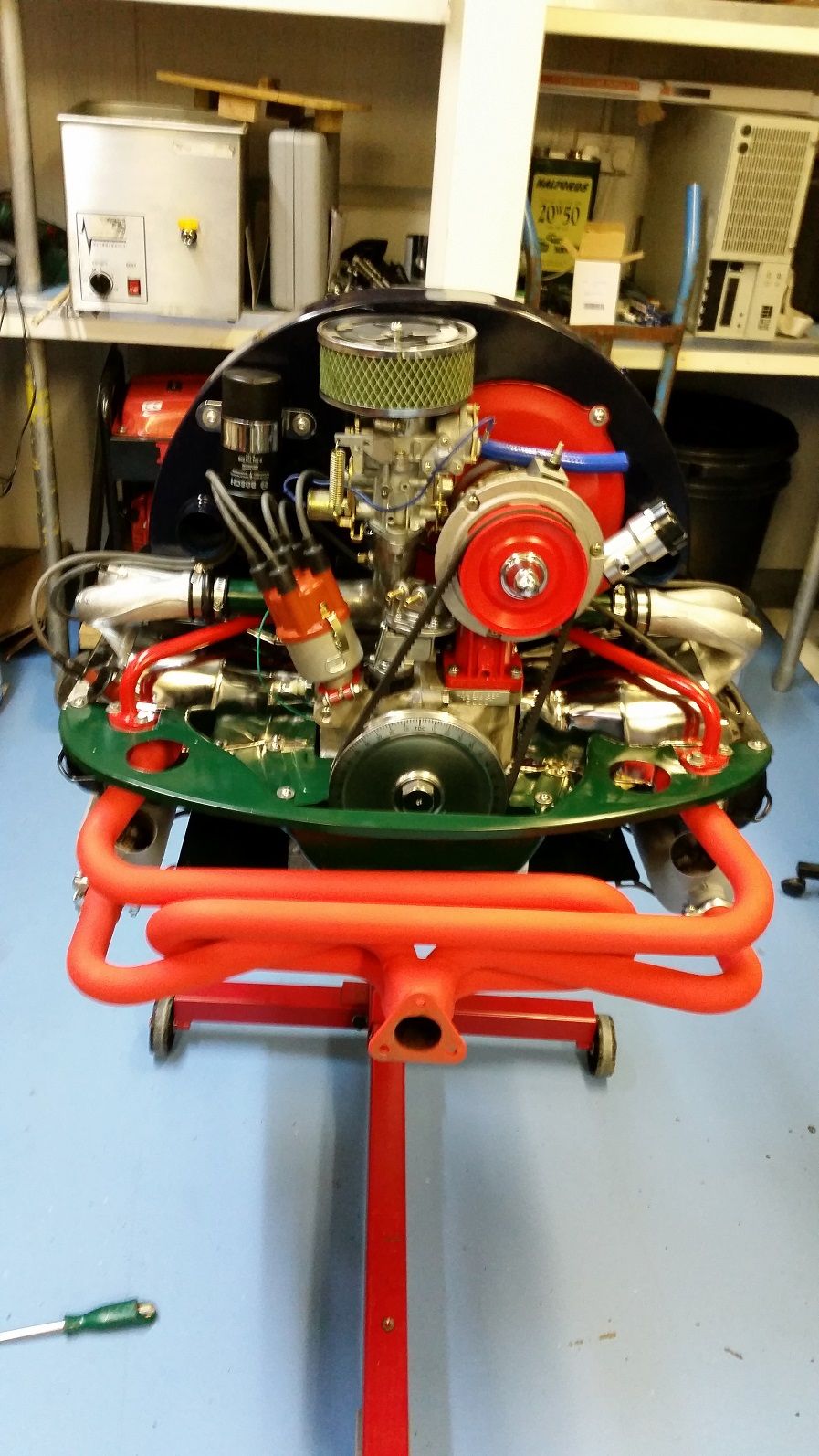

    Like imps these all have quirks and one is fuel condensation on mid mounted carbs, to go dual is expensive, really expensive so likely I will go injection on this one. Result is a poor drive until warm as it affects idle.

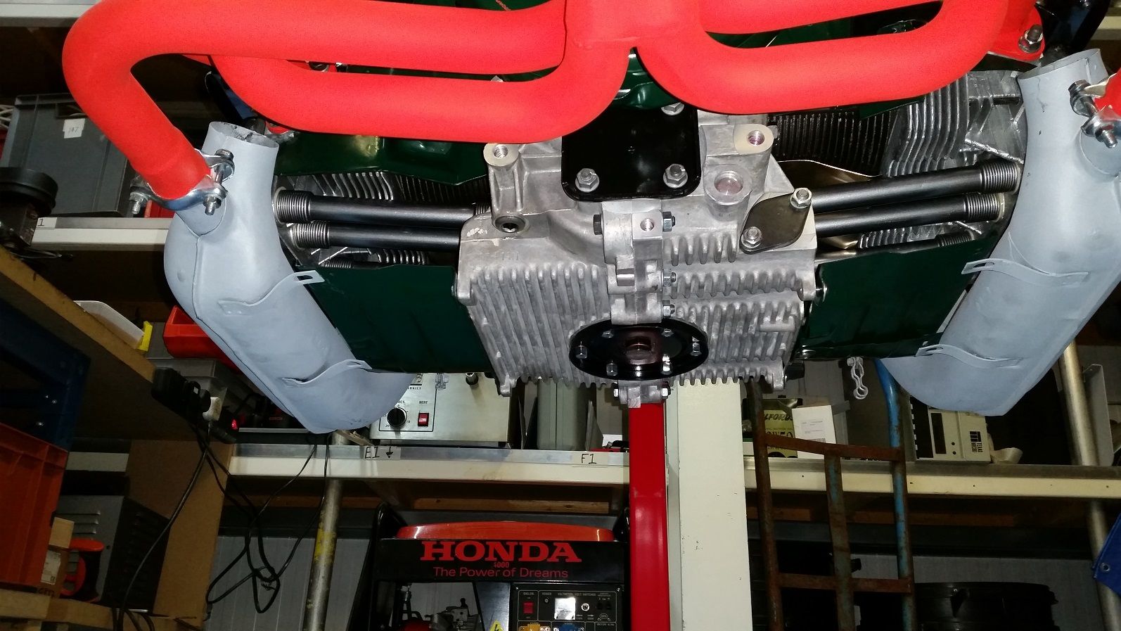

    The engine is new, unlike imps you can buy everything you need new.
    But same issue as pattern parts do and some are real crap. Example is the Solex carbs, the copies are a complete waste of time, better buying a proper genuine refurbished genuine one.

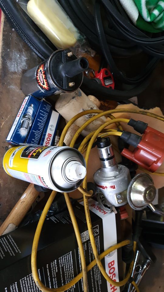

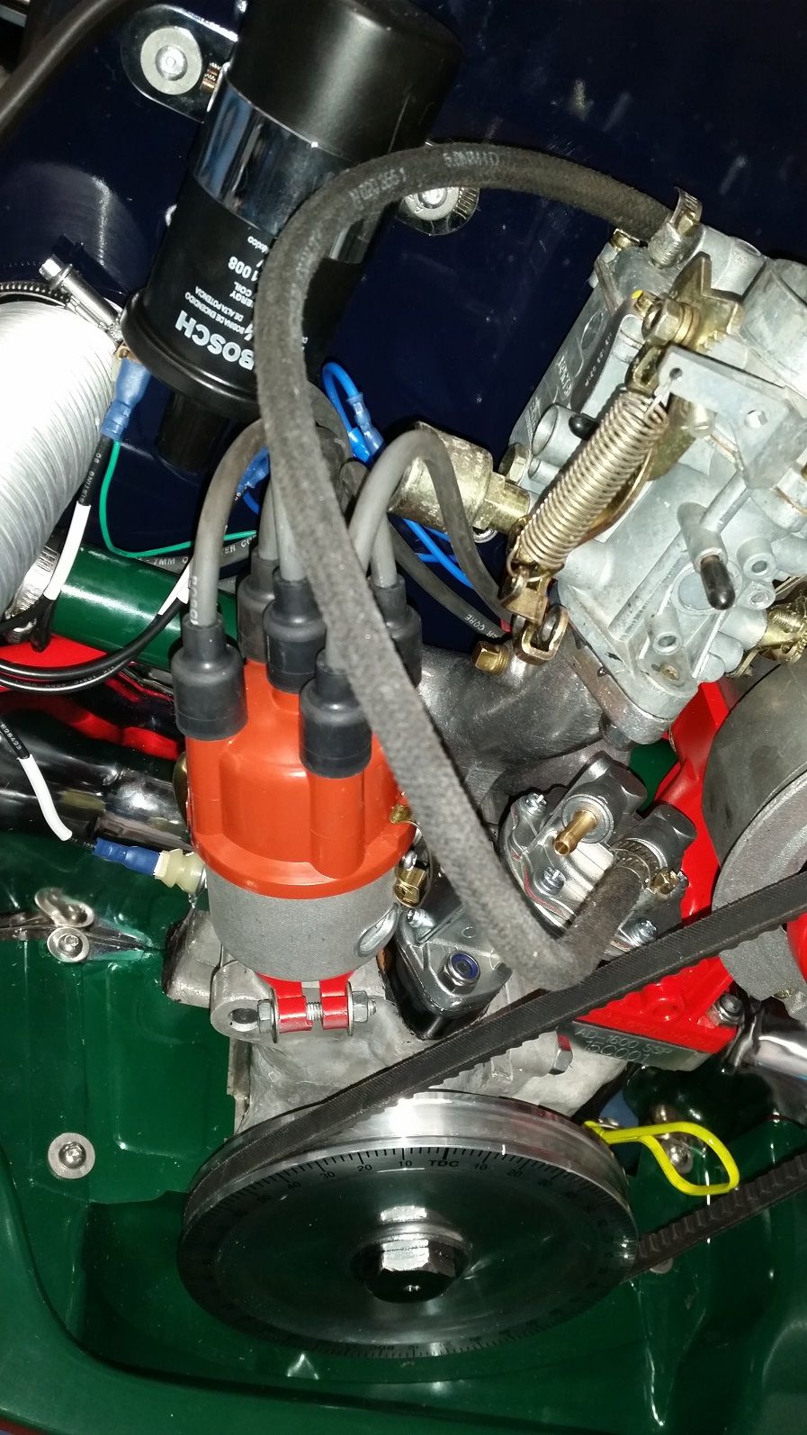

          Ah well. Poor car crapped out on me, went to start last Monday for the builders to start on the house and ended up pusghing it onto the street
          Cause discovered and rectified.
          Yet ANOTHER Pertonix ignition module crapped out. Thats the third, car never even made it a decent run on first two.
          Never again. Electronics in old cars, bad bad bad bad

          Bosch Dizzy, coil and lead s now back in and went first crank

              Amen and for those that think electronic ignition is the second coming, here endith the sermon

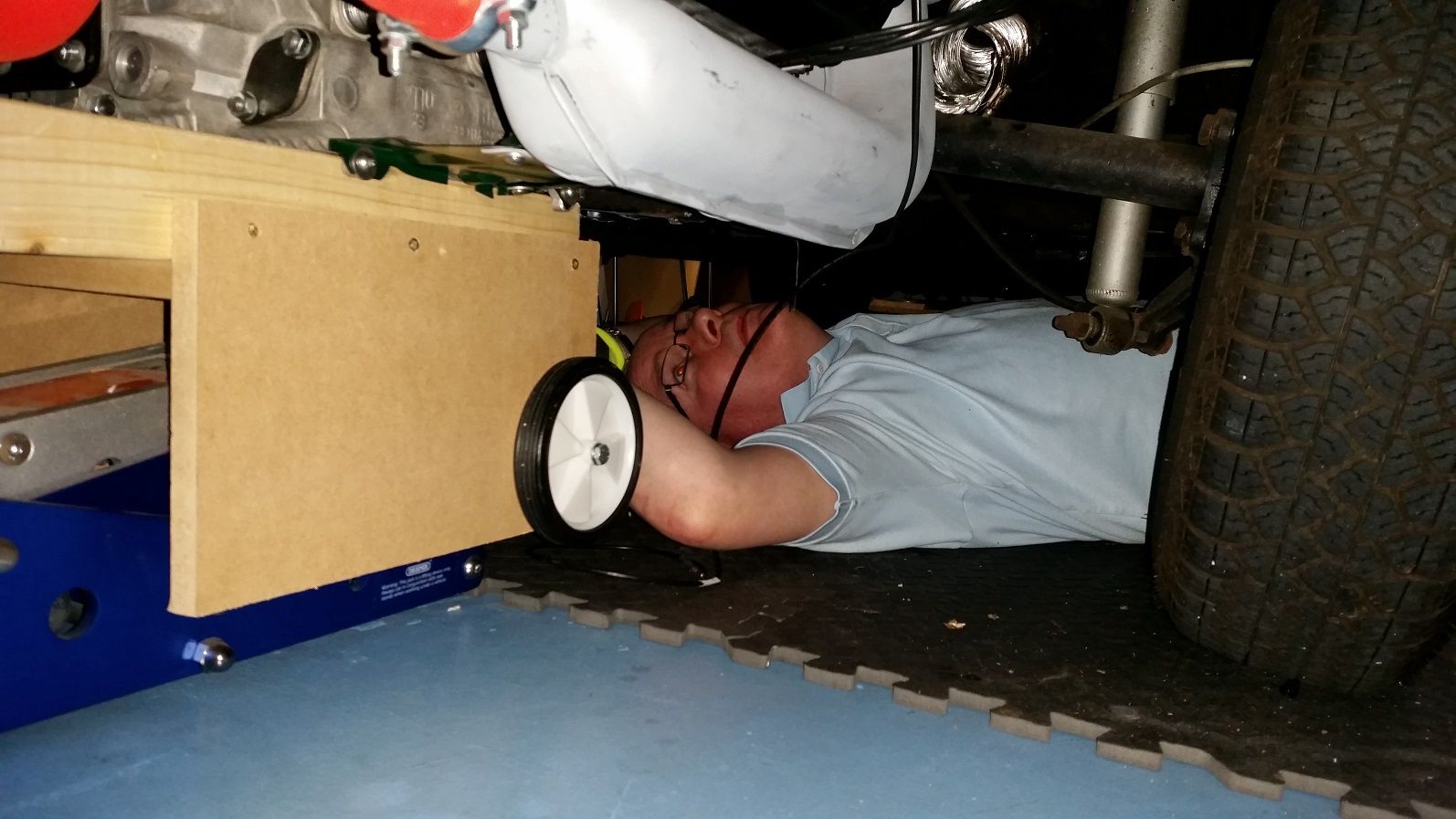

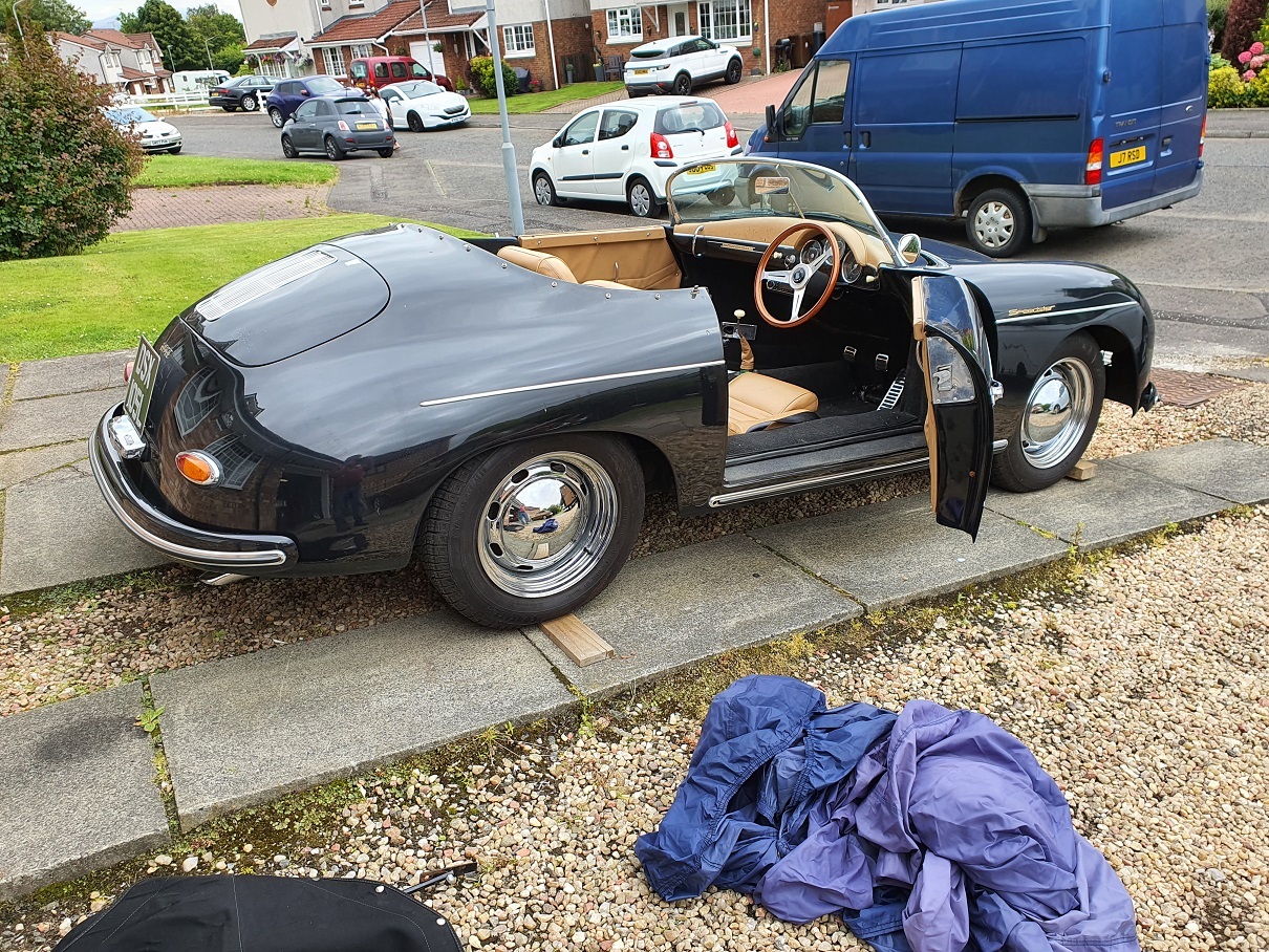

                Woken from its slumber and inside cleaned as best we can.
                New battery terminals and wiring up front, I am still resisting the tenptation to rip it all out and do it again relocating the battery to behind the rear seat in a custom box, there is a huge amount of space in that area above the starter.
                Original battery connectors were actually solid lead crimped one, reckon they probably came with the donor car !
                Battery charged up, started as soon as fuel got to the carb, on POINTS and I took it for a couple fo runs, wow, it idles so much better now and revs higher than the Pertronix would allow.
                Just shows how well the correct and working tradional dizzy functions. Good quality parts are easy to come buy on flat 4s as the spares scene is so big.

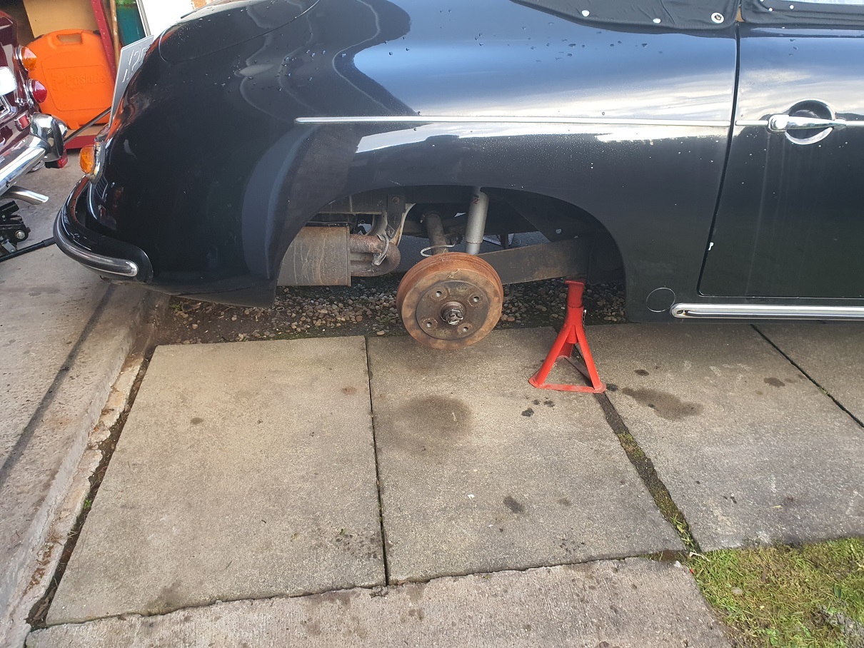

                            Time for MOT. Yes the car retains enough points under the current system to keep the age related plate and be MOT exempt but it has always had an MOT and I am happy enough with the road tax for free
                            Handbrake poor was advisory last year which is no surprise really as I dont think I have ever even adjusted in last 5 years or so as it does sod all miles.
                            Its time at home, handbrake on and parked on a slope must have taken its tool, or the cold has.
                            Anyway, sun goimng down now and temp is dropping so back inside till tomorrow , no "i am freezing emoji"
                            - J
