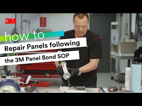

    While in a discussion on facebook about attaching Expressed panels lower 1/2 wing and joggled edges I cam across this small video.
    I know modern bond techniques get scorned, but sometimes they are a perfect case, such as two completely flat, rust free, no gap areas
    I actually used some of these materials on JDL 889F on the rear lamp area as you simply could not weld in the repairs well, plus I wanted the small back gap filled.
    The video shows the highlights
    Just a little bit more to sit back and enjoy.
    Modern cars make serious use of this stuff now as dispensing robuts a lot easier to manage than weld bots
