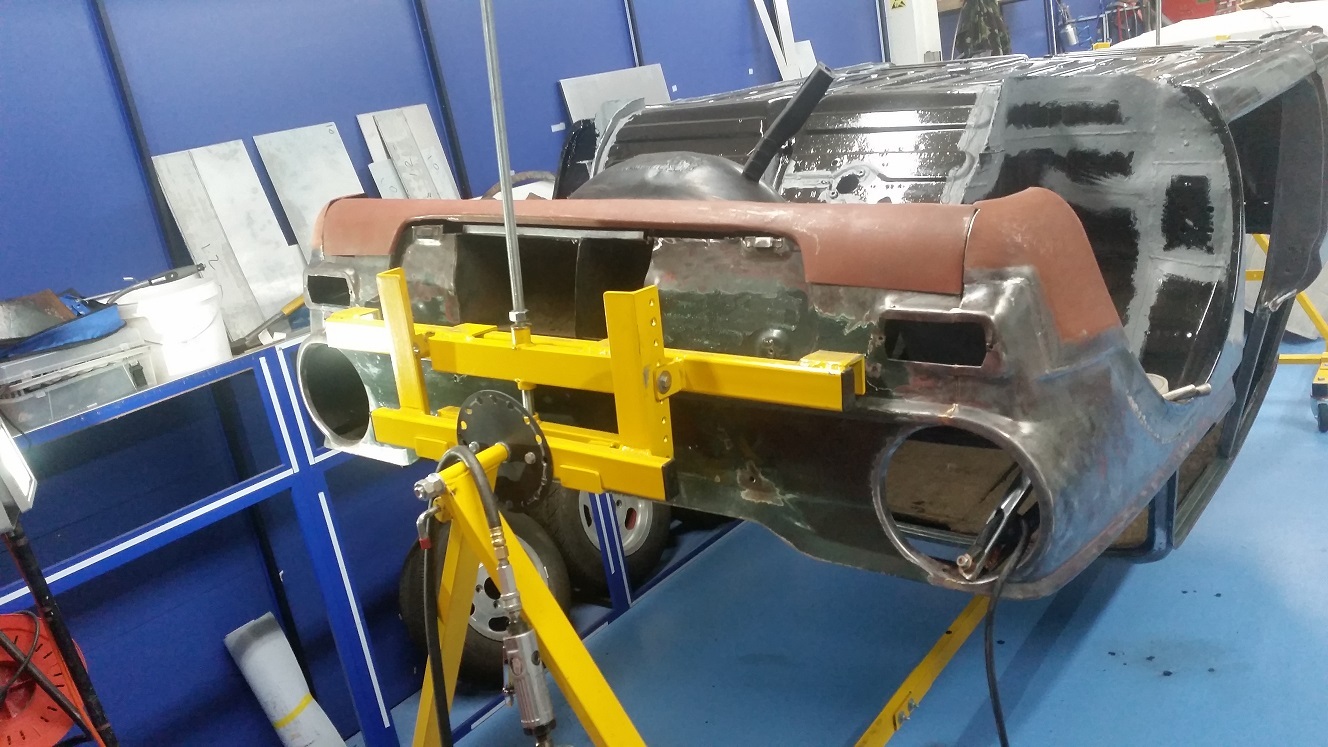

    Click image for larger version  Name:	48 PIC-06840.jpg Views:	0 Size:	220.8 KB ID:	12250
    They are indeed very handy, but need used with GREAT care as Imp Shells are not the most stable when cut up.

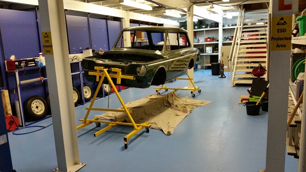

    The best one I found that I had my eye on was from CJ AUTOS
    Does a lot more than just an Imp, raises and lowers to floor level and rotates/lowers for access with ease and on castors, but expensive and not so easy to store when not in use, would be perfect for someone doing it as a day Job. It is also nearly £1000
    So I eventually found this one which can be bought as cut steel "stock" for you to weld yourself, pre-welded sections flat packed is +£50 for you to assemble and it comes supplied unpainted so no added cost there. This came from ROLLOVERJIGS.COM online
    I opted to take the jig flat packed and pre-welded, service was great and only £235 in standard form WITH the bars to fit the Imp, pick Hillman Imp during checkout.

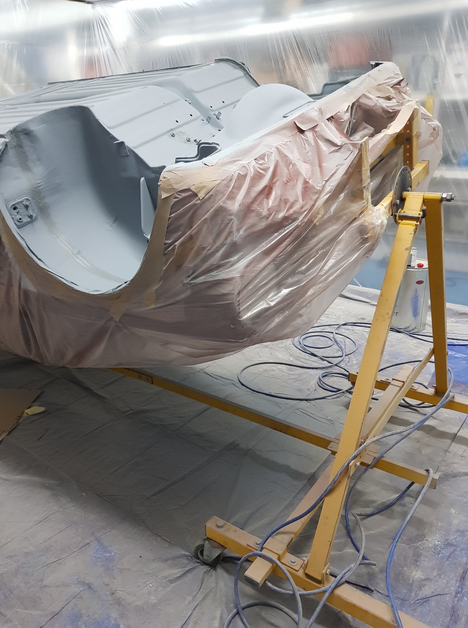

    If you want it on castors they have a castor kit which lets you move it around. It adds a few quid though and you could do this part yourself, good quality heavy castors are cheap
    The lowereing / levelling kit is a pain in the backside, you can raise / lower the car from ground up anyway without it, I will leave you to figure out how

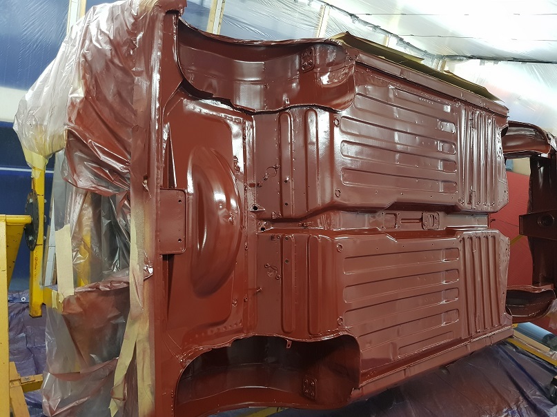

    Paint wise I uses Besa URKI Rapid 70 One Coat, a really tough industrial paint usually used for machine rooms and plant, quick scuff with scotchbright and you will be taking it off with a grinder if you ever need to, I have tossed fuel, paint, thinners, brake fluid and even a small fire and it still intact coating wise.

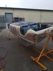

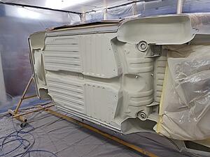

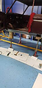

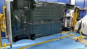

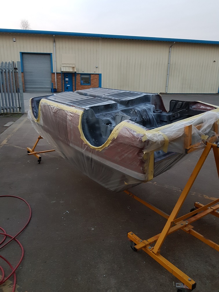

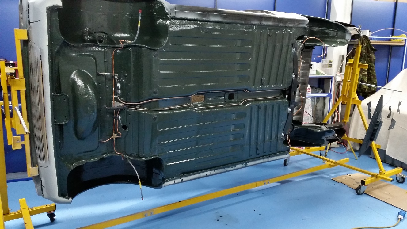

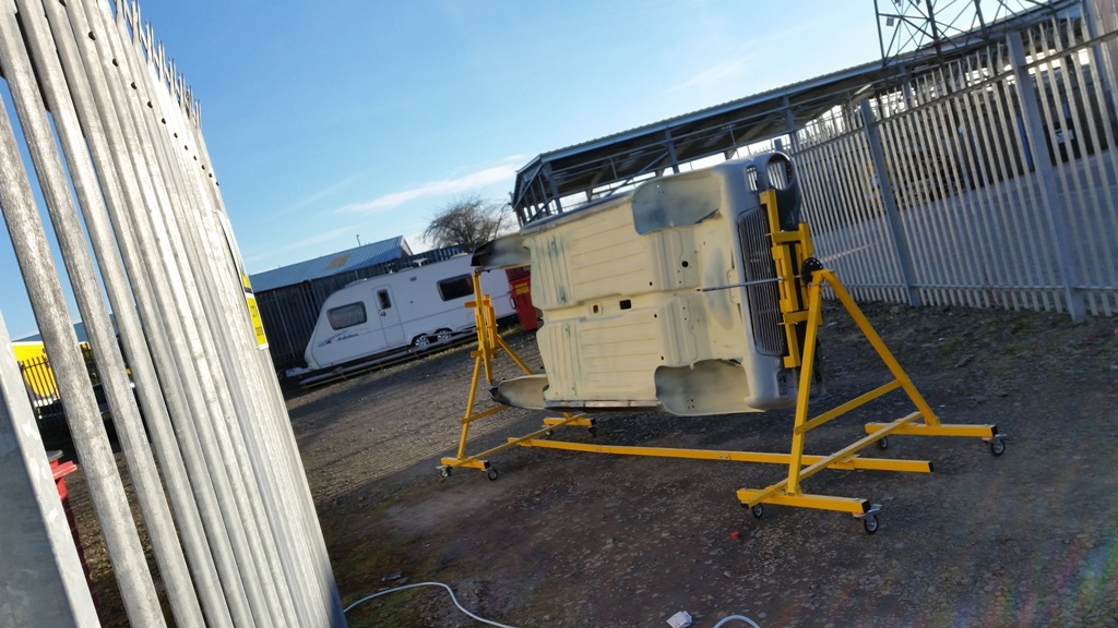

    Shown here used on 2 cars, for storage it flat packs and fits under the bench.

    The cars below are not examples of Colins work, they are mine, Colins work is much much better !

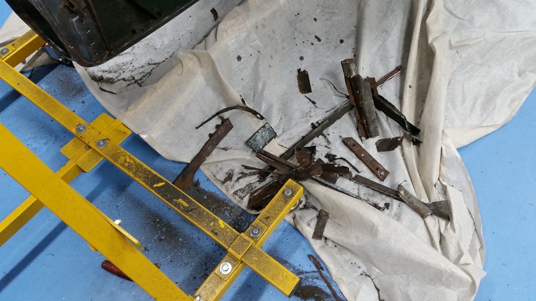

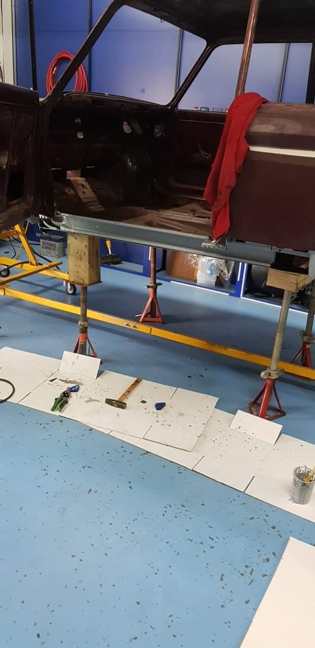

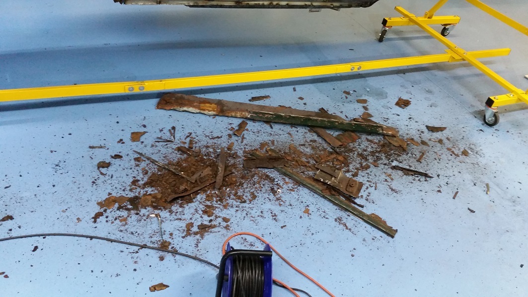

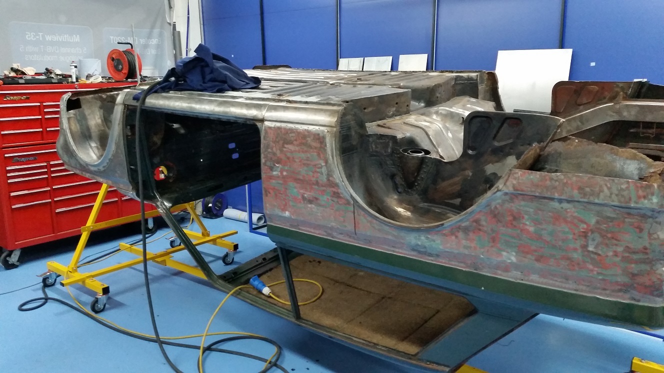

    Click image for larger version  Name:	PIC-09809.jpg Views:	0 Size:	57.3 KB ID:	12251Click image for larger version  Name:	PIC-09575.jpg Views:	0 Size:	139.9 KB ID:	12252
    Click image for larger version  Name:	PIC-07987.jpg Views:	0 Size:	295.0 KB ID:	12253Click image for larger version  Name:	40 PIC-07976.jpg Views:	0 Size:	227.4 KB ID:	12254
    Click image for larger version  Name:	PIC-08029.jpg Views:	0 Size:	322.1 KB ID:	12255Click image for larger version  Name:	PIC-09572.jpg Views:	0 Size:	184.0 KB ID:	12256
    Click image for larger version  Name:	6 PIC-06883.jpg Views:	0 Size:	235.9 KB ID:	12257Click image for larger version  Name:	PIC-06959.jpg Views:	0 Size:	232.0 KB ID:	12258
    Click image for larger version  Name:	PIC-09562.jpg Views:	0 Size:	222.1 KB ID:	12259Click image for larger version  Name:	38 PIC-07954.jpg Views:	0 Size:	291.8 KB ID:	12260
    Click image for larger version  Name:	PIC-09796.jpg Views:	0 Size:	425.6 KB ID:	12261
