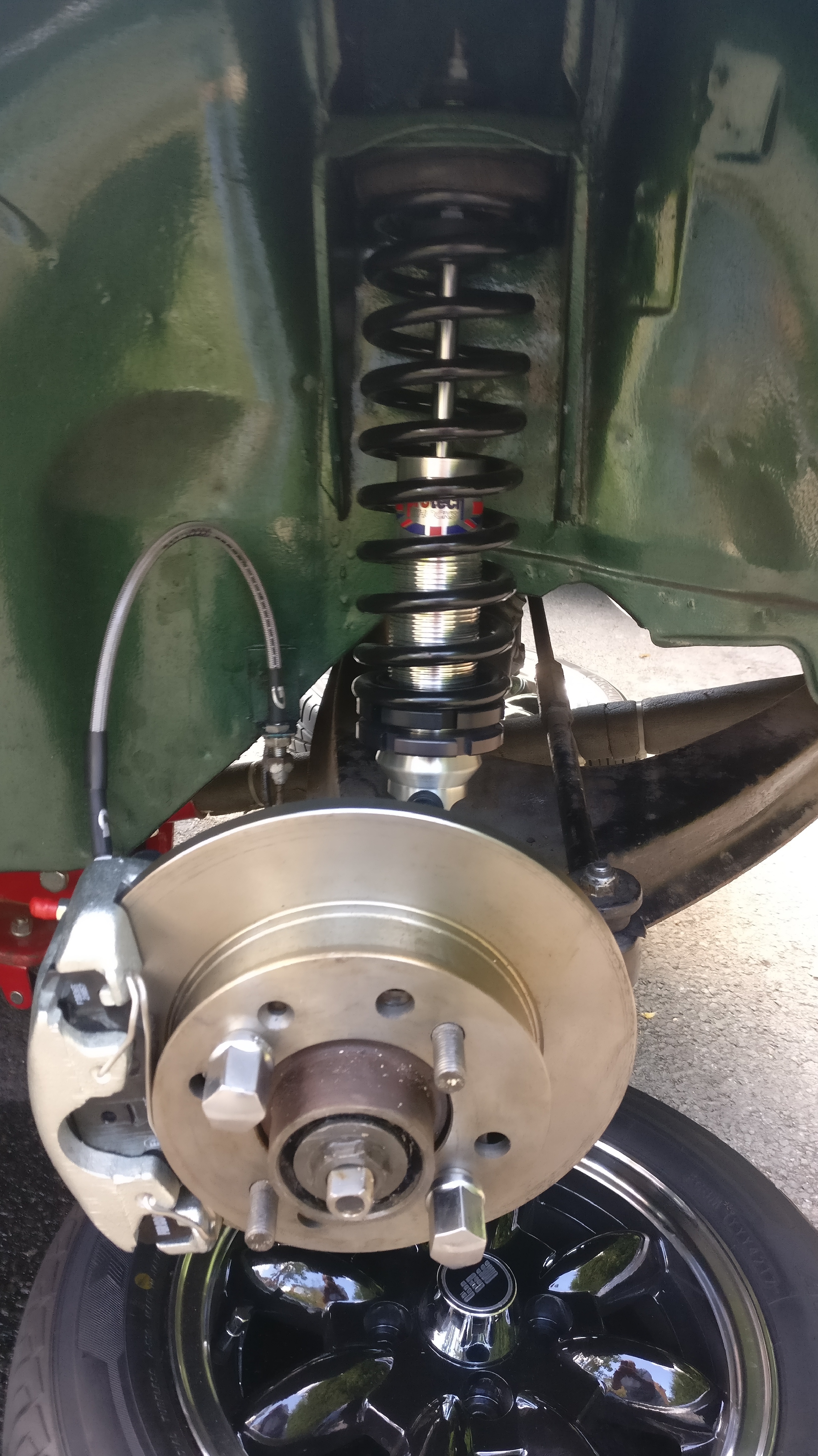

    I acquired the AUK in August 2017, it being my 3rd ever Imp and after a 42 year gap since its predecessor. My first car was a 64 plate which soon got modified with ported head, Piper cam, Janspeed exhaust, Peco box across the back etc and when I got the Auk I decided that I wanted to relive my youth a bit. In 2018 attention was mainly focussed on the running gear so as well as an alternator conversion on went Montes and Protech shocks all round, Colin Valentine's front discs and 13 x 5.5 alloys with A539s. In this form it took 3rd place for Chrysler Imps at the Loghborough National. Last year had the engine out for head mods (bigger valves and porting) done by poor Dennis Allt at Transimp, together with Sport Strombergs and exhaust, new clutch, roller release bearing, and HE radiator. This years plan is just for a Sport engine cover, bog brush cooler and new hatch with HRW, as well as getting the carbs set up a bit better. Hoping to give it a good airing around Goodwood during the National at the end of July.

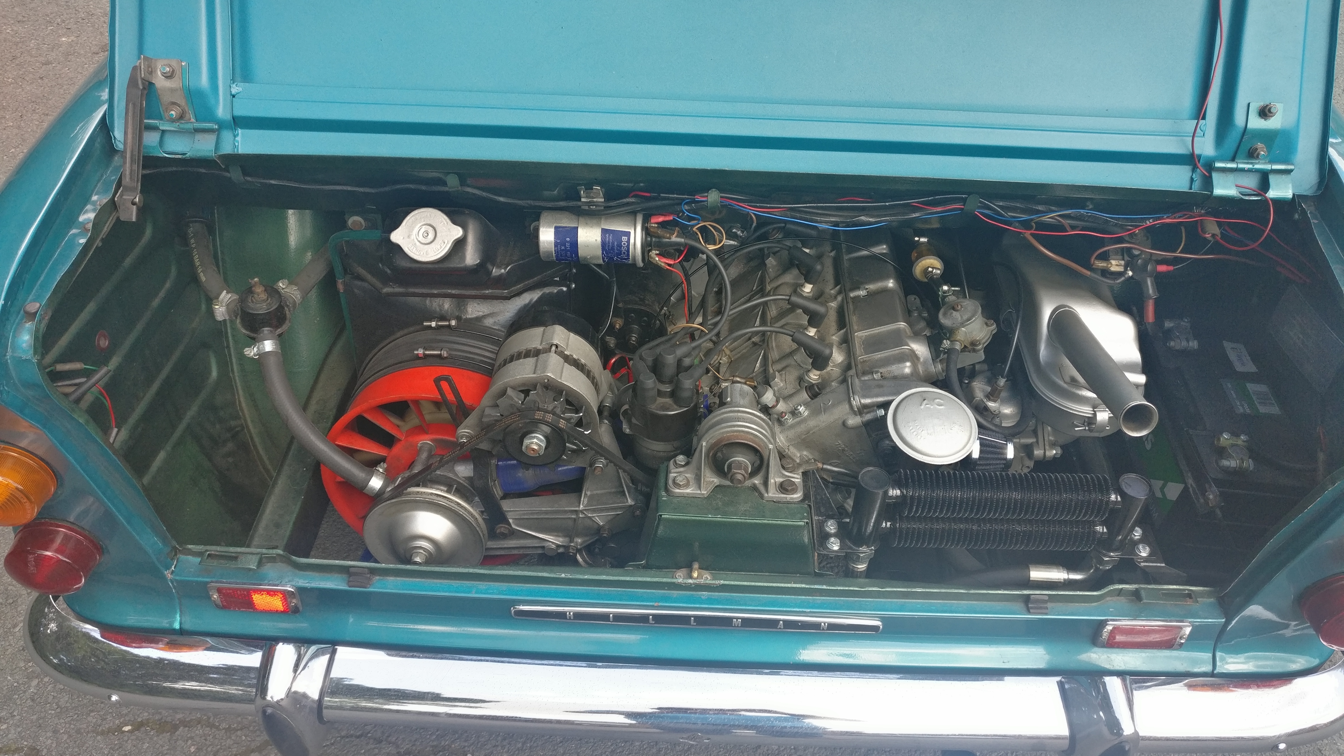

            Well, as I trailed back in Jan’20 the car has since acquired the ‘Sport’ engine cover and the engine mods were completed with the plumbing-in of the Stromberg inlet manifold and the addition of the bog-brush oil cooler.

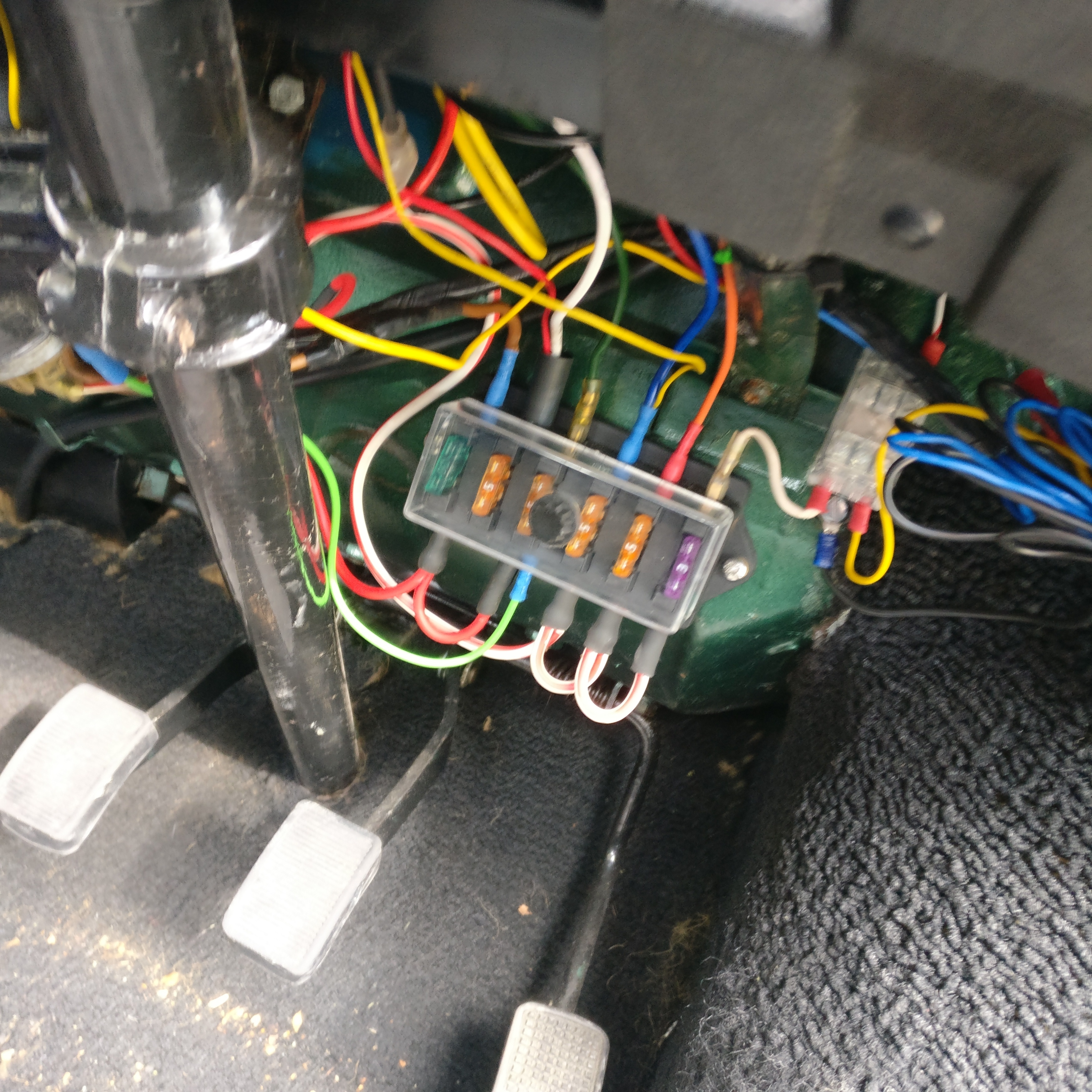

            The rear hatch was replaced with one fitted with a heated rear-window using original style switch and warning light in the dash but using a timer/relay (hidden in the now empty RB340 control box) and the electrical mods were completed with the fitting of fuses, with the fuse- box located inside the car above the pedals as I didn’t want to cut holes in the front boot lining.

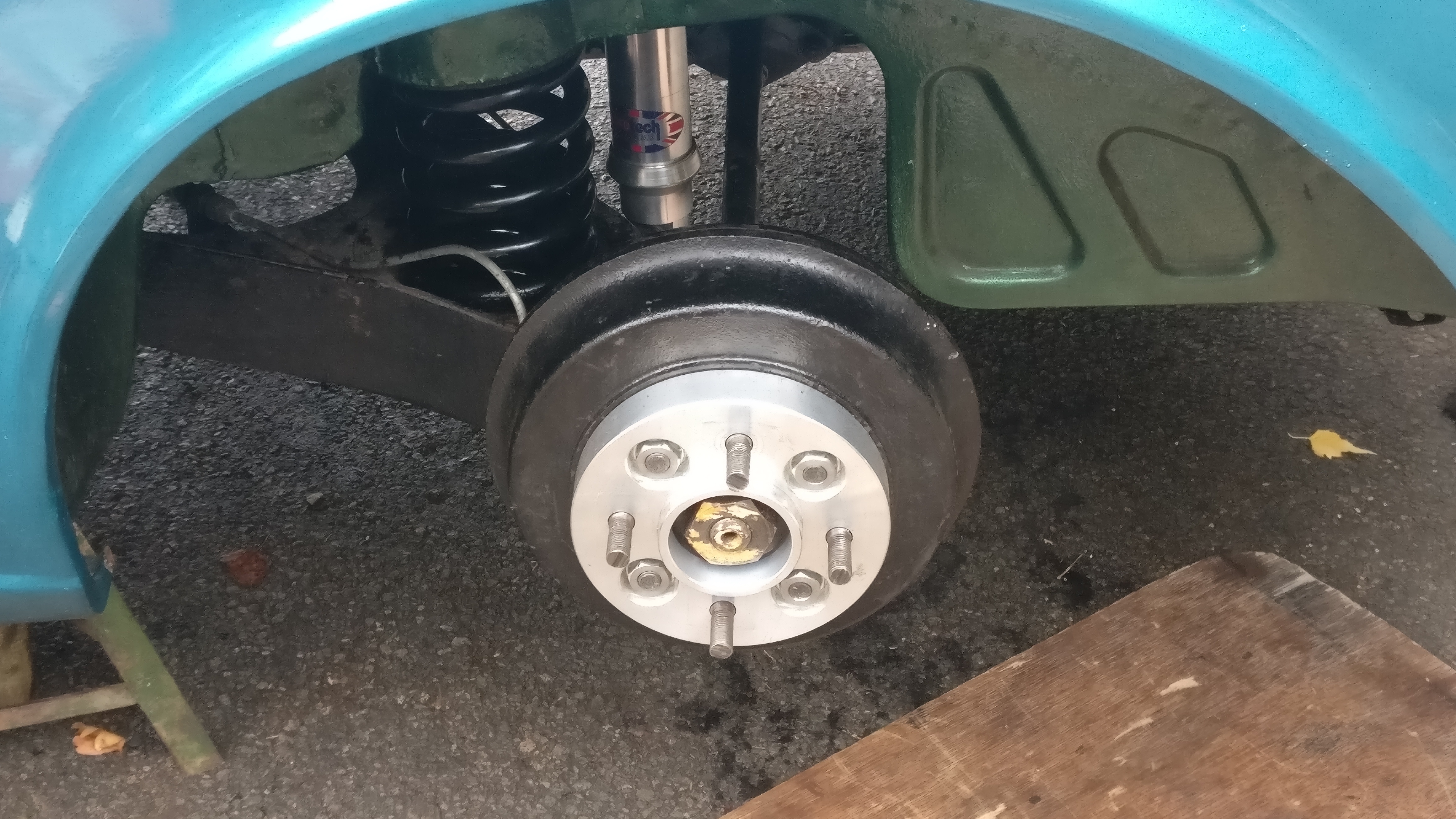

            The drivetrain was improved by changing to 1 inch ‘Sport’ shafts and the rear brakes uprated by the fitting of the excellent brake shoes from Moose which perfectly complement the front Fiesta type disc set-up.

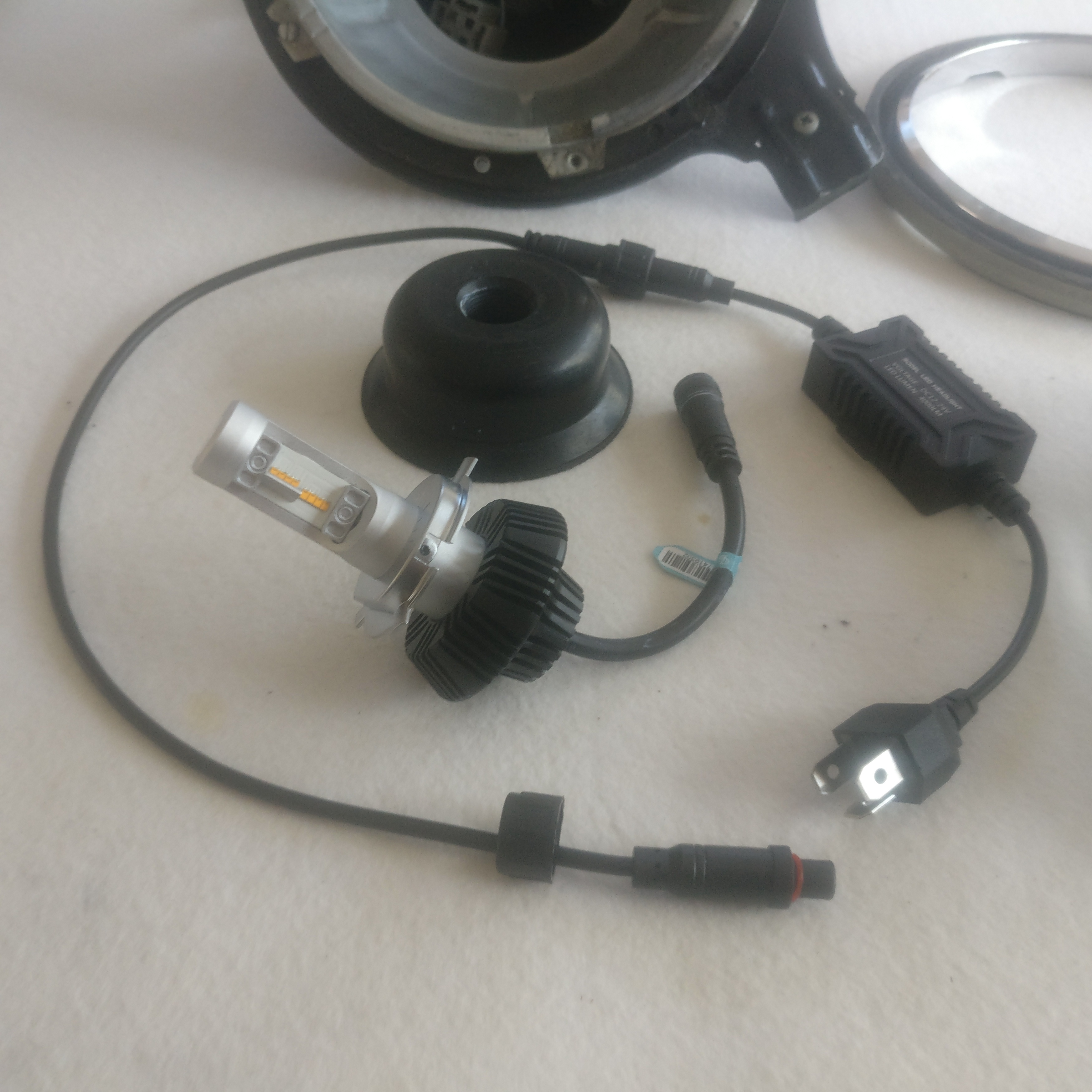

            Lighting has been utterly transformed by fitting LED units to all external lights. What a massive improvement! I kept to ‘warm’ white so as to retain the ‘Classic’ look, and yes, they are all fully legal and have been checked and passed for MoT.

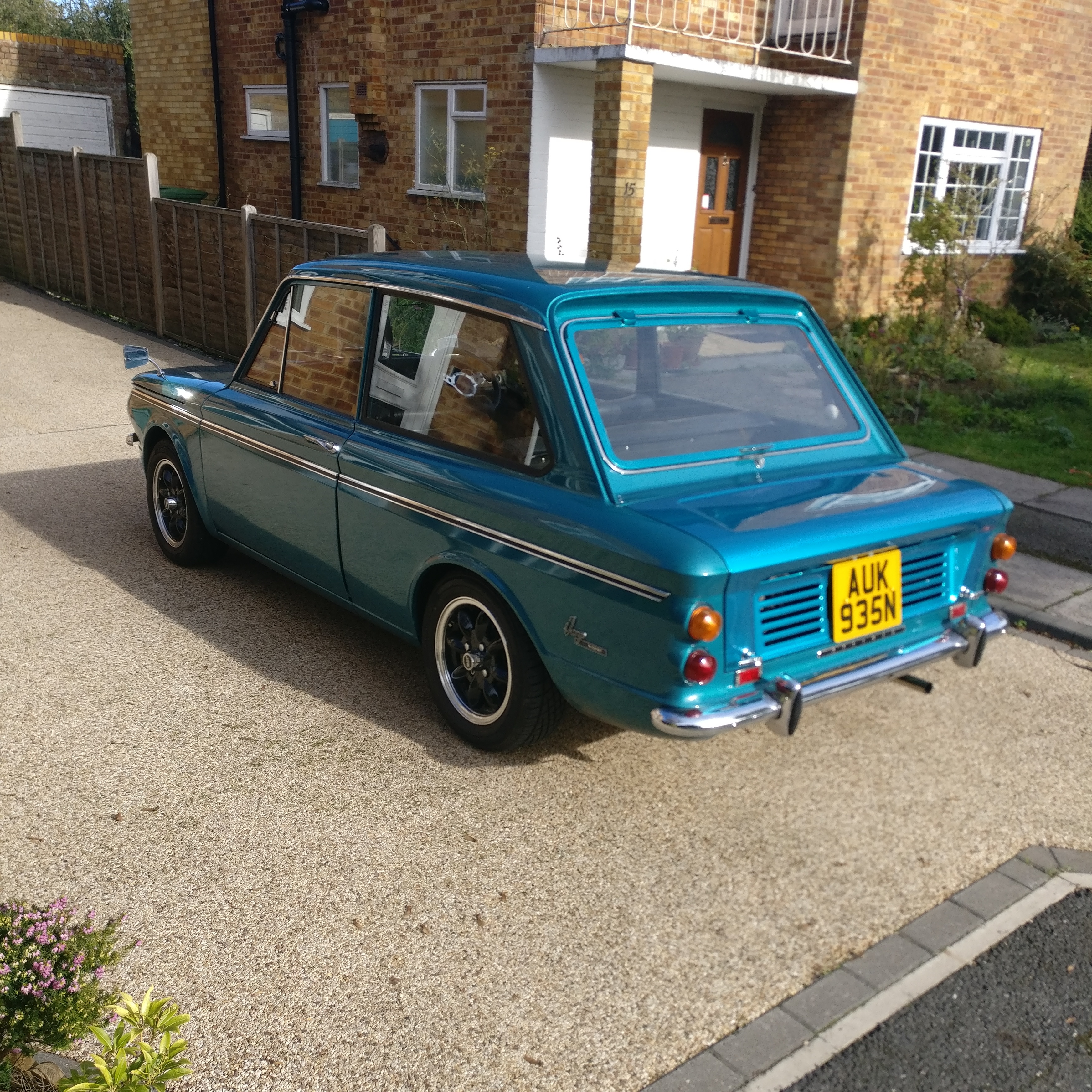

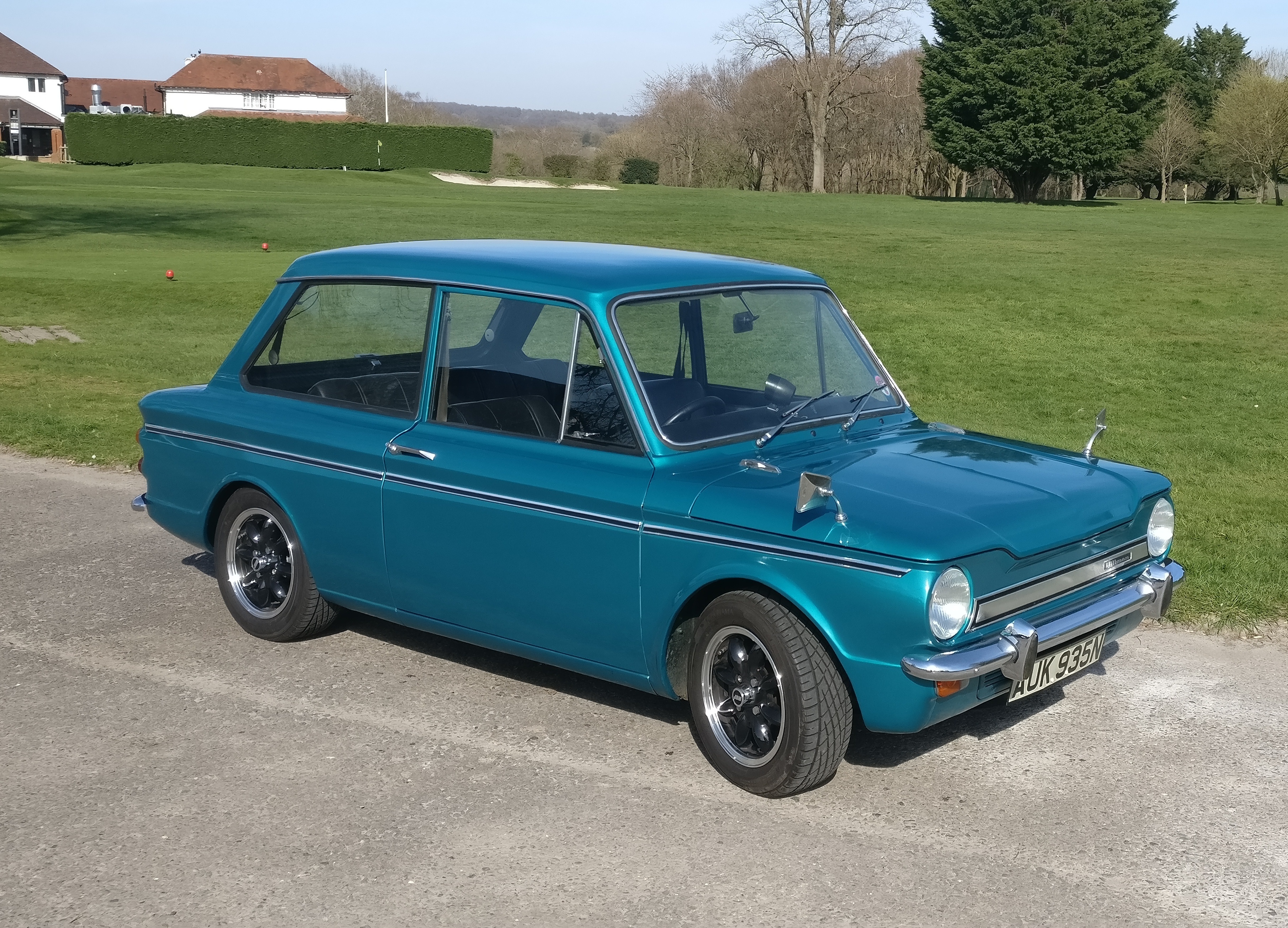

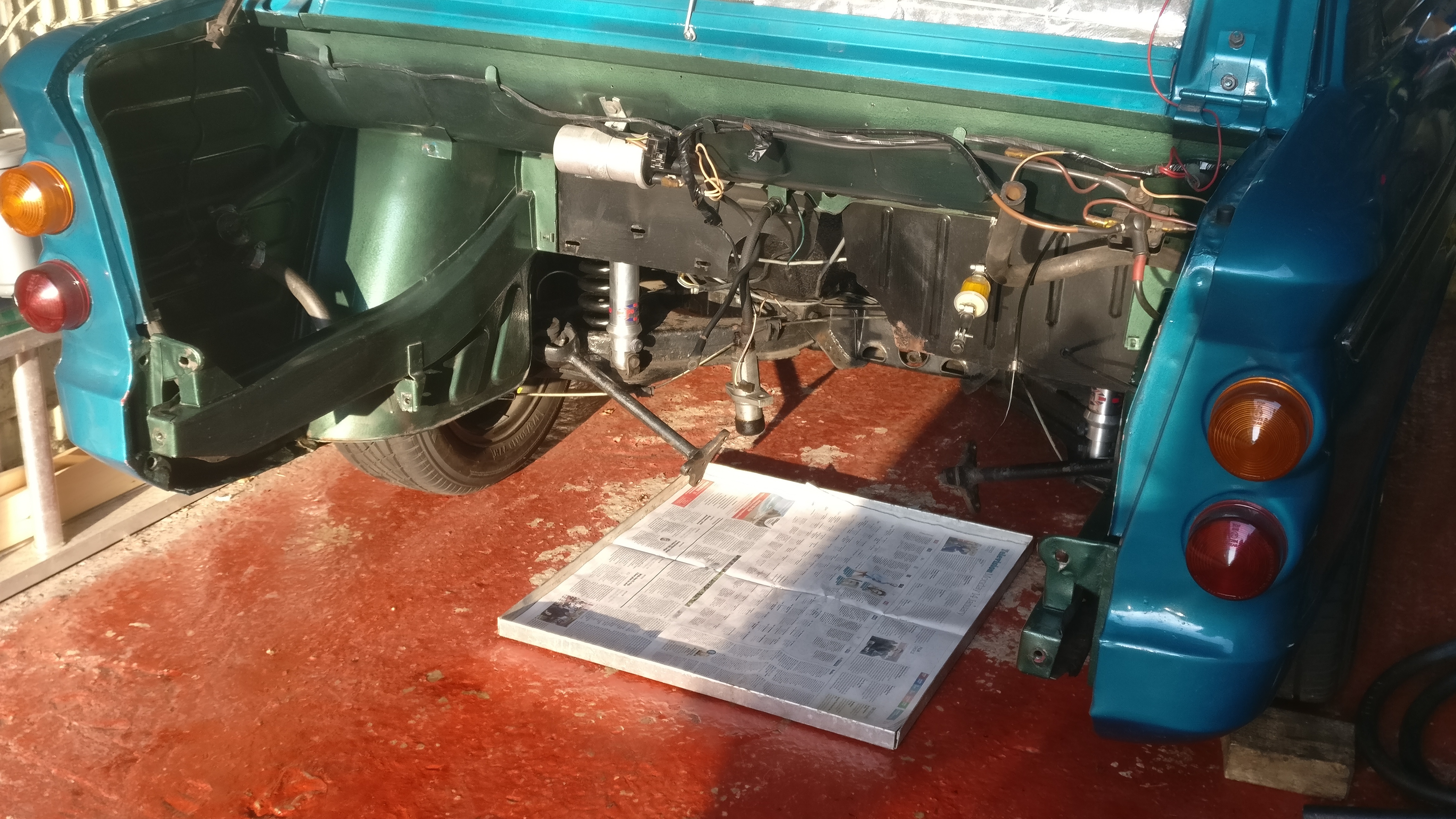

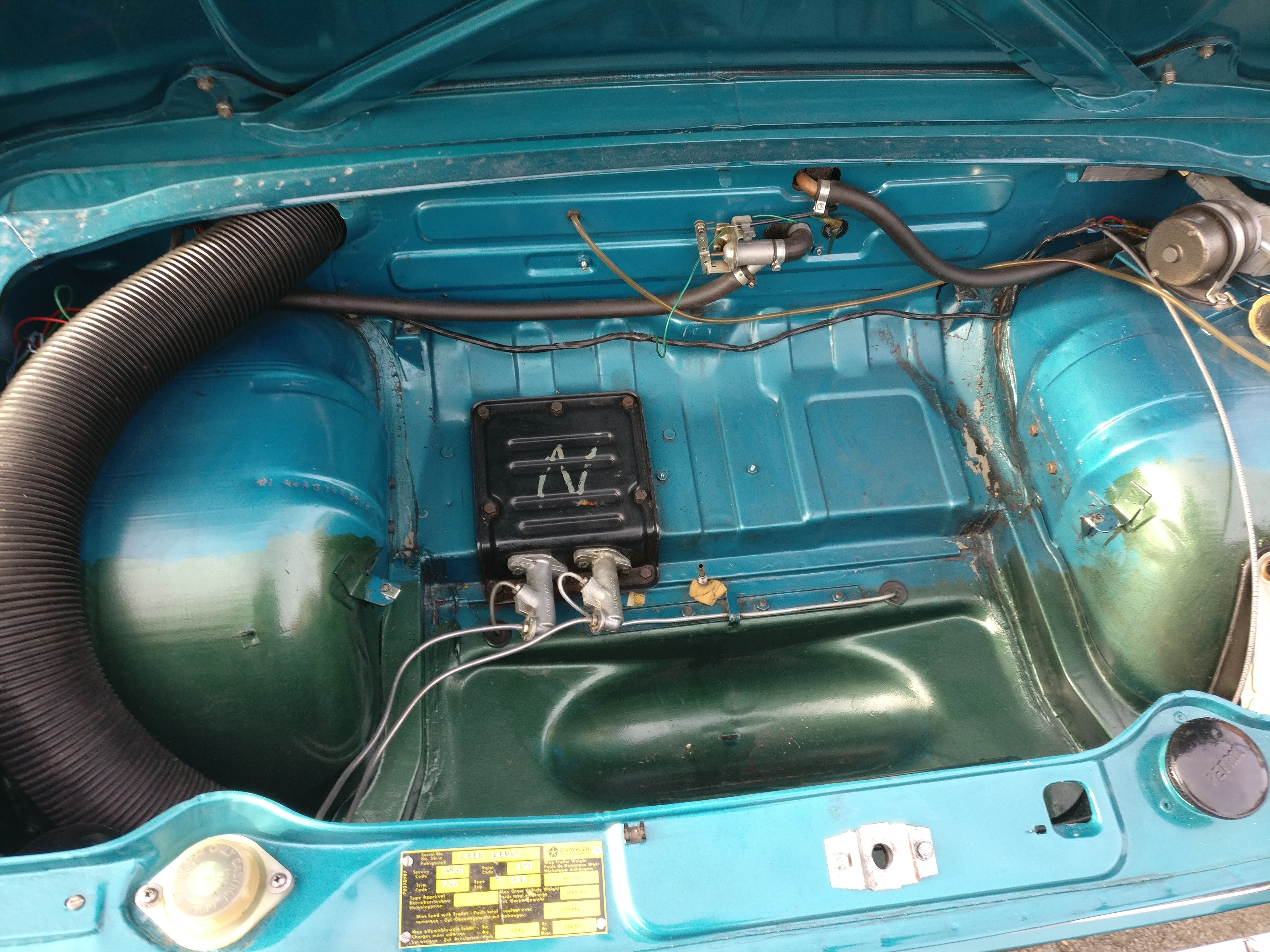

                Aquarius is the original colour but the green you see inside the engine compartment is actually old-style Hammerite which a previous owner had used for rustproofing / protection to the underside.

                Not particularly pretty but seems to have done the job.
