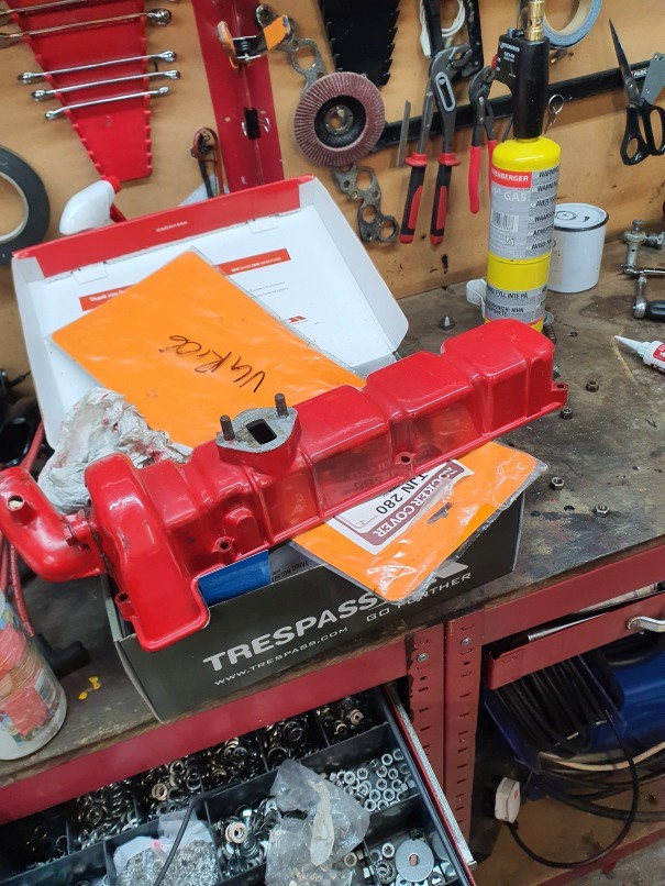

The red cam box had to go
    Its the small things but try as I did to convince myself I could live with the red cam cover, looking at the red along side the maroon, I just could not live with it.

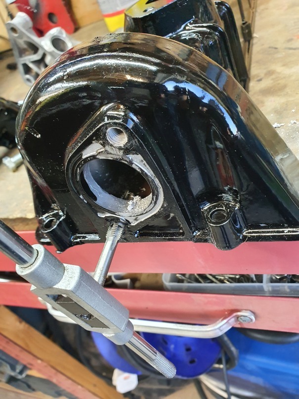

    Thread repair on the filler neck, why o why do people insist on ramming the wrong threas into ally
    heat up a bit, JB weld, leave till next day, drill & tap, jobs a good 'un

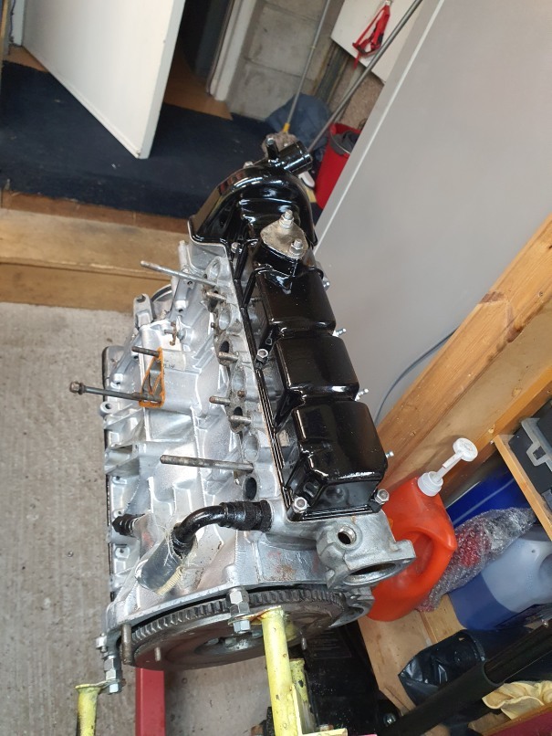

    So duly replaced in black, much more subtle

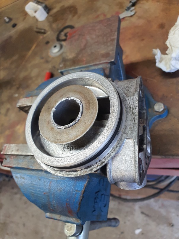

    While I was at it I repaired one of the knackered oil filter flanges, the flat plate the end of teh element rests on had been rammed so far it was jamming the poppet valve open.
    Flattened, cleaned and re-peened
    The engine was expecting a sport manifold but as I do not have a spare oil cooler I need to go find a short stud now
