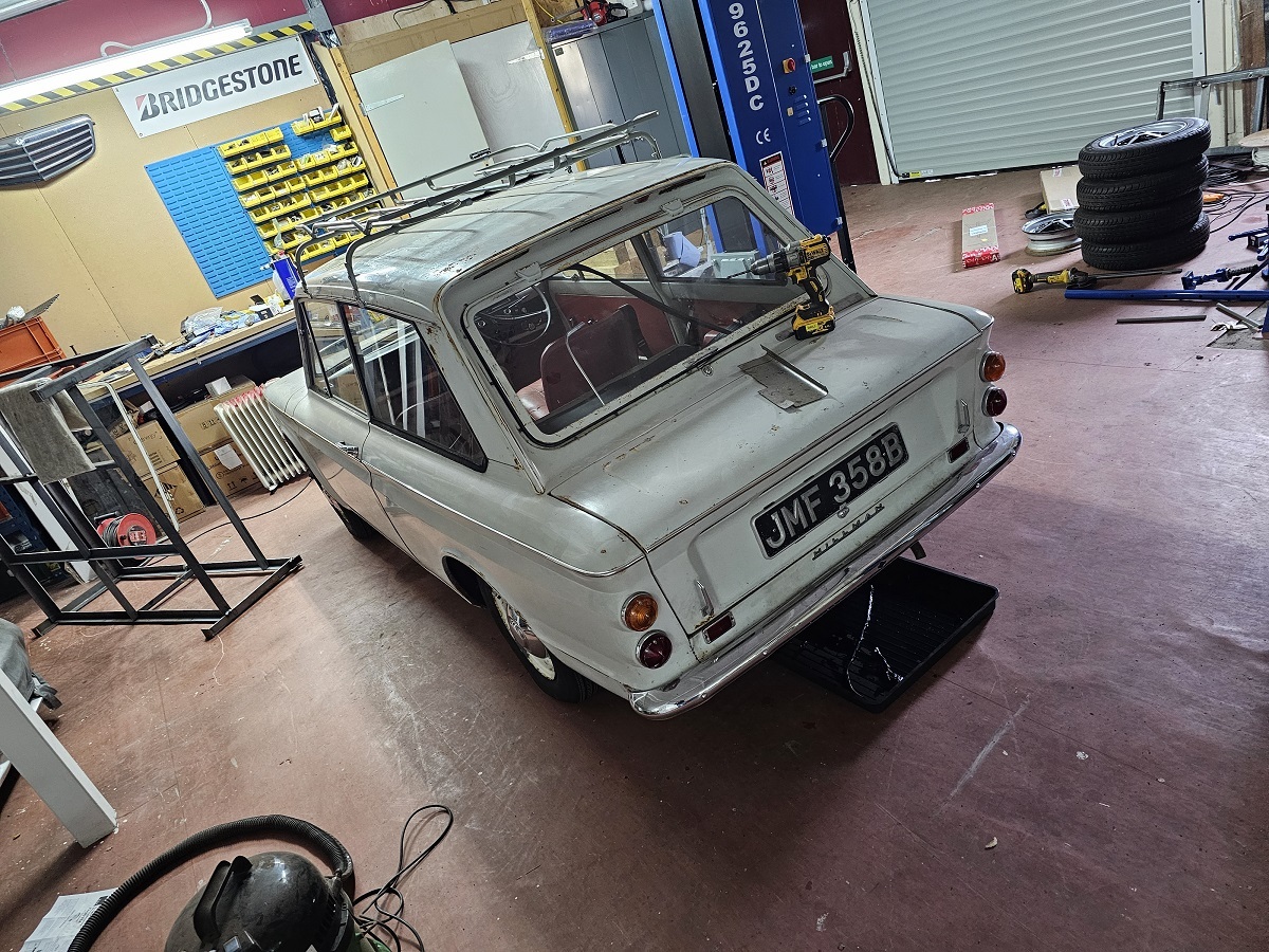

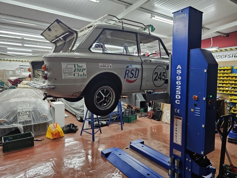

    We bought this car last year and never really paid attention too much as it was running and driving however has a serious fluid loss problem, the drip tray above was well used !

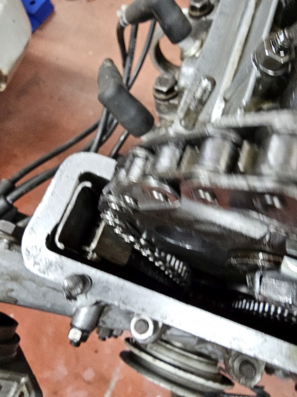

    So out with engine and tear down/rebuild and seal up all the usual spill spots, spotted quite a few things on the way, loctab washer not bent and this little beggar flipped over.
    Was that the end of it no, bad seals on oil drain, filter block, hoses not fixed to unions for the cooler, sump plug washer was done, cam box leaking like a sieve.... and oil down back of flywheel (bolts)

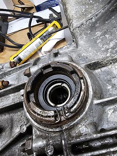

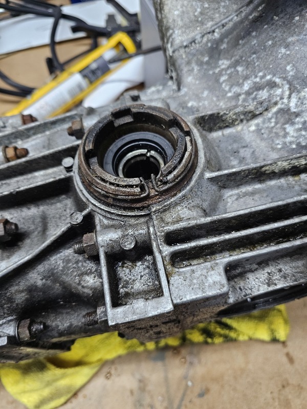

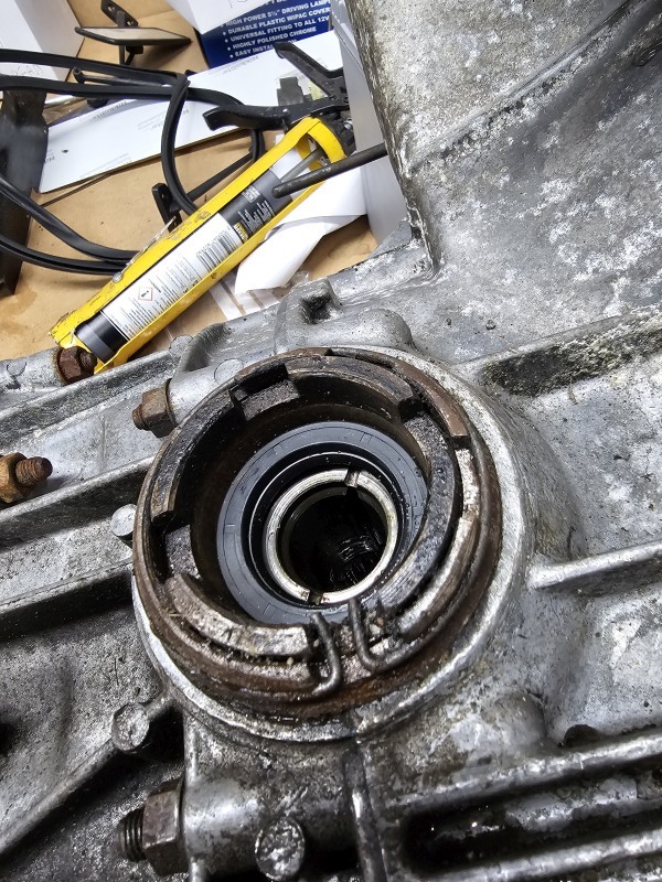

    All that done, time to look at the transaxle which was losing fluid all over
    primary shaft seal, easy fix
    Drive shaft seals were actually new, they had been hammered in so far though they were not wrapped around the shaft and almost on the bearing
    I had 2 seals lef, that was it, we magaed it !

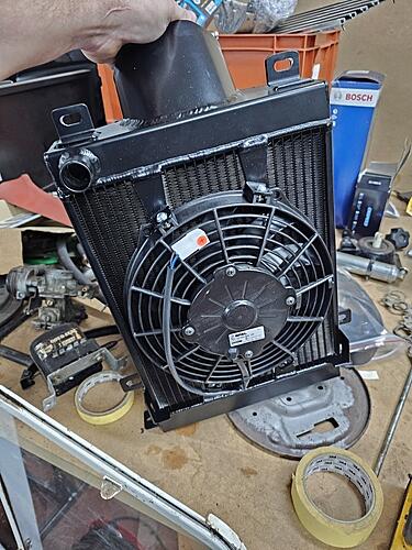

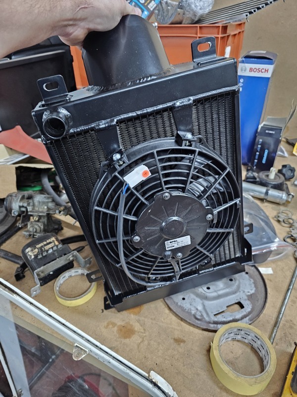

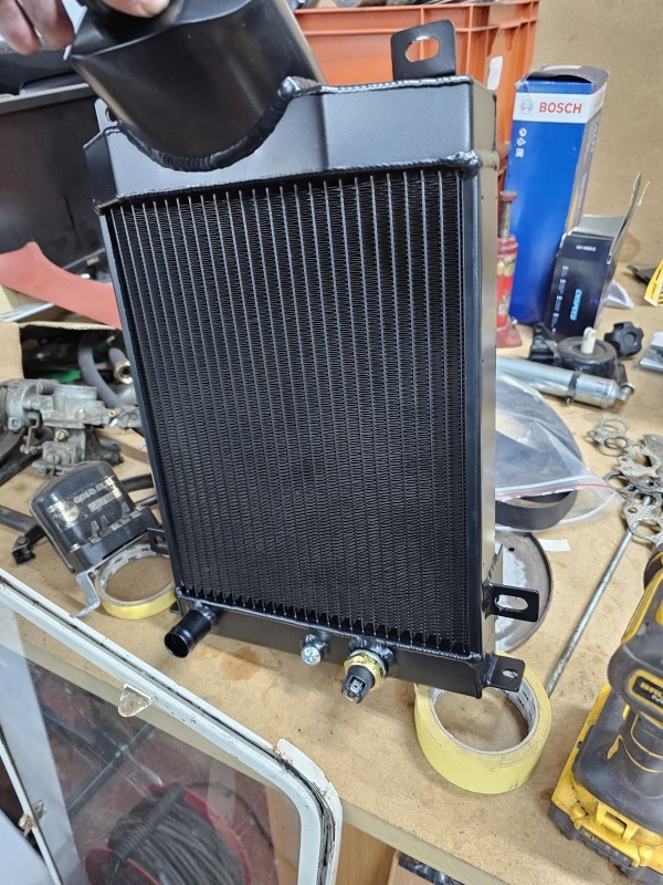

    Then add new Radtec radiator (thanks for the great service Radtec )

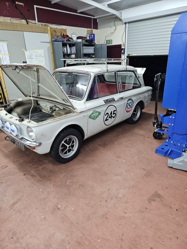

    Add some spors, electric washer, a heater blower as the car has never had one fitted ! put all back together and take a drive.
    No drips as yet, that in itself is very worrying for an Imp

    You won't have any issues with overheating with the Radtec rad and fan - I use the same on my comp 1040 engine with no problems. (As long as you have the fan pulling air in the correct direction of course).
      Thanks Oli
      Not seen any signs of overheating yet at all and thats without the fan and switch
      OliDP72
      I did not get a definitive answer from Darren but does the thermal switch manage the fan current without a relay ??
        Oli
        When fitting the rad I had an issue on the rear cowling as it fouled the rear engine bay closing panel and i had to add spacers to set the radiator position.
        The distance hole to hole on the rad is bigger than a standard one but the mounting tabs seem set from front ocl position rather than rear if that makes sense.
        Thats the rads installed on both cars now
