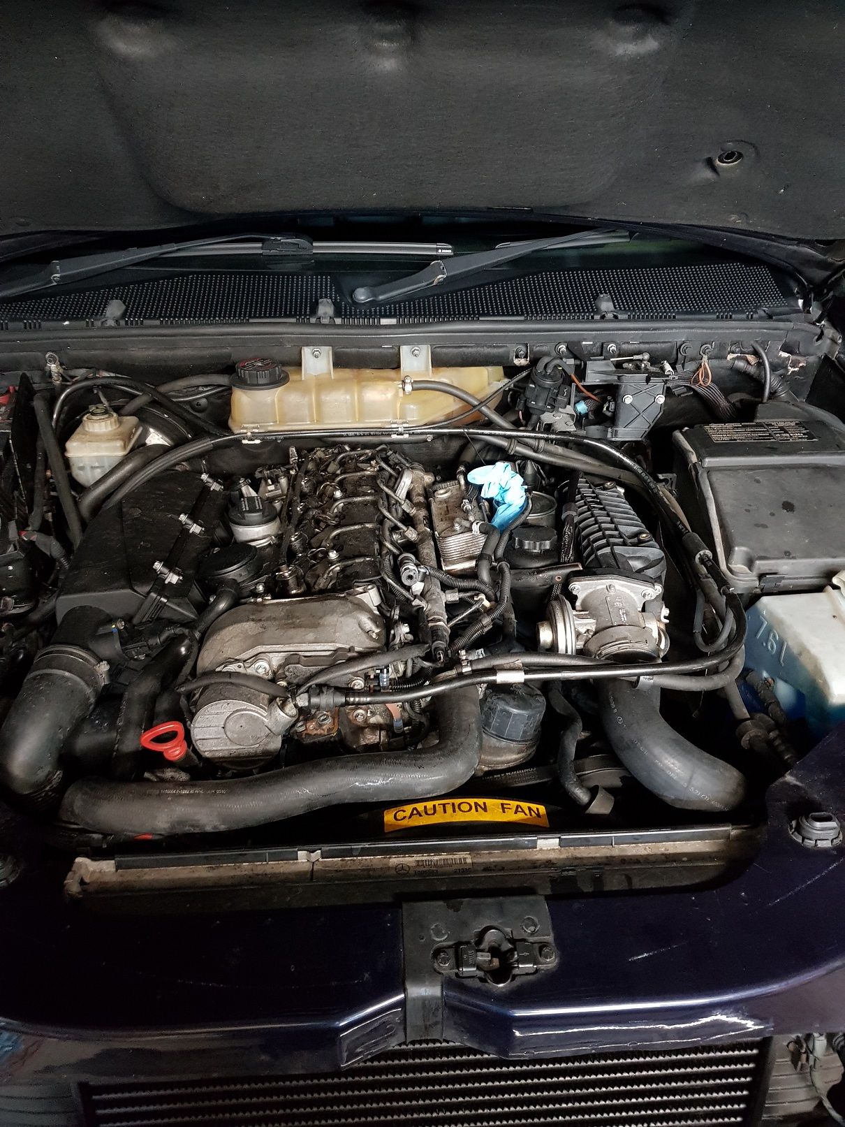

                Injection wise good performance can hinge on a lot of things, good looking but otherwise crap wiring, poor components (specifically Chinese connectors), under-rated wire, crap fuel lines, old fuel lines, crap o ring seals, …… but mostly air.
                I was chasing issues on this today as it did not like starting if parked uphill, yip, really ! which is most inconvienient as my drive is on a slope it would drain the battery before starting (big 95Ah beast)

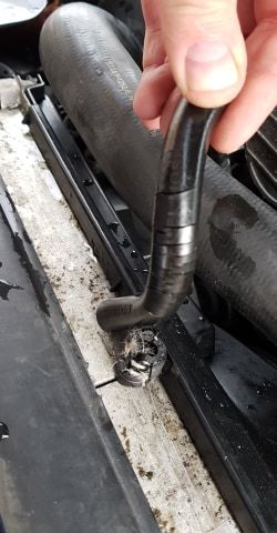

                So a set of new fuel lines plus test port, bunch of O seal rings as a lot of the connectors were push fit, replace rubber fuel lines at filter and repalce filter.
                These 5 cylinder trucks do not have a fuel tank located pump, so the LP pump mounted at the front of the engine has to cuck the fuel up and then to the high pressure pump mounted on the cam then to the fuel rail, any leaks and the fuel drains out and you need to prime the bugger on every crank but the battery will go flat as its sucking air !
                pain pain pain. In principle simples but a pain indeed.
                Click image for larger version  Name:	20200313_204628.jpg Views:	0 Size:	376.8 KB ID:	5087
                The blue glove was where I left off yesterday as I had no hose to use and it was well cracked
                Click image for larger version  Name:	192512_n.jpg Views:	0 Size:	26.5 KB ID:	5088
                Hose obtained today, system primed at engine side with red diesel so i can see it in the clear fuel lines and started then ran till clear fuel.
                All seems OK, have parked it on road up from house on hill to test again tomorow, if it does not start there it will sit for a loooong time
