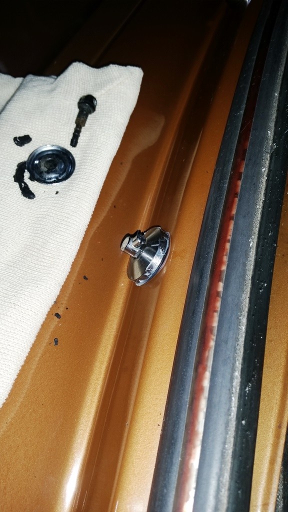

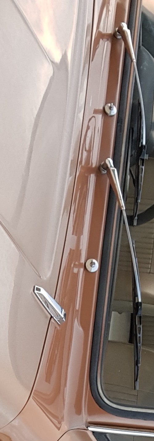

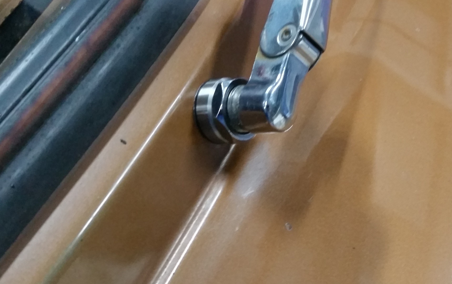

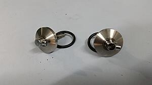

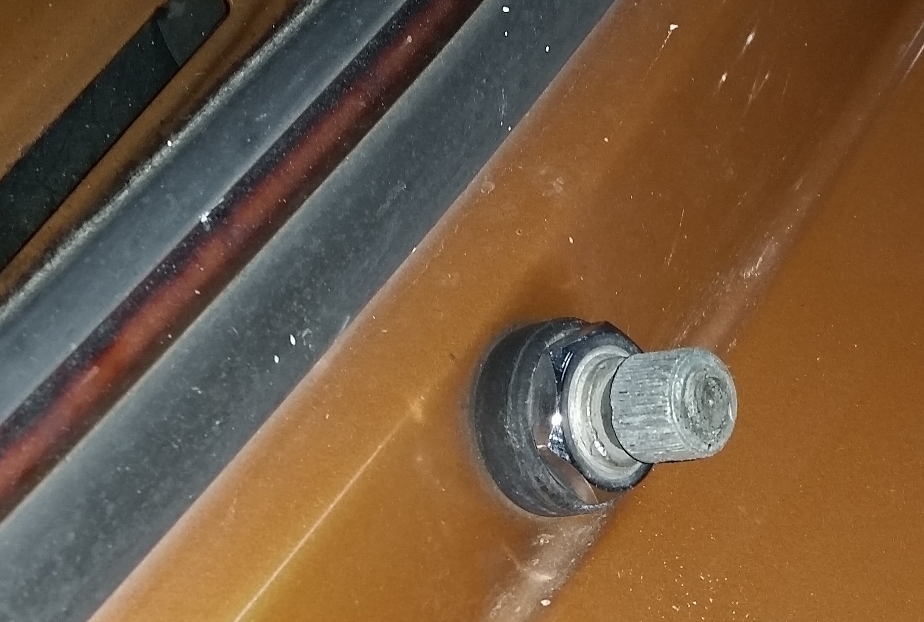

    OK and have I modified Boris, well yes.
    One huge difference was changing the wheelbox seals on the wipers to nice machined stainless and o ring seals, the originals had totally perished.
    See the change
    Crappy disintegrating material to a nice machined stainless seal with o rings from Bob Picton
    Click image for larger version  Name:	PIC-00063.jpg Views:	0 Size:	279.9 KB ID:	959 Click image for larger version  Name:	PIC-00062.jpg Views:	0 Size:	405.8 KB ID:	960

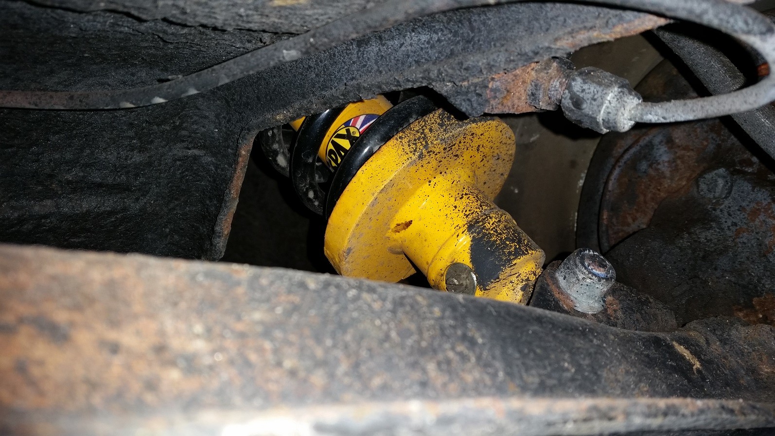

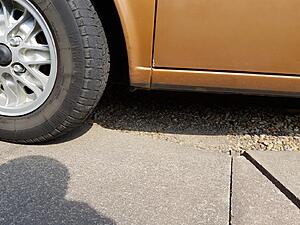

      Boris alwasy handled well, front shocks are actually spax with slightly lower spings, not my doing, car came like that, spax and almost nuetral camber, still on 12" pirelli tyres as well !
      Click image for larger version  Name:	PIC-00100.jpg Views:	0 Size:	415.3 KB ID:	962 Click image for larger version

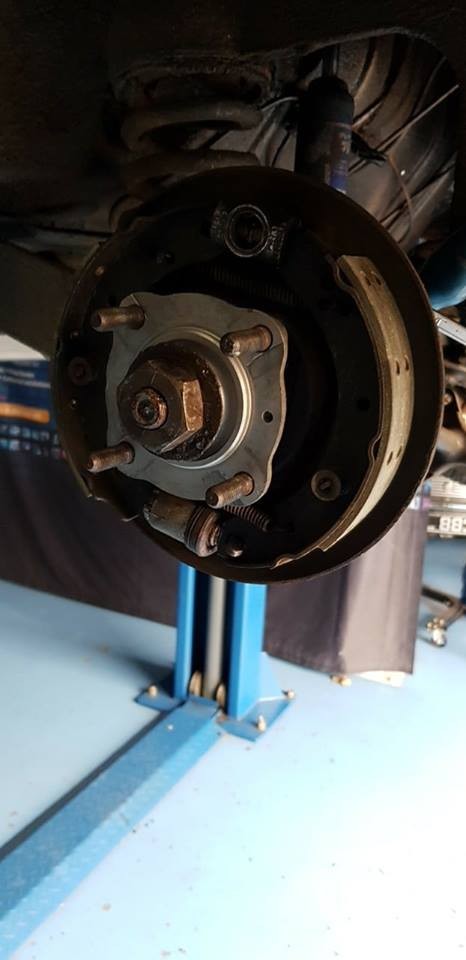

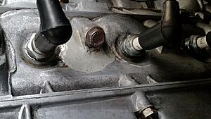

        #18

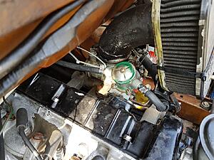

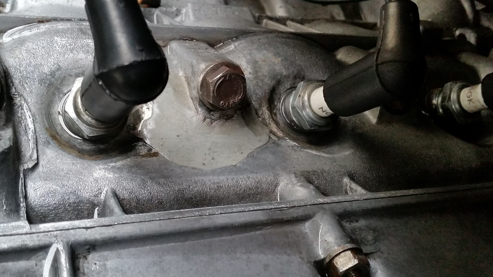

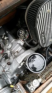

        One small issue I had was acoolant "weep" which was eventually traced to the repaired sport 180 head, in the past it had suffered a crack around the headbolt between cylinder 2 and 3, after 4000 miles of my driving the previous repair was starting to fail.
        So I removed all the previous repair back to the welded section, I must say whoever did it did a fantastic job but filling alloy that has been cast is not easy.
        As technology has came on Loctite/3M have a fantastic compound now which seeps into cast and saves the casting, it is indeed used by several manufacturers in production and you would never know. So the welded section was coated and the compound left no evidence of itself, filled up and ran to temperature (it has a 88 deg stat) and no sign any more of a weep, so the repair was completed with some re-enfoced epoxy (liguid metal like JB weld) and i gave the repair a coating / cap to keep anything else out. Job done, another 1k+ miles and no weep, even with the weep Boris still goes like a train
ID:	964 Click image for larger version

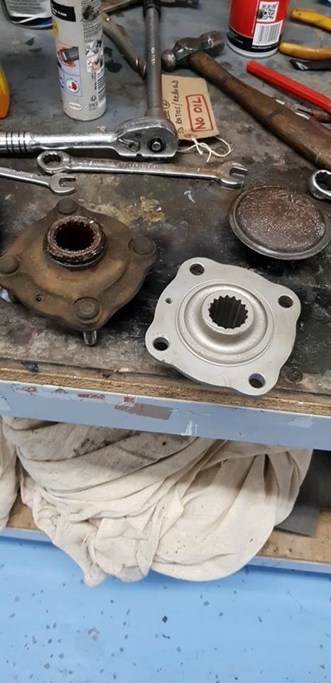

          Click image for larger version  Name:	PIC-00456 - Copy.jpg Views:	0 Size:	142.0 KB ID:	969 And Bob pictons nect project the washer jets, again a crappy but effective solution by rootes but it does not stand test of time. Disintegrated.
          New stainless replacements worked a treat, and the finished look with wheel boxes and washer jets replaced
          Click image for larger version  Name:	PIC-00428 - Copy.jpg Views:	0 Size:	134.8 KB ID:	970 Click image for larger version

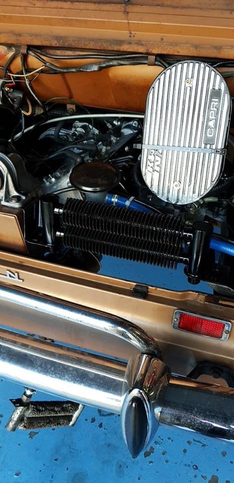

            #20

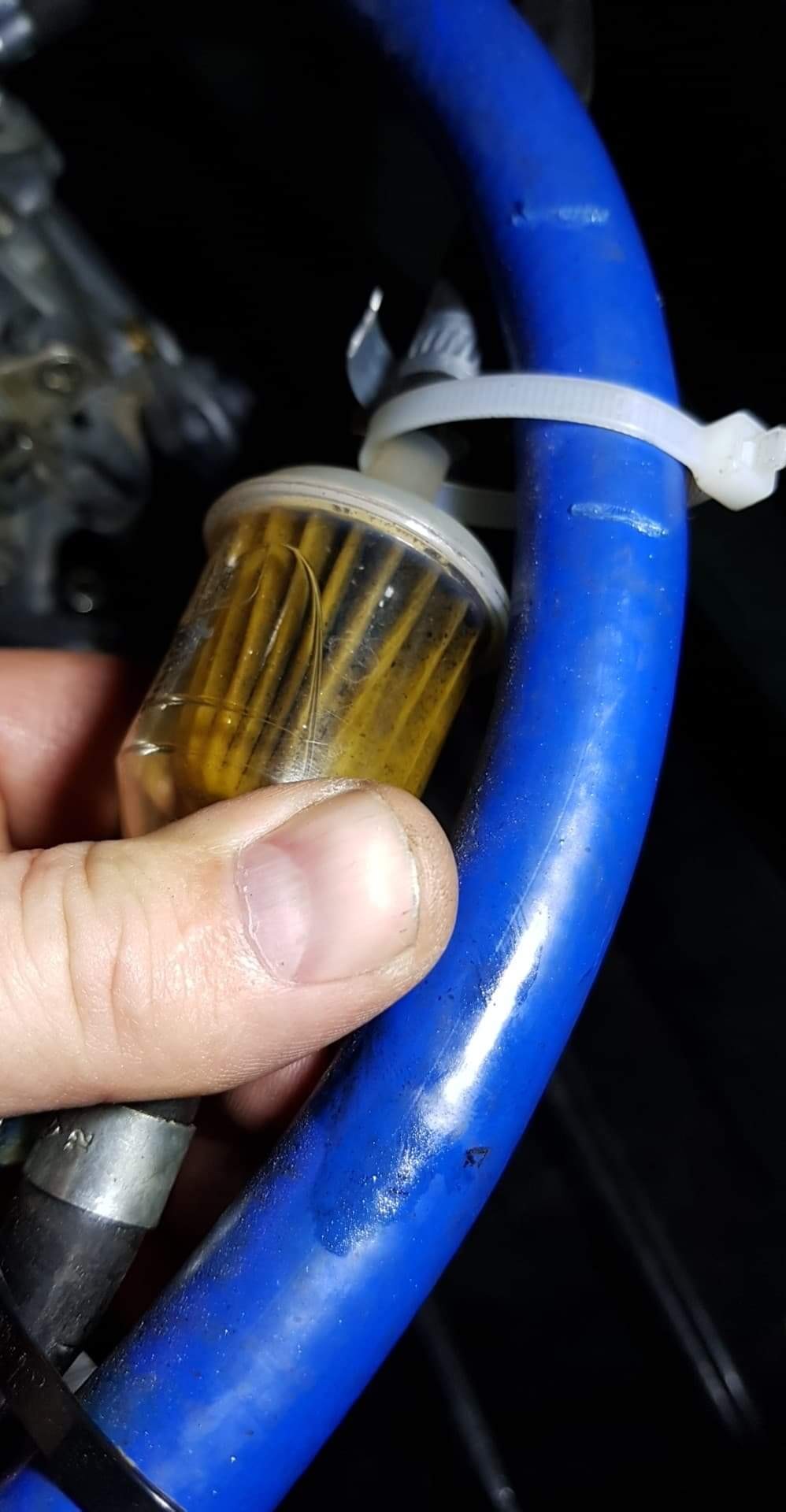

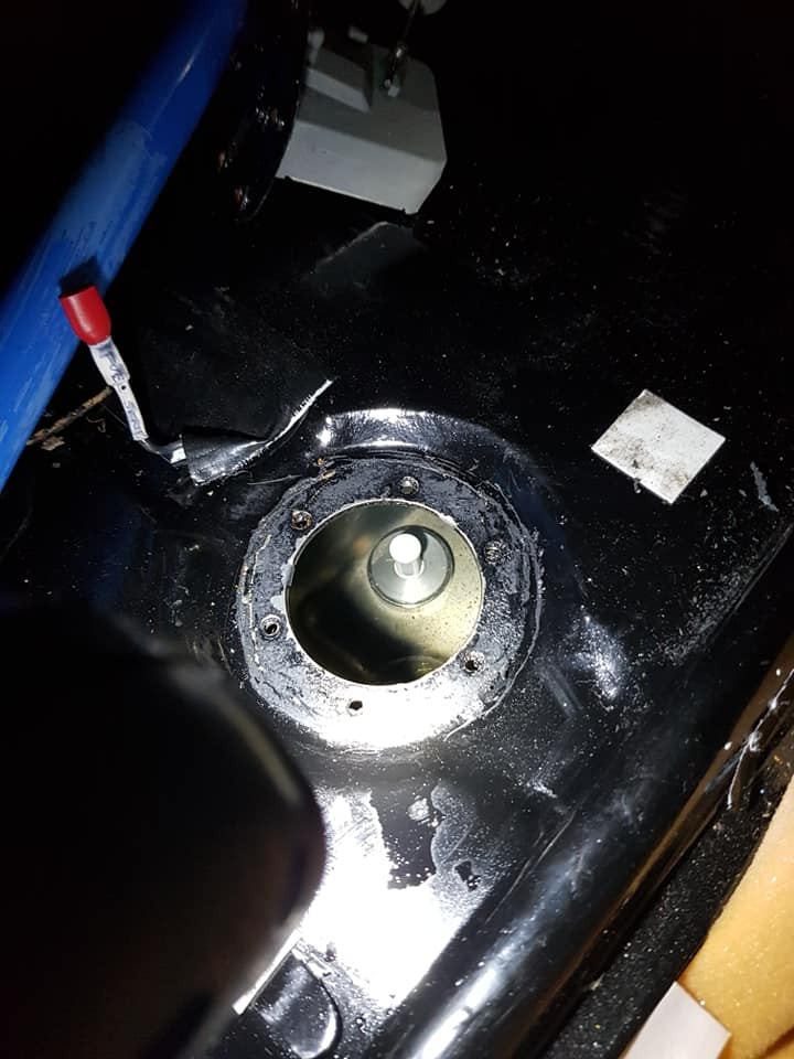

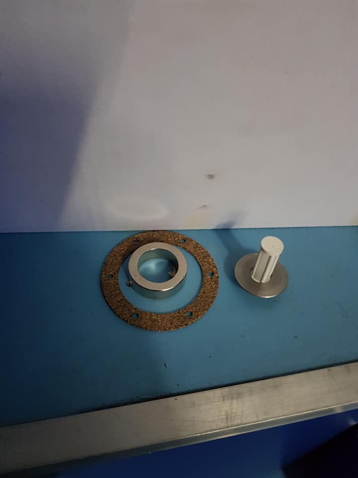

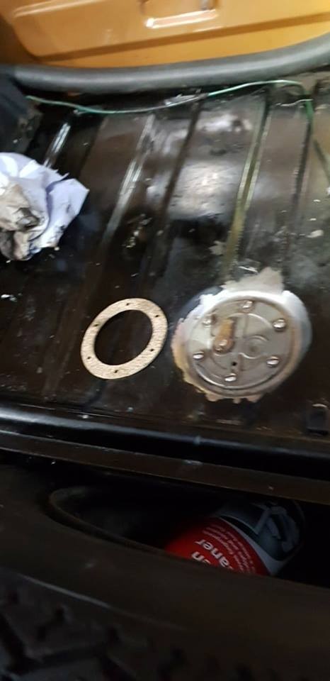

            And now for another Imp problem, common, sorted out with another mod from Mr Bob Picton
            The fuel grot !!!!
            Click image for larger version  Name:	PIC-00453.jpeg Views:	0 Size:	155.8 KB ID:	974 Click image for larger version  Name:	image_562.jpg Views:	3 Size:	1.88 MB ID:	975
            Even with this, it can still sit in the fuel line needing a blow back
            Eventually some does get through to here, best solution is it not to leave the tank !
            So Bob Pictons machined stainless skills to the rescue with a massy in tank filter, out with the sender, blocw back the fuel lines, fit filter over fuel pipe exit, deed done. Peter Nunney started this one off with the tea strainer idea !
            Click image for larger version  Name:	PIC-00405.jpg Views:	0 Size:	56.4 KB ID:	972 Click image for larger version  Name:	PIC-00452.jpg Views:	0 Size:	103.0 KB ID:	976 Click image for larger version
            Sealed back up, deed done

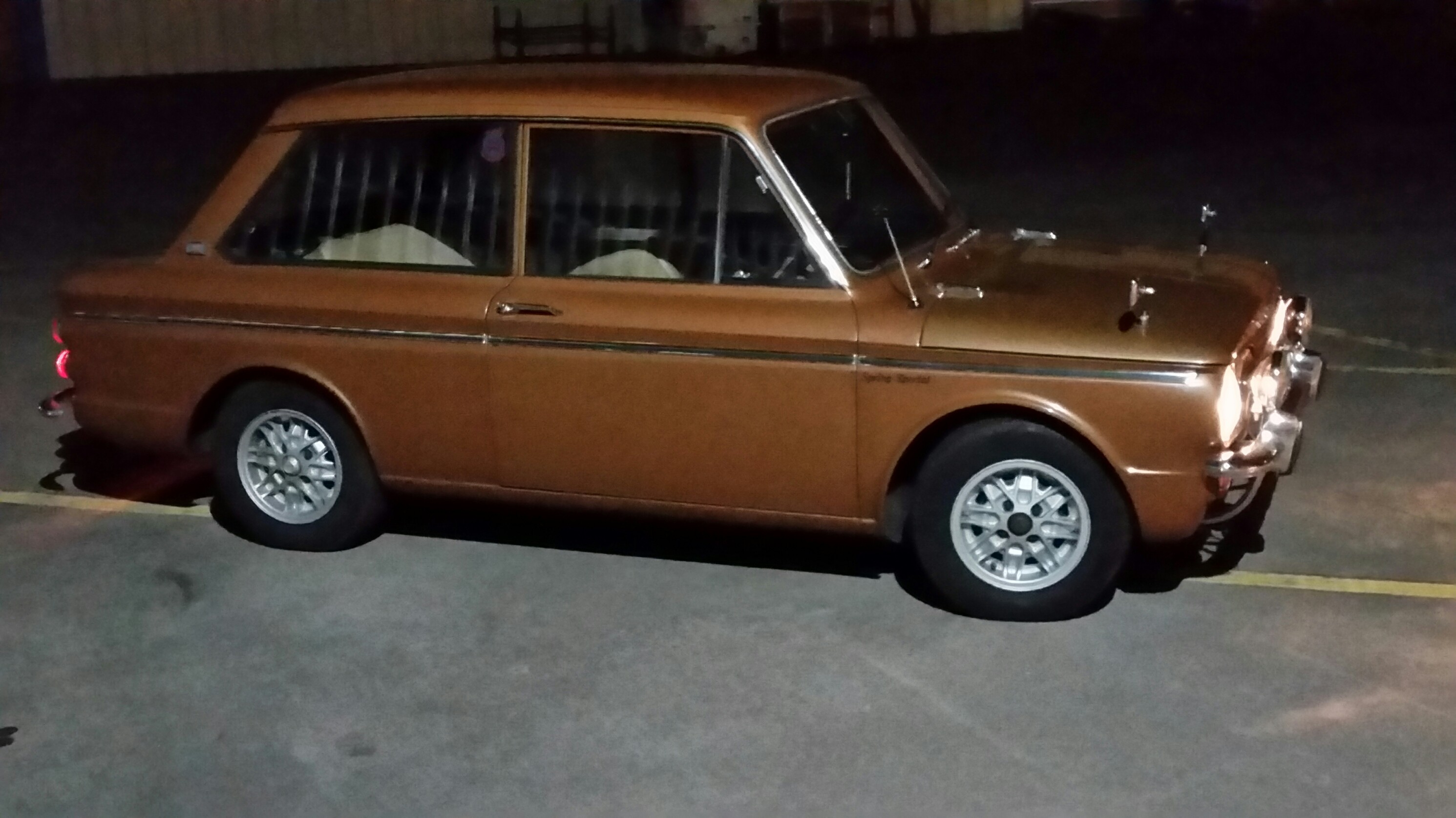

              #21

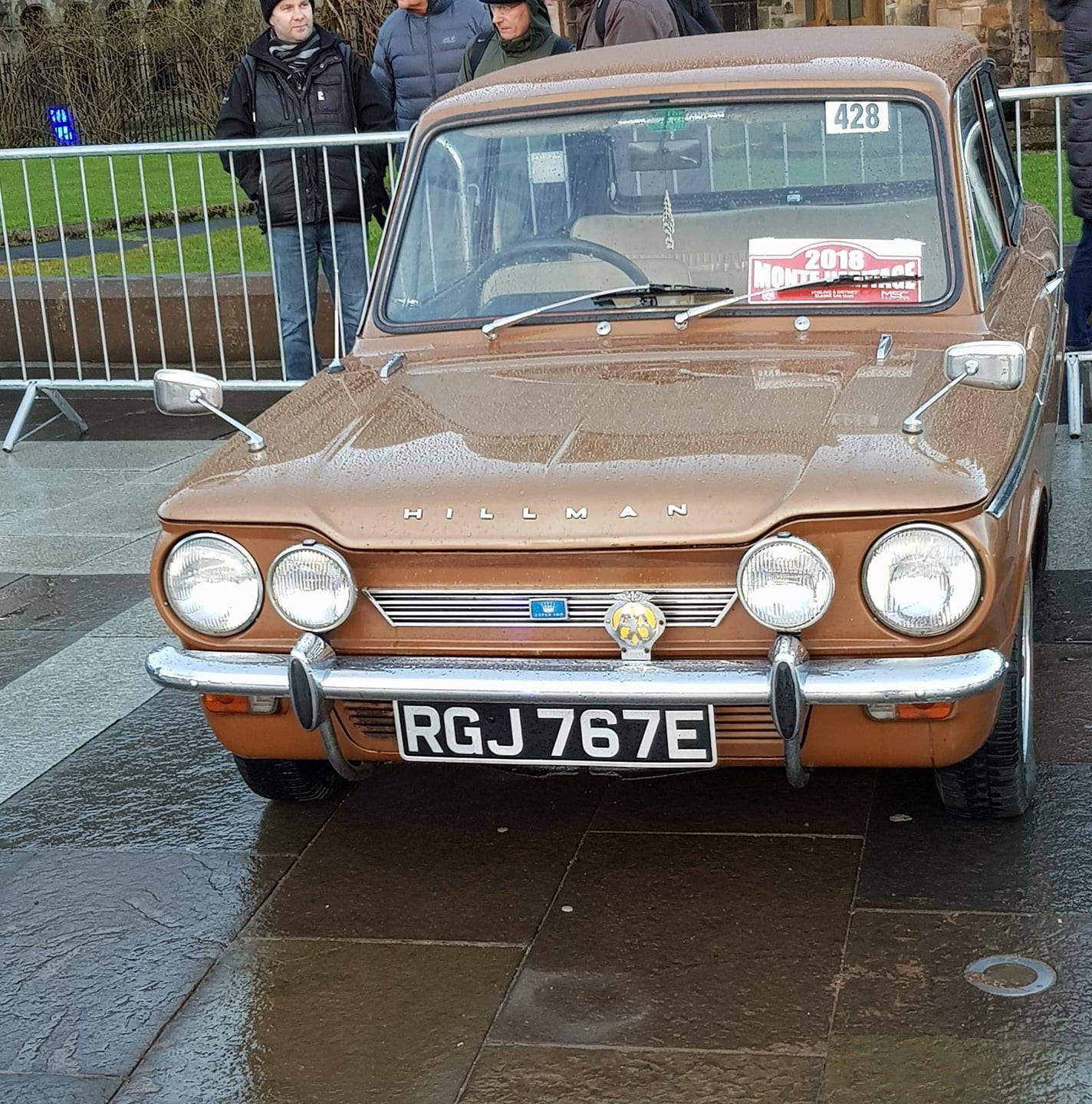

              And with those repairs done Boris is off again, this time a bit of night time driving and a quick photo op on the esplanade of Stirling Castle with a visit to the coast first with helen and Hayley

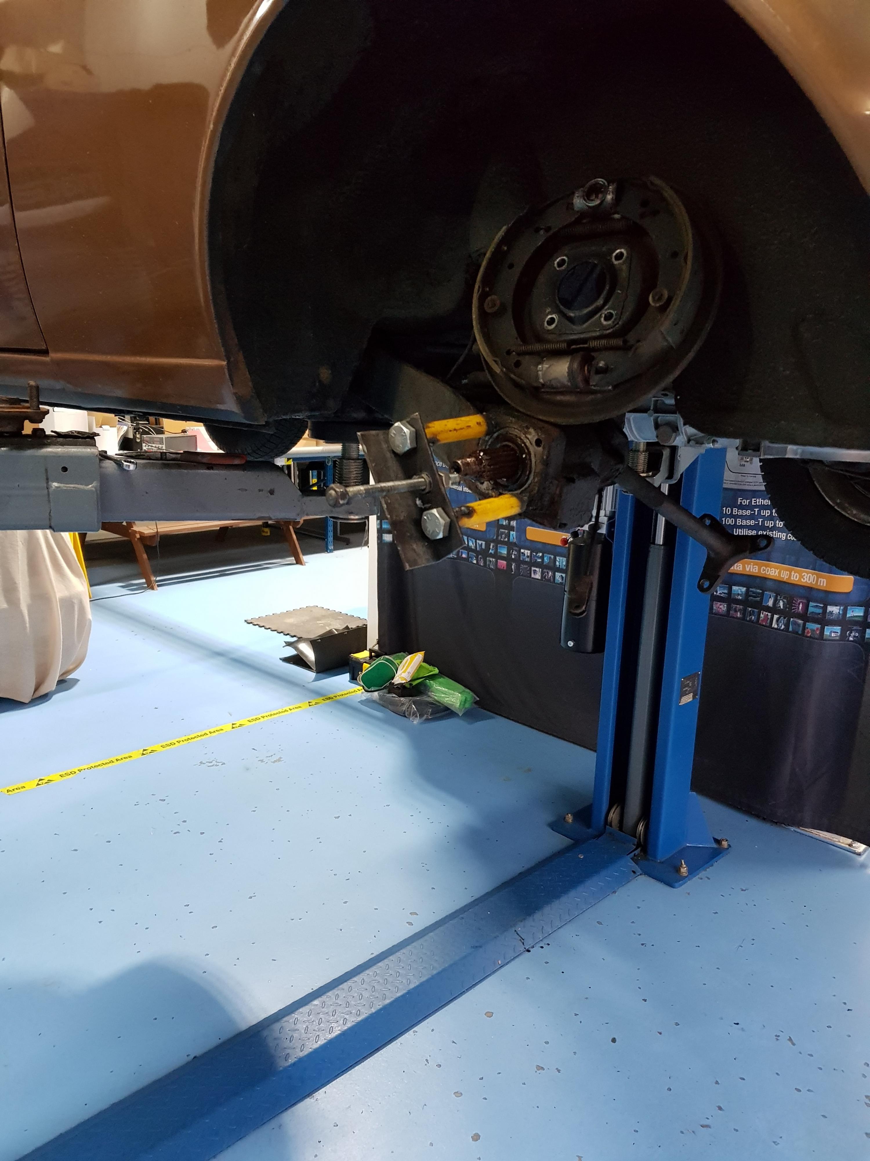

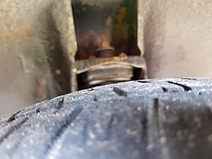

                  But of course on any journey in a 50+ year old car the miles do take its toll, on prep for the Monte start one year I found a buggered bearing on the rear hub, so a new bearing was fitted from a "reputable source" and looked OK but the bearing was in fact too small ! When i looked up the spec it was metric !!!!
                  So I fitted another bearing and hey presto it was happy again.
                  Deed done in less than an hour.

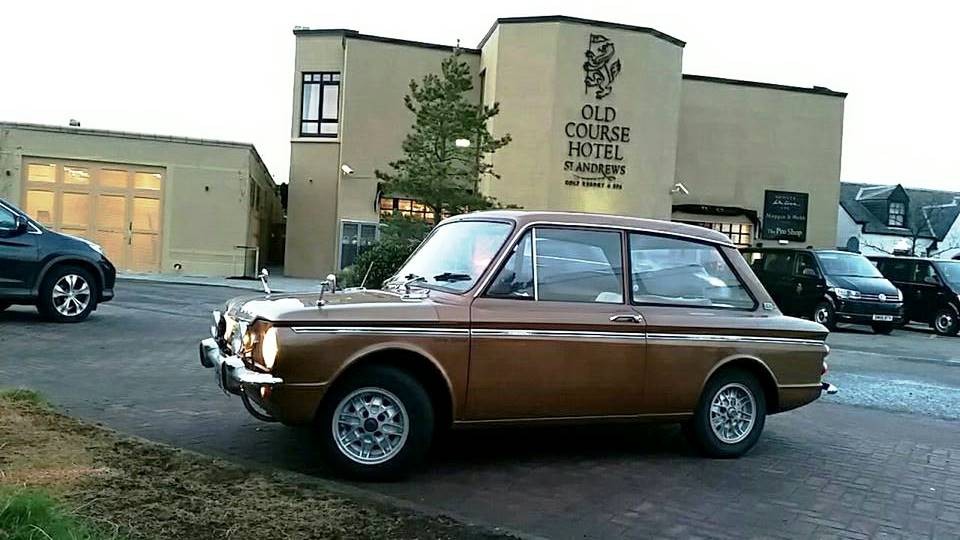

                    And what about snow you ask, well he has no fear, snow or not he will be out and about, nothing a good hose down wont fix when back home
                    Click image for larger version  Name:	PIC-00208.jpg Views:	0 Size:	160.1 KB ID:	1001
                    From Cumbernauld, to Paisley
                    Click image for larger version  Name:	PIC-00404.jpg Views:	0 Size:	536.8 KB ID:	1003 Click image for larger version  Name:	image_581.jpg Views:	3 Size:	1.46 MB ID:	1005
                    To St Andrews (not exactly around corner from paisley !!
                    Click image for larger version  Name:	PIC-00246.jpg Views:	0 Size:	900.8 KB ID:	1004 Click image for larger version  Name:	PIC-00402.jpg Views:	0 Size:	111.6 KB ID:	1002
                    Click image for larger version  Name:	PIC-00217.jpg Views:	0 Size:	919.5 KB ID:	1006 Click image for larger version  Name:	PIC-00175.jpg Views:	0 Size:	3.24 MB ID:	1008
                    Click image for larger version  Name:	PIC-00342.jpg Views:	0 Size:	4.11 MB ID:	1007

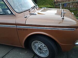

                      #25

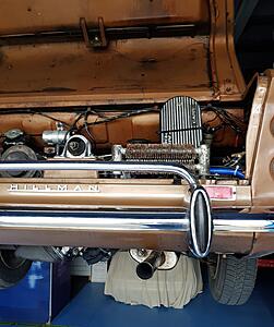

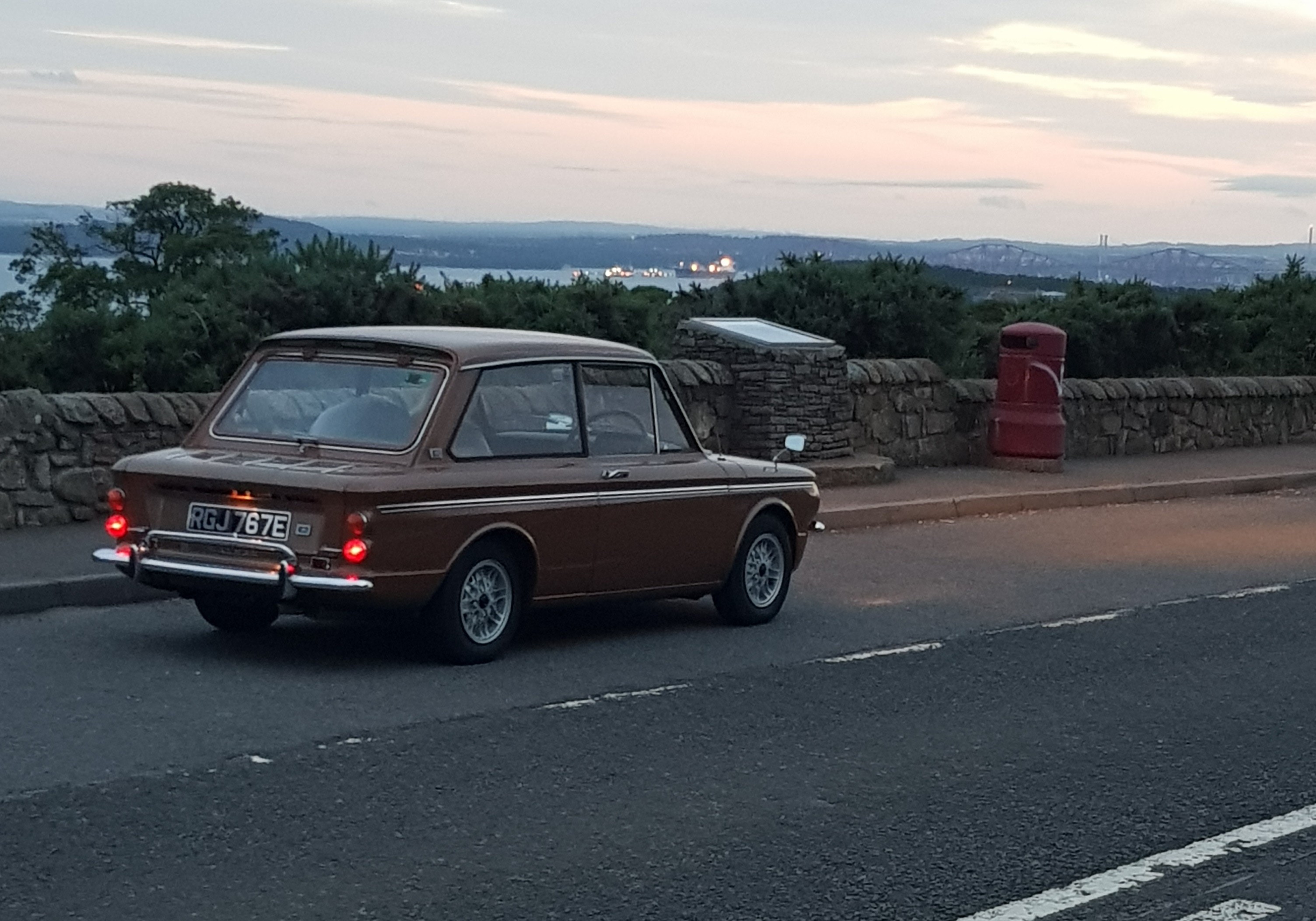

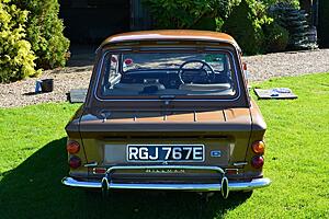

                      So how has Boris faired over the years, well here is a view from top side
ID:	1012 Click image for larger version
ID:	1013 Click image for larger version

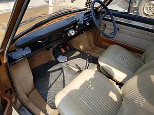

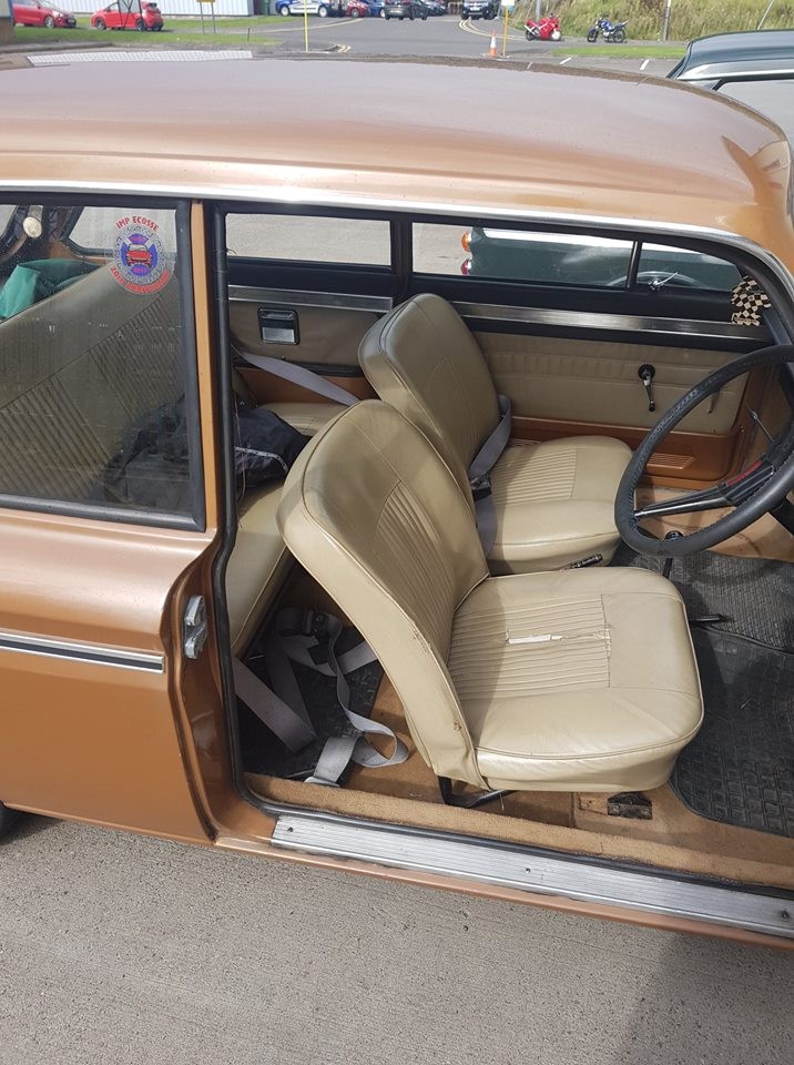

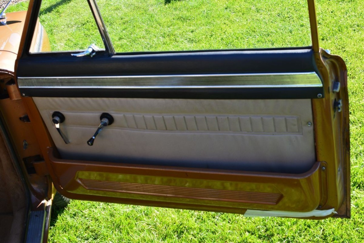

                        And after top side we have inside !
                        Click image for larger version  Name:	PIC-00320.jpg Views:	0 Size:	1.83 MB ID:	1023 Click image for larger version  Name:	PIC-00319.jpg Views:	0 Size:	2.67 MB ID:	1024
                        Click image for larger version  Name:	PIC-00286.jpg Views:	0 Size:	1.81 MB ID:	1025 Click image for larger version  Name:	PIC-00345.jpg Views:	0 Size:	2.03 MB ID:	1026
                        Click image for larger version  Name:	PIC-00438.jpg Views:	0 Size:	190.2 KB ID:	1027 Click image for larger version  Name:	PIC-00318.jpg Views:	0 Size:	2.75 MB ID:	1028
                        Click image for larger version  Name:	PIC-00426.jpg Views:	0 Size:	181.6 KB ID:	1029 Click image for larger version  Name:	PIC-00347.jpg Views:	0 Size:	2.15 MB ID:	1030
                        Click image for larger version  Name:	PIC-00348.jpg Views:	0 Size:	1.60 MB ID:	1031 Click image for larger version  Name:	PIC-00349.jpg Views:	0 Size:	2.43 MB ID:	1032
                          #27

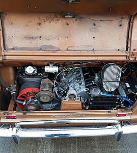

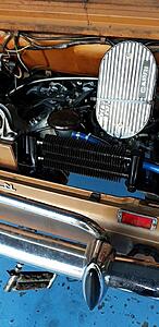

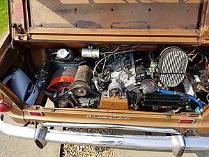

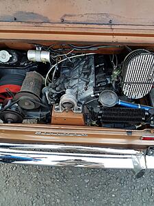

                          Engine wise he has never gave much trouble except the odd occassion on fuel starvation which ended up being a duff non return valve in the fuel pump and a clogged filter
                          All good after adding Bobs Filter and cleaning out the lines (the new fuel pump, or parts of anyway helped also Cheers Kevin !!! )
                          Click image for larger version  Name:	PIC-00408.jpg Views:	0 Size:	116.6 KB ID:	1034 Click image for larger version  Name:	PIC-00224.jpg Views:	0 Size:	1.97 MB ID:	1035
                          Click image for larger version  Name:	PIC-00317.jpg Views:	0 Size:	2.55 MB ID:	1037Click image for larger version  Name:	PIC-00378.jpg Views:	0 Size:	2.46 MB ID:	1036
                          Click image for larger version  Name:	PIC-09652.jpg Views:	0 Size:	2.61 MB ID:	1038 Click image for larger version  Name:	PIC-00351.jpg Views:	0 Size:	2.60 MB ID:	1039
                          Click image for larger version  Name:	PIC-00153.jpg Views:	0 Size:	2.51 MB ID:	1040

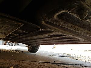

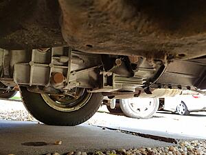

                                #30

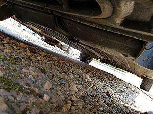

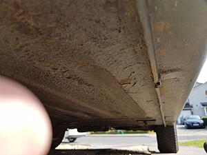

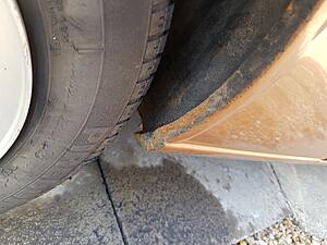

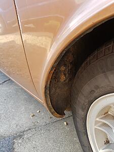

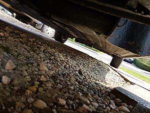

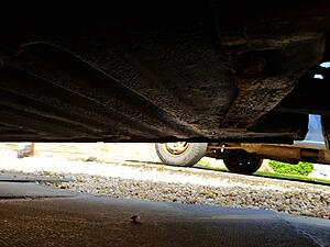

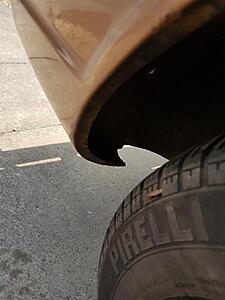

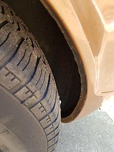

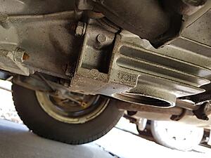

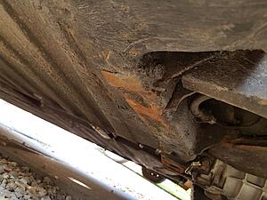

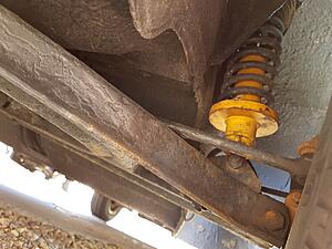

                                And how has Boris fared, most of all UNDER NEATH !
                                He is starting to suffer a little but still well sound and no leaks. Except the back window, it has a drip now and aagain just never had time to catch it, the back windows leak is one of the mysteries of the imp !
ID:	1048 Click image for larger version
ID:	1050 Click image for larger version
ID:	1052 Click image for larger version
ID:	1054 Click image for larger version
ID:	1056 Click image for larger version
                                He has fared wuite well, non of the usual rust spots and if your eagle eyed enough the Dave Weedon serial number on the reconditioned transaxle can be seen and the gear linkage refurb is a few posts up
