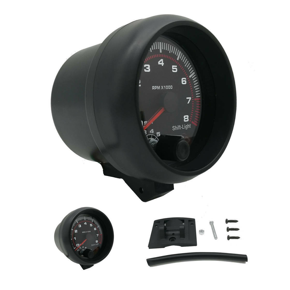

    Well I have bene hunting high and low for a nice Smiths tacho as was fitted to the car originally (1k rpm 80mm or so) but prices are way too high.
    So fitted a nice £15 one which will do for now. Going to modify it a little inside later to add a beep sound when the limit is triggered just well, as I can
    EXAMPLE CHEAPO TACHOMETER ON EBAY

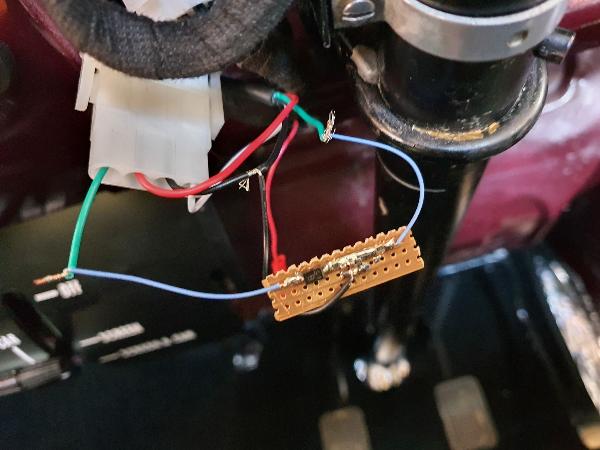

    Only thing is these are modrn servo based instruments and the input filtering is worth about two rows of horse dung and thats doing them a favour !
    The spikes from Imp ignition are simply too much and the tacho display resembles a performers feet doing the river dance more than a meter
    So magnifier out and small filter made up, yes there really is 6 parts on there !
    Nice stable gauge, sorted
