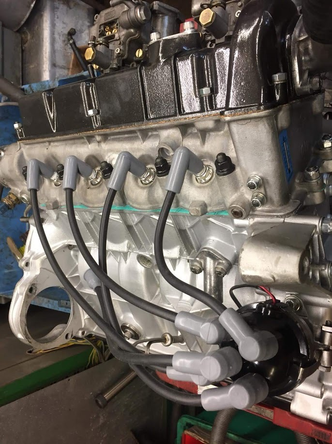

    So I had a coil and condenser that worked, I have had points re-made with 32 oz spring and proper high quality plastic heels, good quality contact material and reliable spring material. In the end I settled for the 43D distributor as you can buy a side exit cap that bolts on so this solved the movement problems and allowed for neat plug lead installation.
    To fit the above you need to build the engine with number one plug firing in the correct position this is achieved when distributor and oil pump drive are matched, so not any easy task to do on your car that is running and on the road now. It needs to be set up with number one plug being top right as you look into the engine bay this means number 3 lead is below and can run parallel with number 4 and number 2 is on the top left parallel to number one. All neat, tidy and short.
