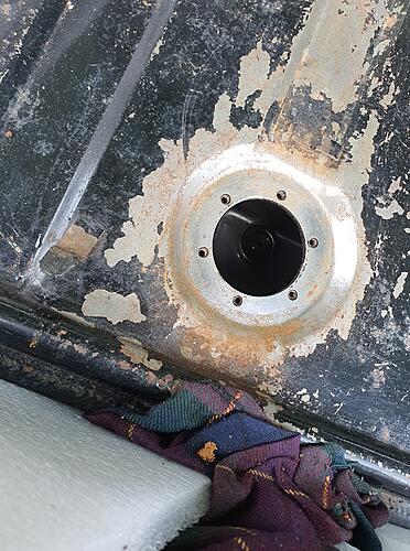

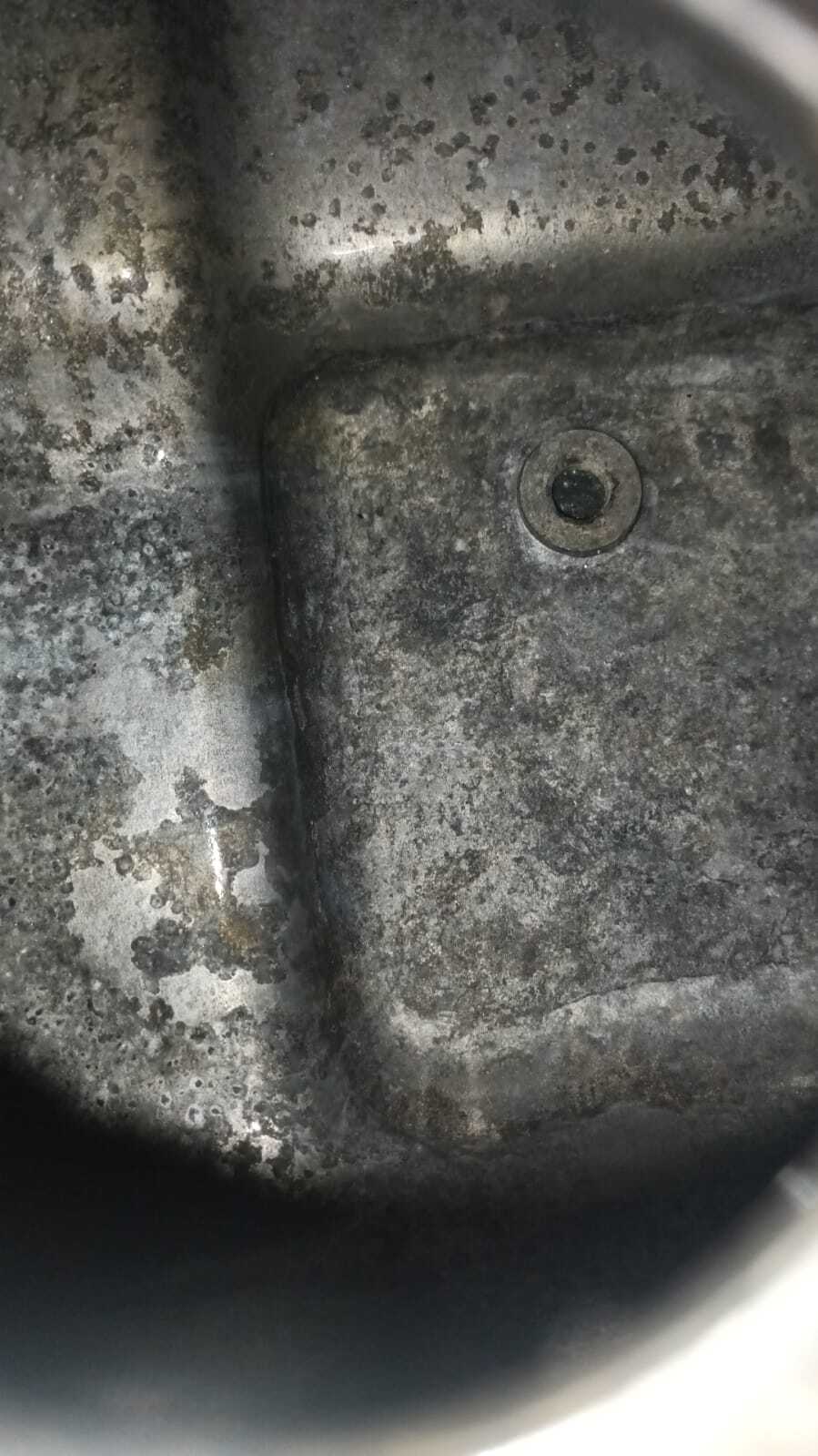

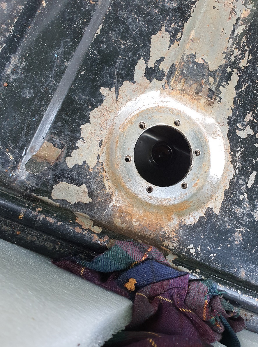

not bad for a 60 year old fuel tank
    And not bad for a 60 year old fuel tank
    This has been power / steam washed then kindly dipped in the acid tank care of Scott Clements who uses it for all sorts.
    A bit of zinc phospate and sealer when it comes back and we will be all sorted
