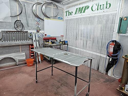

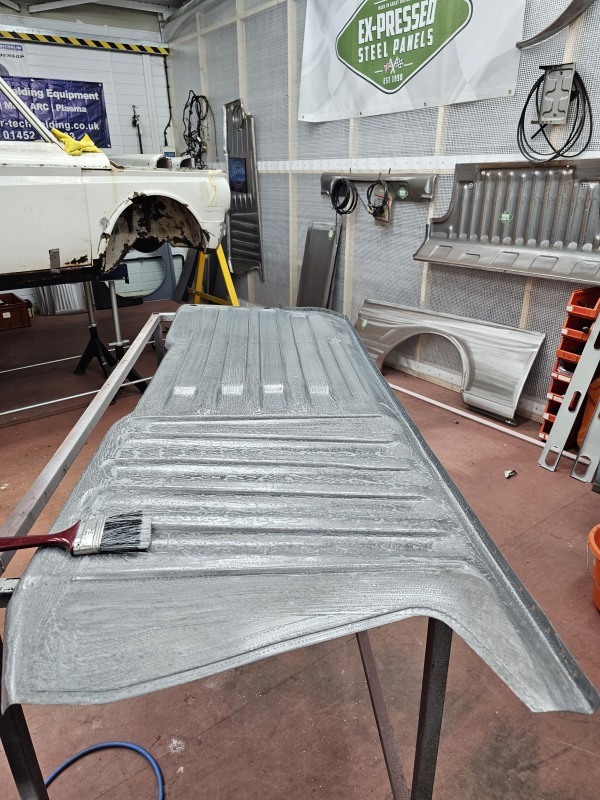

    Prep wise here are a few static images, why do I add this stage, well these panels have been in bare metal and were shwoing signs of surface rust and every little rusty spider growth under your expensive shiny paint could be bad prep

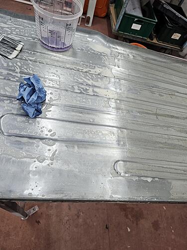

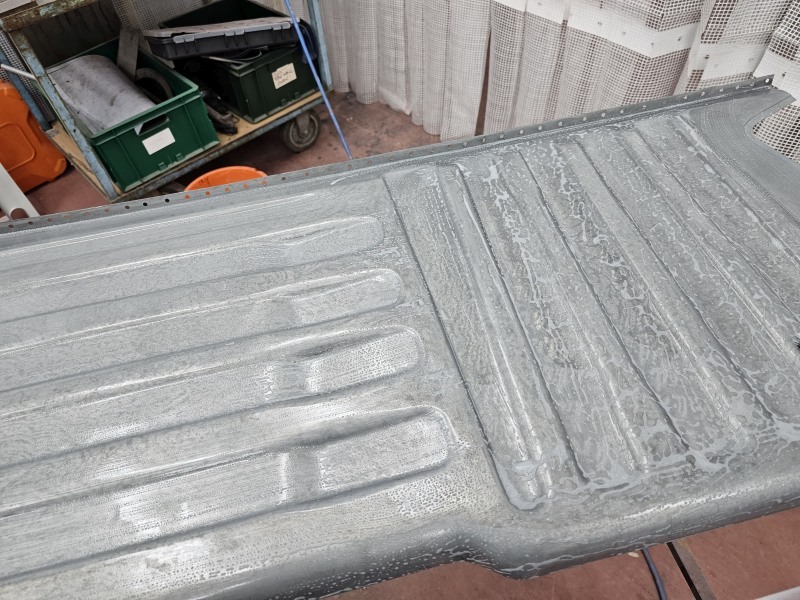

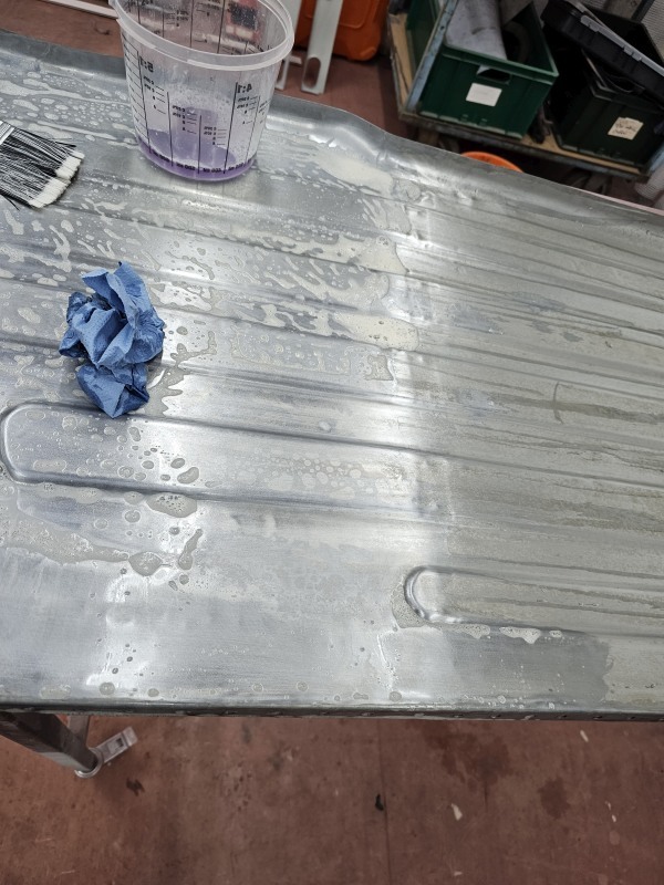

    Takes about 10-15 minutes to brush the solution in as it is weak and you need to keep it wet for it to work, so brush in then just keep repeating for 10 minutes then leave 10 minutes, agitate if its going dry.

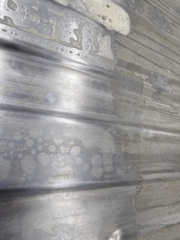

    If you wonder what difference it makes see below, the part I just brushed it in on left of image, significantly cleaner than whats left

    In the end its only clean as its not had time to work yet, shiny is ship, well not good anyway

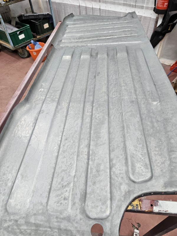

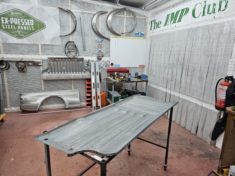

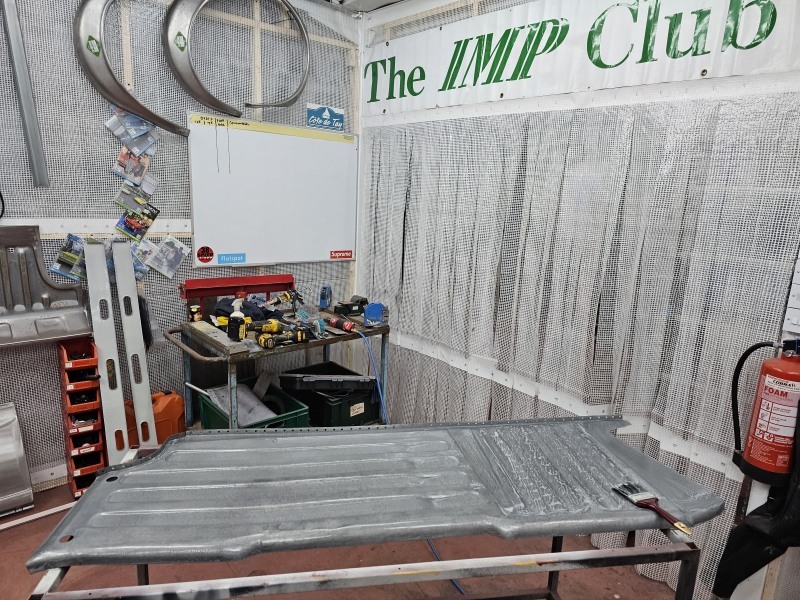

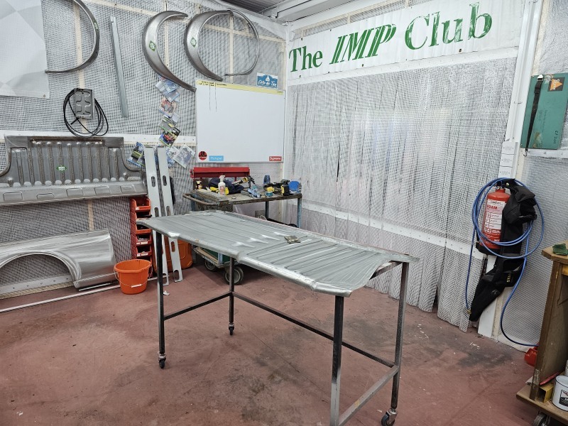

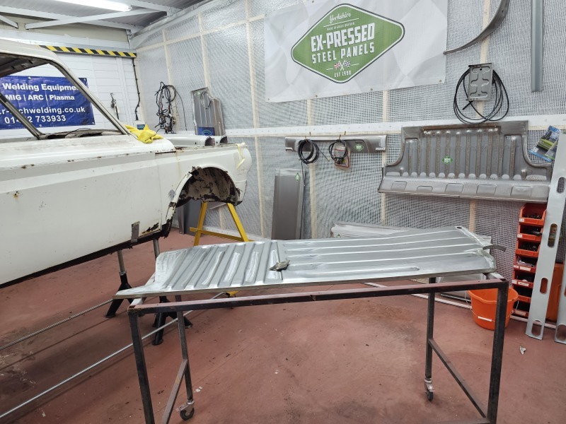

    Finally after it has had time to work and I have rinsed it off with some water it will settle a dull zinc sort of grey, the emtal is protected enough for a few days from flash rust, more if its not stored in a humid place.
    Well thats it ready for epoxy and some colour
