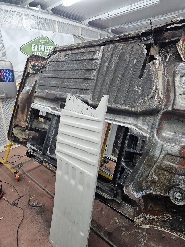

Fitting the floor pans from expressed steel panels
    • 4881

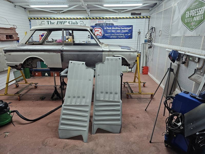

    Life is so much easier when the panels fit

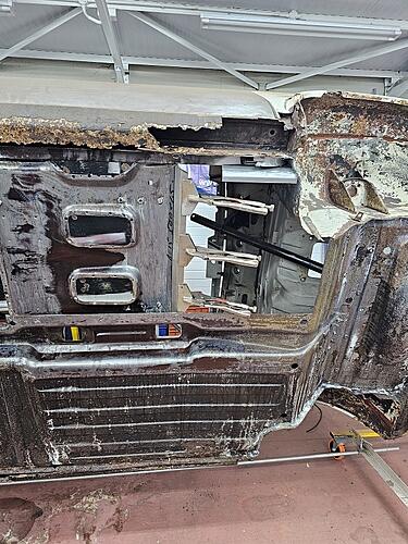

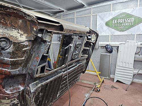

    These panels fit so well. But all the time is in prep.
    Click image for larger version  Name:	20230801_171635.jpg Size:	8.0 KB ID:	22600 Click image for larger version  Name:	20230801_194614.jpg Size:	7.4 KB ID:	22601
    Click image for larger version  Name:	20230801_171655.jpg Size:	8.2 KB ID:	22602 Click image for larger version  Name:	20230801_194600.jpg Size:	8.7 KB ID:	22603
    Click image for larger version  Name:	20230801_194610.jpg Size:	8.6 KB ID:	22604 Click image for larger version  Name:	20230801_202745.jpg Size:	8.6 KB ID:	22605
    Click image for larger version  Name:	20230801_202749.jpg Size:	7.3 KB ID:	22606 Click image for larger version  Name:	20230801_195536.jpg Size:	7.0 KB ID:	22608
    Click image for larger version  Name:	20230801_194600.jpg Size:	8.7 KB ID:	22610 Click image for larger version  Name:	20230801_195527.jpg Size:	5.9 KB ID:	22607

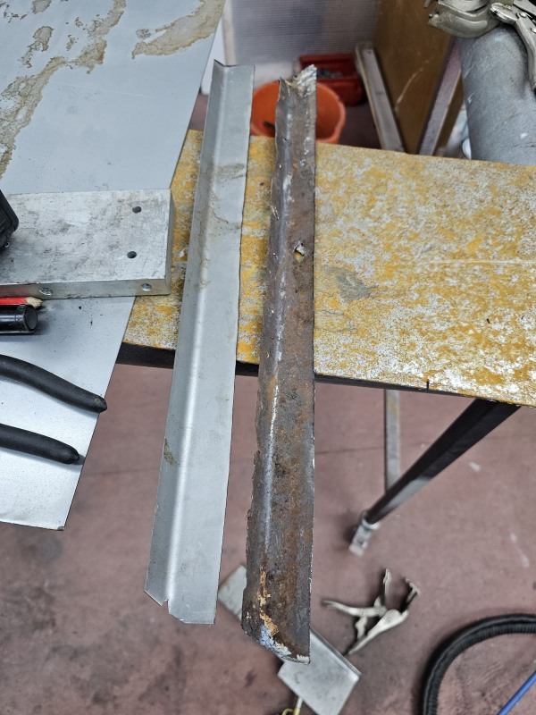

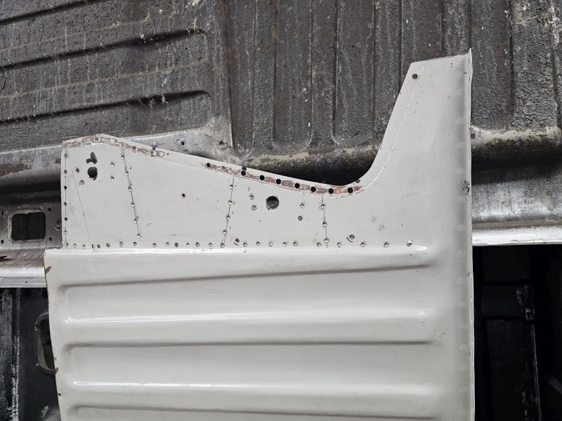

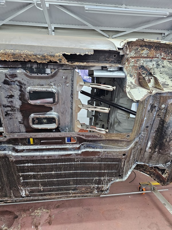

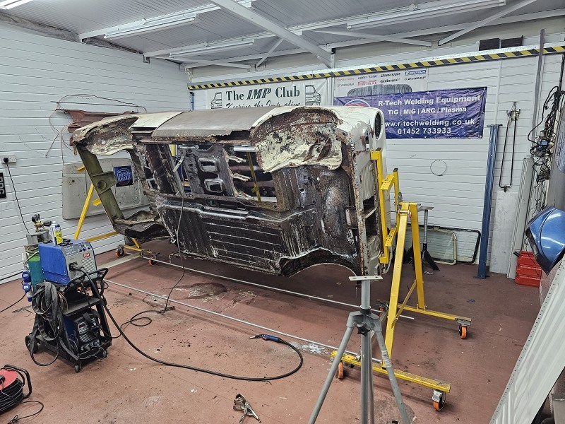

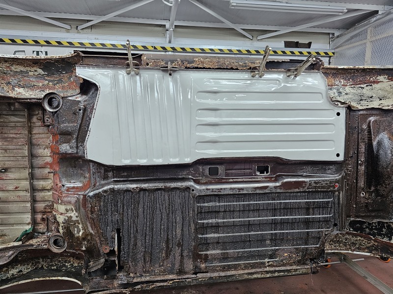

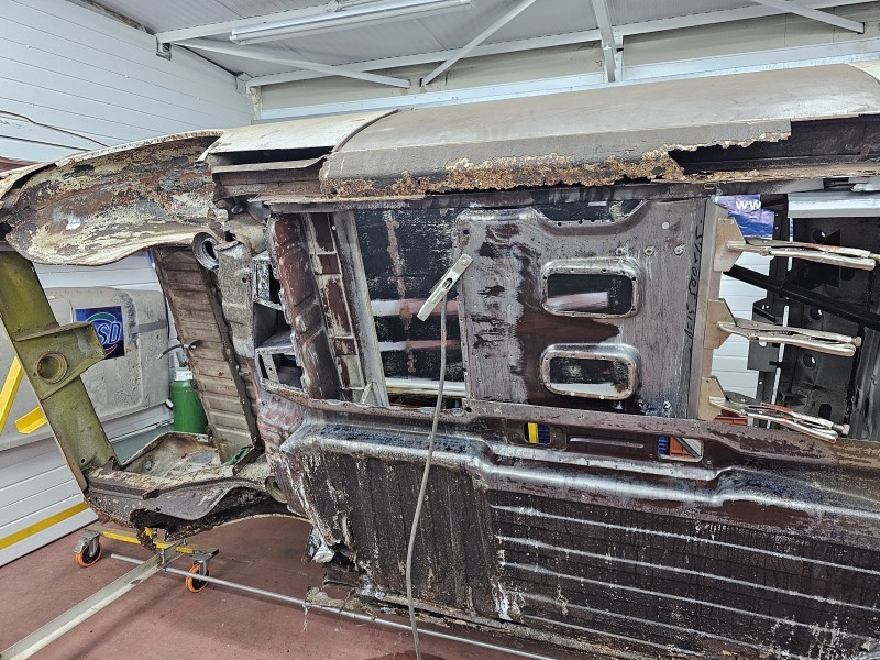

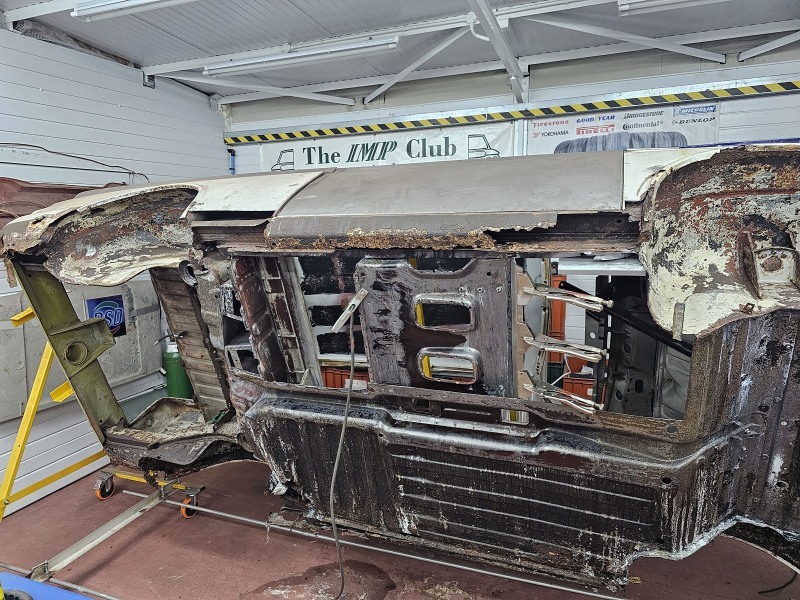

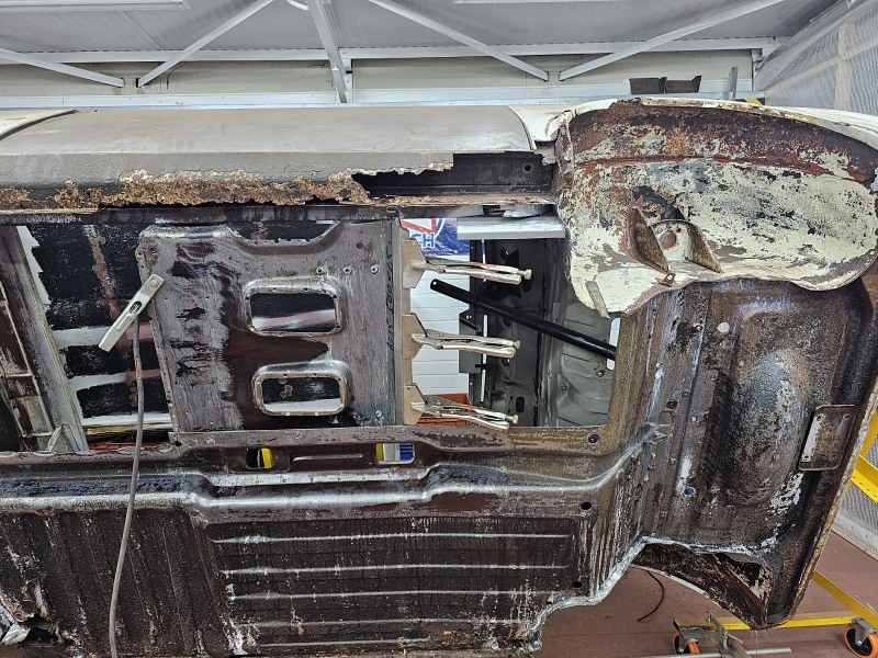

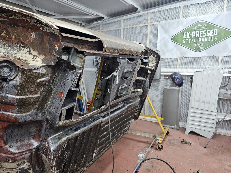

    The cut out and replace
    Click image for larger version  Name:	20230925_152654.jpg Size:	174.4 KB ID:	22612
    Click image for larger version  Name:	20231002_132954.jpg Size:	209.5 KB ID:	22614
    Click image for larger version  Name:	20231002_132954.jpg Size:	209.5 KB ID:	22621
    Click image for larger version  Name:	20231002_132951.jpg Size:	206.3 KB ID:	22615
    Click image for larger version  Name:	20231002_132955.jpg Size:	217.9 KB ID:	22616
    Click image for larger version  Name:	20231002_133506.jpg Size:	131.5 KB ID:	22617
    Click image for larger version  Name:	20231002_133010.jpg Size:	207.6 KB ID:	22618
    Click image for larger version  Name:	20231002_133002.jpg Size:	209.1 KB ID:	22619
    Click image for larger version  Name:	20231002_133022.jpg Size:	199.0 KB ID:	22620
    Click image for larger version  Name:	20231002_132954.jpg Size:	209.5 KB ID:	22622

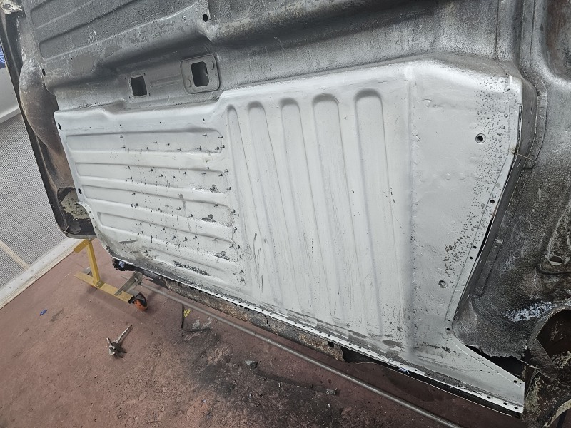

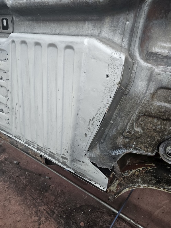

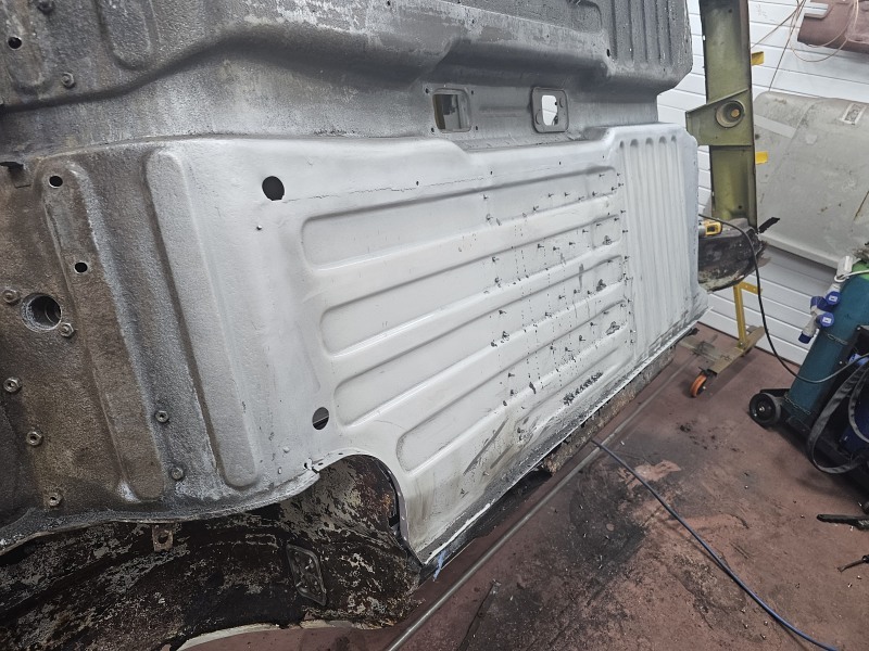

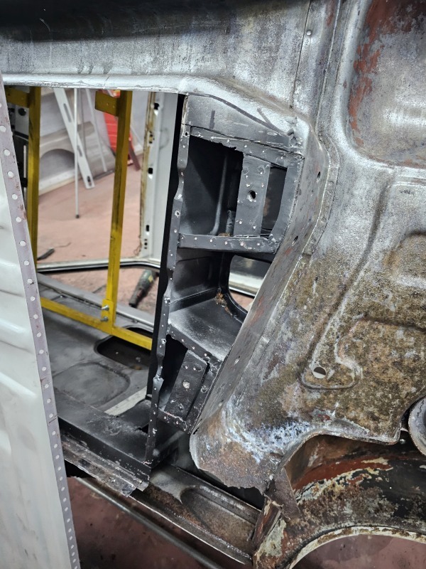

      And its in !

        Summary
        Panel cost - £143 In Vat per side (£286 per car)
        Imp club members get discounted prices and to put the discount into perspective your 10% discount (£28) covers the current club membership fee ! so everything else the club supplies you is gravy
        Labour - 1 hour prep per panel, 30-40 minutes each panel to key with 120 grit, then acid phospate the surface
        Labour - 8-10 hours per side to install (not including cutting out old floor and other section repairs.)
        Consumables - 2 x 80 grit flap disc to clean of drill holes
        Consumables - 100ml x zinc phoispate etch solution (water soluable)
        Consumables - Mixing cups, cleaners, degreasers......
        Consumables - 100ml Rust acid etch and phospate solution
        Consumables - 400mL can zinc galve coating
        Consumables - 30-40 Self drilling/tap flat button heads screws
        ​​The floor attachments are surprisingly few, changing rather than repairing a floor, well it makes sense as you can cut as far as you need in to get good strong metal to attach to AND you get to clean out under the seat braces which will be nasty. almost makes sense to replace ratheer than repair.
        As you will see in the video, it is very easy to get out BUT make sure the shell is supported sufficiently or you will end up in really deep doo-doo and its nothing to do with it being on a jig, its common sense.
