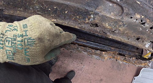

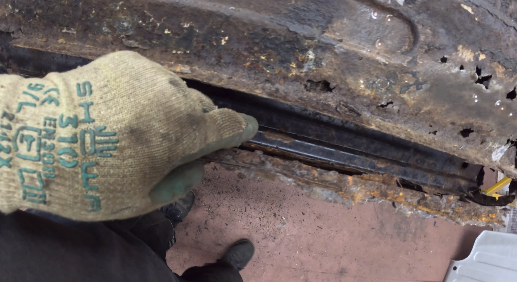

passenger side floor pan prepped
    The nasty cover sill had to go, it was just too rotten

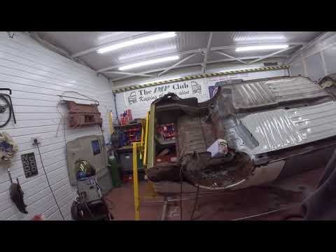

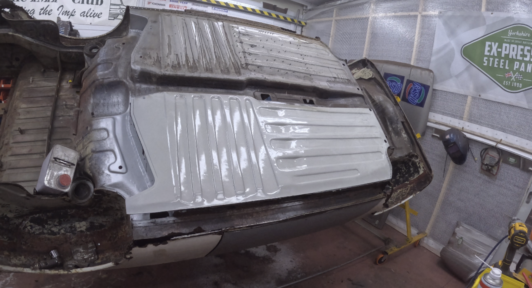

    Underbelly treated and coated, floor pan from Ex-Pressed Steel Panels now shapred and ready for final trim.
    Currently held in place by 2 self drilling screws / anchor points which will act as the datums to make sure it goes back in same place

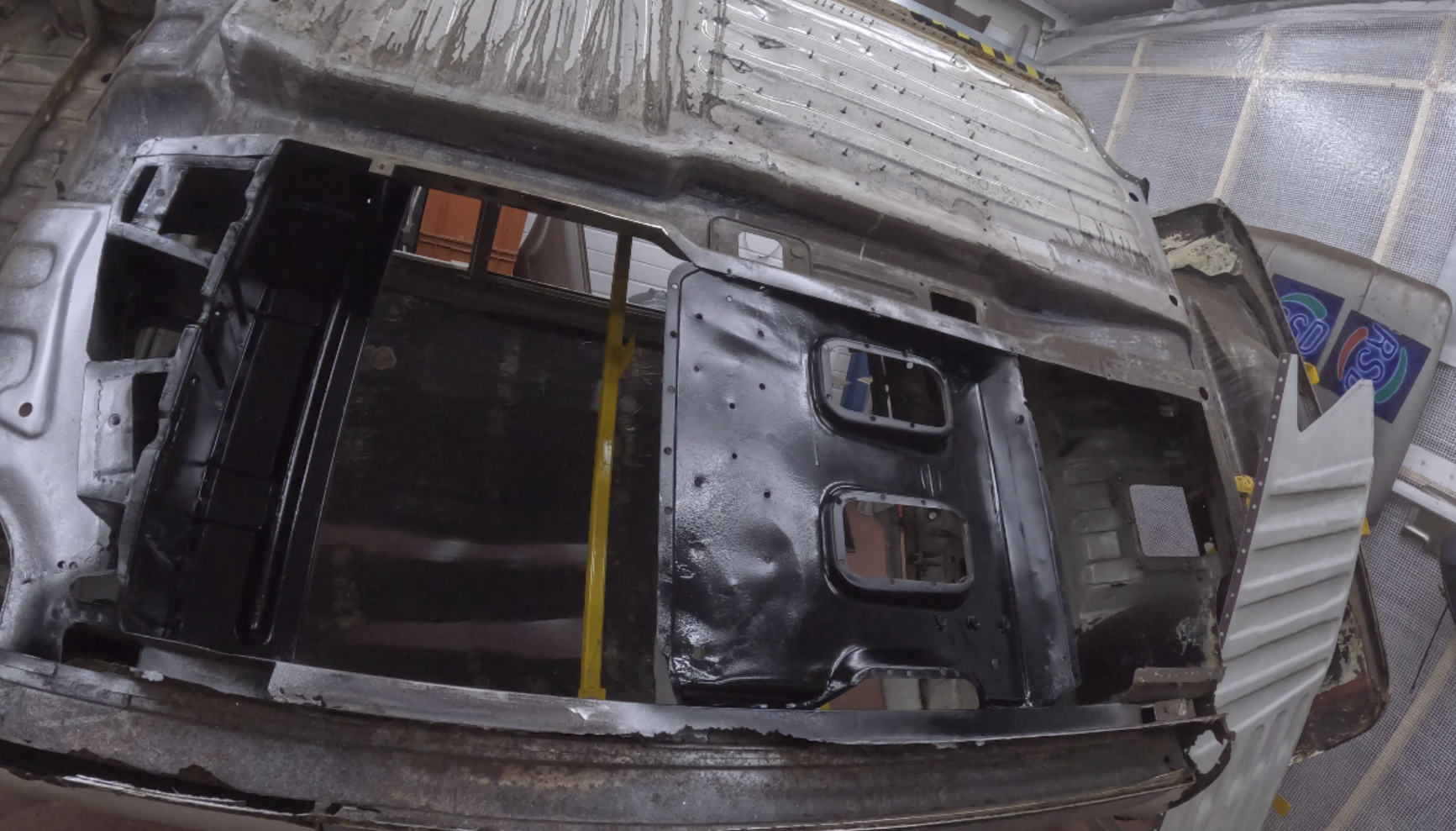

    Couple os small repairs on the box section and the top few inches of the seat brace front lip nearest the tunnel and then we can get it fitted.
    Overall I must have chewed through
    8 x 75mm discs,
    2 x 125mm discs
    1 x 80 grit flap disc
    Galv paint 400ml between both sides
    about 200 ml of epoxy sealer/primer in matt black
    Next up same process as before, seat and trim, install self drilling screws (The left over burred hole is GREAT for starting a good plug weld) and then tack in and weld.
    We are on our way !
