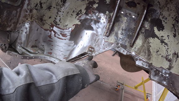

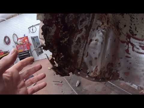

    These sections are very likely to be poor, even if the floor itself is not so bad.
    Here the metal was very pitted and poor condition so it was cut back to good metal which left a rather odd shaped hole to fill
    Sorry peoples I do not have the skills to do this in one go so patchwork it will need to be. Turns out not too bad in the end.
