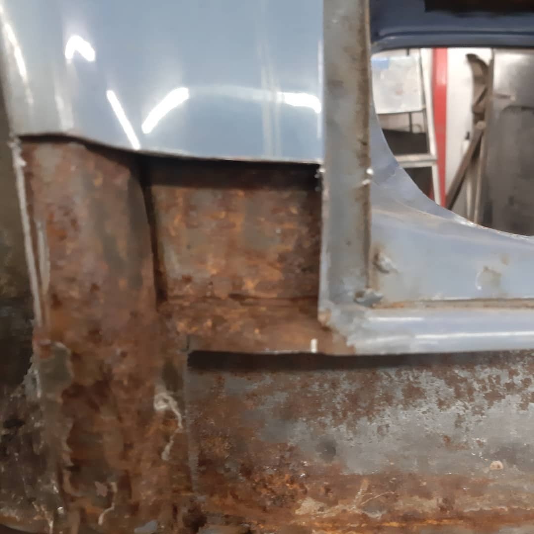

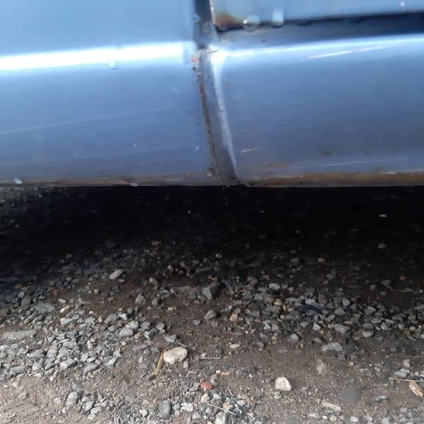

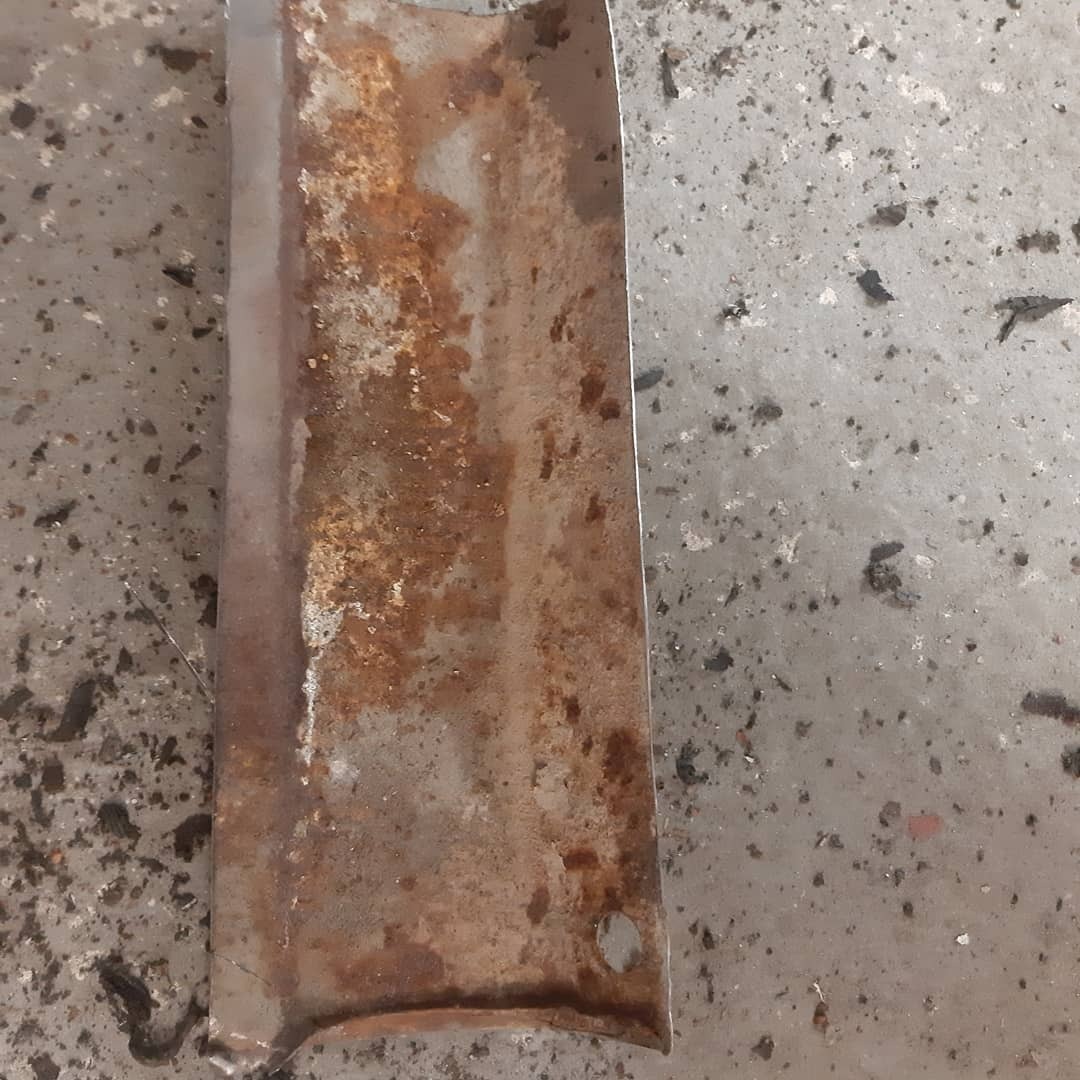

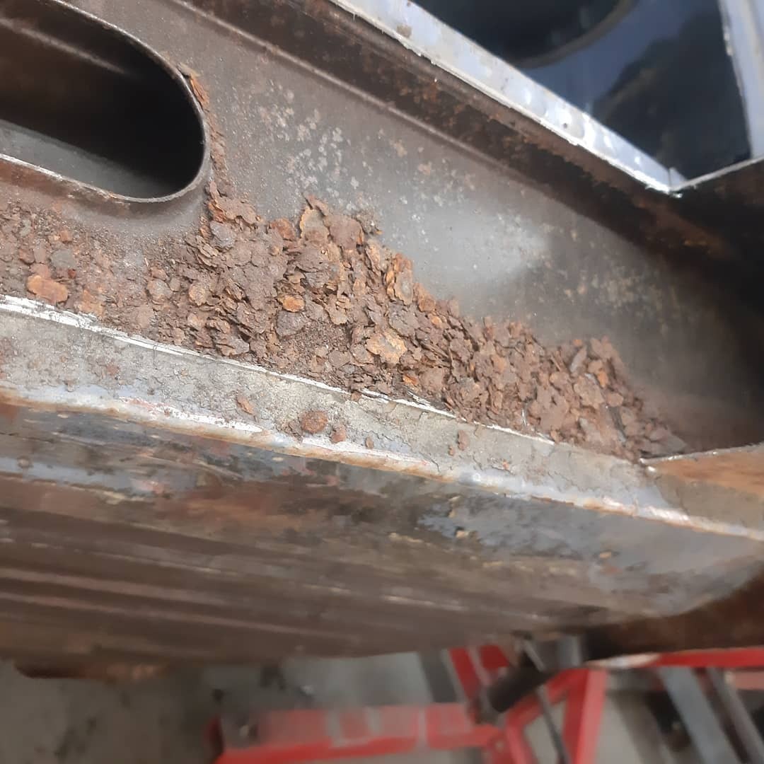

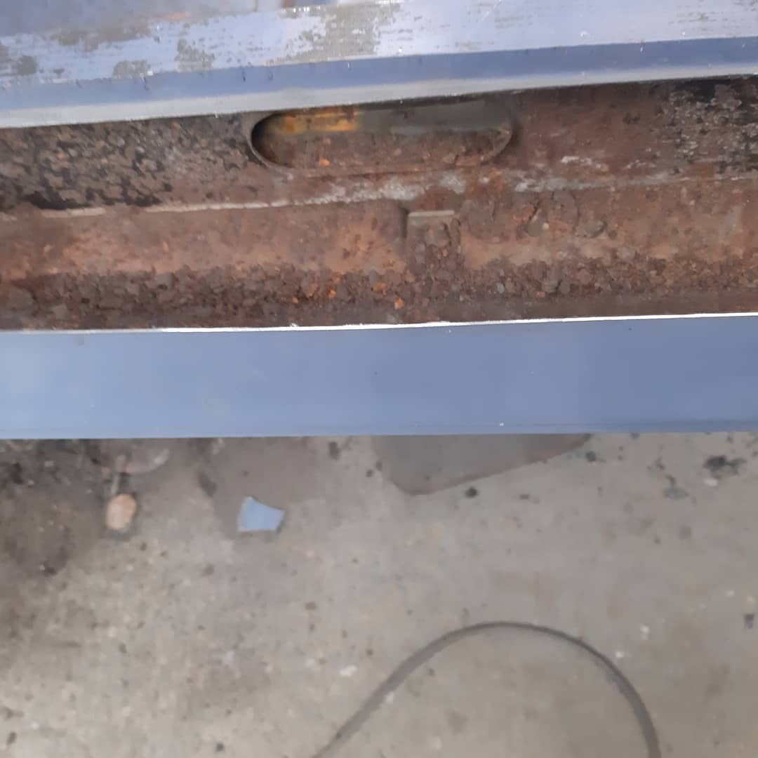

    It's been a while since I got this 64 #imp in which belongs to Steve Burton so over the past few weeks I have slowly stripped it down and today got it braced up and on the rotisserie.
    Now the sills looked good except for the rear section of the front wings and the nose of each sill .

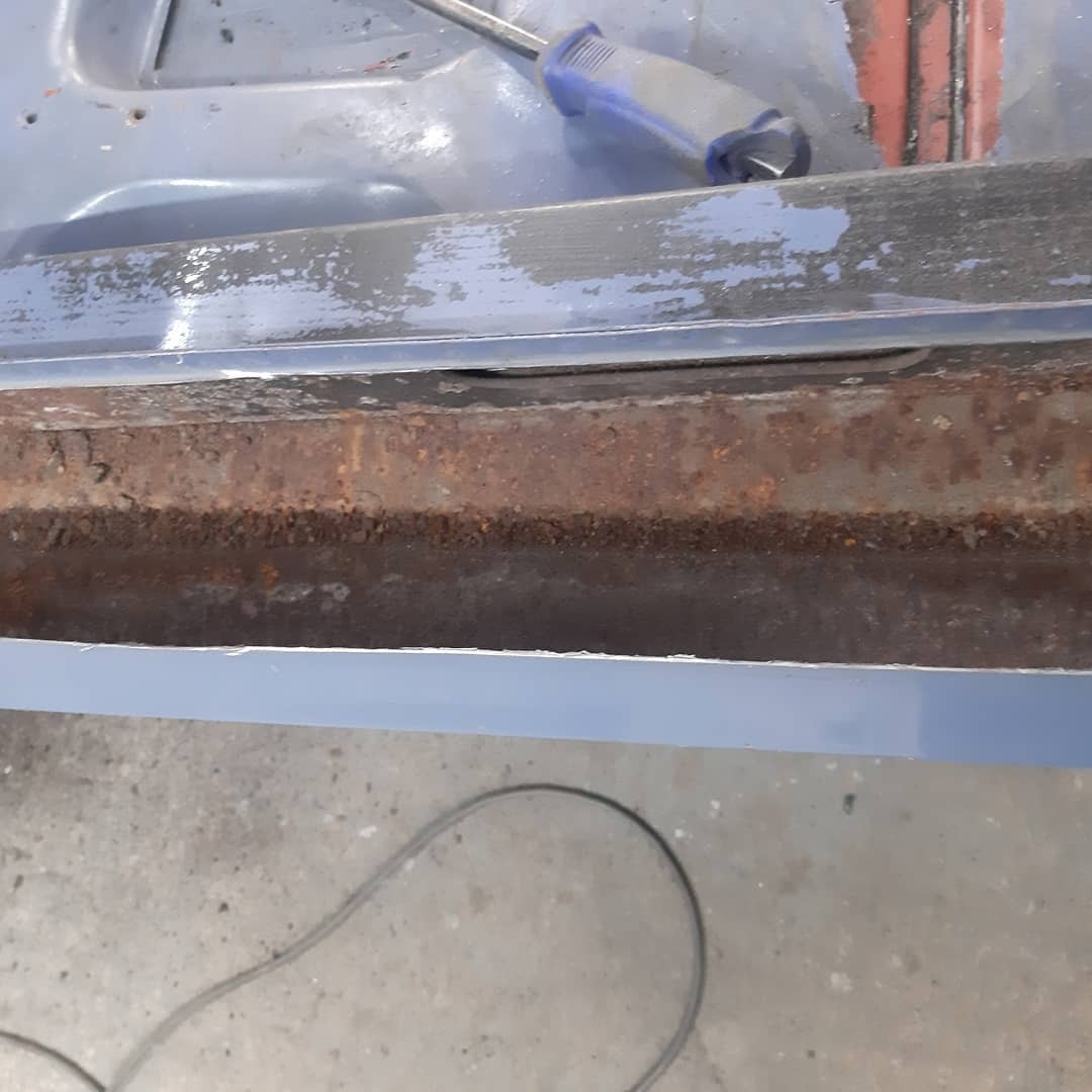

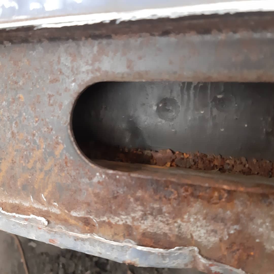

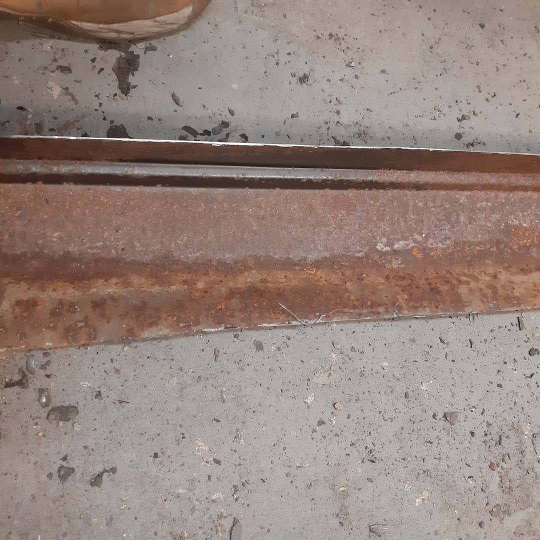

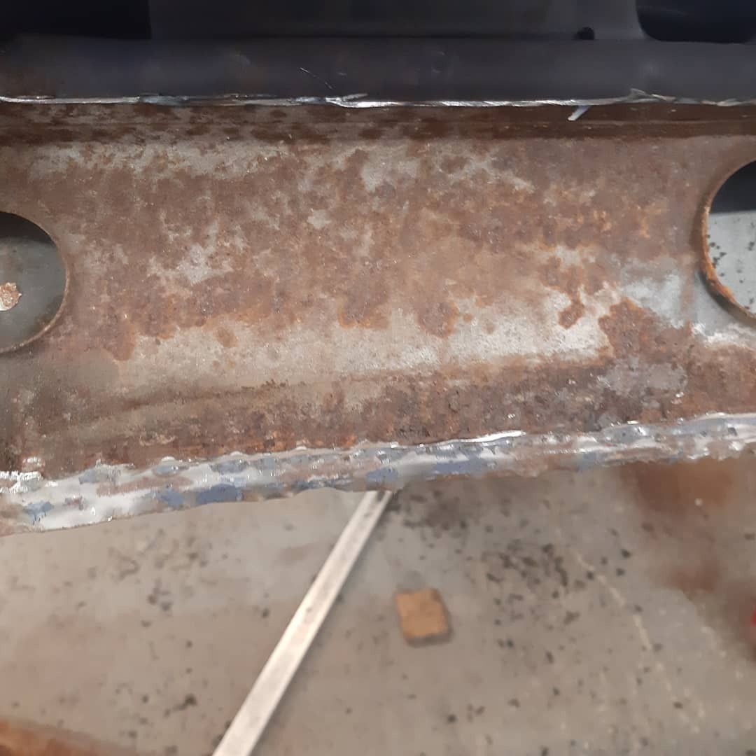

    I sent a camera up the sill and the decision was made to remove and replace the sills and glad we made the right decision .
    As tlyou can see the rust inside is unreal . So I'm removing all the underseal and then it's off to the blaster .
