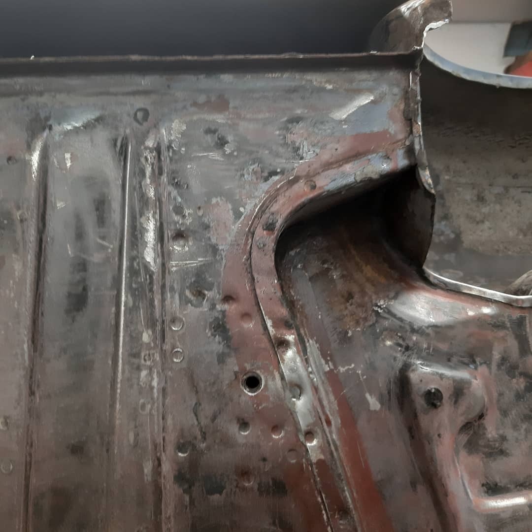

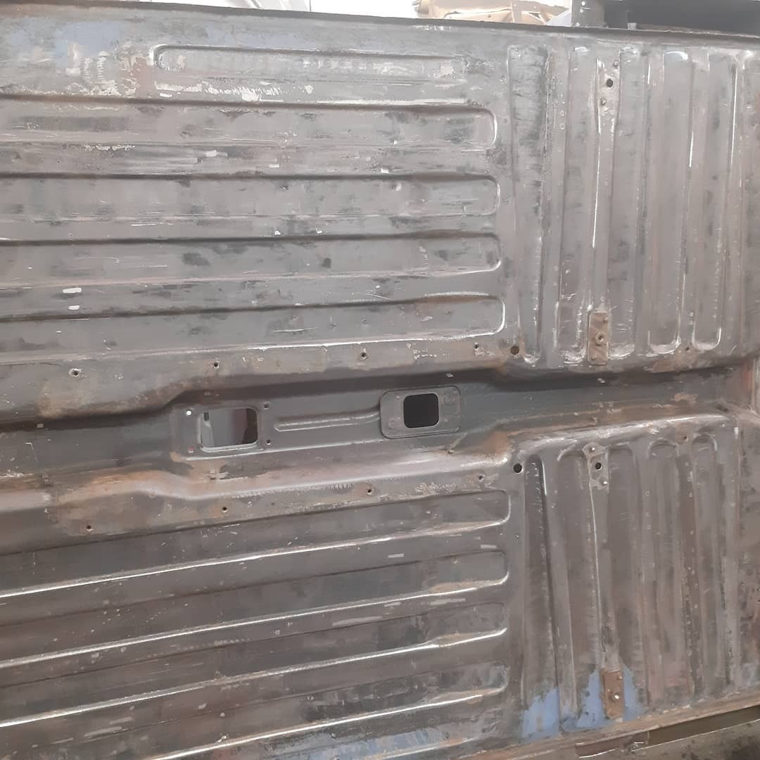

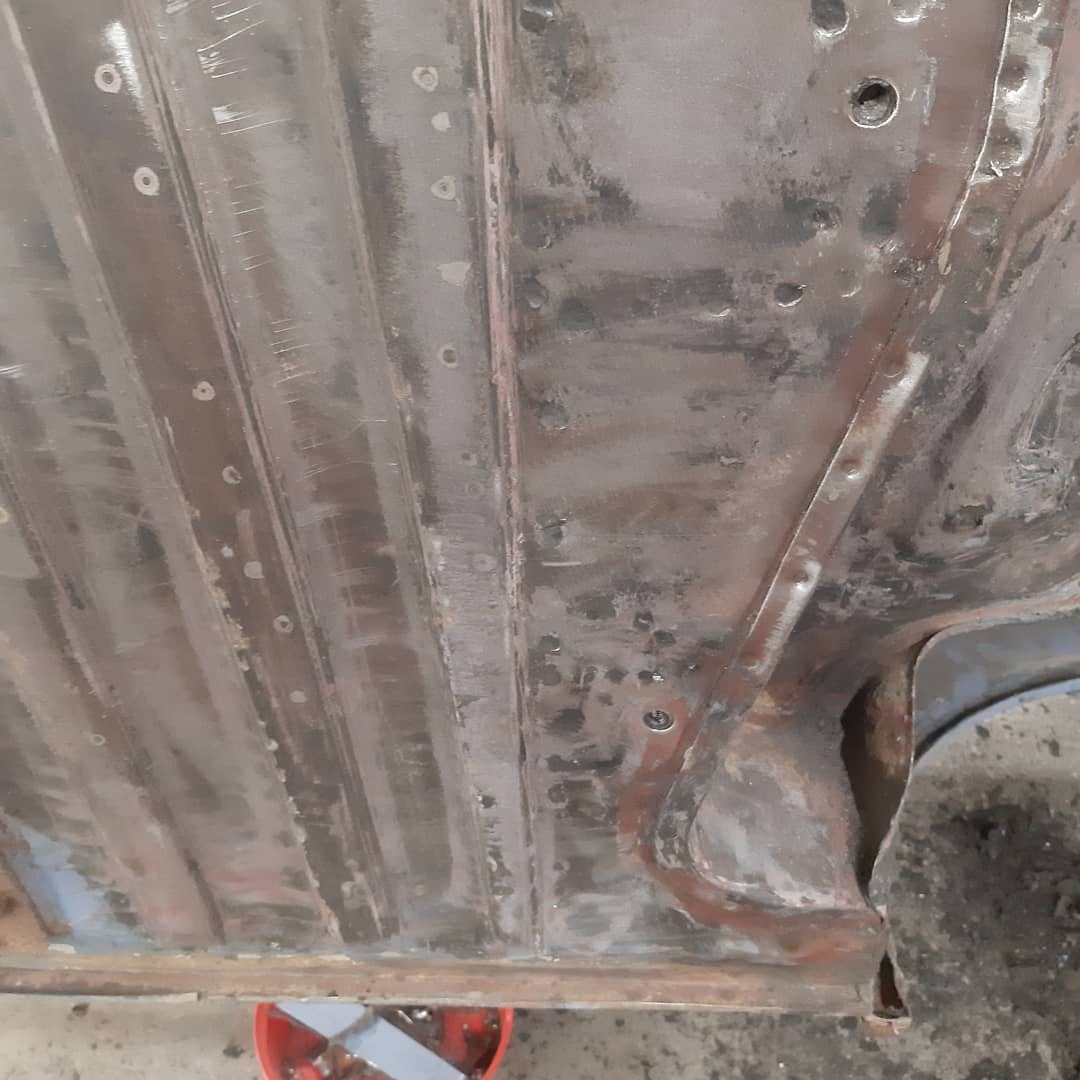

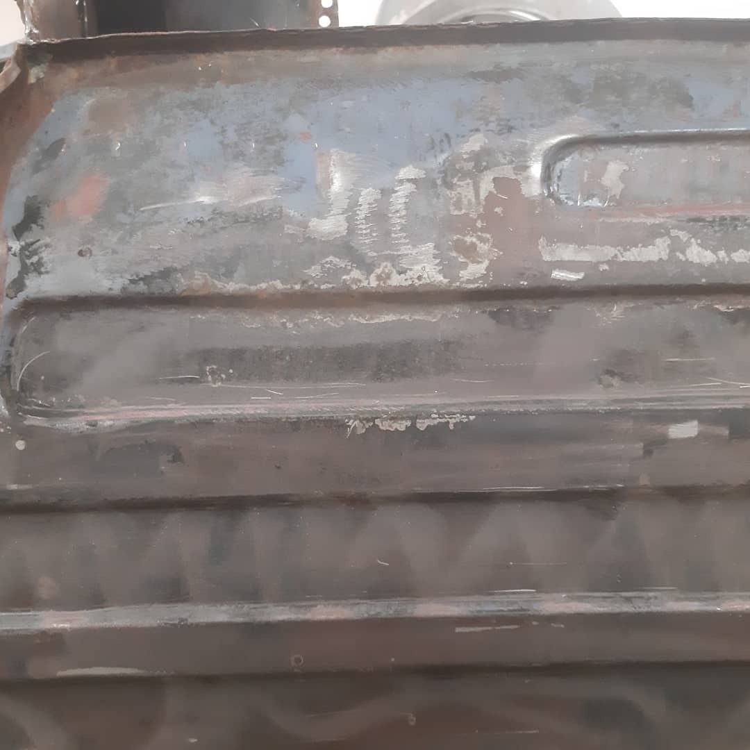

    This is 1 of the best Early #imp floor pans I have seen in a few years .
    Notice there is no drain holes anywhere from factory at the rear slightly later cars gained a small hole with a little plastic tube and then in around 67 or 68 the floor gained big rubber grommets at the front and rear and so helped the floors to rot
