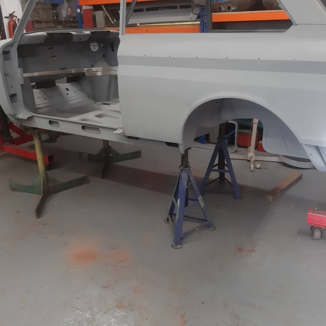

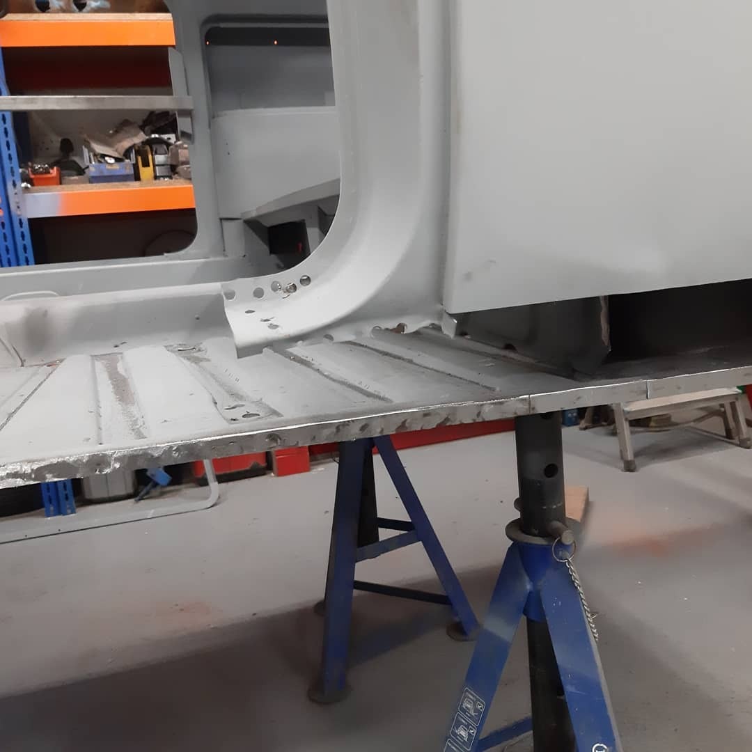

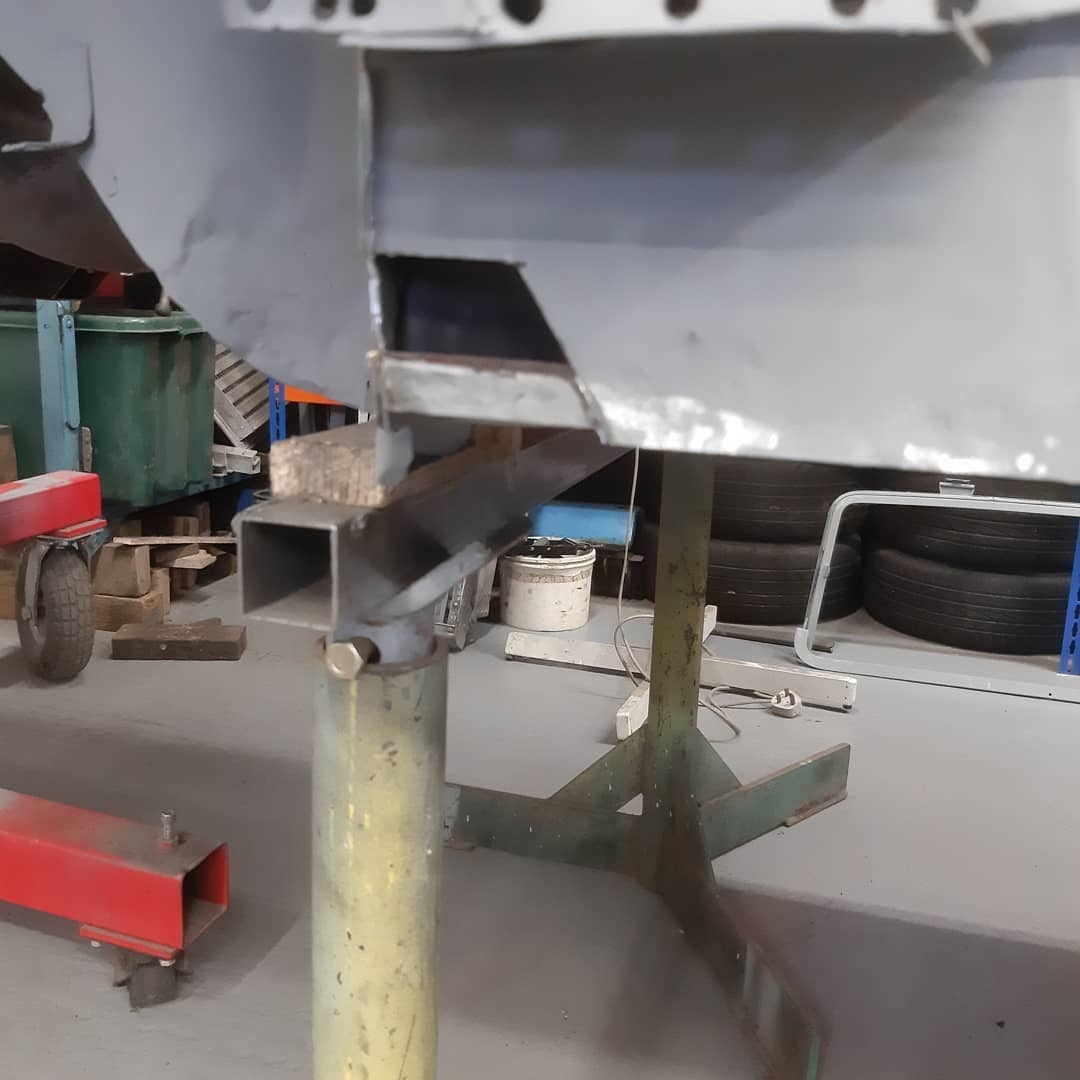

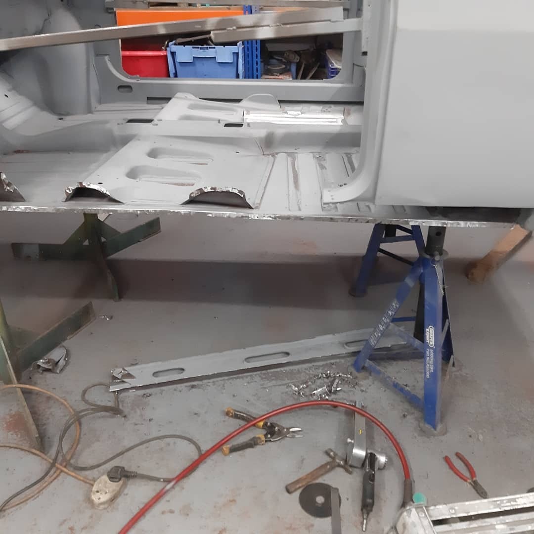

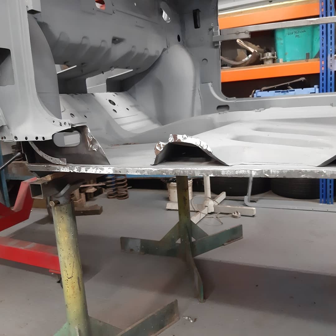

    Well it's been all go at the moment with picking up a few cars to break or sell on .
    I also got Steve Burton #bodyshell back from MJK Blasting fantastic job .
    The decision was made to remove the inner sills because after a camera inside there was very heavy pitting on the seams .
    So it's on with new inner and centre over the next day or so
