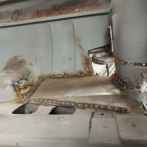

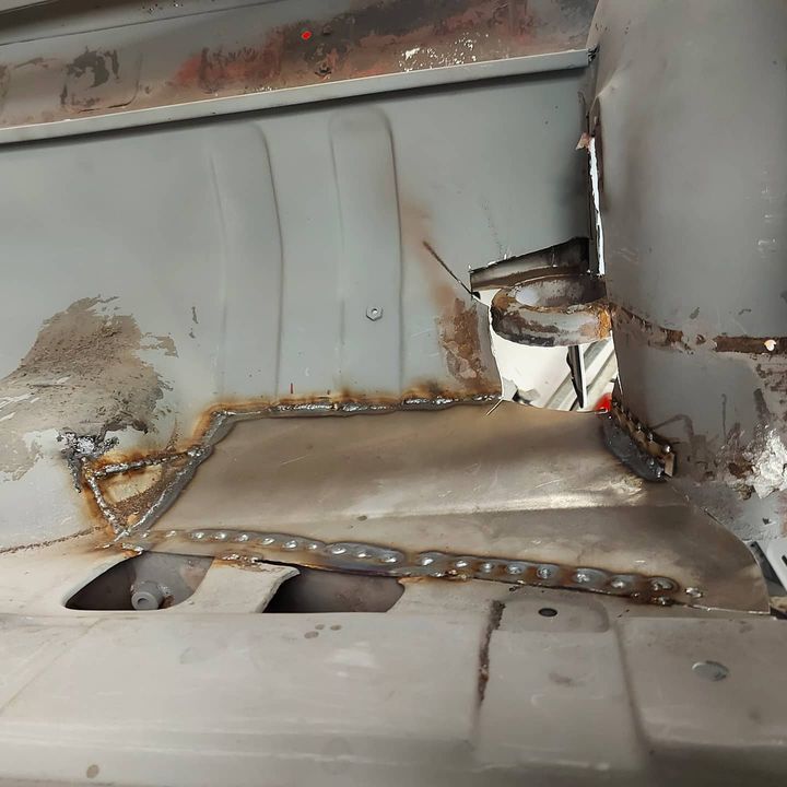

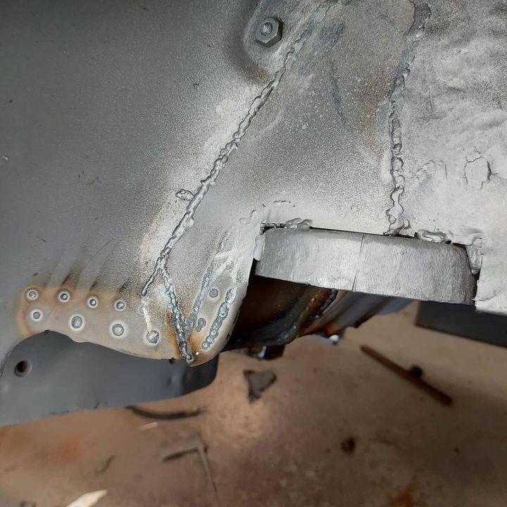

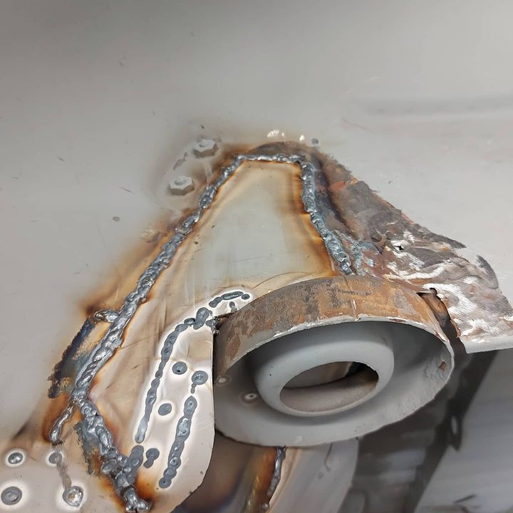

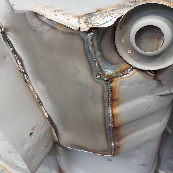

    Some more progress on Mike's mp .
    Its destiny is to be a track car with full cage and BMW 1200rs engine so no point getting involved in putting the swage back in the floor section .

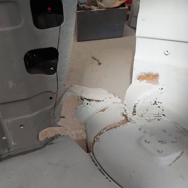

    The main thing is that the car is solid .
    This is actually a strange section to need to replace but the floor section must have had lots of water on it at some point.

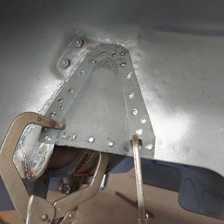

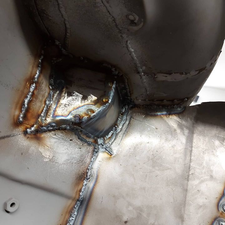

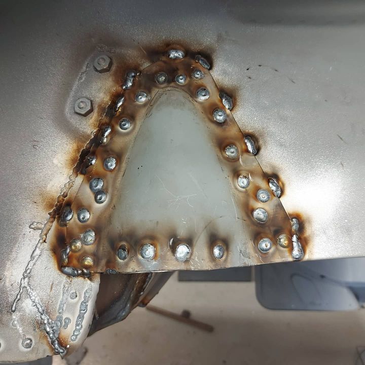

    Rear spring cup was OK surprisingly but a new rear spring cone was needed so 1 of our in-house cones was fitted lovely job .
