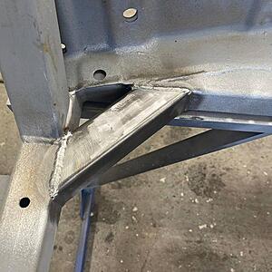

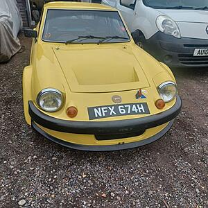

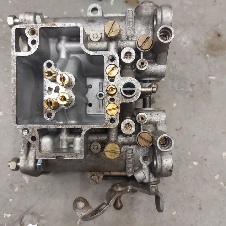

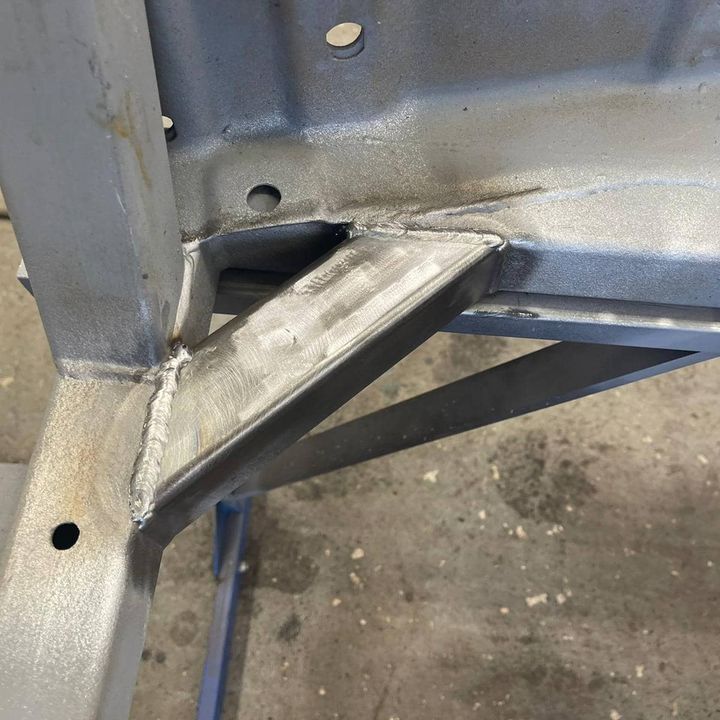

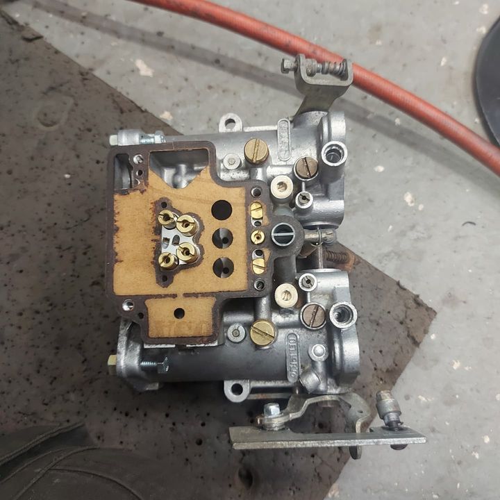

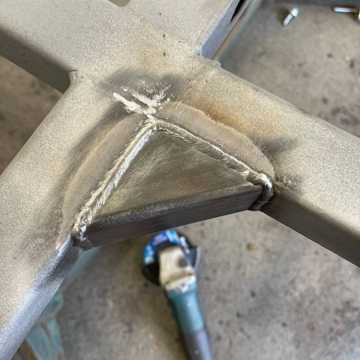

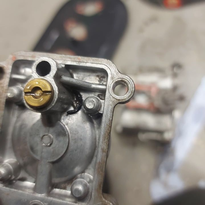

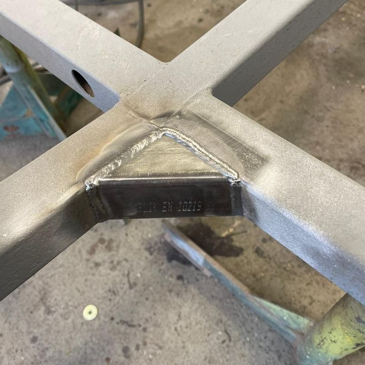

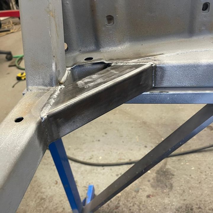

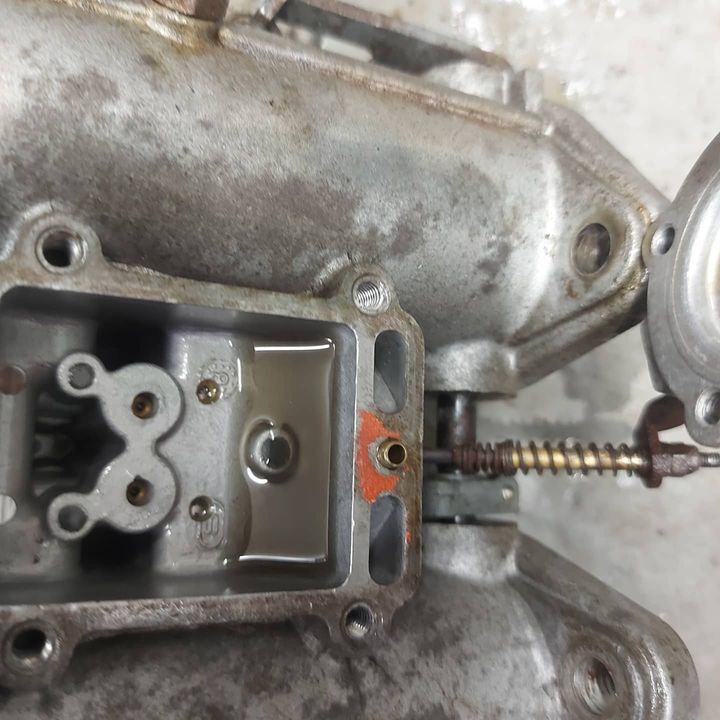

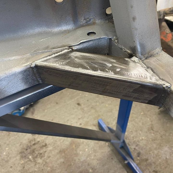

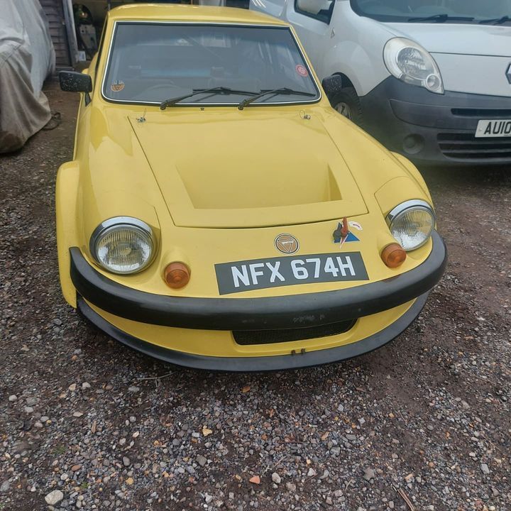

Well this week has seen us work on 2 ginetta #G15 the chassis is from the white car in for full rebuild and some extra bits on the #chassis . The yellow car came in for a new fuel line and ended up have the carbs cleaned in the ultrasonic tank and a rebuild kit ,along with a brace on the rear cross member as the rear tunnel is removable ,this Is due to the car being originally built to take a vw engine and box to go to America but it ended up staying in the UK. Where it was fitted with the #imp engine and box . The owner picked it up this afternoon and has since rang to say it has never gone as well which is nice feedback, hope you all have a great weekend and stay safe
