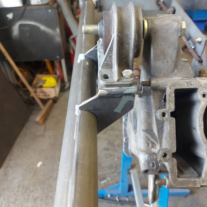

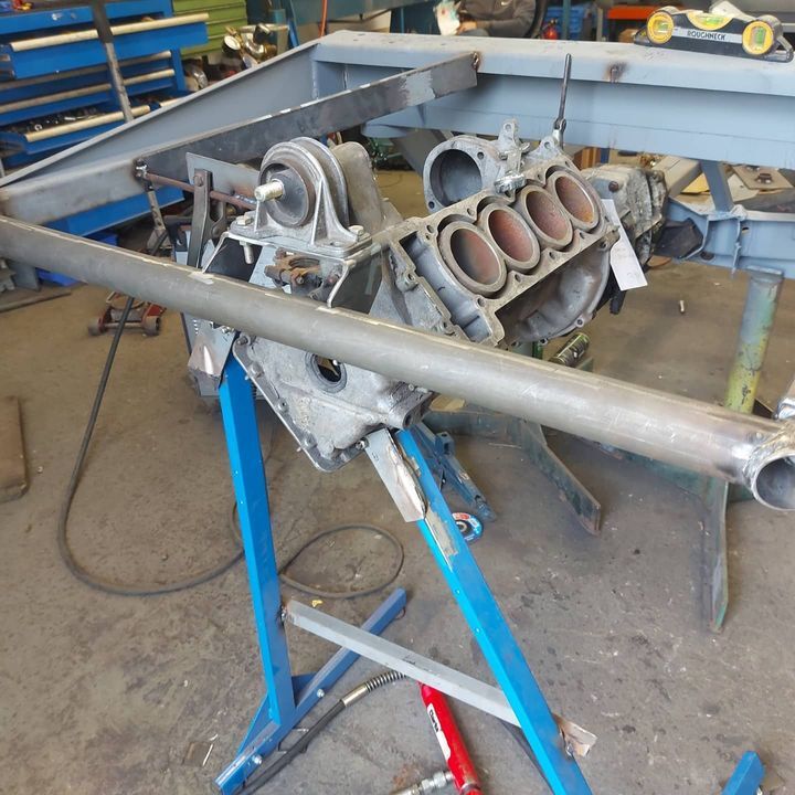

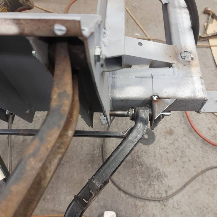

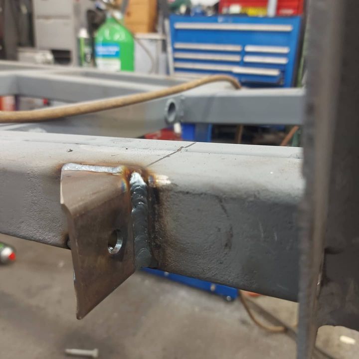

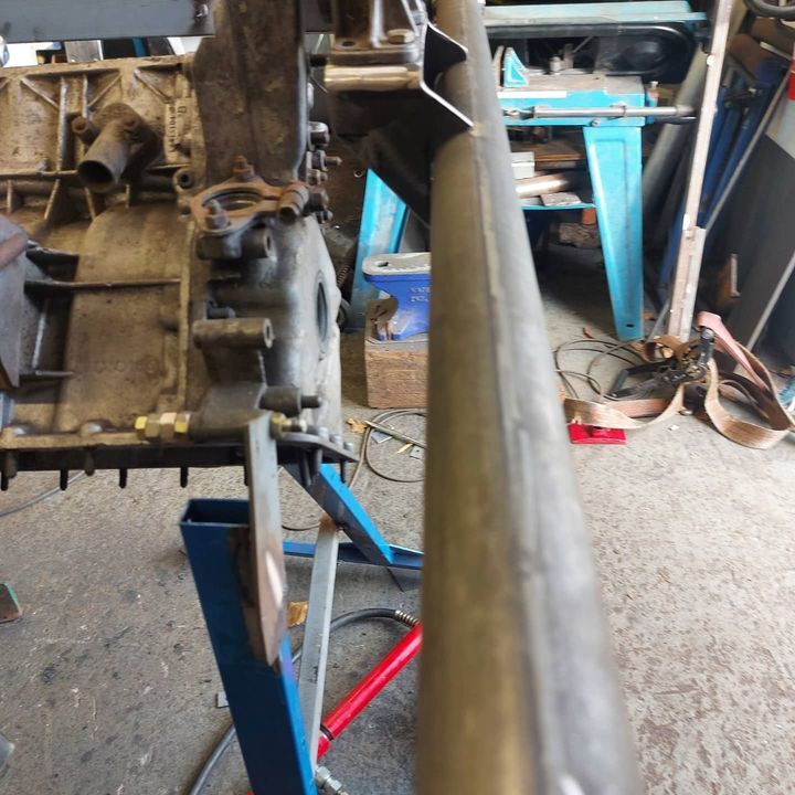

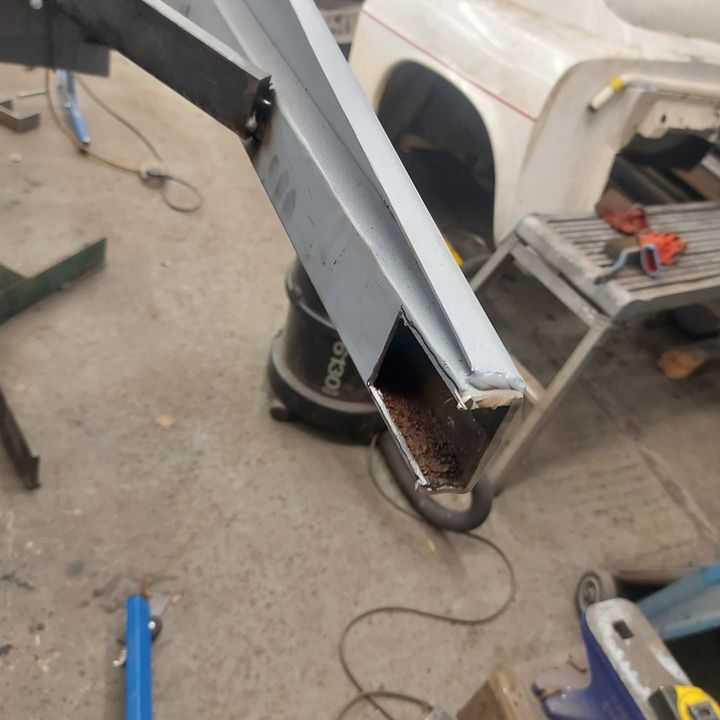

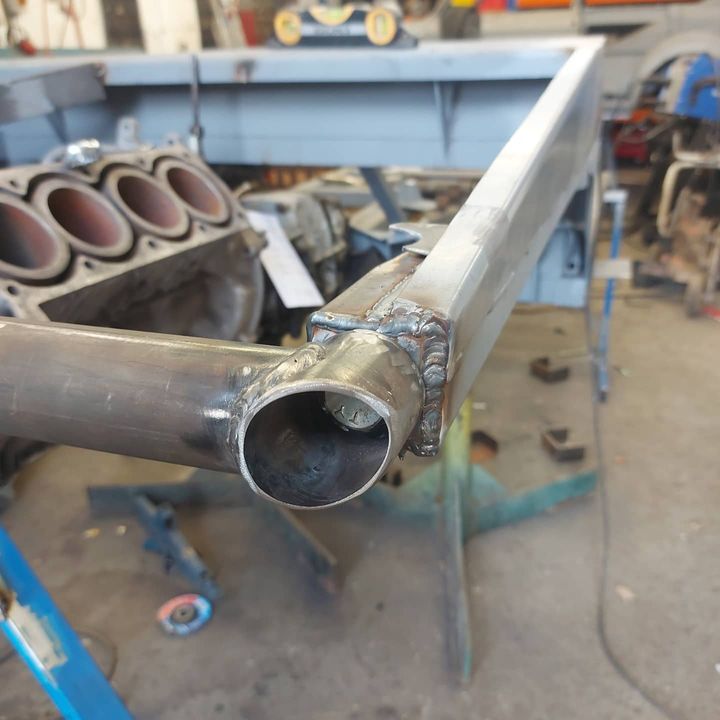

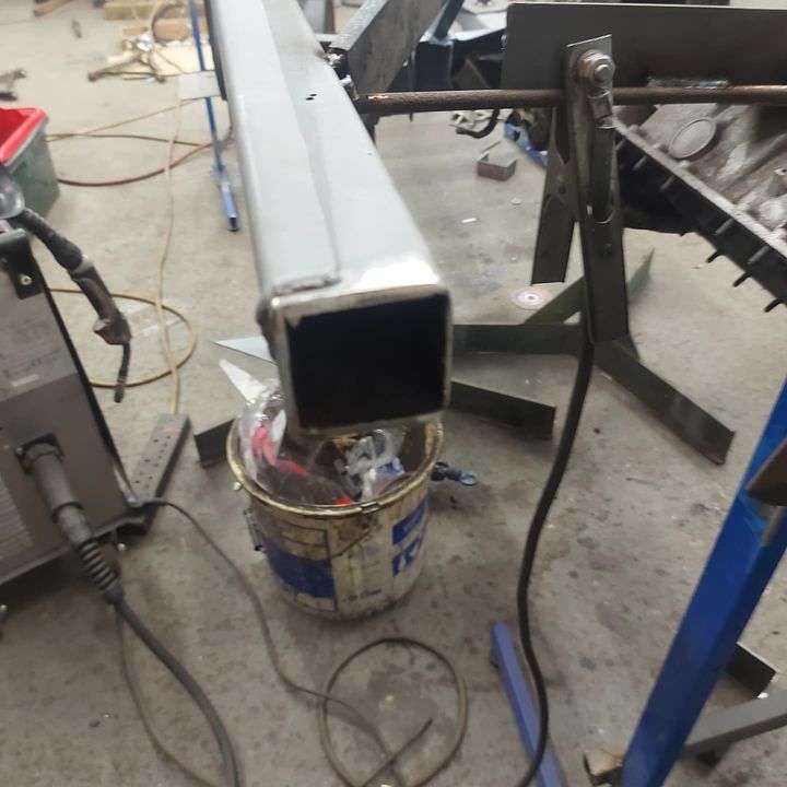

Midweek update on the #G15 now with removable engine bar ,this is something we have looked at on a few #ginetta #g15 but this is the 1st we have actually got around to doing very happy with the results it will at least allow the owner to remove the engine without having to take the gearbox out at the same time , Also some front suspension modifications on the lower arm pivot points
