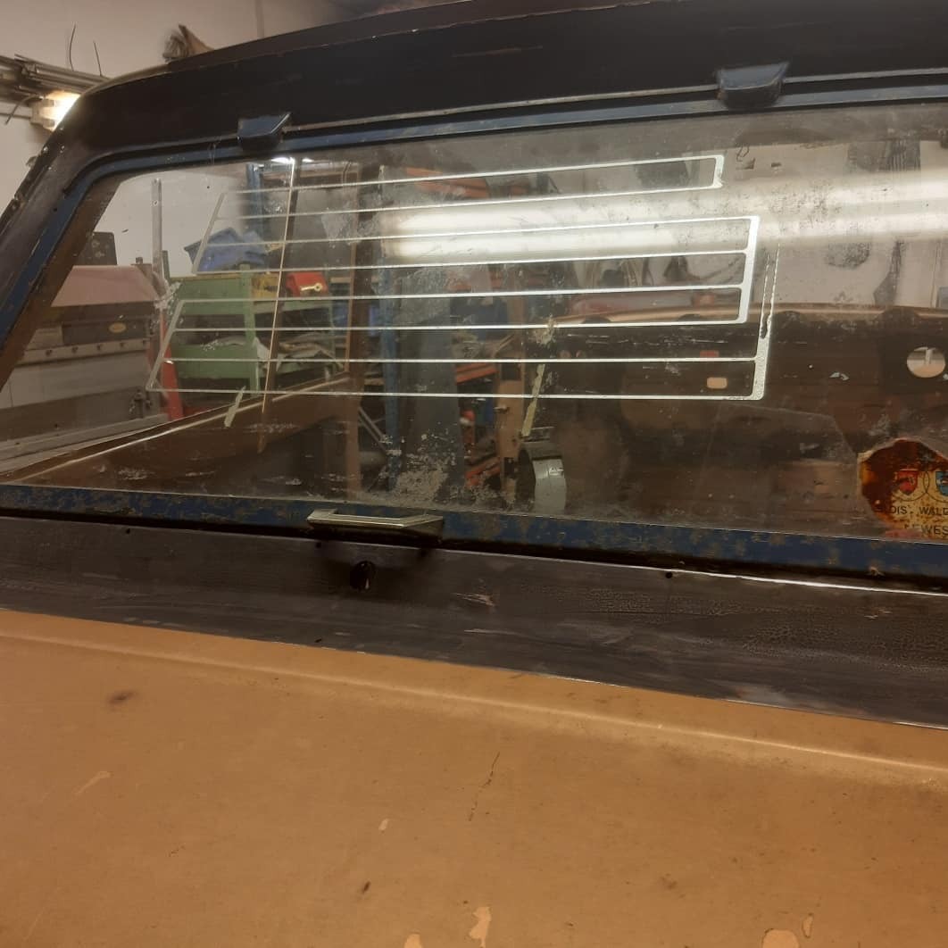

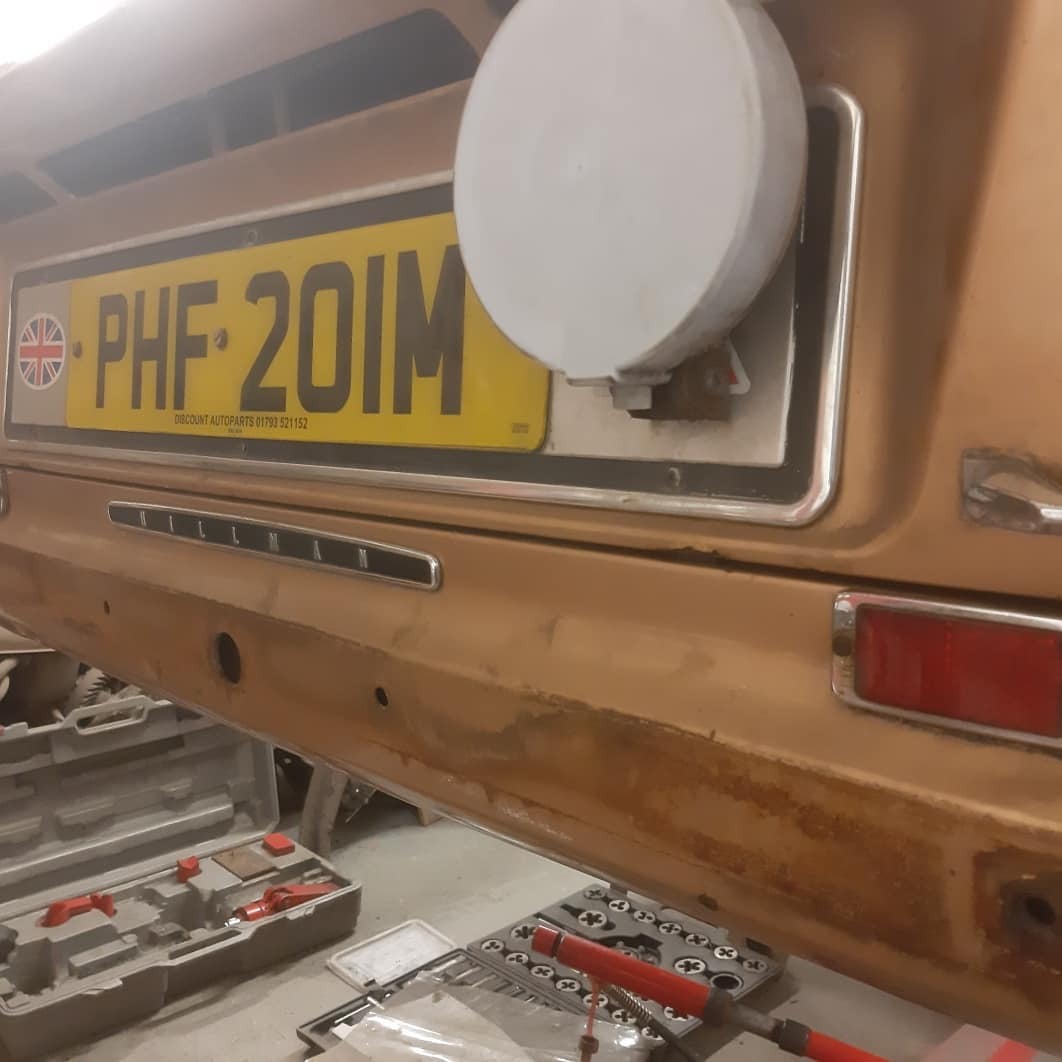

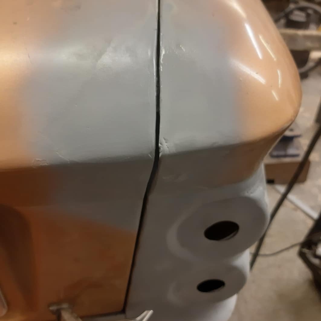

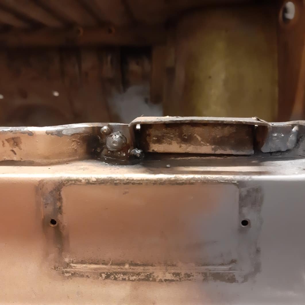

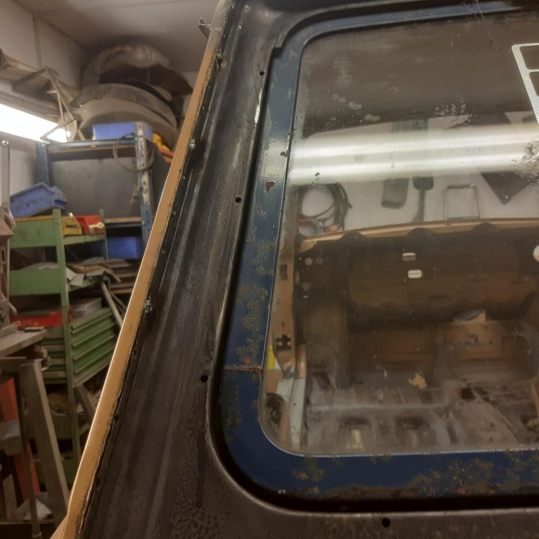

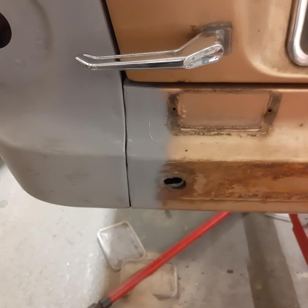

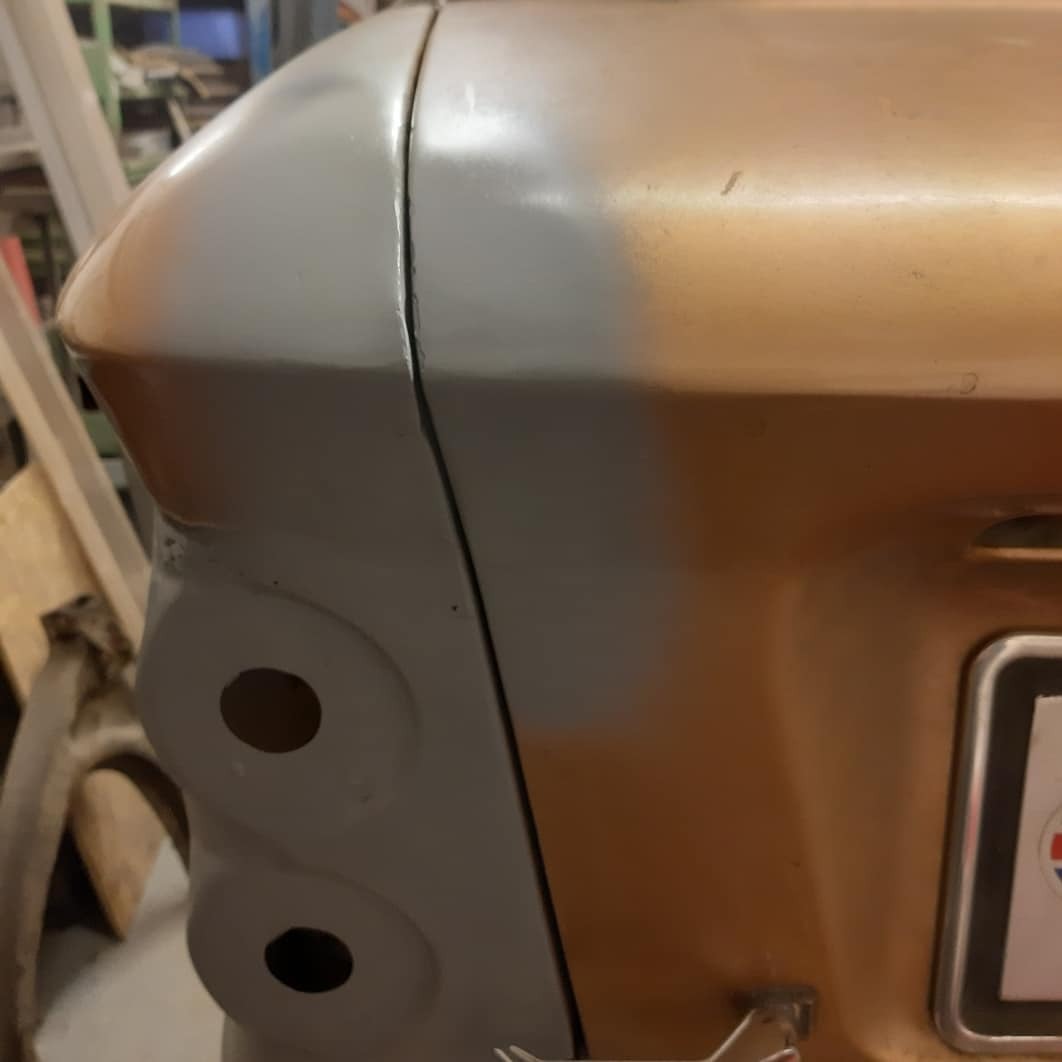

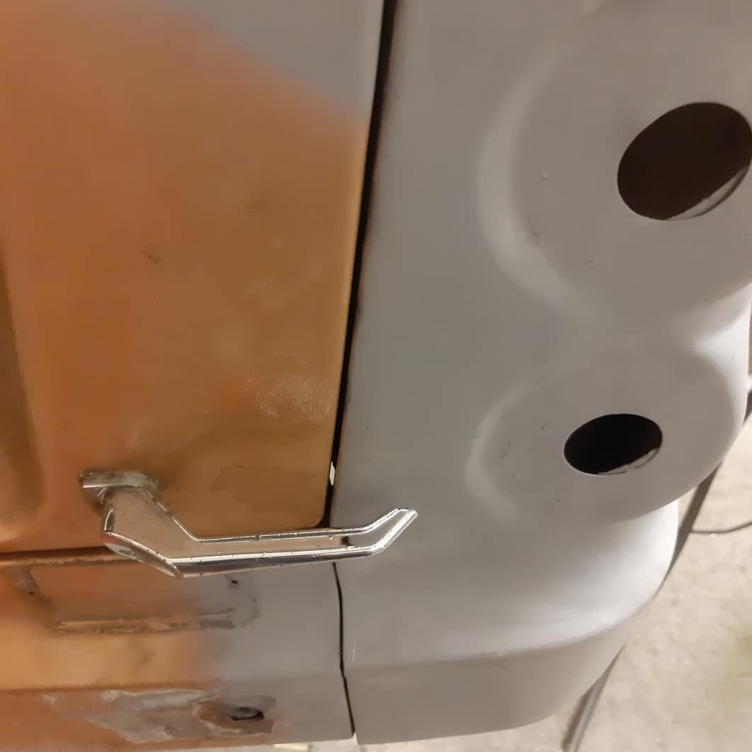

    I have been fitting the rear scuttle on Gordon's #imp and making sure every thing lines up as best I can get it . The offside corner on engine lid was low and after some measurements were taken it would seem the engine latch on the rear transom was lower than any of the other transoms I have so removed it and moved it all is good on the corner now . Tomorrow I hope to get the roof section in and then it's just a few hours to clean back some welds and that should see the rear end all done . I can then sort out the front end . Col

    Nice work, I'm always amazed how good these can look at the back after the magic is worked.
