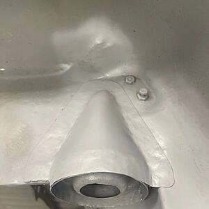

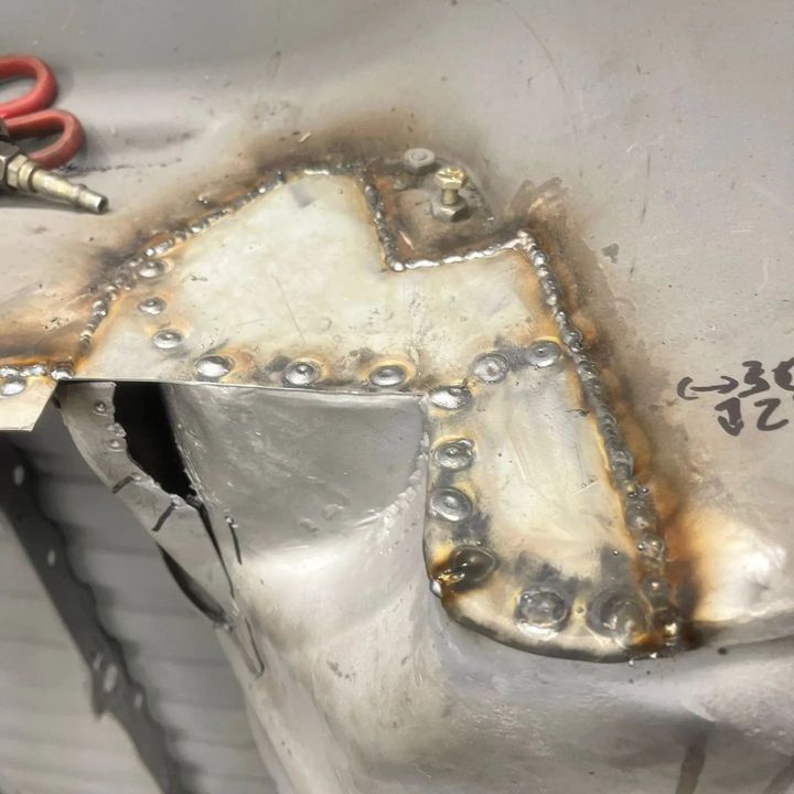

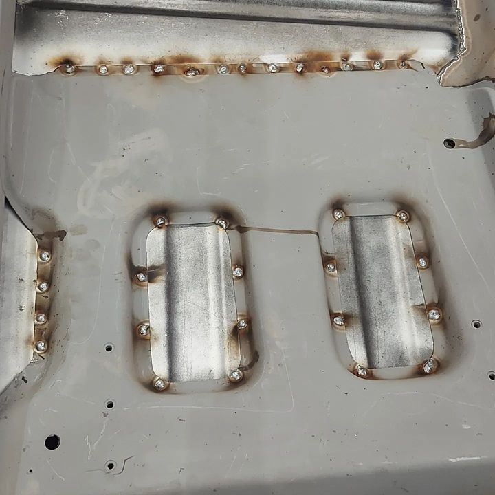

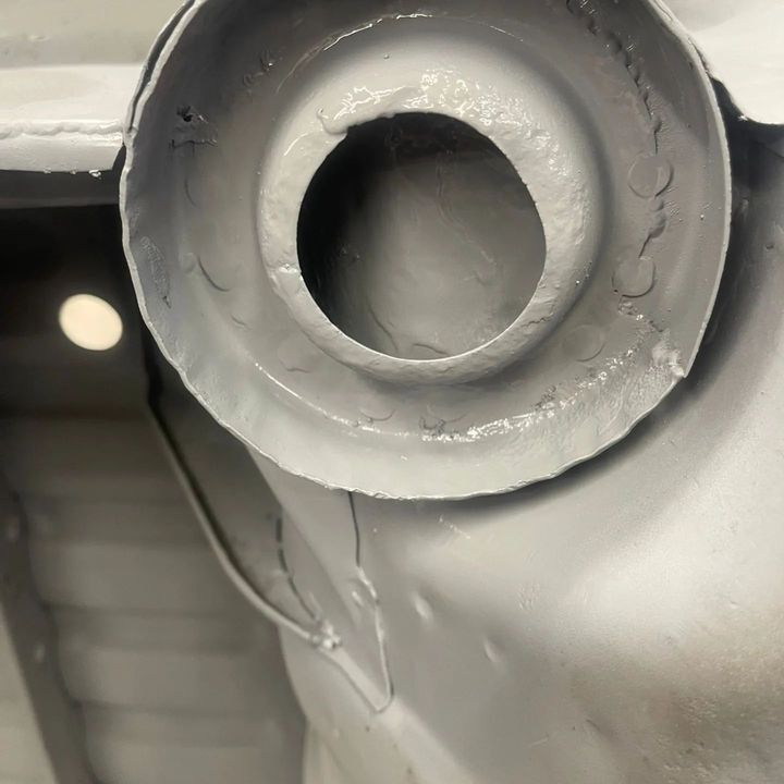

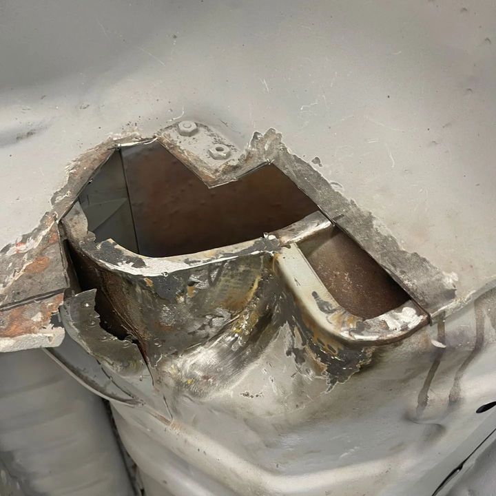

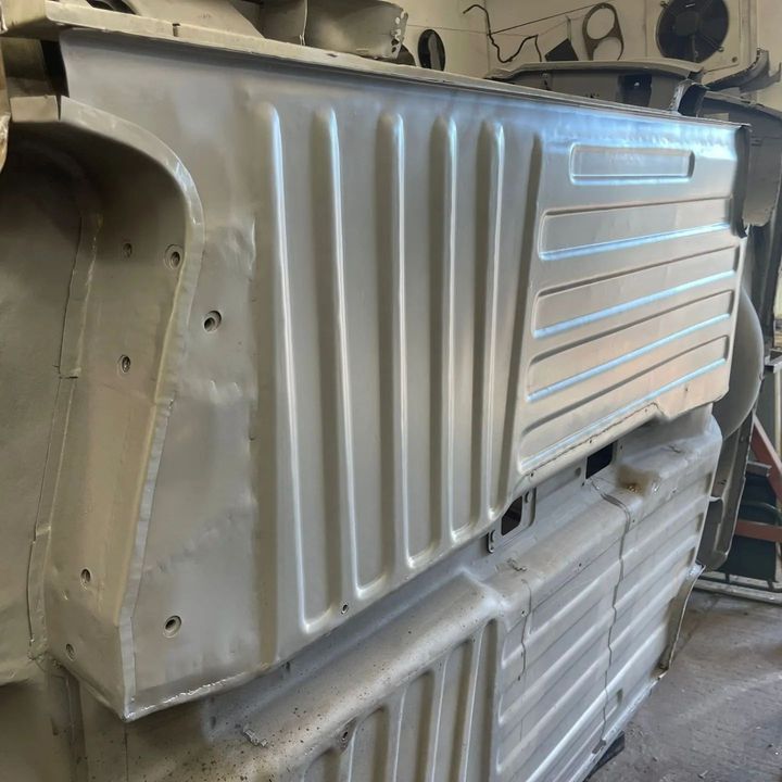

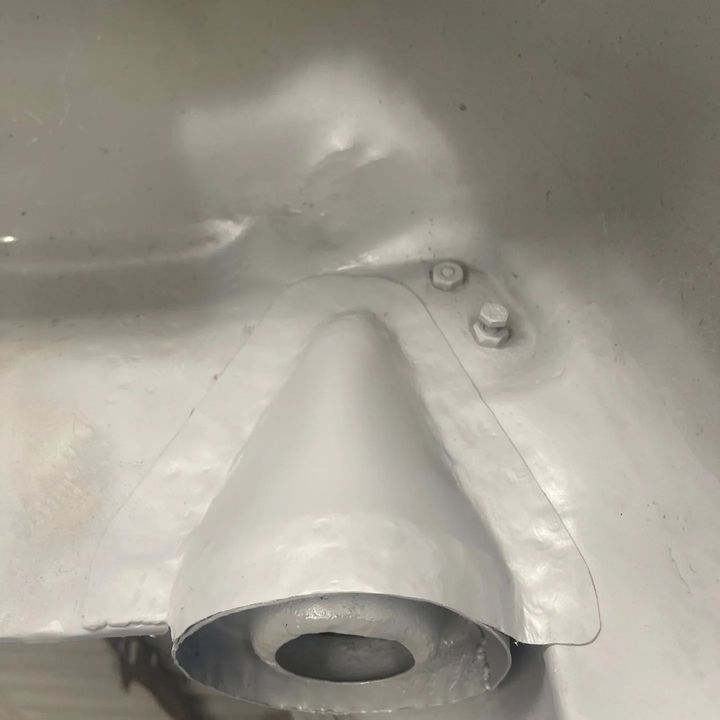

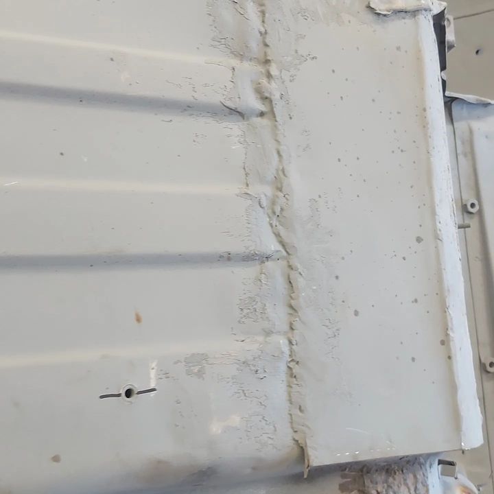

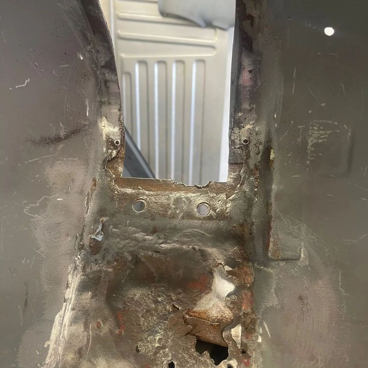

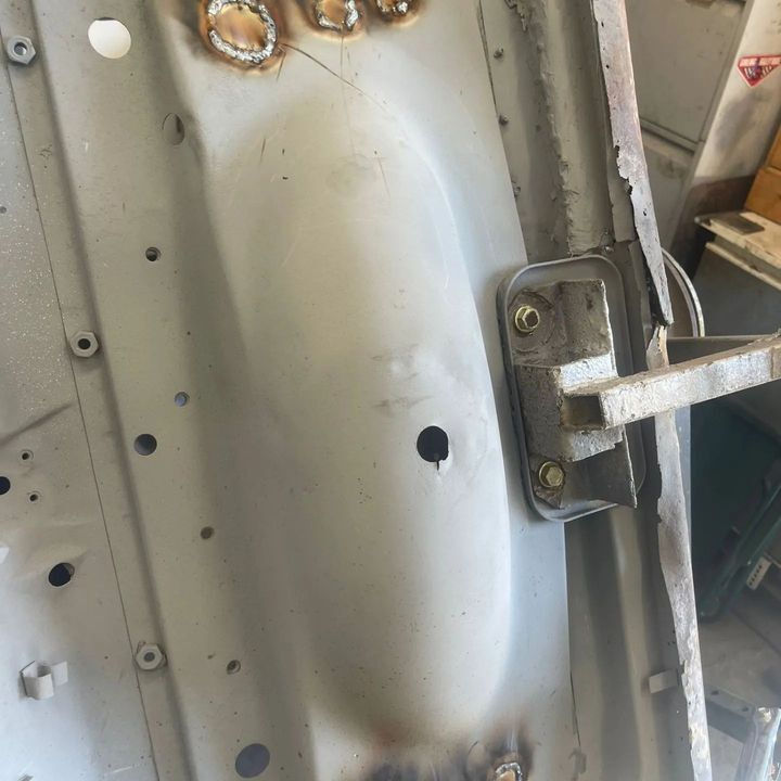

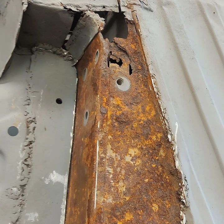

    Bit of an update on how the #stiletto of Roman is coming on drivers floor is in and rear spring cup repaired along with rear cone replaced , the front H bracket had been removed and new 1 is in just needs cleaning back the tops are left open to access the nuts and closed off in the wheel tub to stop the build up of dirt more pictures to come on Monday
