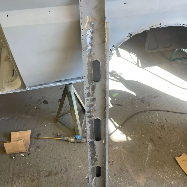

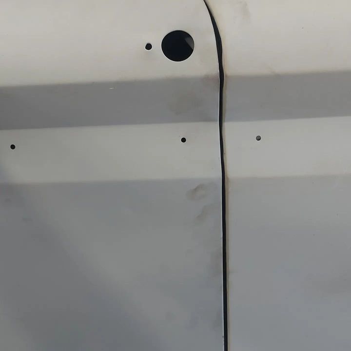

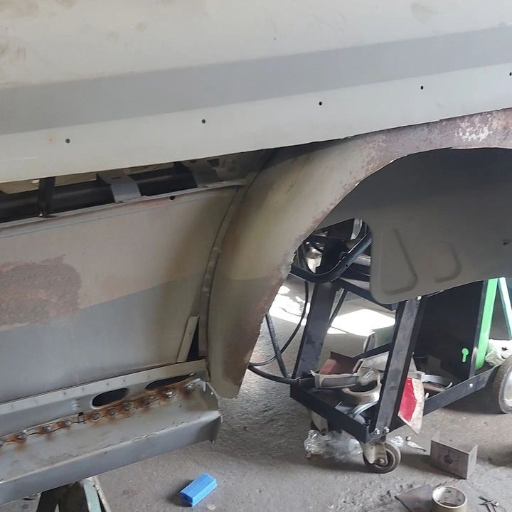

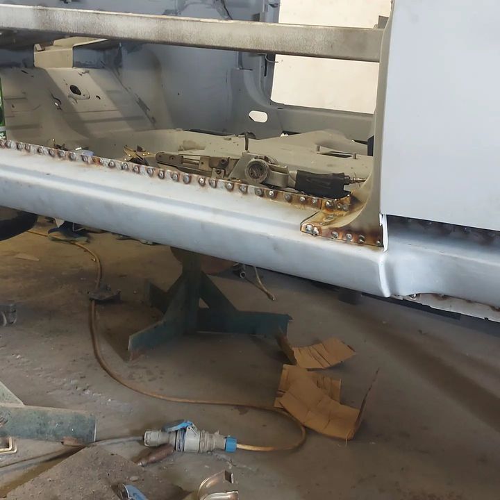

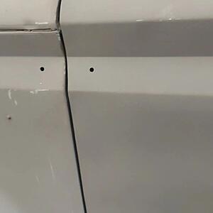

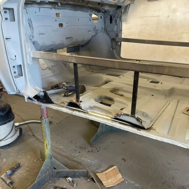

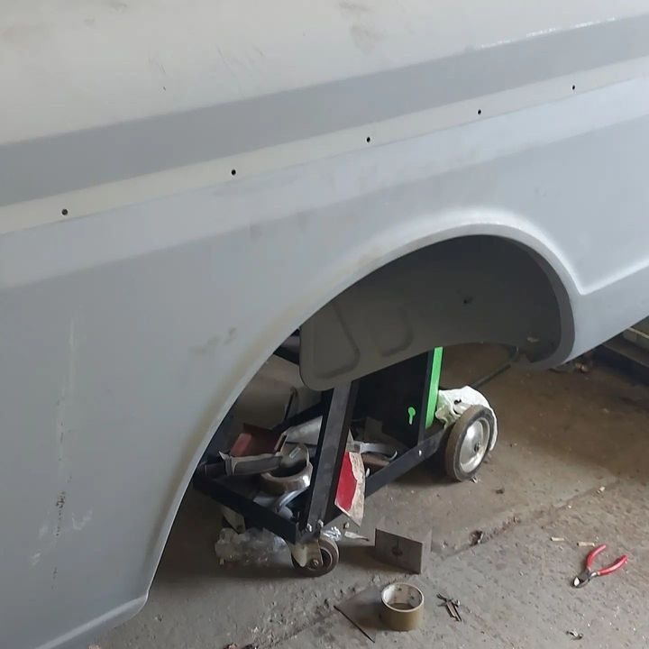

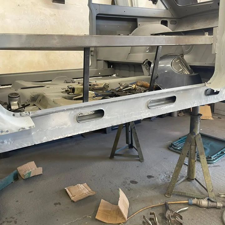

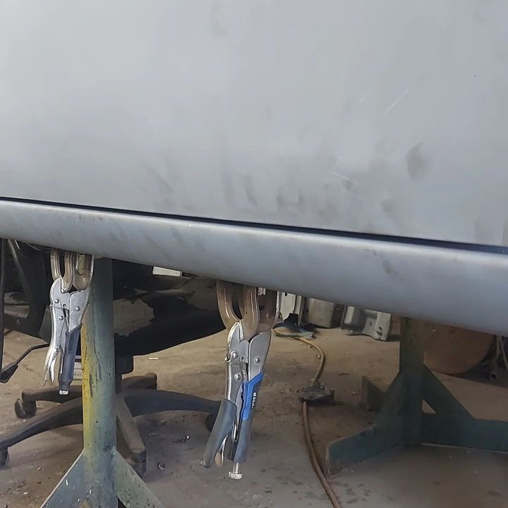

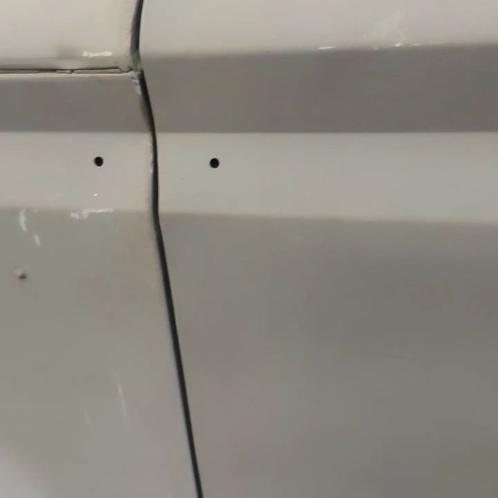

    Some good progress on Ken Angell singer chamois ,inner and centre sill on note the 2 drop bars from the door bar to hold the floor from sagging , outer sill on with door fitted to align properly, half rear wing removed and new Ex-pressed Steel Panels half rear wing trial fitted ,next job is to remove the new rear wing and fit a new outer tub supplied by ex-pressed steel panels before fitting the half wing
