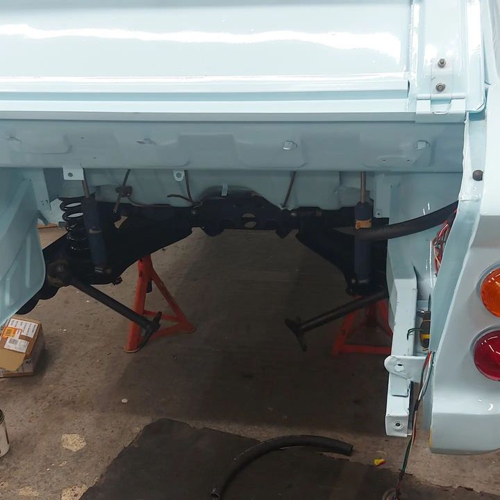

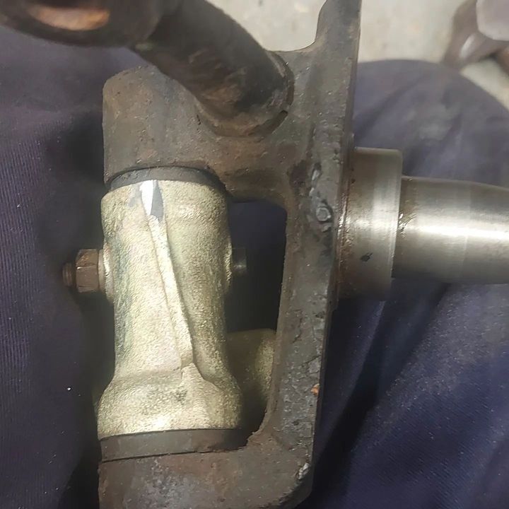

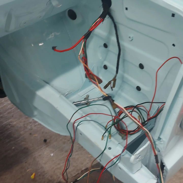

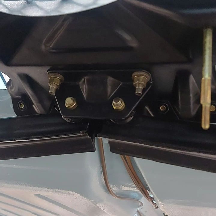

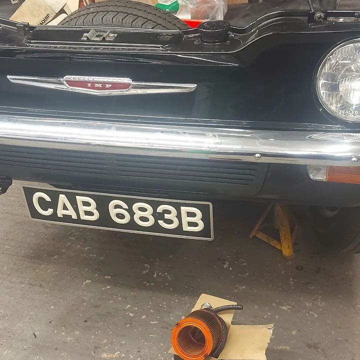

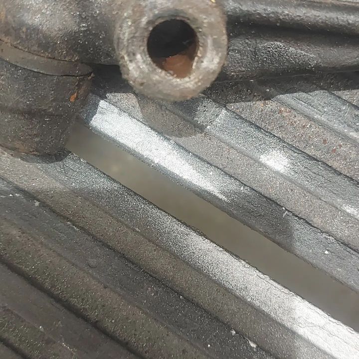

    This week's update progress on Steve Groves imp suspension all on and loom in plus 19mm bore water pipes in as the car is having a bmw 1100 engine, then in comes another for starting issues which was burnt points and a fuel pump that wasn't pumping all the time , and generally check over, where we found the front wheel could rock at a mad angle due to the stub axle having been drilled at some stage so replacement part fitted all good , bolt check on the front suspension revealed that none of the suspension had been tightened so the rears will now be checked along with every other nut and bolt on the car
