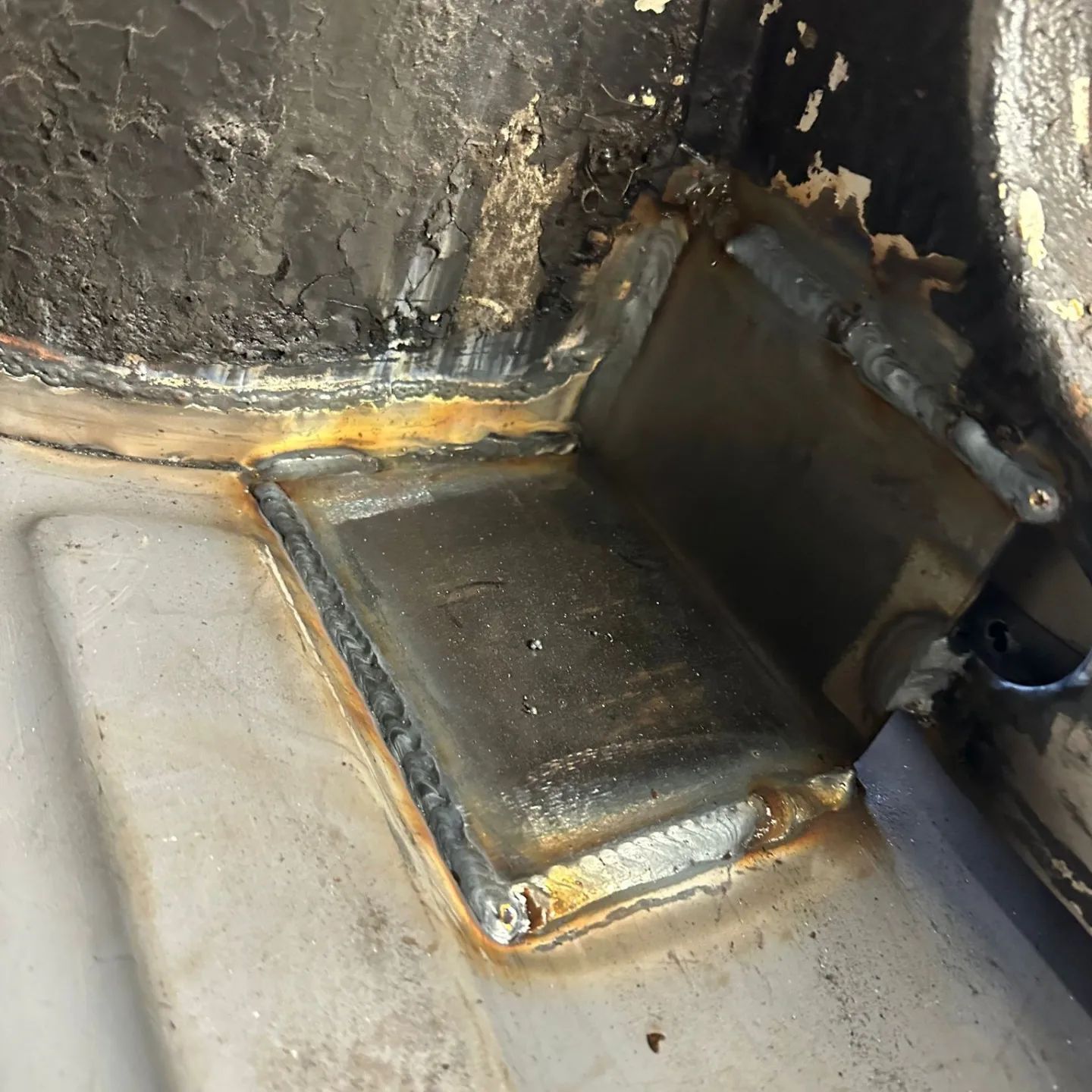

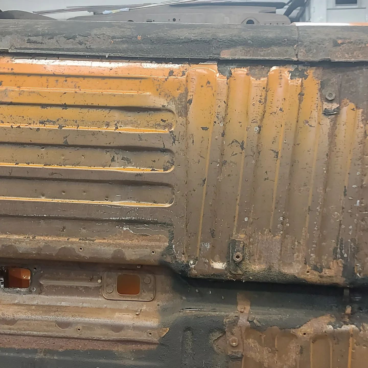

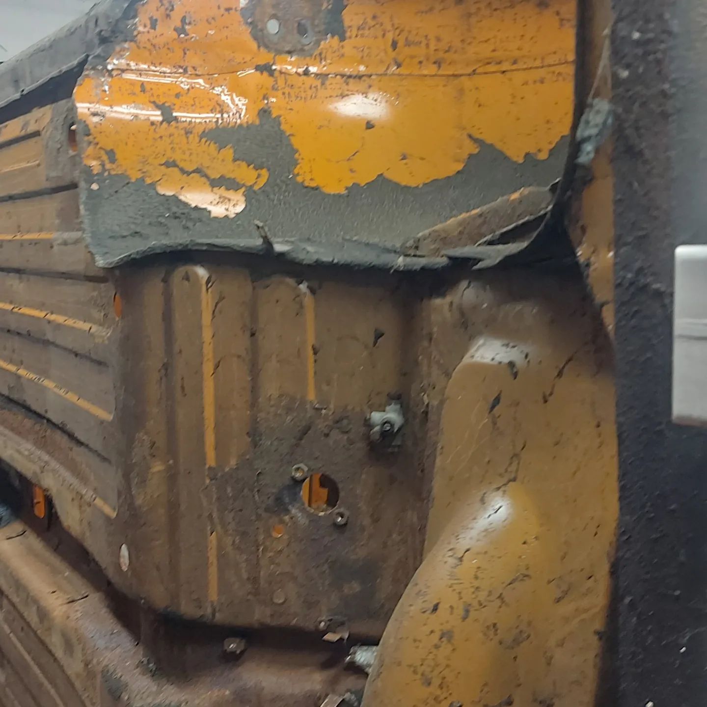

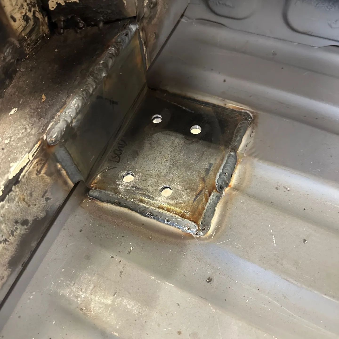

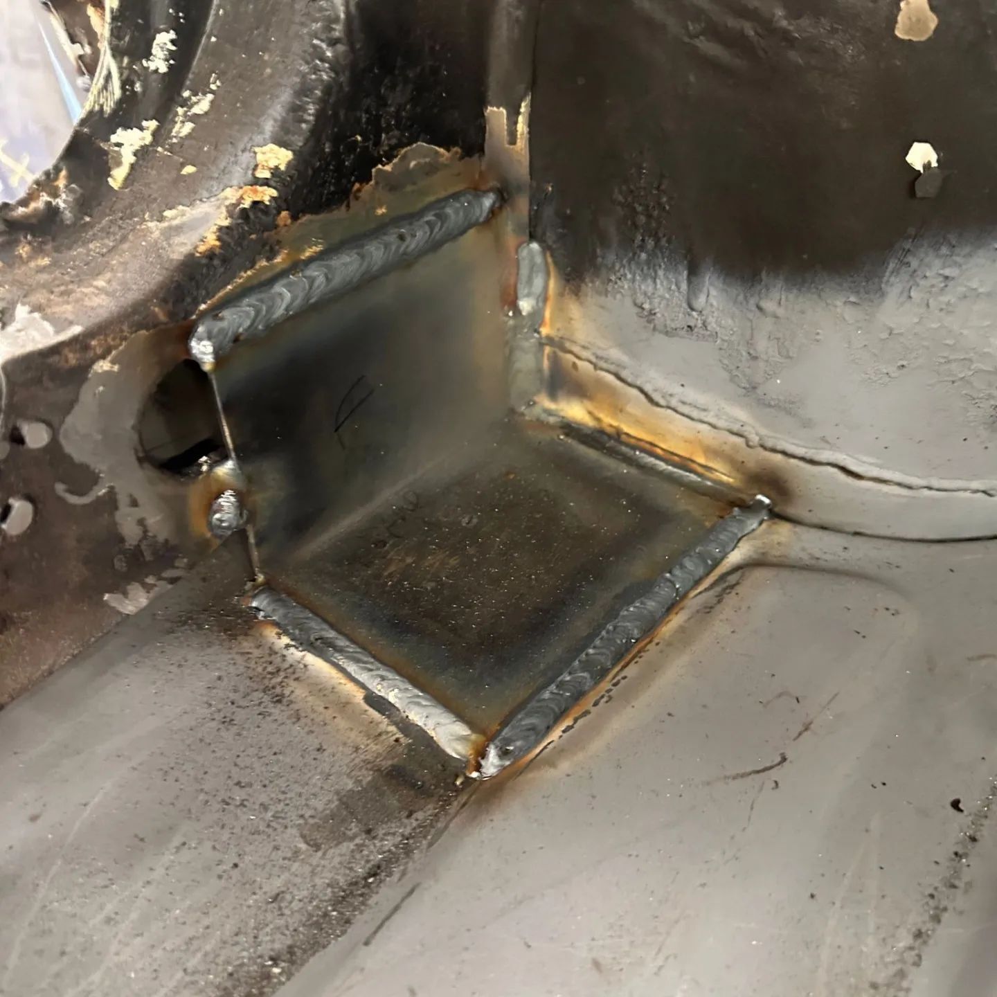

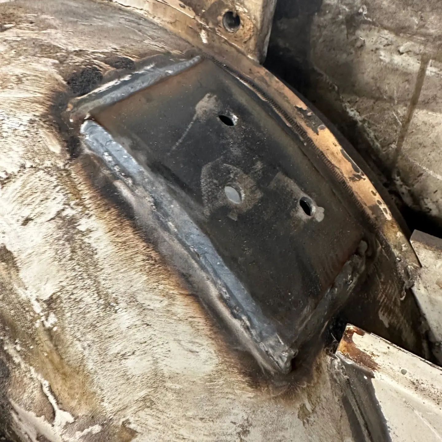

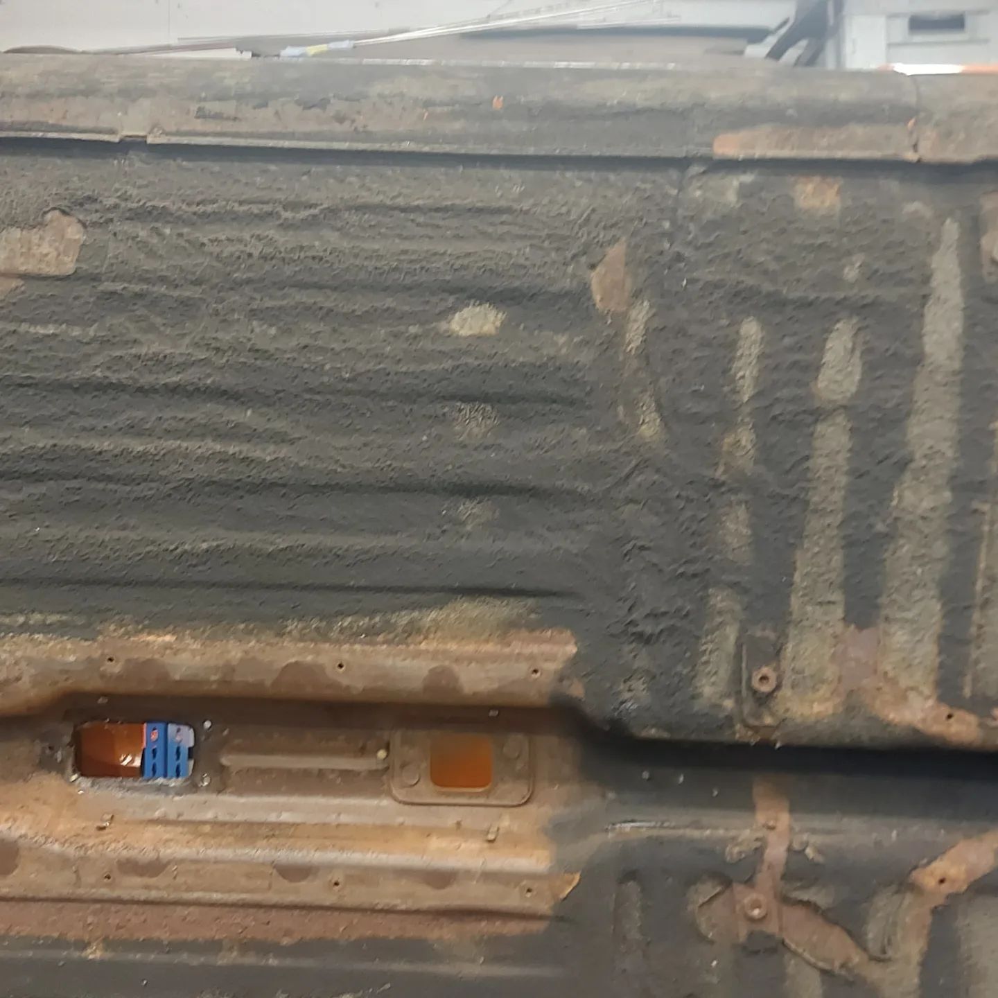

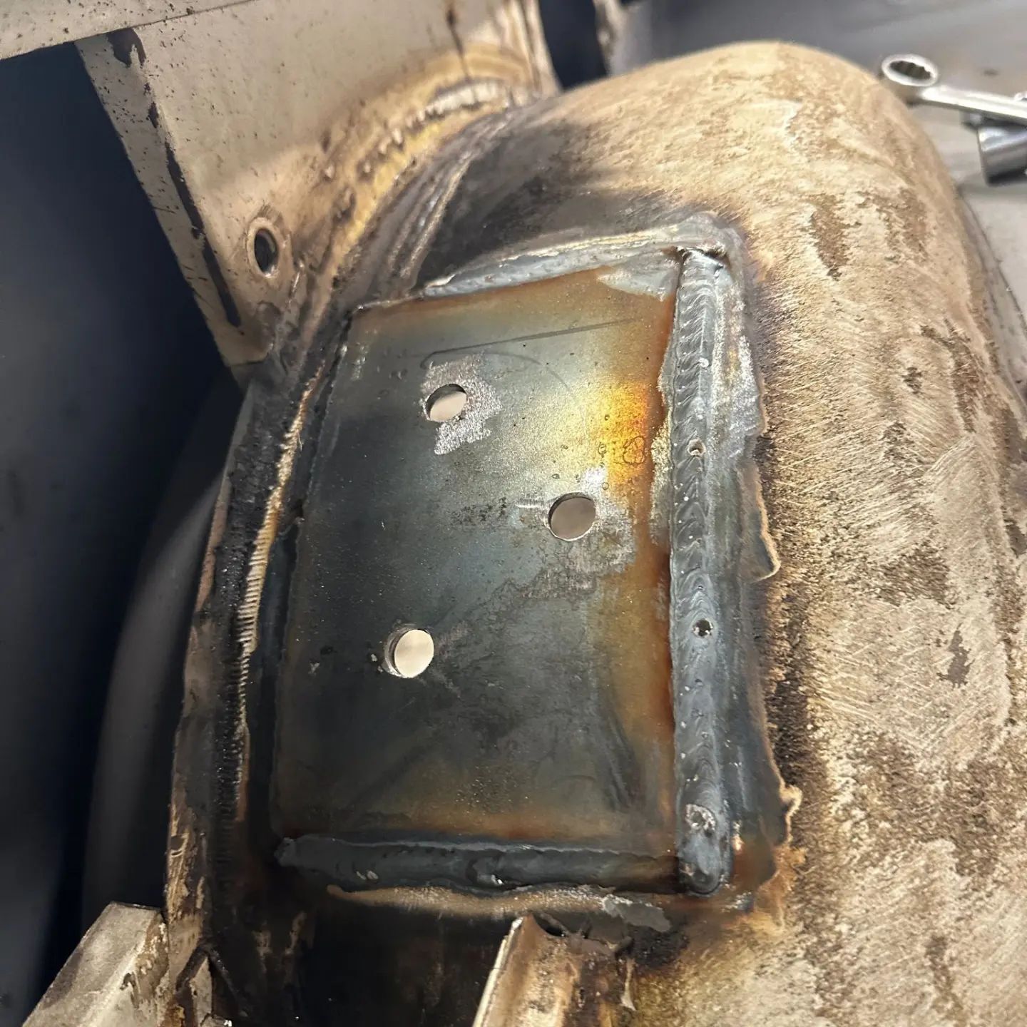

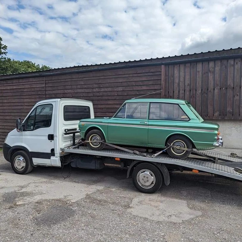

    Well us been a busy week at the workshop, we had a lovely #impsport in for a starting issue which turned out to be the wrong points which were making contact with the distributor body all sorted and the owner is back enjoying his car. The #apricot imp is fully stripped and underseal off and what a great shell floors are mint and sills so just a few sections needed on the wheel arches. The #hartwell imp has had new #rollcage plates fitted and just needs the new front wing and inner tub doing plus a few little bits then its off for paint. Have a great weekend all and enjoy
