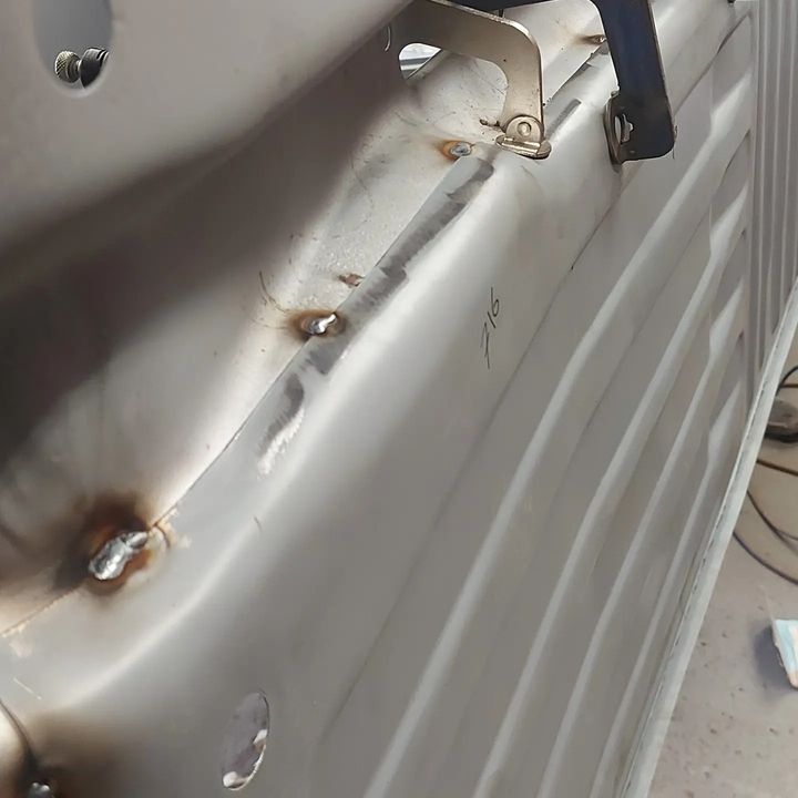

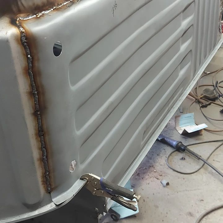

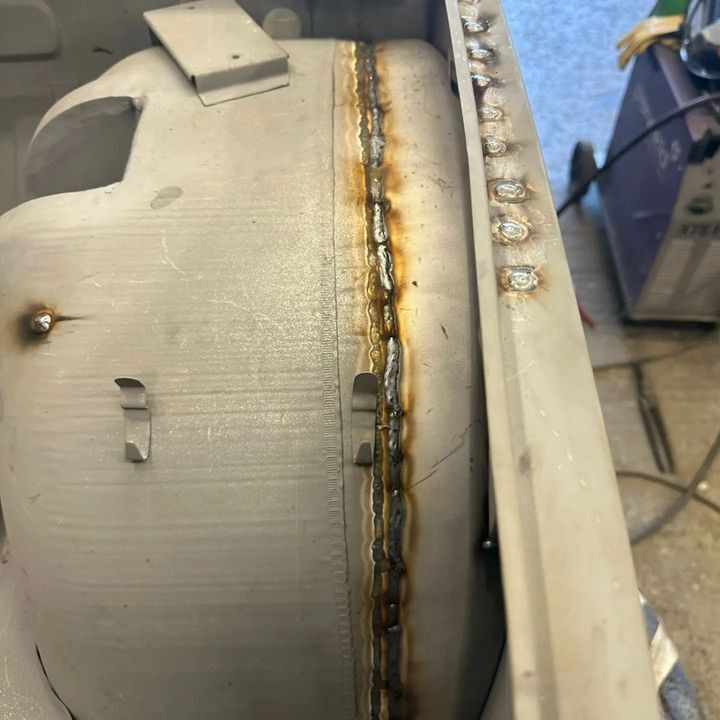

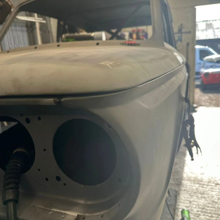

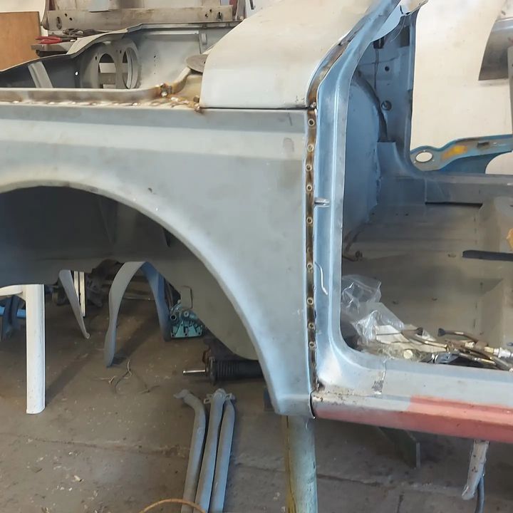

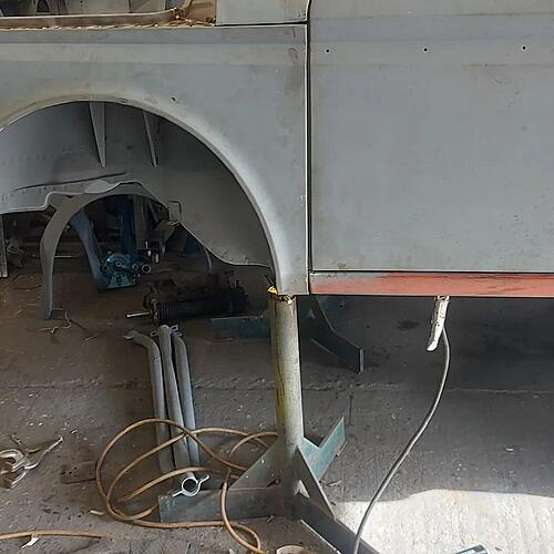

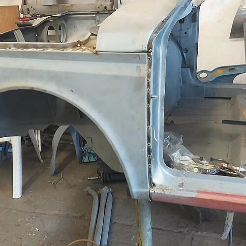

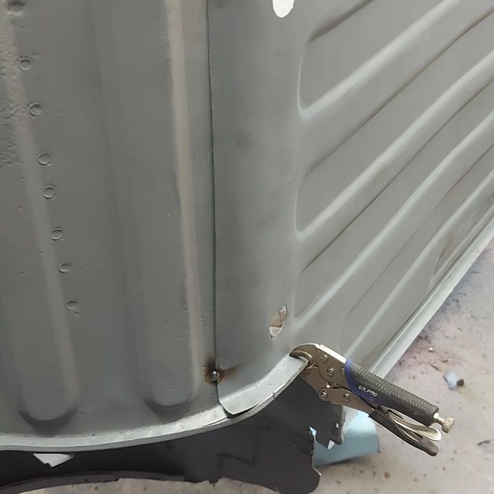

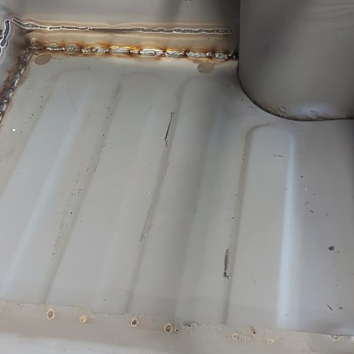

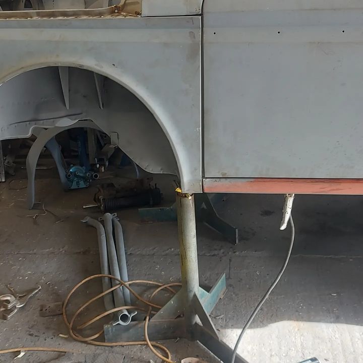

    Few pictures of this week's activities in the workshop so far ,Michael Loveland #impsport nearing the finish line big thanks to Vince Frost for helping me out with a new old stock wing to move it nearer to the paint shop and a new Ex-pressed Steel Panels outer repair tub , New customer Chris Charles shell in for a bit of paddy love to build into a #Classic Touring Car , new in from#Ex-pressed Steel Panels is the new half floor for the imp range and what a lovely fit ,so as it's a race build I decided to over lap and get 2 runs of weld , the seat pan is coming out so I can get a full weld on the inside as it's having a F.I.A seat mount fitted
