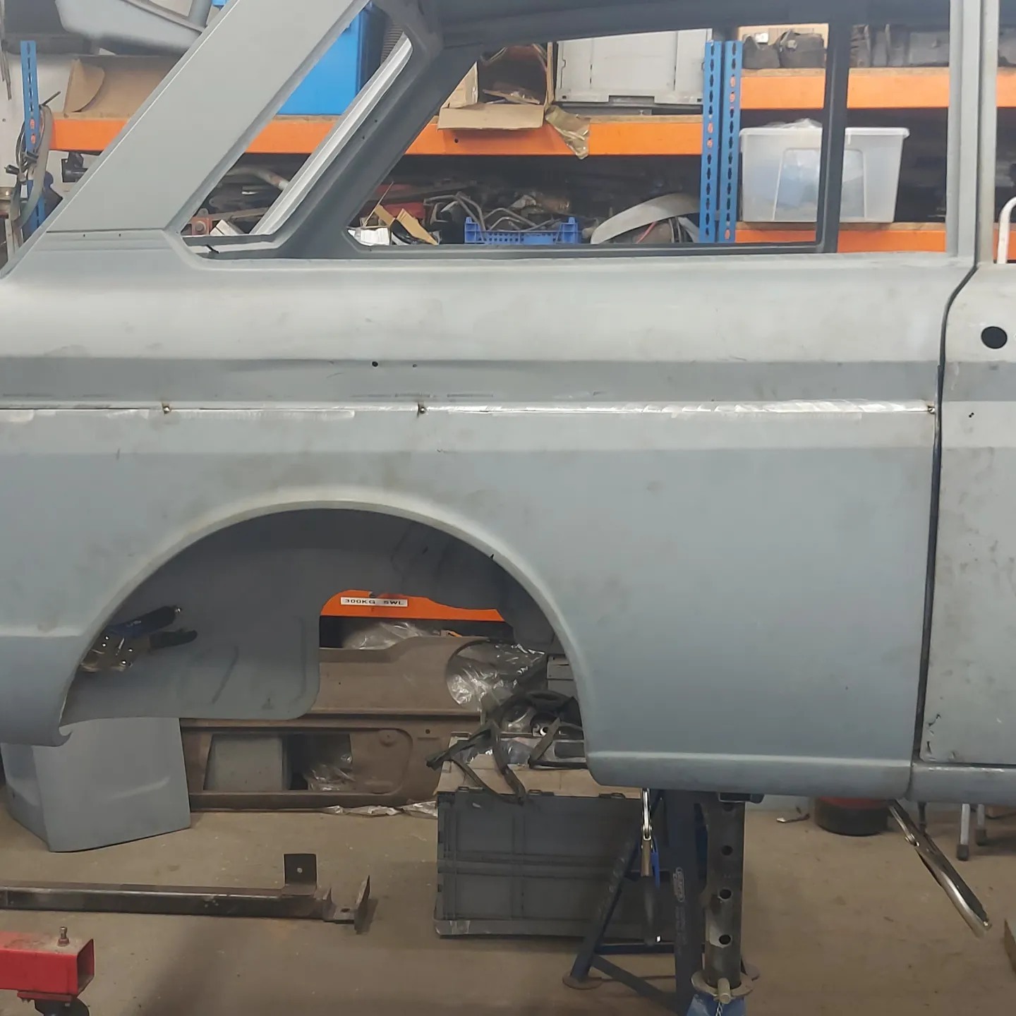

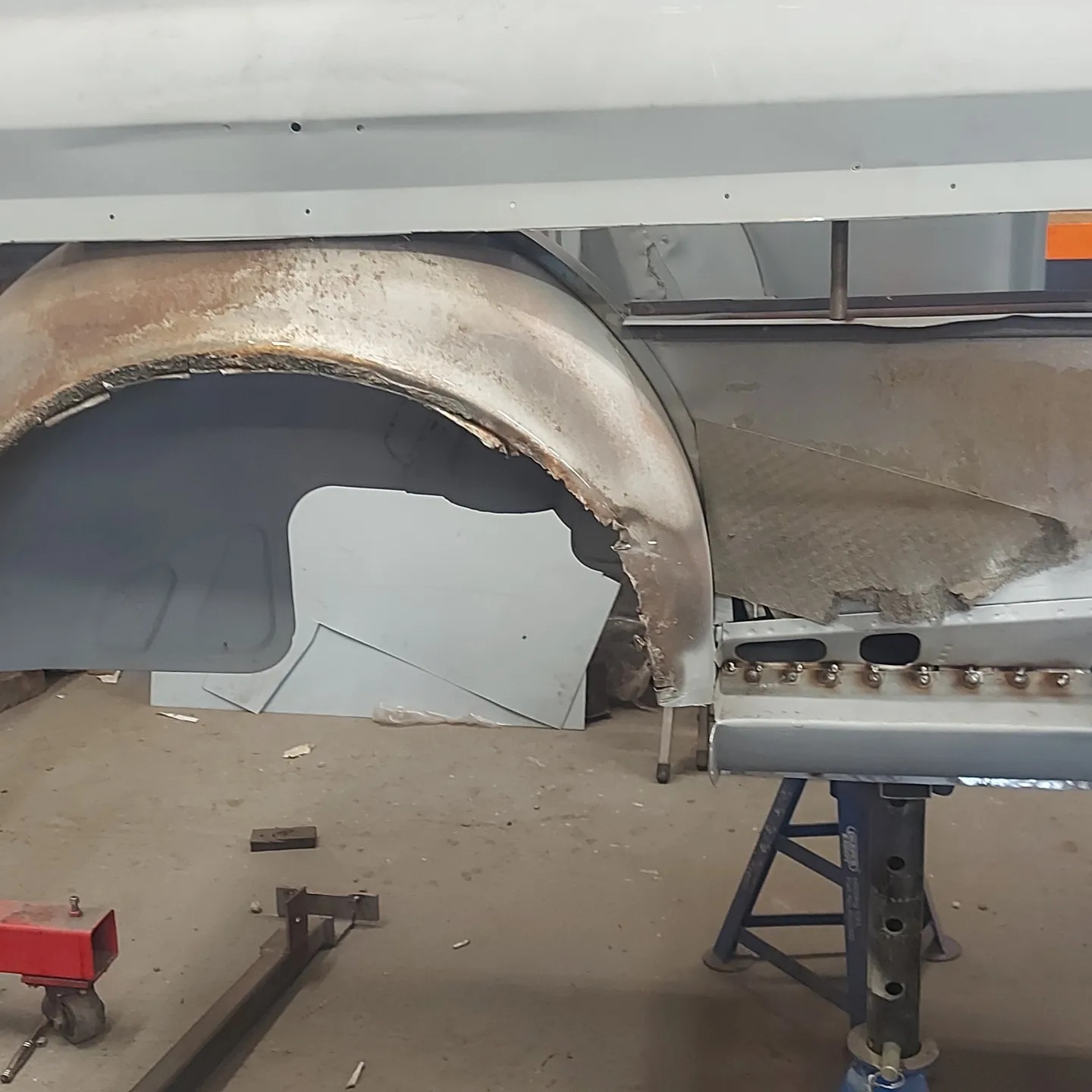

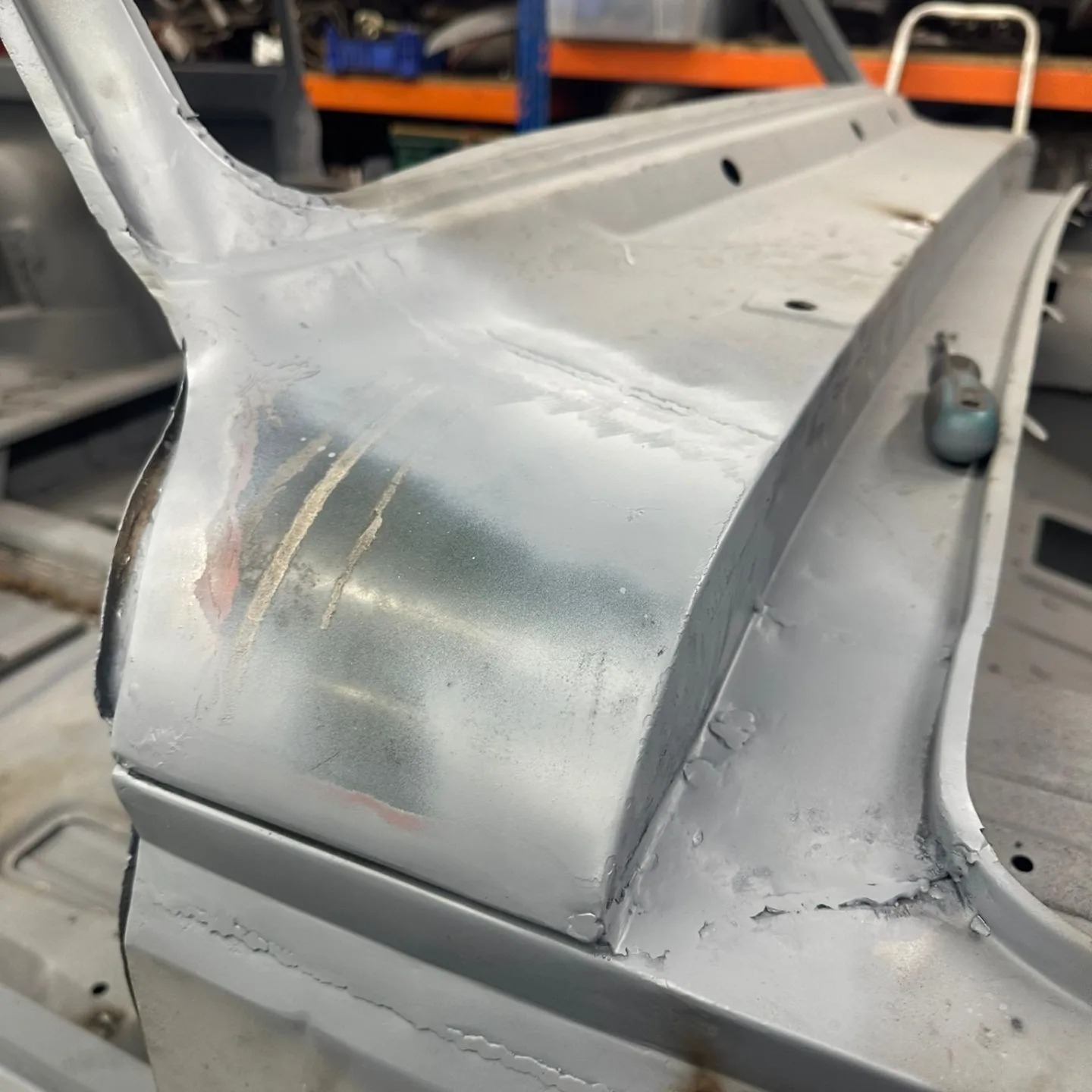

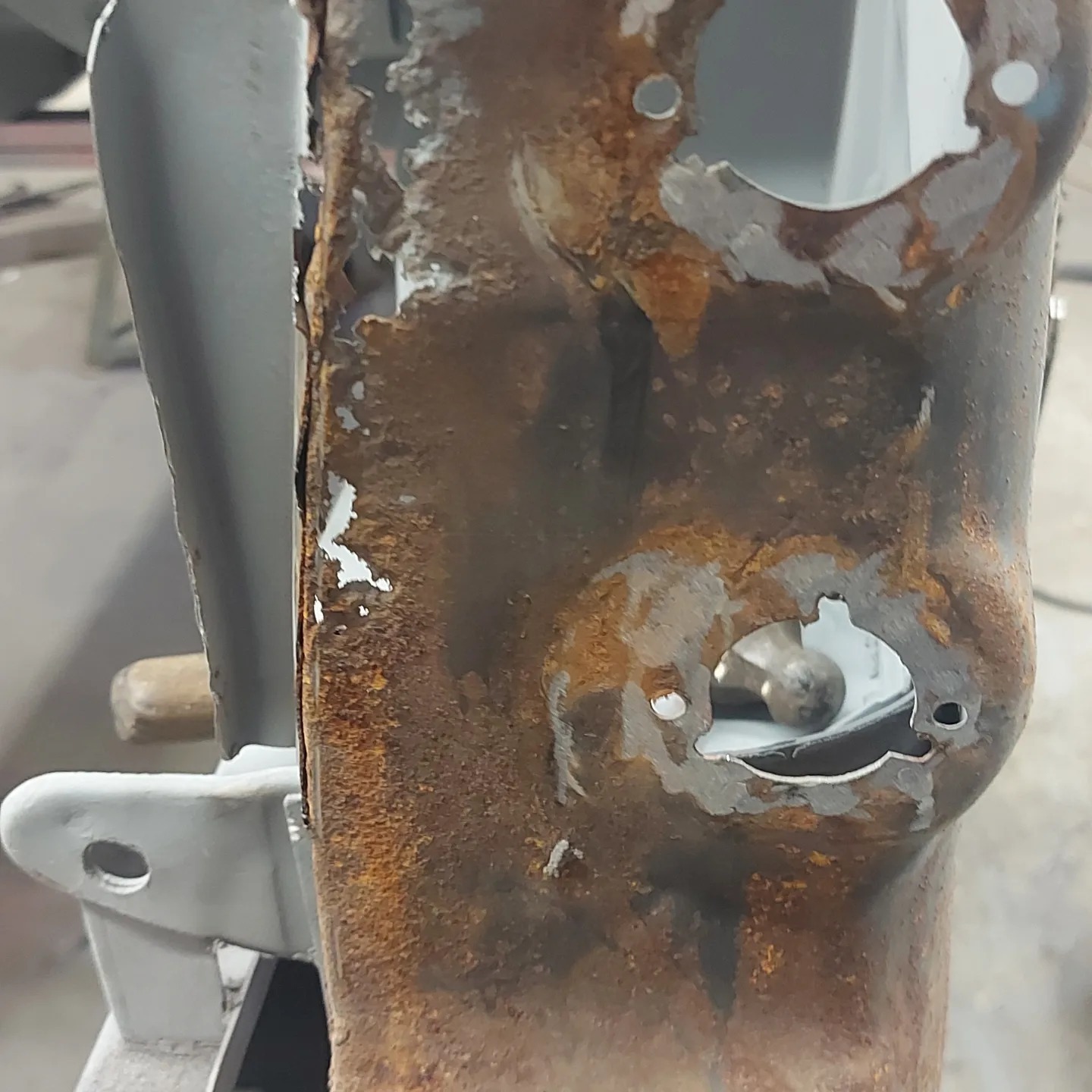

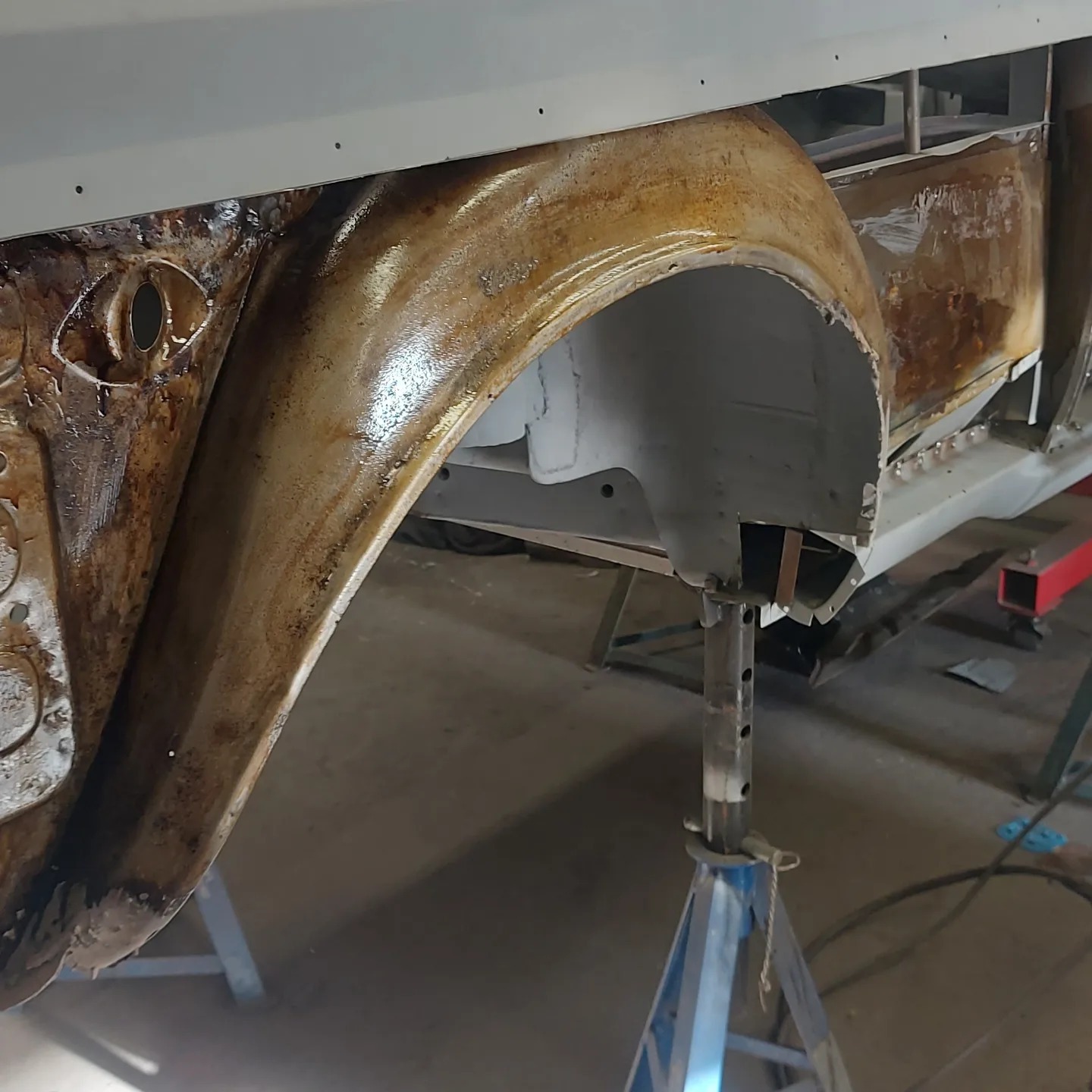

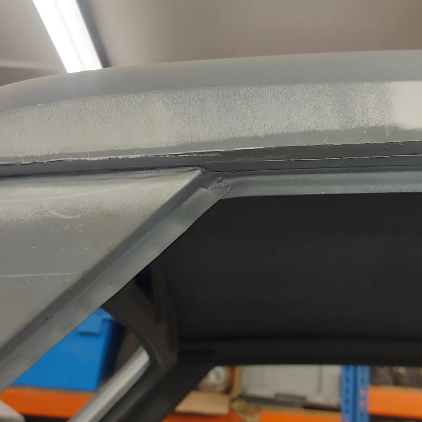

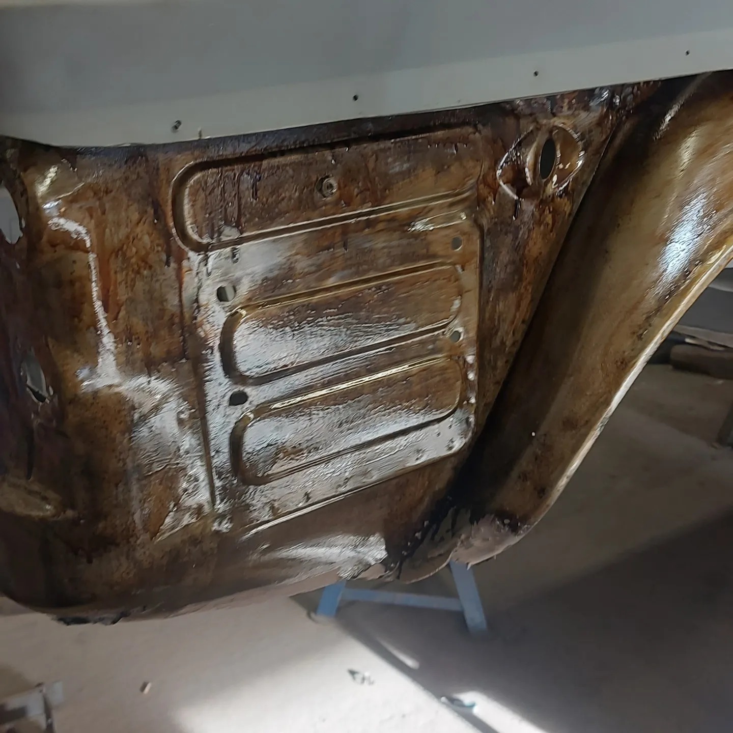

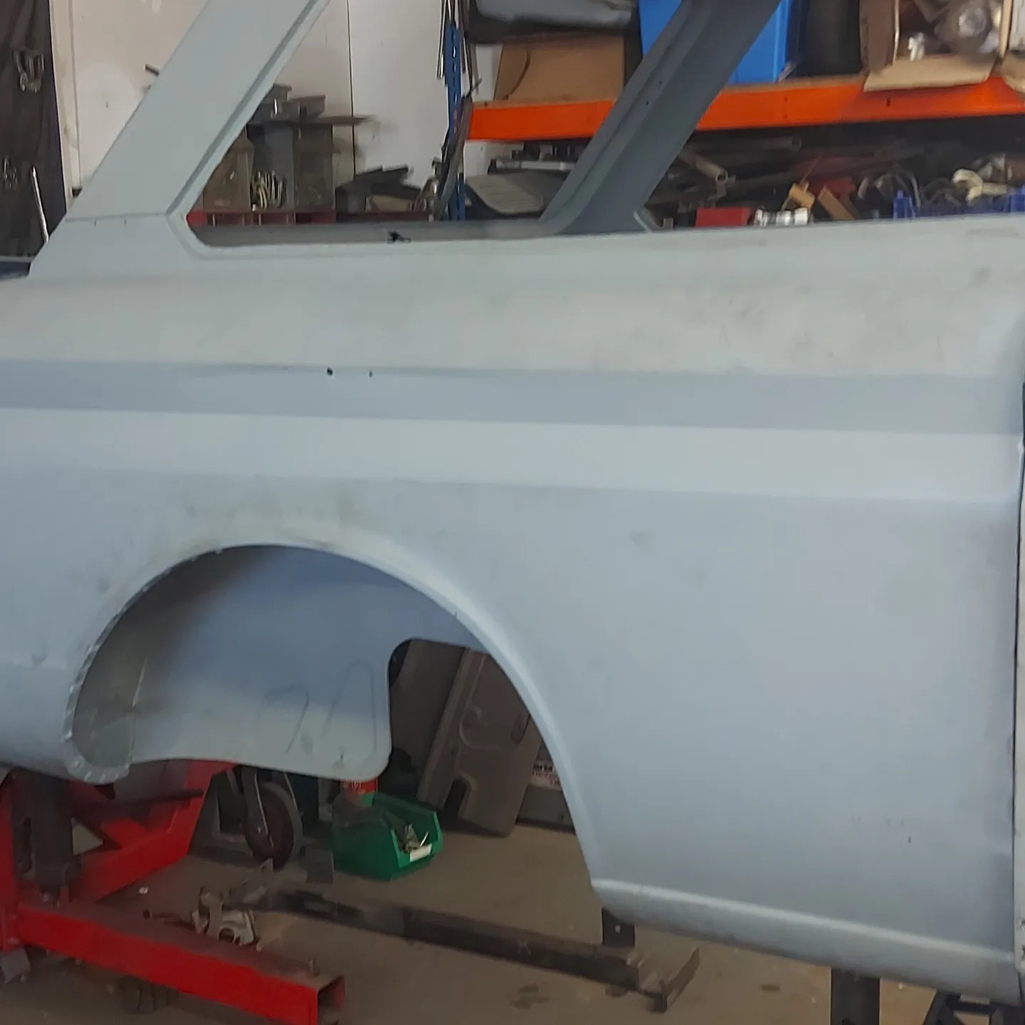

    This week work has been flat out on Chris patten #race imp #shell , after fitting new inner,centre and outer sill on the driver side it was time for a half rear wing from # Ex-pressed Steel Panels to go on once the outer rear wheel tub was repaired and the inner rear wing , also we let a section of scuttle and little bit of the pillar in from a donor shell ,funny thing is the donor bit was like new inside due to having been waxed , some roof gutter repairs as well its amazing what the paint was hiding on this car as Chris only bought it a year or so ago as a restored car , 1 persons idea of a restoration is to fill all the rust holes and bodge it up , we also had a visit from #imposter the 1 and only in the world we are told for some box section to mount the seats the car has been off the road for many years but is now getting close to its return , I will keep you all posted when pete is finally finished , have a good weekend all and stay safe at them firework displays
