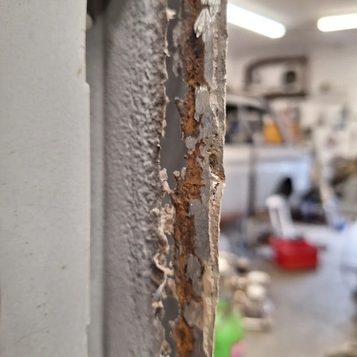

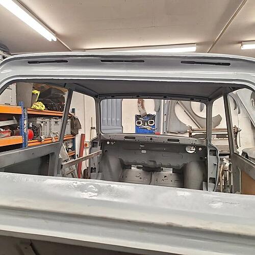

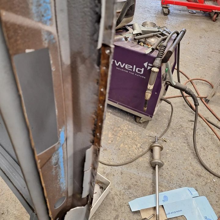

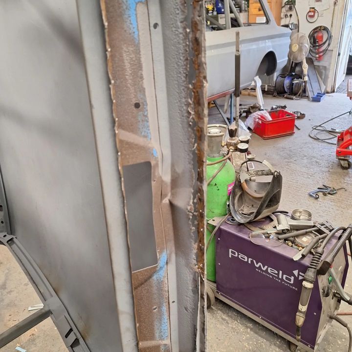

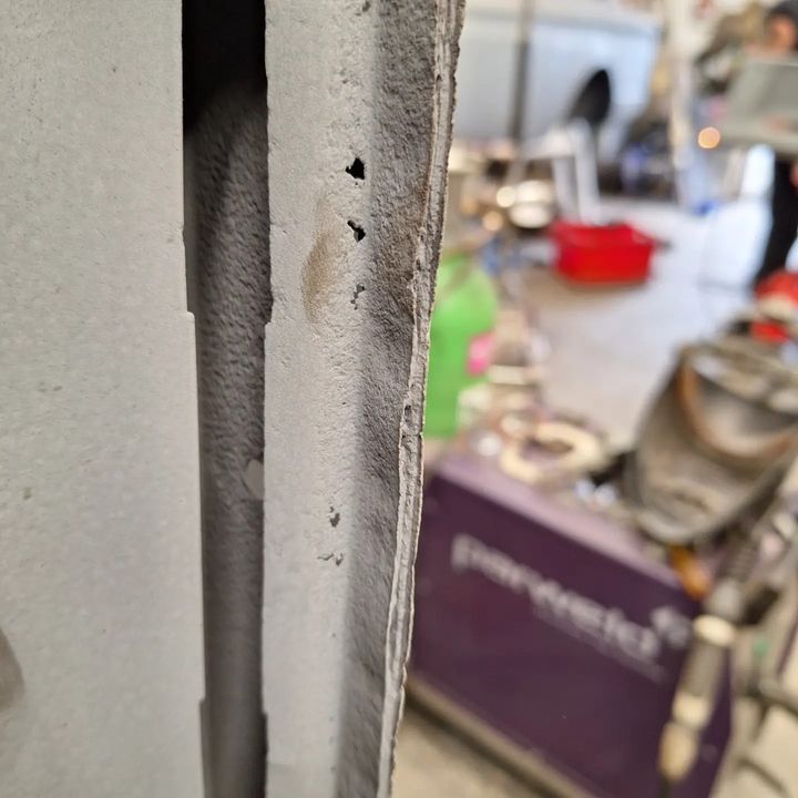

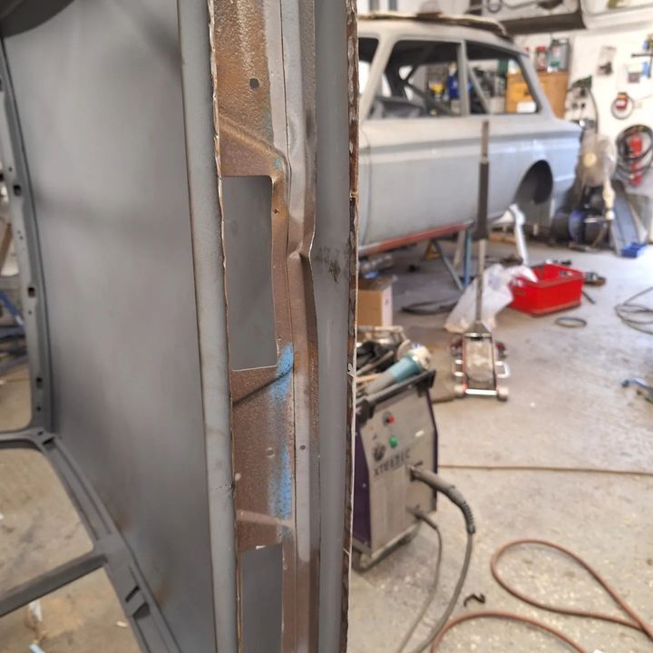

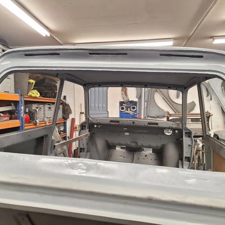

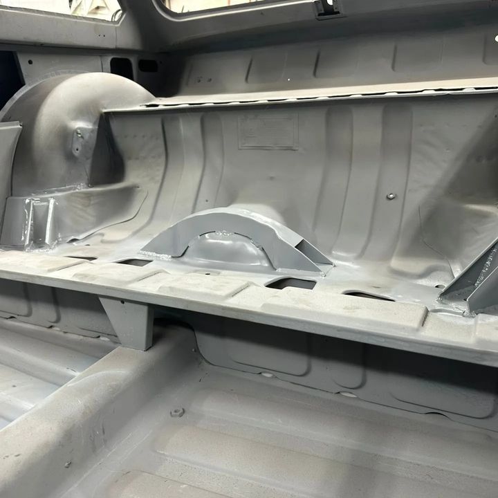

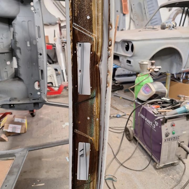

    Bit of an update on Chris #race imp ,the rear scuttle had some rust issues at the top on all 3 vents plus the inner panel was rusted so the decision was made to remove the top outer section and repair the inner , then replace the outer and repair the sections above where the chrome vents live , also some floor strengthening so to tie the suspension cross member into the car this idea is stollen from Mike Hanna thankfully Mike dosent mind us taking his ideas
