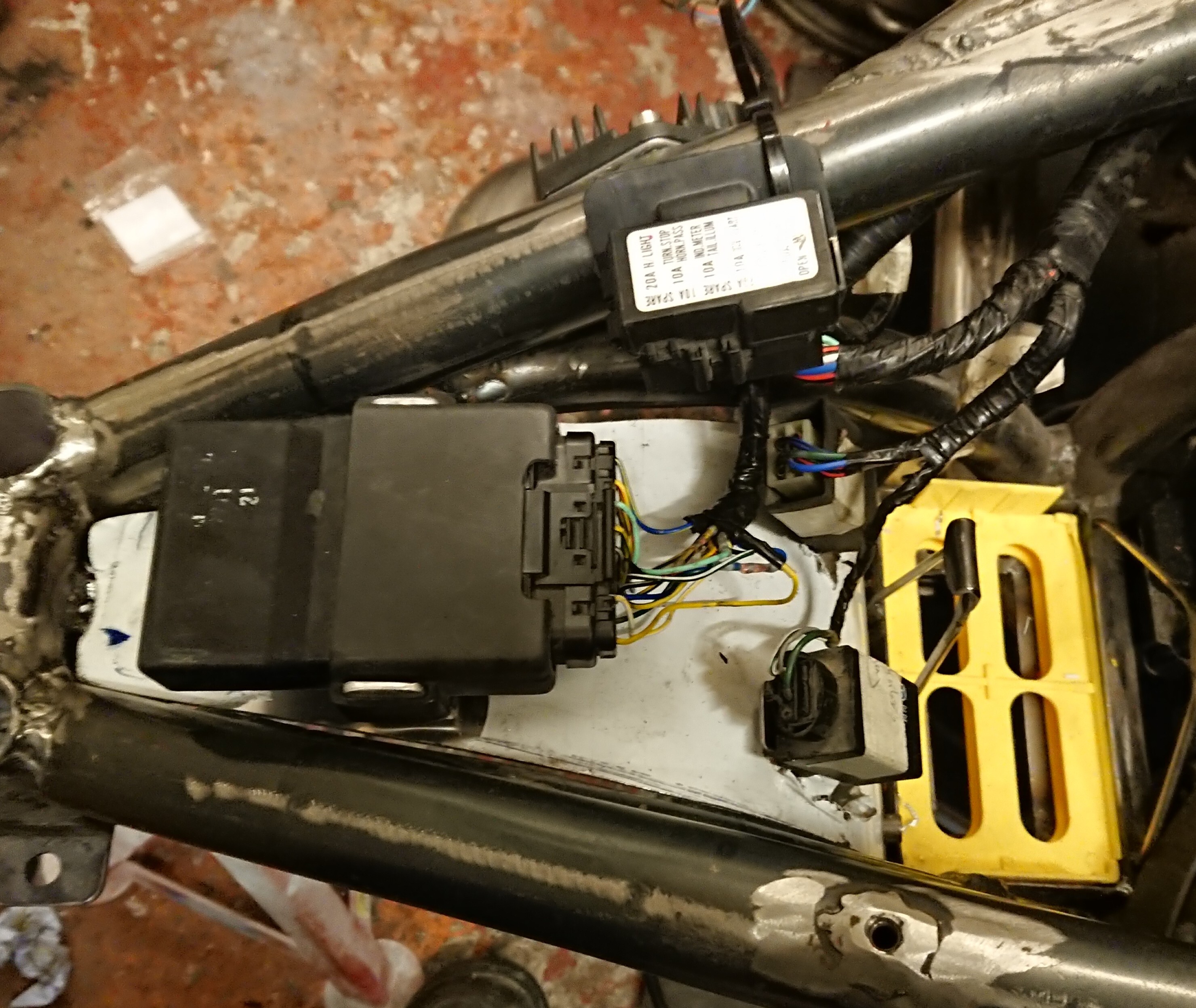

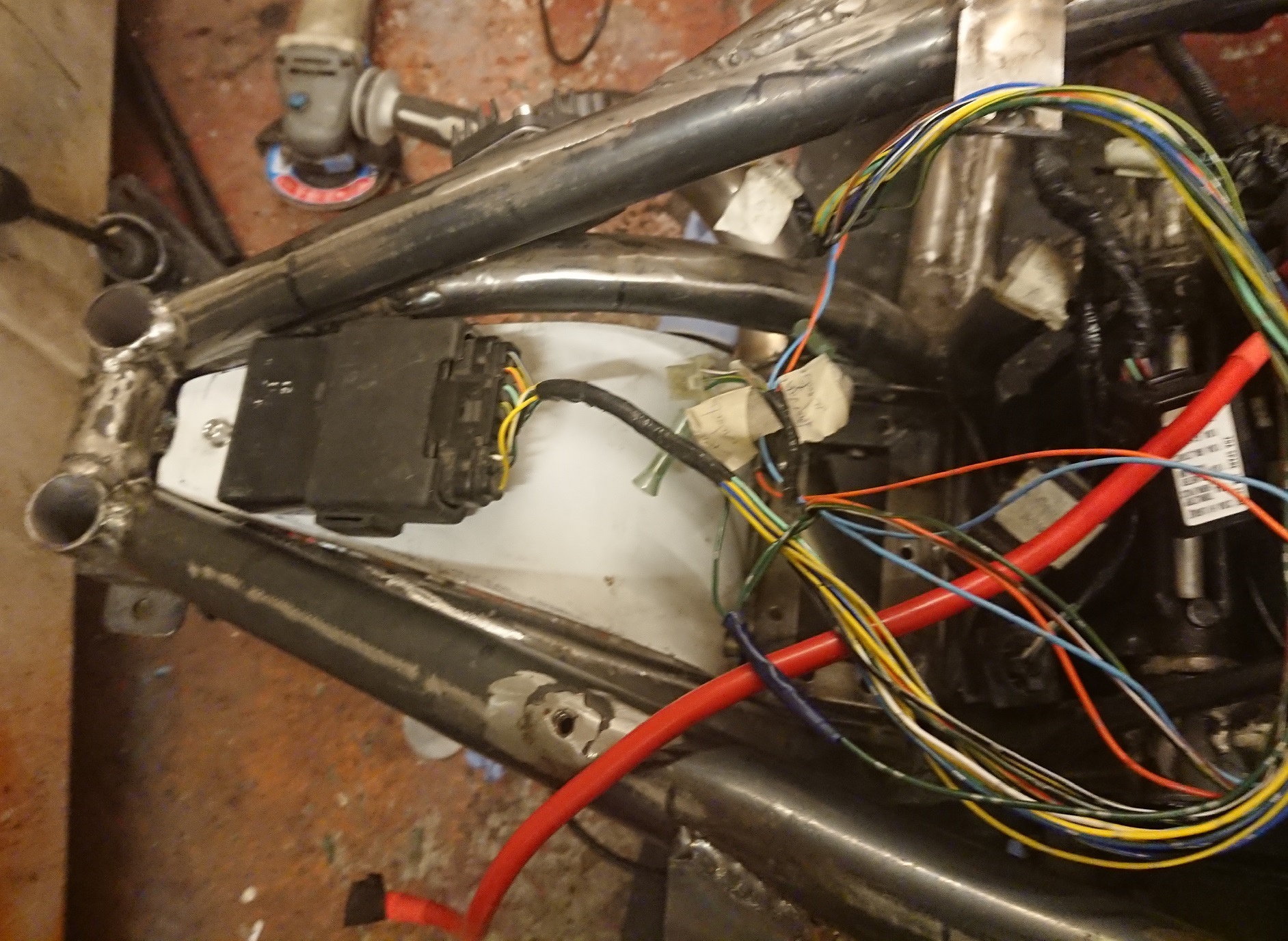

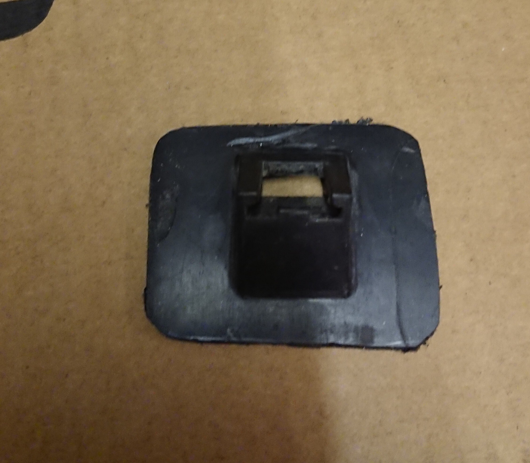

First I made up an alloy heat shield plate and mounts/tabs welded to the frame that I could mount the CDi unit on behind the battery. I still need to make up a little bracket so the original rubber holder for the CDi can be secured to. Later today hopefully.
You can see I have partially stripped the wiring to be shortened too.

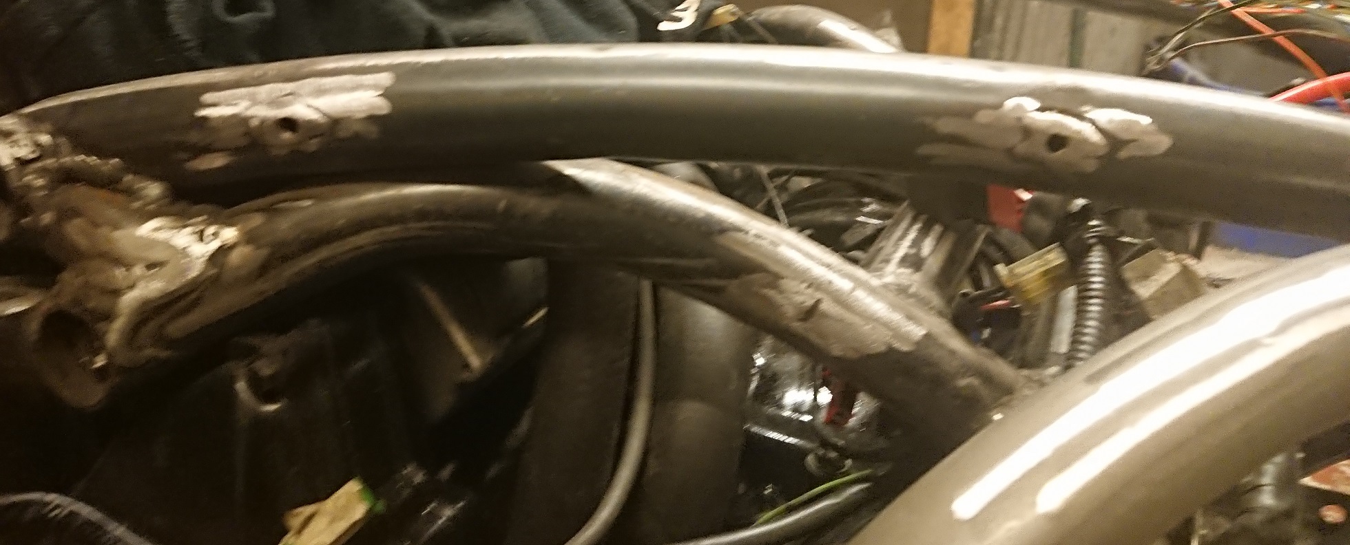

The wiring loom will run behind the engine so it wont be seen so easily, trying to make it neat so drilled the frame and countersunk some flanged nuts into the frame. Probably use some P clips to attach to the loom there.

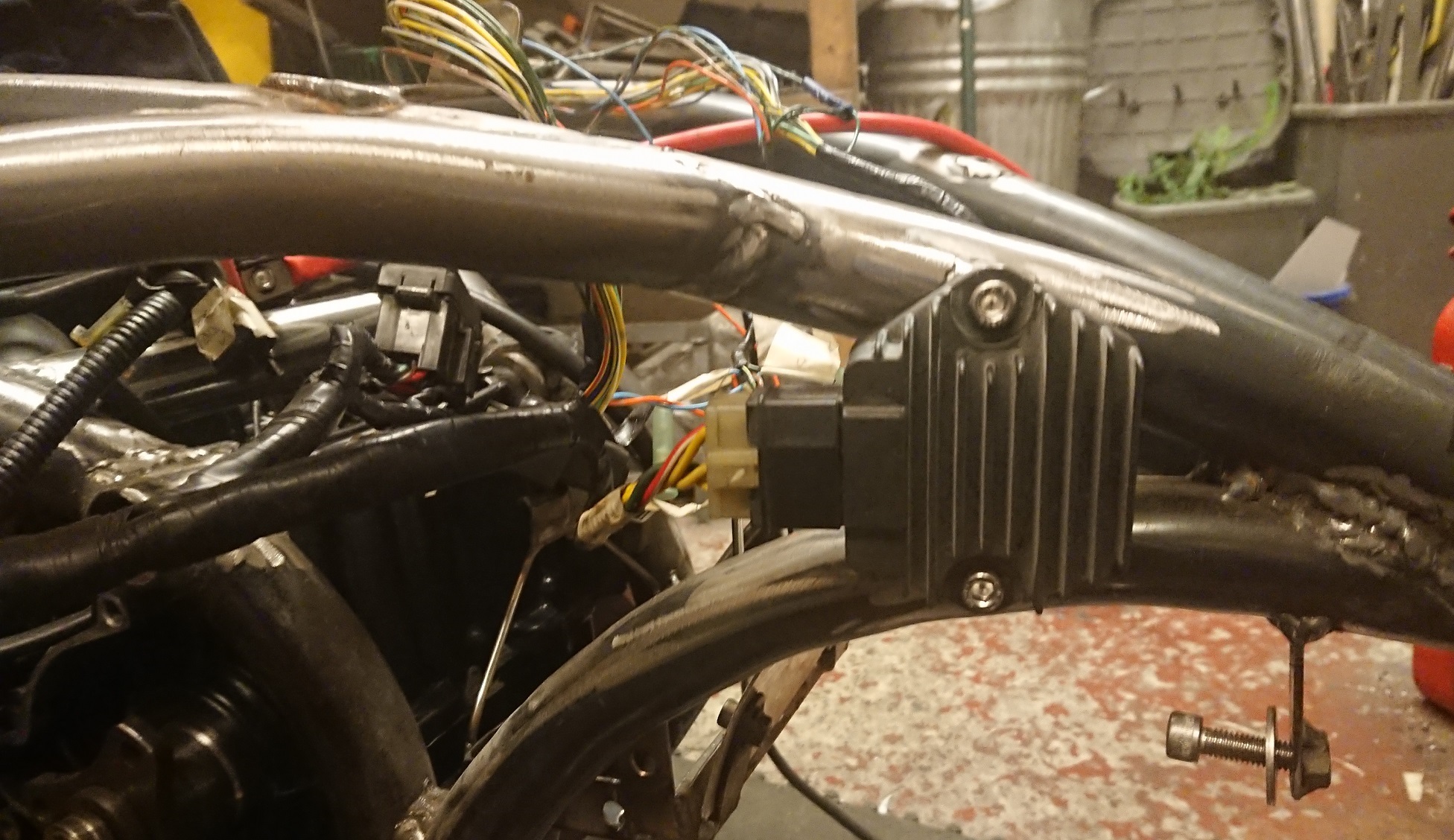

Then I did the same for the regulator, it saved putting a plate onto the frame so positioned iot where I could use more countersunk flanged nuts.
