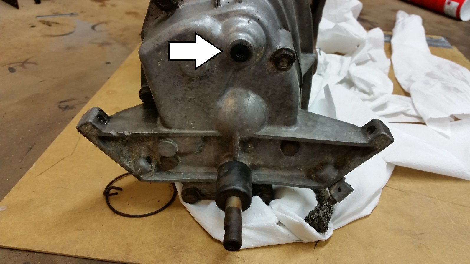

thanks John, have ordered some new oil seals from club and will order some new oil. Do I just pull the old oil seal out? It’s a bit vague in the workshop manual. Oops maybe one question today!Originally posted by John A. Ross View Post
If what is there is working fine, no gear change isue, no whine, not weeping oil all over the shop I would be just wiping its back side, few oil seals, new oil and back in it goes.
Ah, need to be careful, the side seals can only go in so far, Dave Lane had dimensions for the hub oil seal tool, gives an idea on how to refit them.
The input shaft seal nedds to come out carefully and like the side seals it can actually be tapped all way back into the gearbox.
I have a bit of tubing i welded some flat plate onto and took out a largish holes, it locates over the input shaft and not only pushes the seal back in even but as it is slightly bigger, it stops at the casing so you know its home and no more needed.

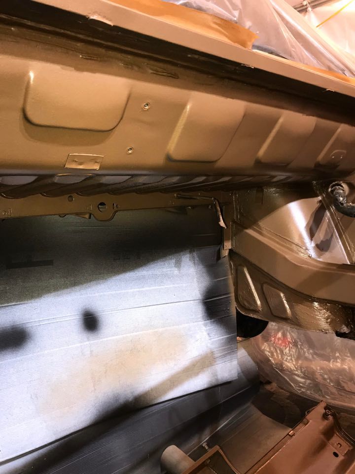

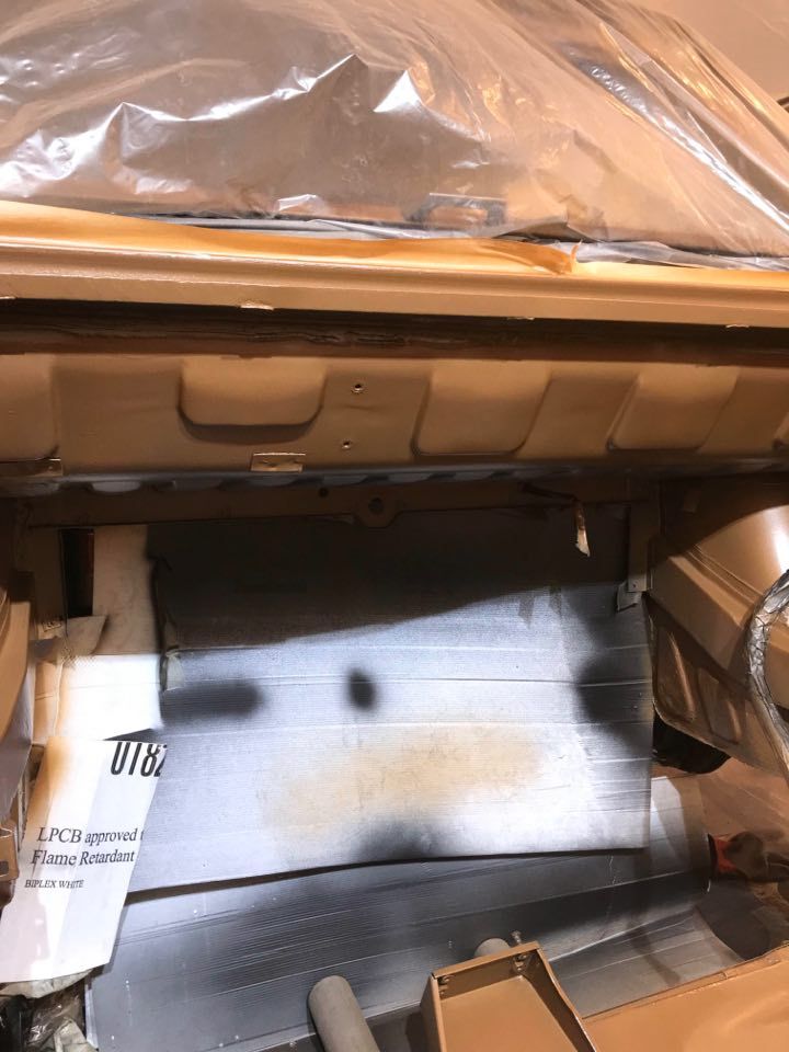

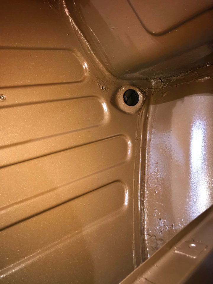

Raptor is not a top coat so goes on with a little texture anyway.
By tint I mean actual Glenalmond Green paint.
You would mix the "tint" first so if its 2K you would need to mix that first, then add the volume to the raptor mix which is 4+1
As it fills the bottle and leave little to mix with I had Jim use 1/2 Raptor kit first, add tint, thin 10% and he just sprayed it on.
This is Jims and he prepped tis all himself (he hates paint)
I like the finish.
