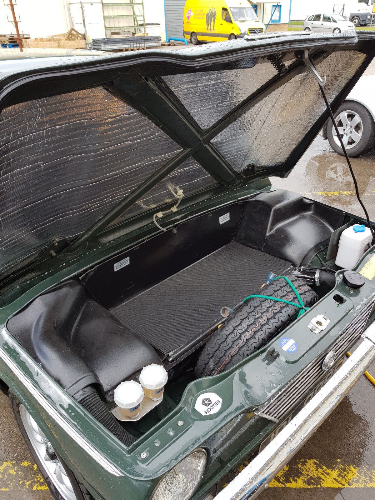

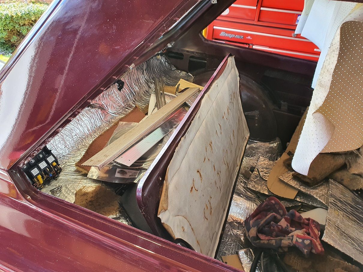

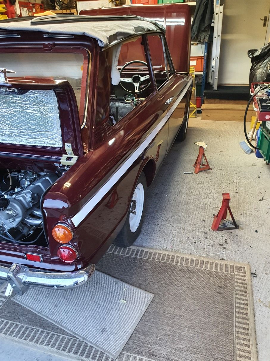

Bonnet wise its original bits, bit of a wipe down, some stone chip on the paper panels and some satin black works wonders
Hope I do not have to take it apart that often.
I spent more time on George the chammy, with a view to making it look "standard" except the spare wheel retaining strap which was very high tech indeed
but suits the car

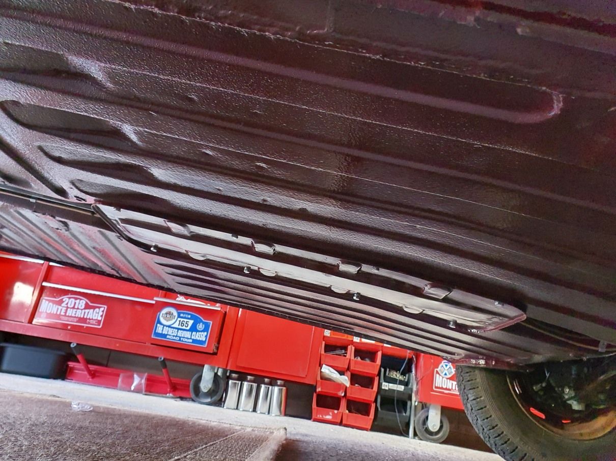

The deadening I used in the engine cover looked much better, downside is it was too heavy and as it was intended for floor, kept falling down as no matter what adhesive I used it would not stay, eventually it was put on with acrylic so wont be budging again.

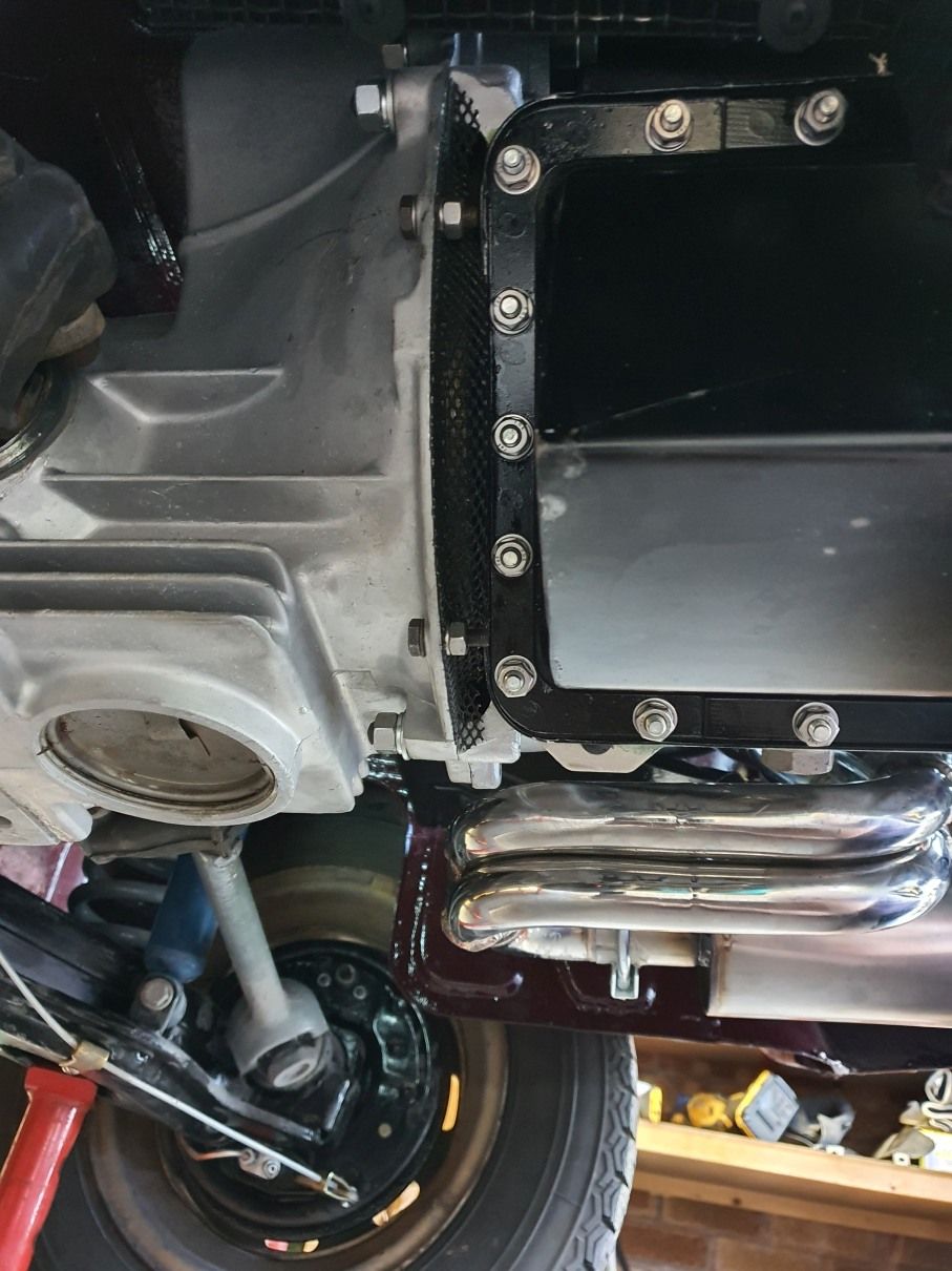

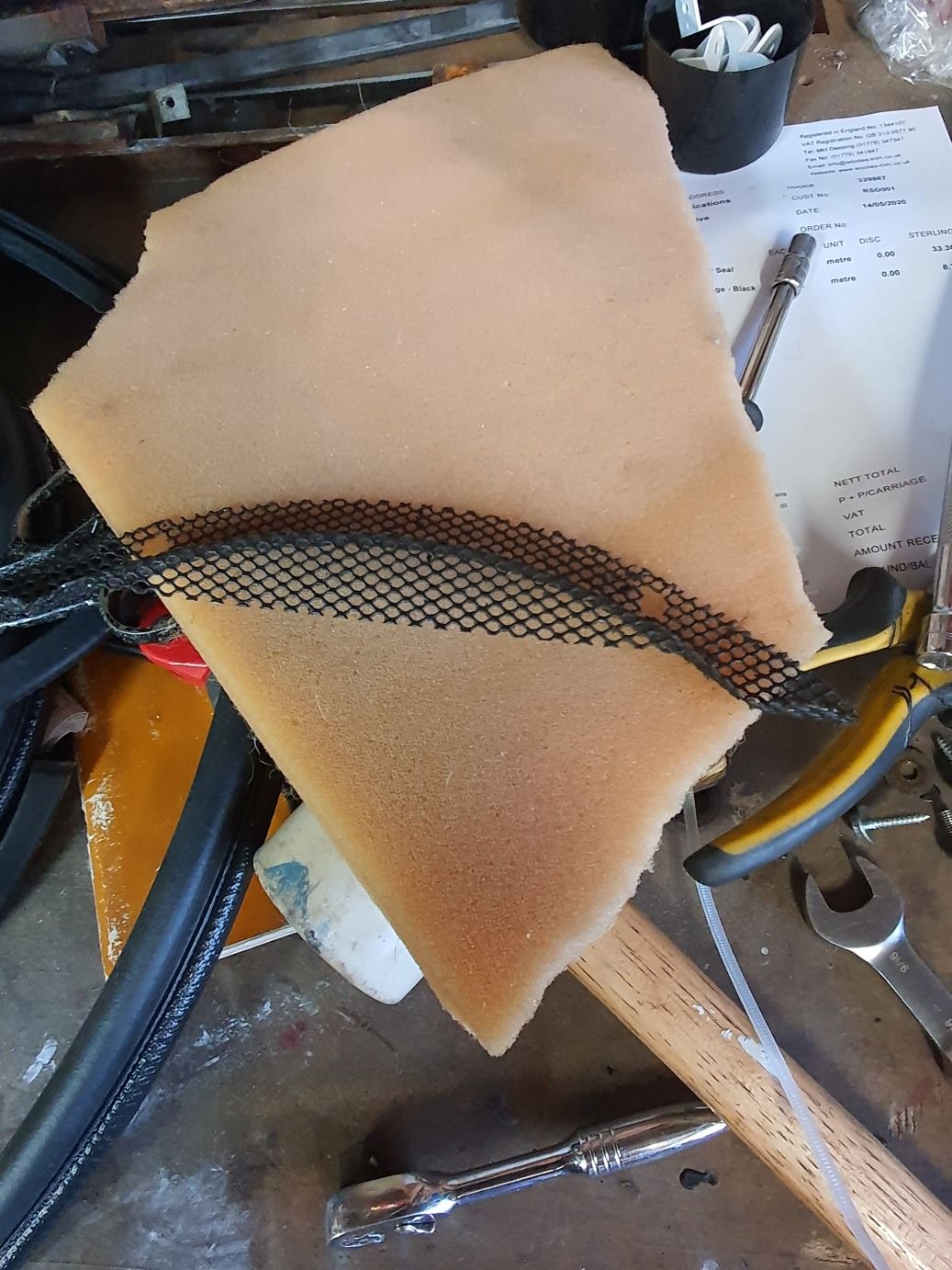

Yes stainless mesh will cover the exit aperture for the front Aux radiator ( Audi A3/ VW Polo heater matrix ) you can just see the cut down fluid pipes.
