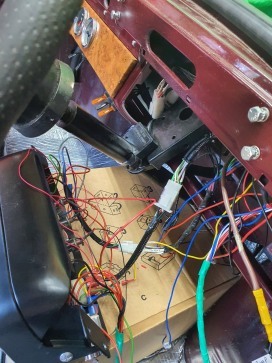

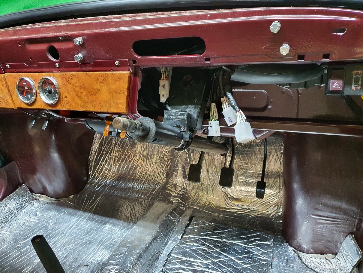

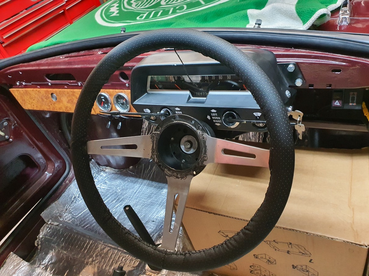

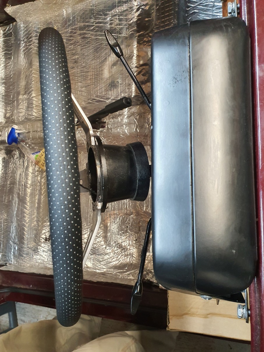

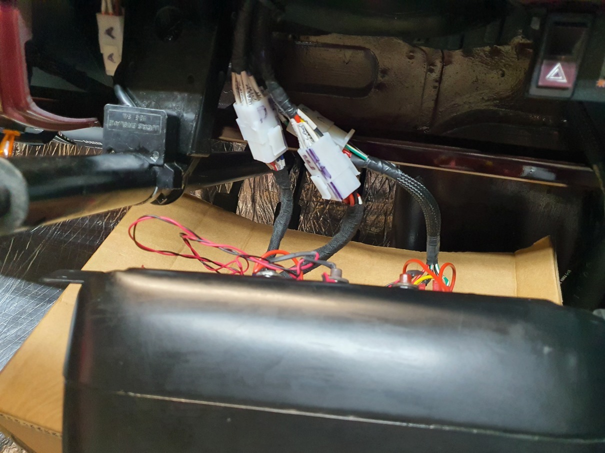

So I decided to add the pawl unit and indicator controls to a 6 way connector as the wire group of pawl plus indicators just fitted a 6 way so well.
Hopefully the other connectors turn up tomorrow and i can get the binnacle finally done.
And the Hazard light controls also now all in, everything working great including the pawl unit
So far so good !

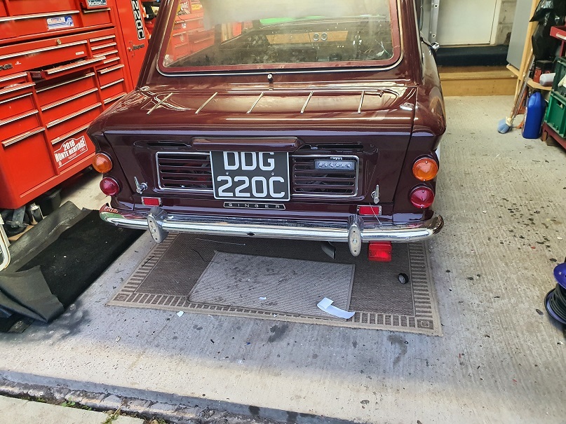

Originally posted by Petowner View PostIt was the reversing light on DDG i was referring too when l asked what make it was?
Ah OK
It was these I bought from Ebay, were £7.50 a pair when I bought these now £10 !
They are very bright though Bob, was thinking hiding a set under the front bumper to be honest/ John

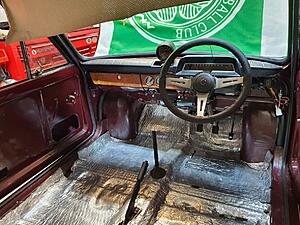

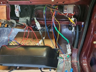

Wiring finally tidy up and ready to connect
Binnacle hung and fitted
Just need to make sure nothing is "on" that should not be with ignition switch off
So far only failure has been the main beam warning lamp, seems not to be working. No idea why, as it is LED indicator I used finer wires than normal so will need to get a better look tomorrow.
Small casualty though, the foam I used to rest the binnacle on seemed to melt itself onto the lacquer I used on the indicator stalks but as i can remove the binnacle anytime now with ease, will leave that as a later fix.
Second casualy was the NOS lucas wiper switch i bought, gave up at second use, spring inside feels like it went for a walkso had to change that up

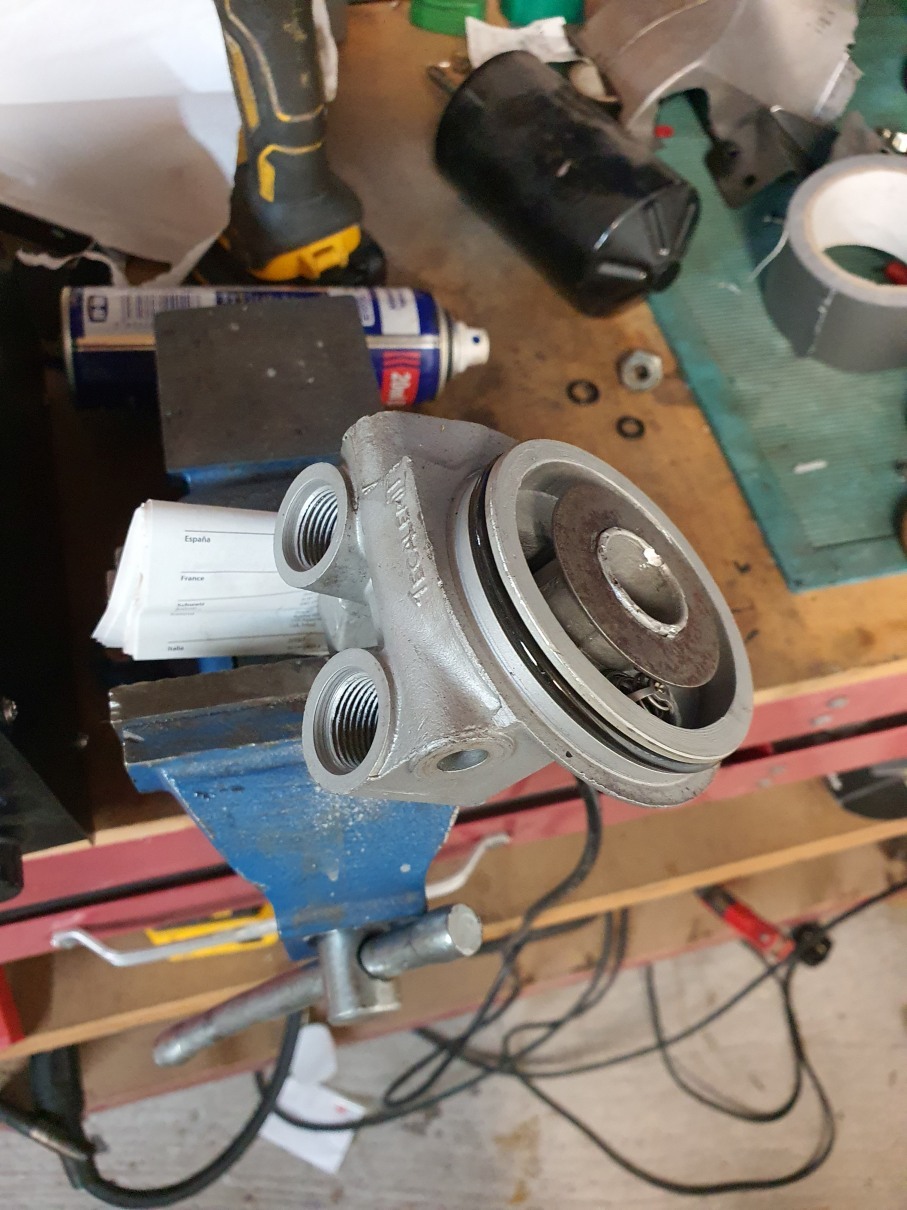

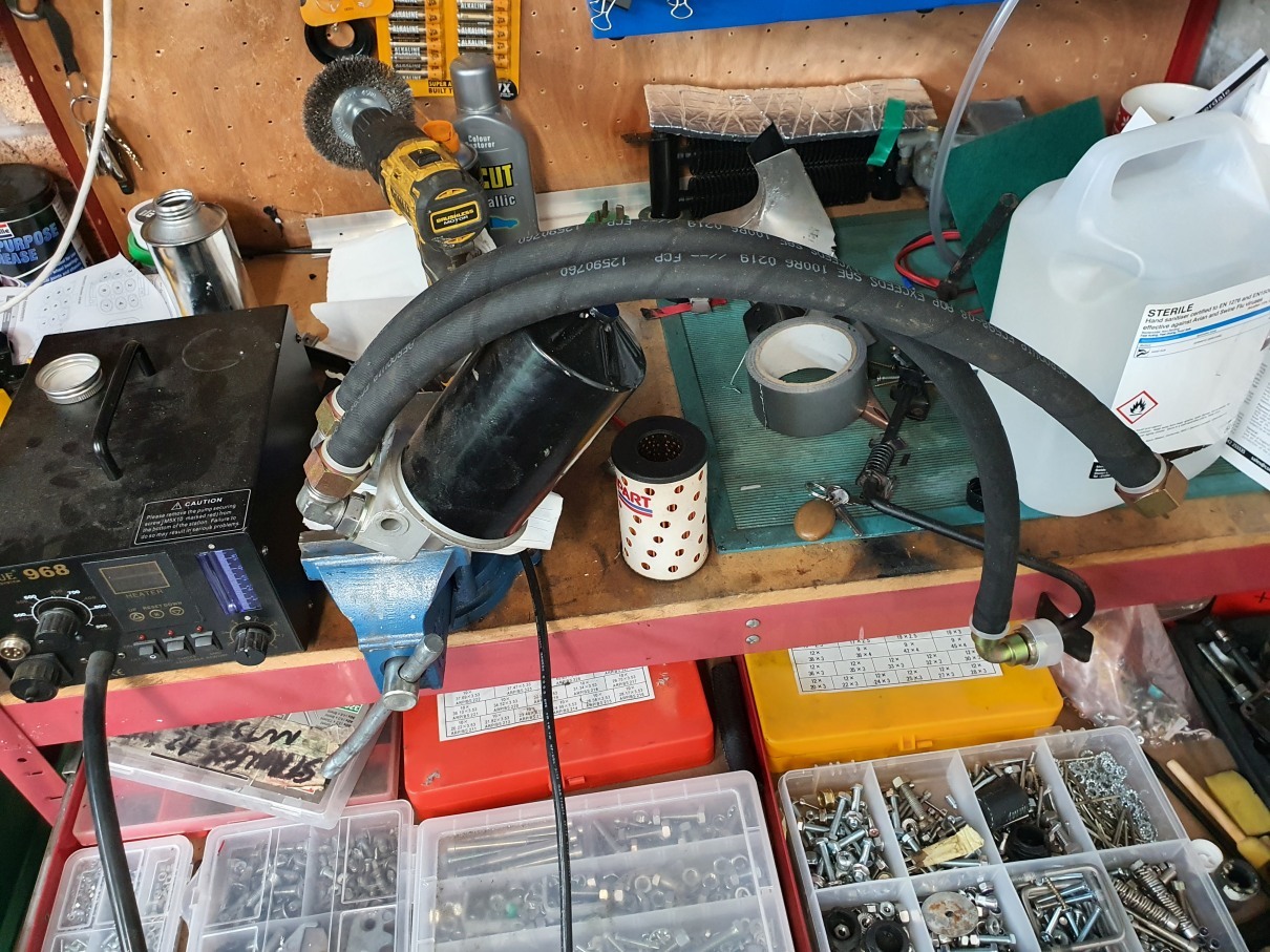

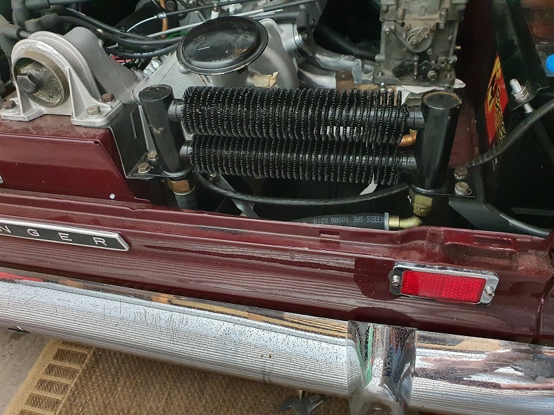

Will get back on case tomorrow and if i can find my other oil cooler bracket might even be able to cold crank it and get some pressure up
Well it creeps one step closer now.
Oh, fixed the lamp issue, FAULTY LED lamp so crushed out the LED and just used the the screw in body, fitted my own led
Tested the oil pressure sender (electric) temp sender and fuel sender, all good.
Added a few of the last bits in,

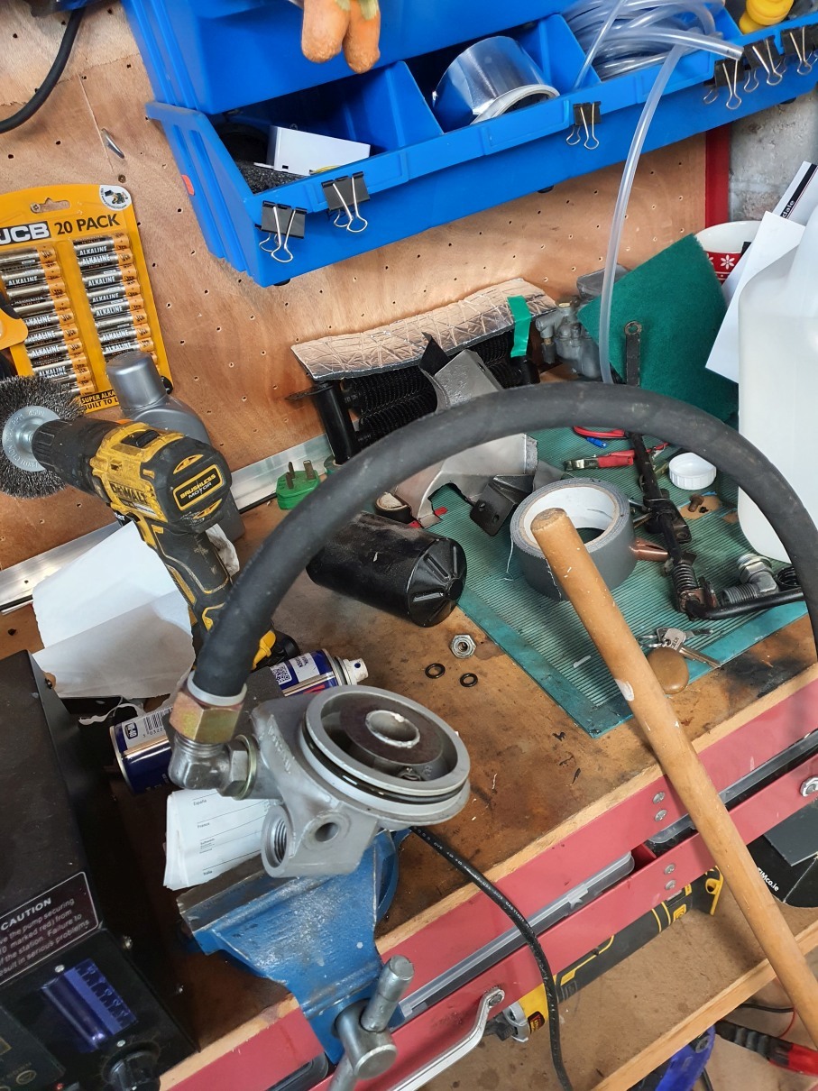

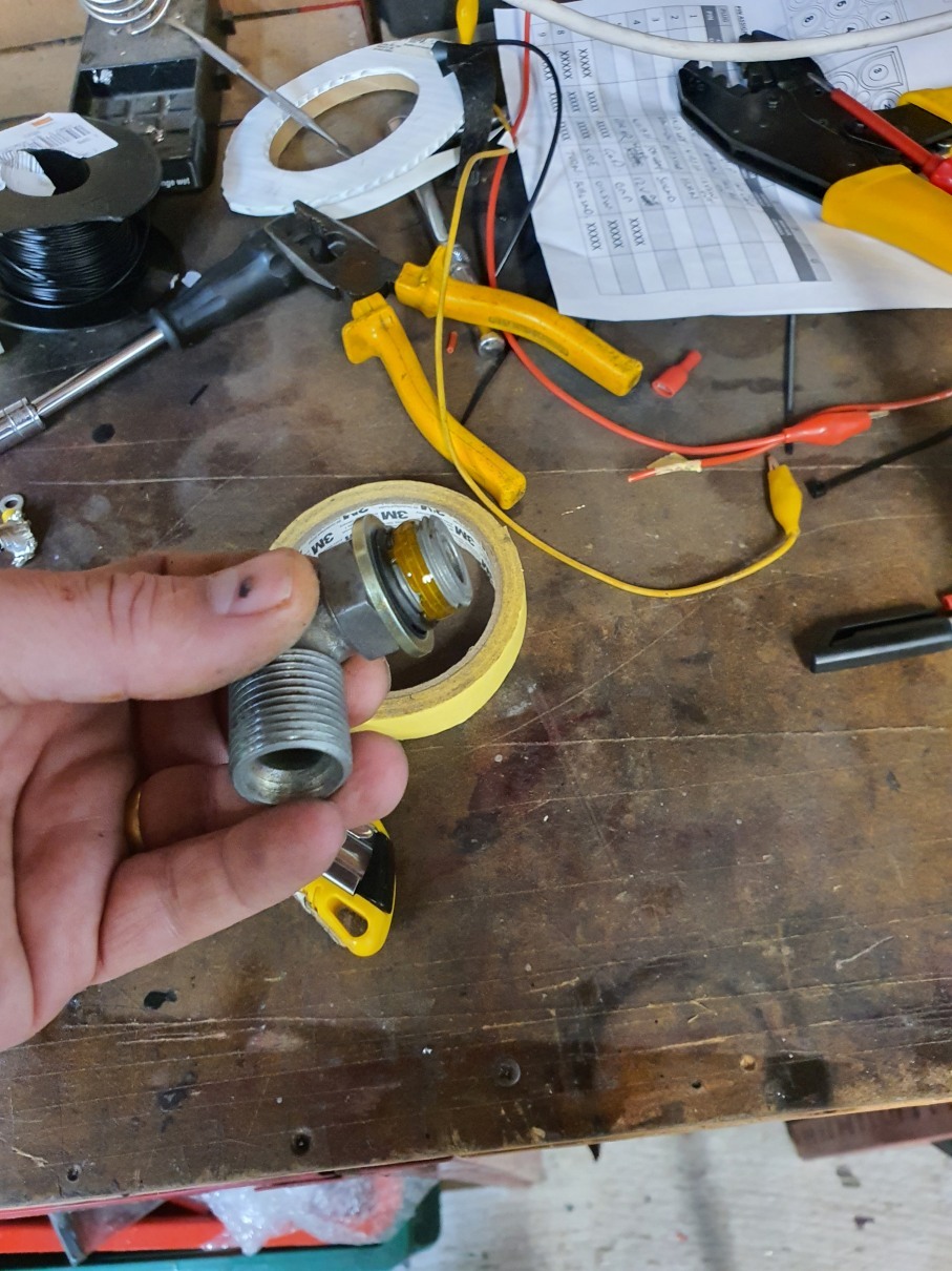

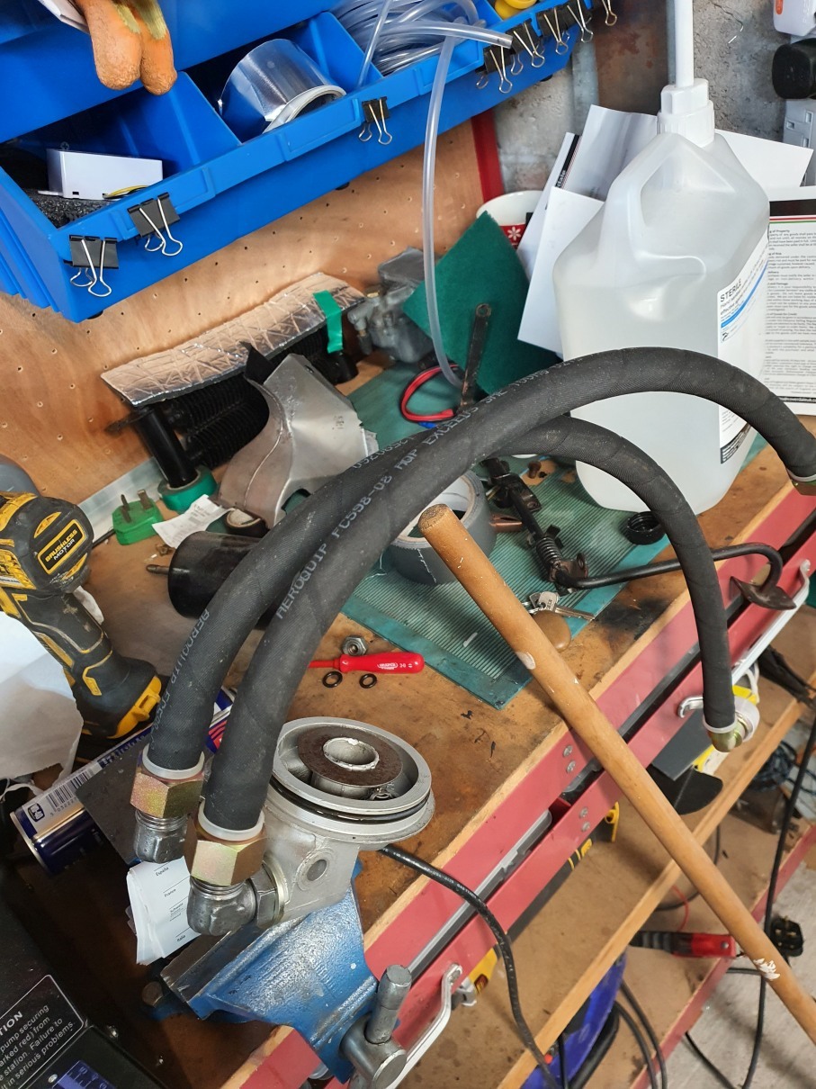

And now one last thing on the engine block, the oil cooler exit elbows, the crush washers were toast on these and you apparantly cant get new ones.
So added an O ring, slightly oversize dowty (o ring sits tight inside dowty and added some thread sealer so hopefully thats that sorted.
Clean out the cannister, prime filter with oil and mount the cooler and thats the engine ready to dry crank !/ John
