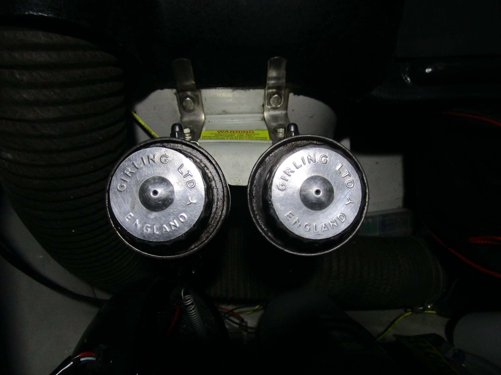

    Im using separate genuine Girling reservoirs as fitted to Jag XK150s as well as Aston Martin DB4 - 5 and 6 etc .
    They hold a lot of fluid , so much so i can bleed the brakes and only top it up once .

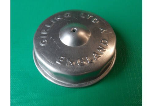

    Anyway whilst the reservoirs themselves are superb the lids are anything but . They are made from thin aluminium and have no seal as such , if you add a seal they often loose grip on the reservoir , no seal and they can leak , added to which we have aluminium , steel and brake fluid all in one place resulting in corrosion . Basically the lids are shit.

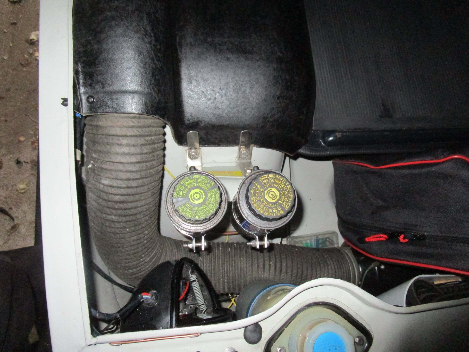

    Anyway i carefully removed most of the writing on both - hacked the crappy Ally Girling lids to bits and put the two together .
    They now seal but still look the part
    Proper but shit Girling cap
    Click image for larger version  Name:	500201-500x348.jpg Views:	90 Size:	29.8 KB ID:	10014

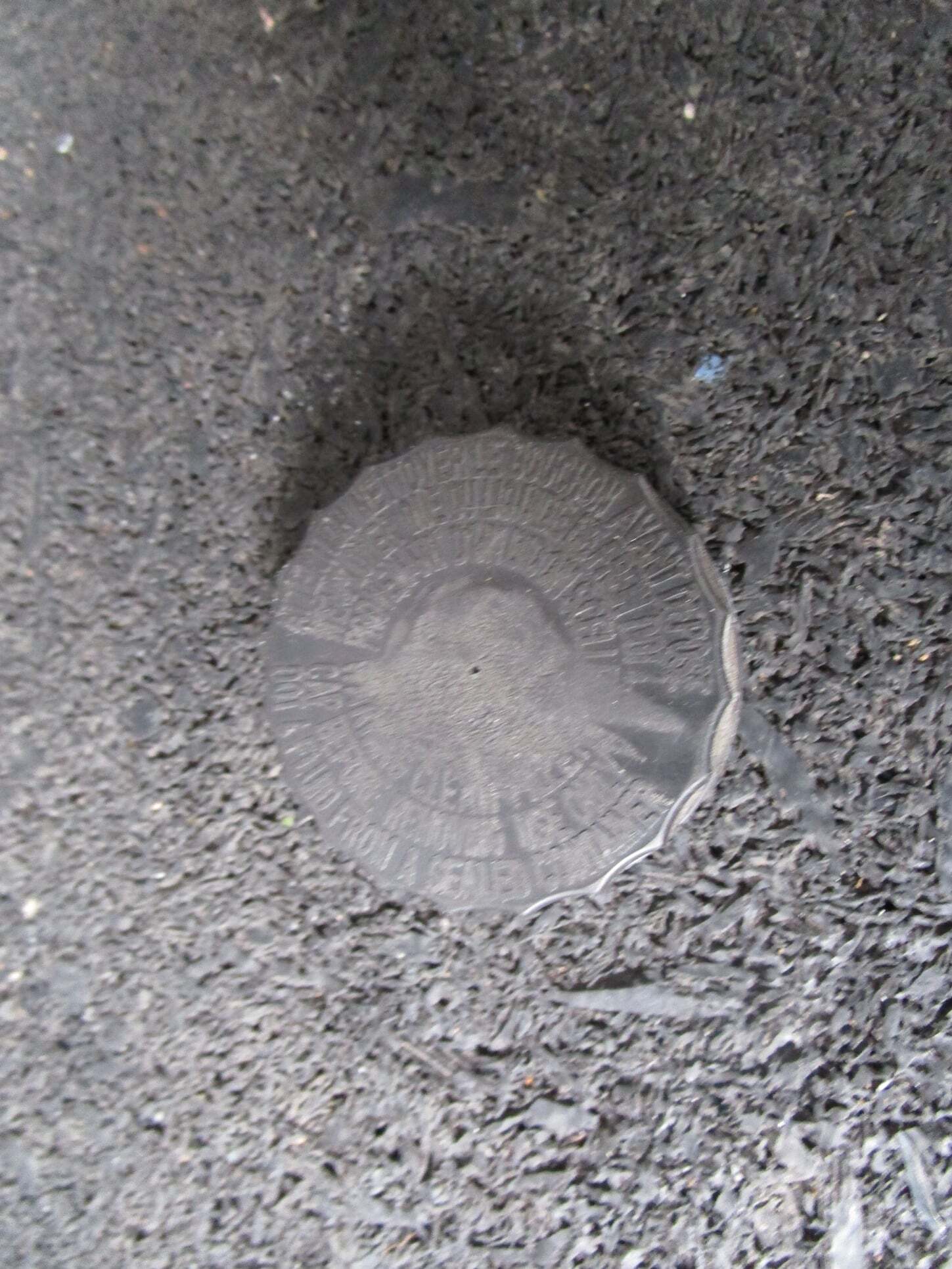

    Great fitting modern plastic ones
    Click image for larger version  Name:	118633204_10224199309150092_5103919968278769111_o.jpg Views:	50 Size:	252.4 KB ID:	10015
    Removed most of the raised writing
    Click image for larger version  Name:	118614624_10224199310670130_7073547942942932645_o.jpg Views:	46 Size:	294.6 KB ID:	10016

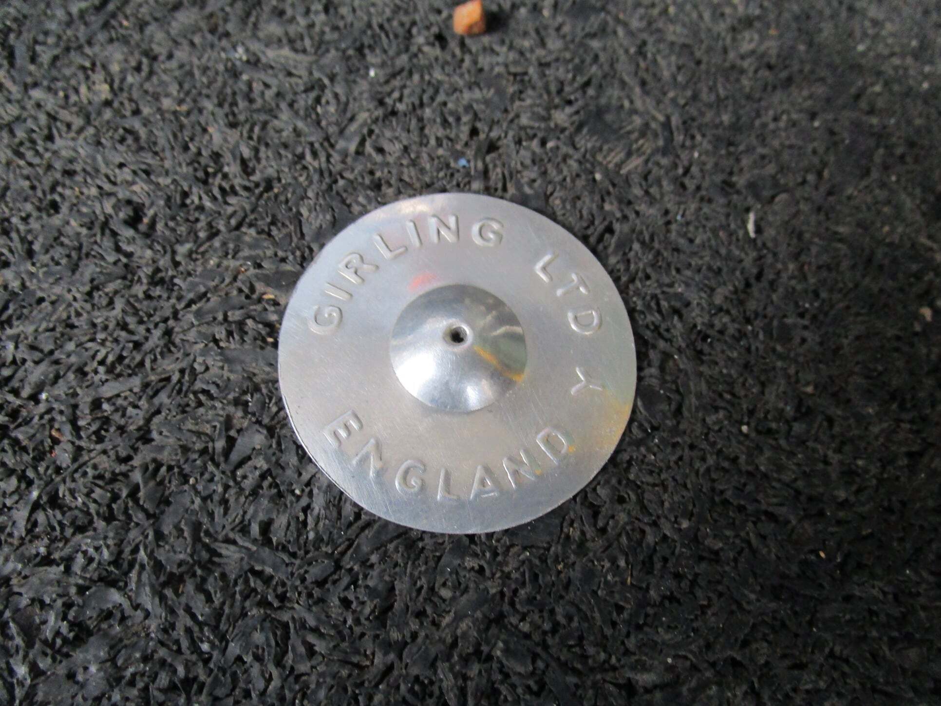

    Hacked the genuine lid to bits leaving just the top disc
    Click image for larger version  Name:	118581444_10224199312630179_2997735198912251593_o.jpg Views:	47 Size:	254.6 KB ID:	10017
    Screw lids on tightly then glue the disc to the lid so they line up
    Click image for larger version  Name:	118600886_10224199314070215_3130760699131126342_o.jpg Views:	48 Size:	124.0 KB ID:	10018
