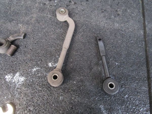

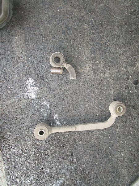

    Today I changed the rear drop links on Ingrid our W203 C18OK Merc .
    Bottom bushes were utter toast however the top ones were still perfect.
    Whats the relevance you may ask .

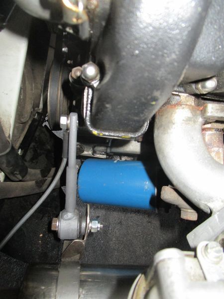

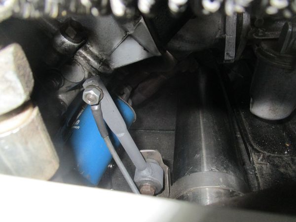

    Well my lateral thinking bonce got thinking and it turned out the top part makes a great rubber mounted exhaust strap

    up cylcing at its best, Pat no more throw away drop links with good bush

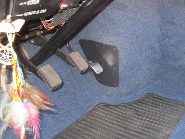

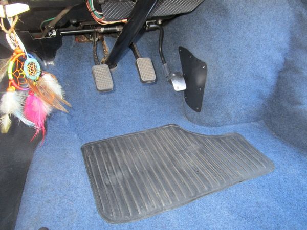

      Carpets wearing through on the arch by the throttle pedal .
      No probs though - an old plant pot , some biffercated rivets and washers for said and we have this
