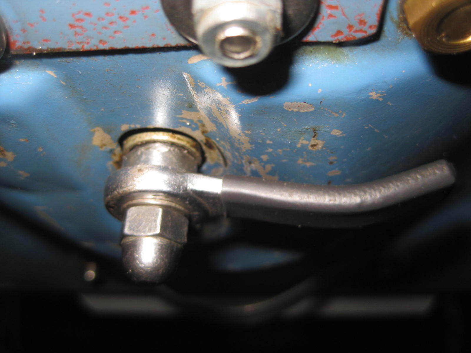

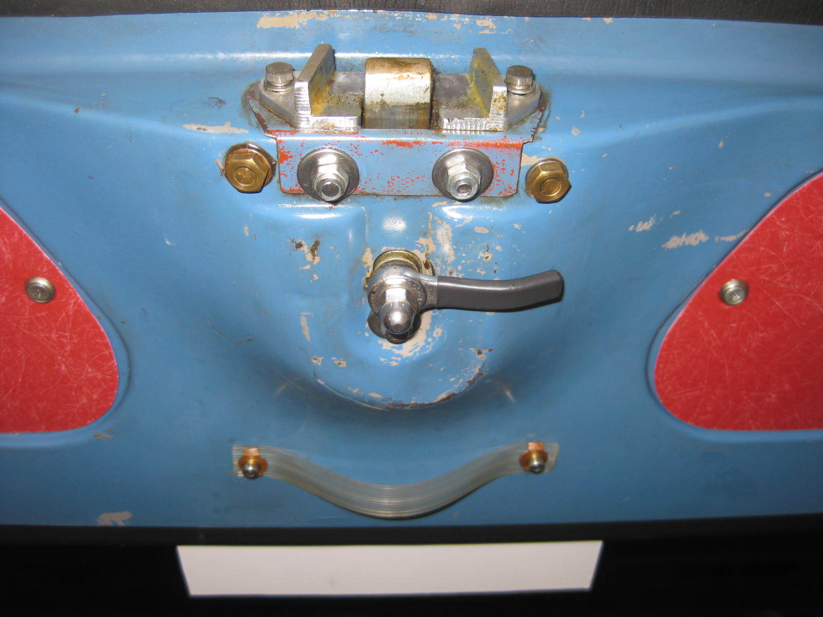

    For a good while Ive wanted a way of opening Barnabys tailgate from the inside , used to sleep in it ages ago so getting out without opening the tailgate was shall we say tricky .
    Plus would be handy in case of an emergency .
    Anyhoo the 5/16 bar on the lock is way too short to add an internal handle - talking of which said handle would need to be slimline and almost out of the way in case i shoved a large load in it .
    Well after much faffing ive done it

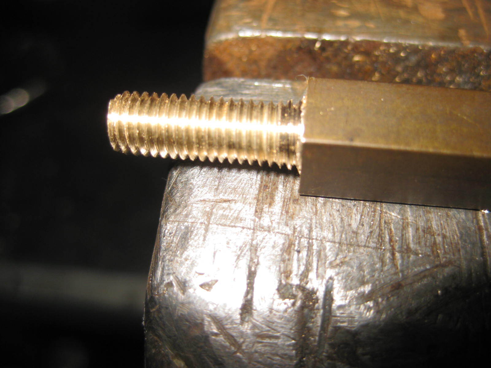

    Replaced the factory bar with some brass 5/16 - on one end it was turned down to 6.35mm meaning I could cut a 1/4 UNF thread on one end . Bar was fitted to the existing lock the same way as factory - that is a 2.5mm hole and a roll pin .
    Bit of a stepped spacer was made for said handle . A tiny bit of end float was required for this so the lock doesnt go stiff when the nuts tightened . Handle is a brake adjuster cut down .

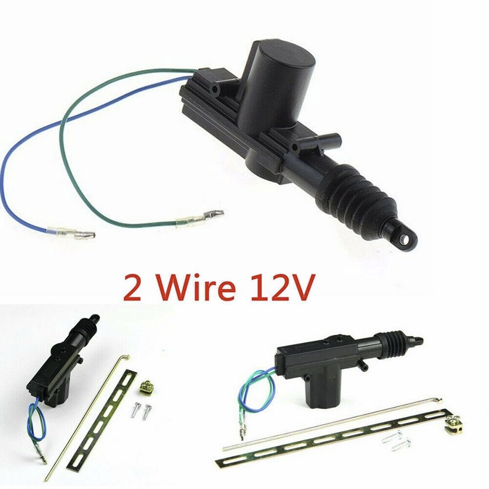

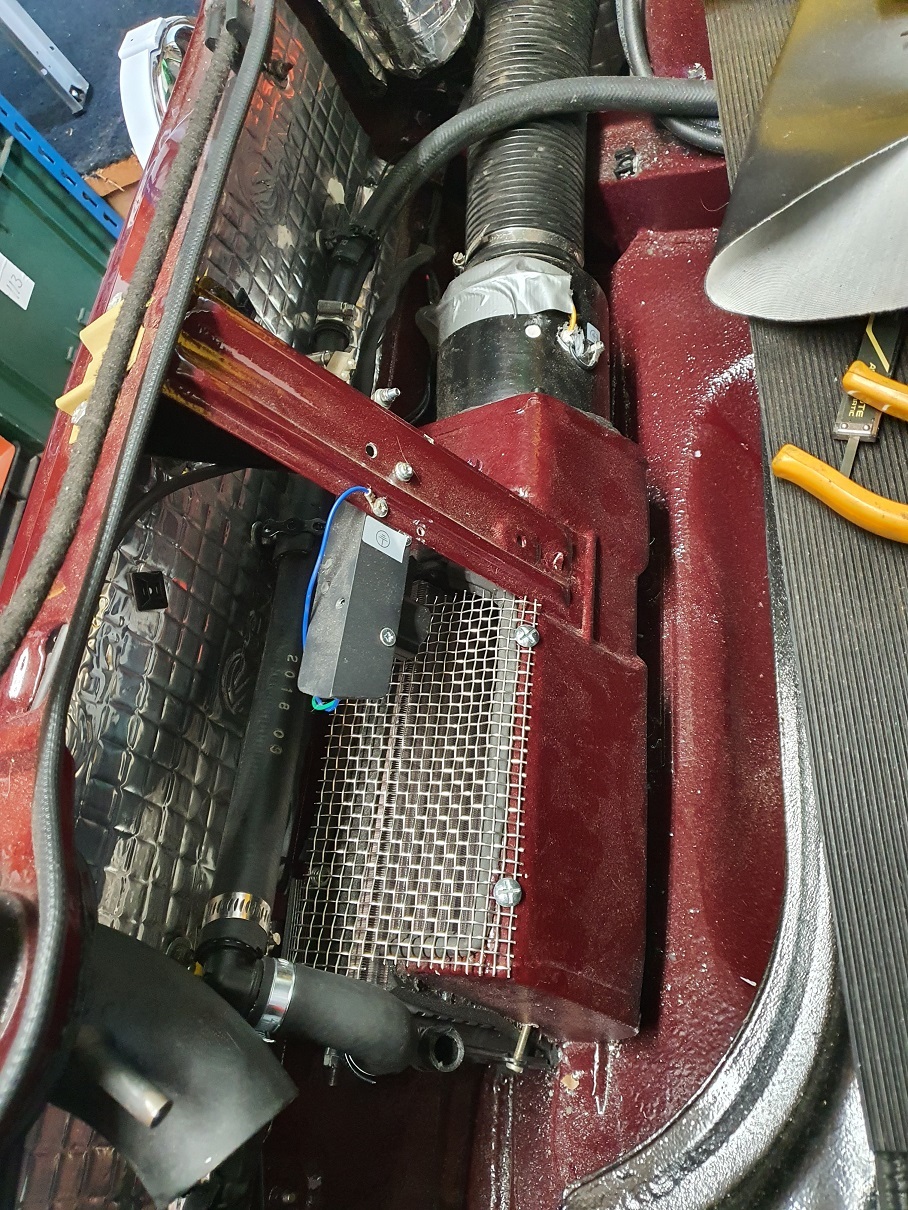

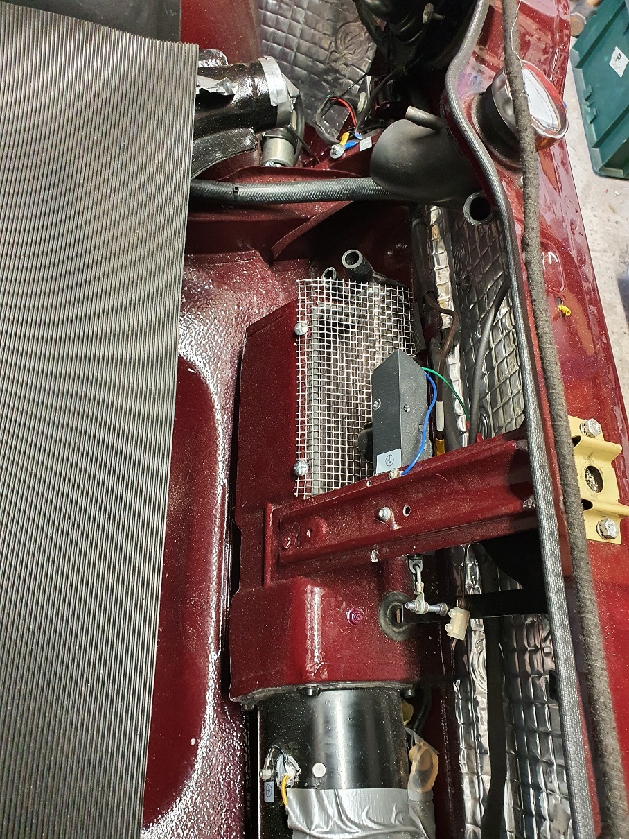

    Did you ever get round to fitting that actuators i sent down, it was same as the one I used on DDG for electric bonnet opening
    I think Andy also did it Uncle Henry

      I did, John. It works very well. But I still have the cable option as belt and braces. Bracketing and precise location/operational length being the critical items.

          Dave, yes, years ago mine is fitted in standard lock though, your challenge, if you chose to accept it, was making it work with your mid-grille lock and no self destruct in a few minytes

          Should look something like this
