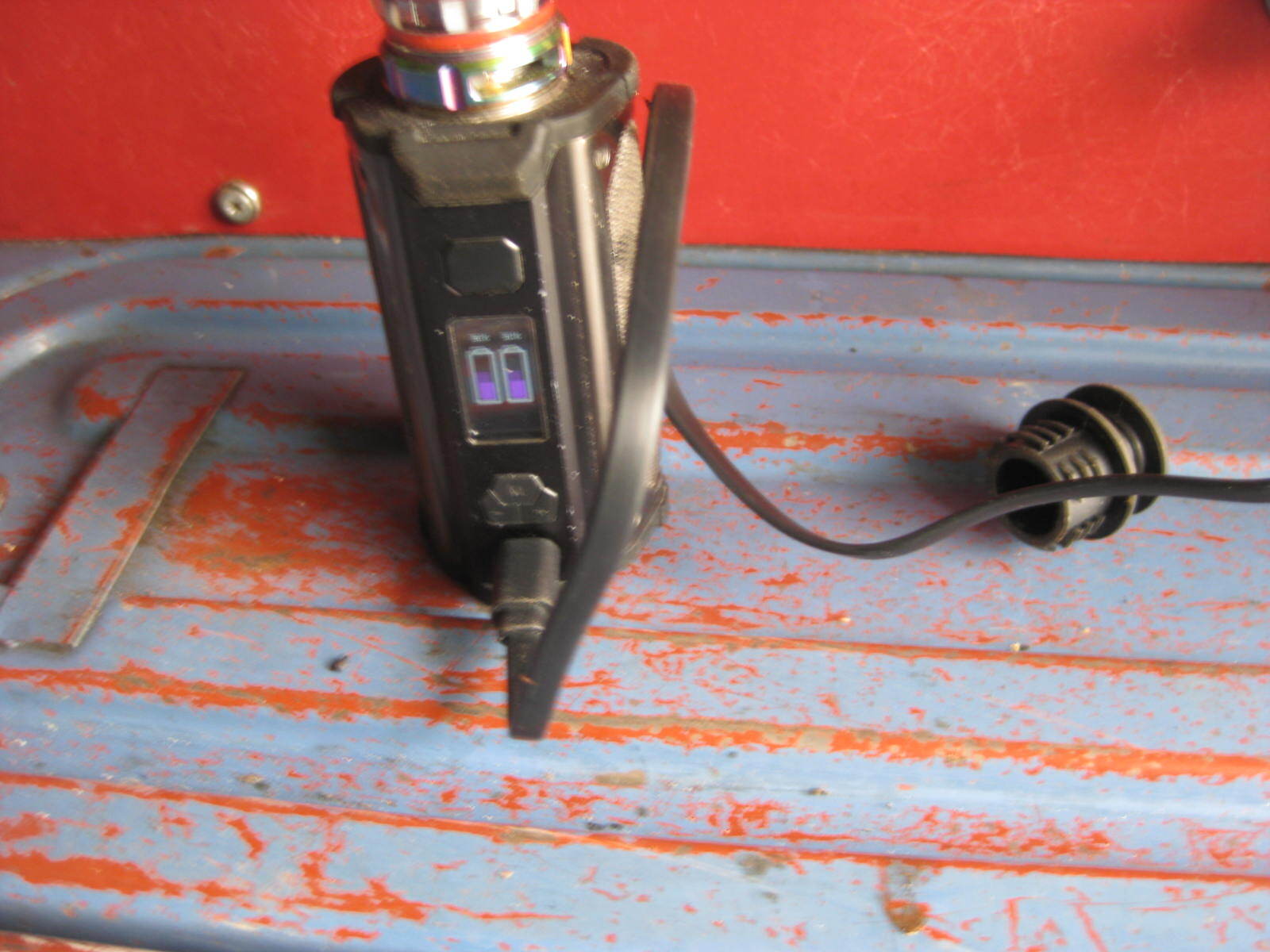

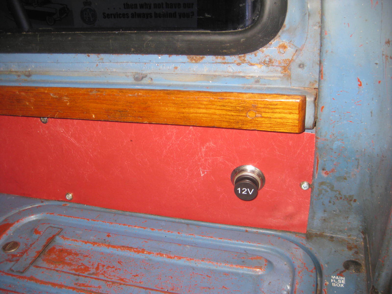

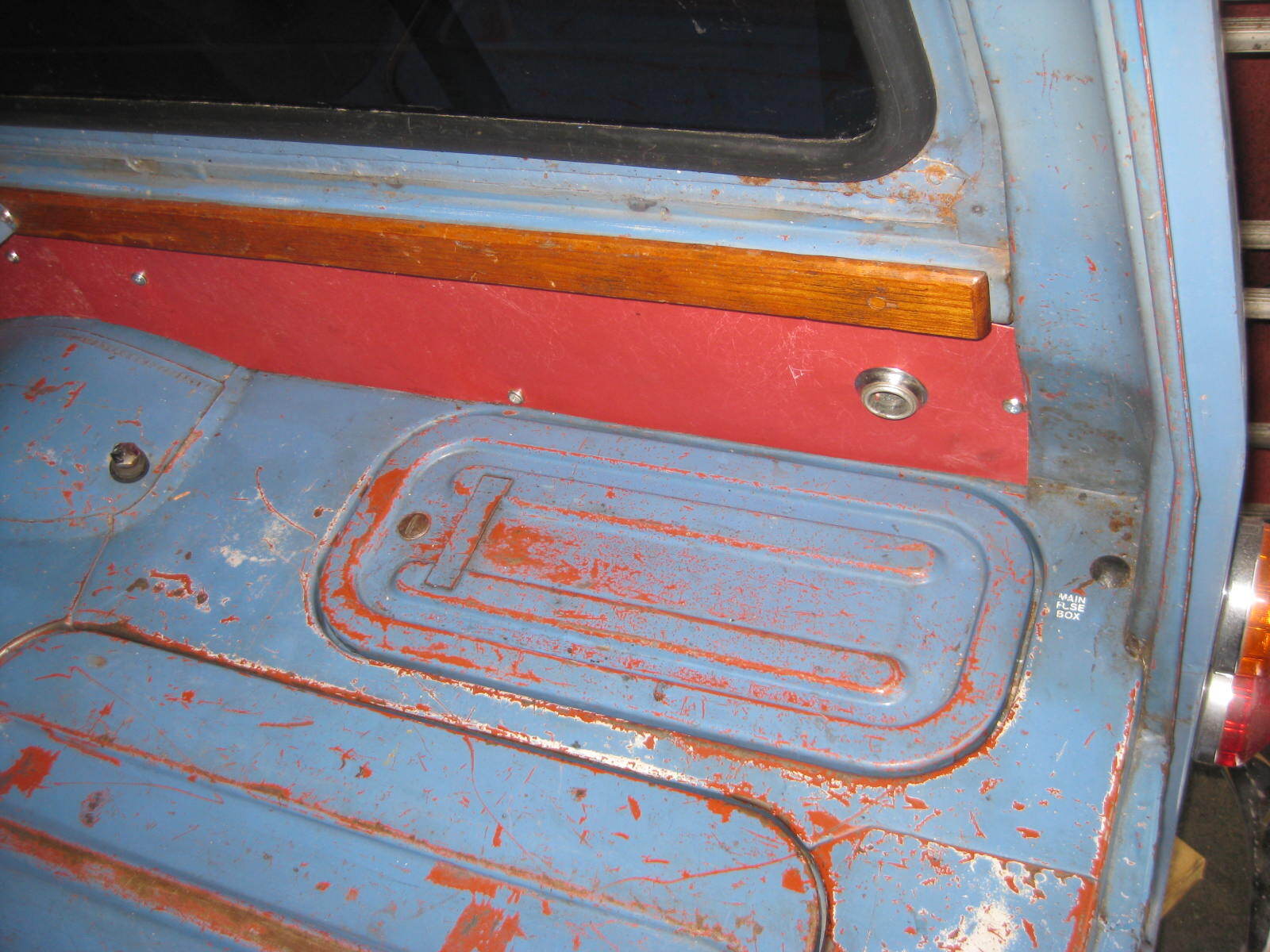

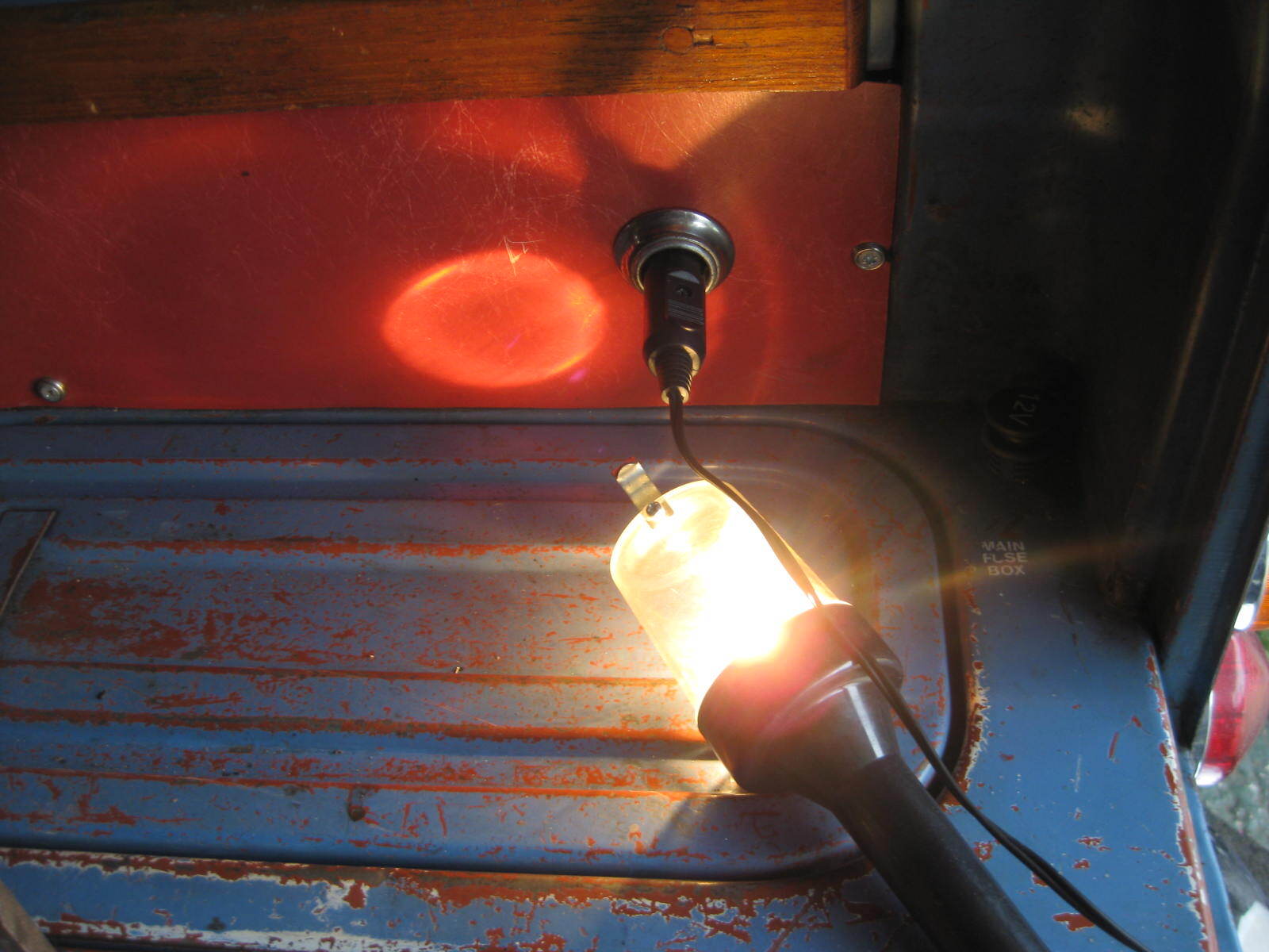

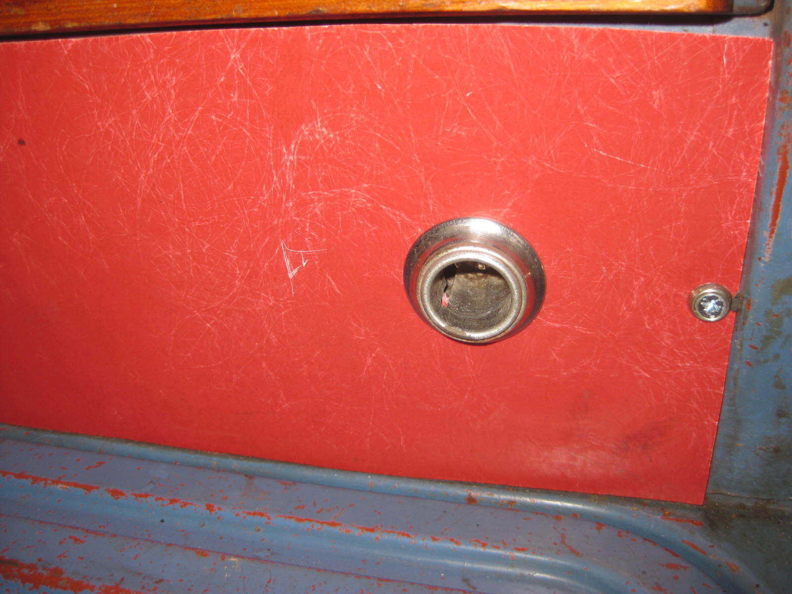

    Added a 12V supply in the back of Barnaby , its just an old Cigarette lighter socket.
    Its fused of course as the supply is off the brake light fuse .
    Not wanting to bore holes in the steel I fitted it to my home made side trim panels .
    Chrome surround is an old door handle escutcheon just to space it slightly forward as a total failsafe for the live in wire .

    Dave, just a thought as I just did it in the transit, is their a gutter around the roof trim like there is in the saloon ?
    I got sick of knocking off lighting in the van I ran a led strip all around pointing up, works a treat, no good if you want to inflate a tyre though
      kind of , got two lights in the load area as it is , you supplied the LEDs
