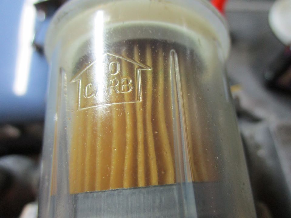

    Back in Nov 2018 I trial fitted one of the very first in tank fuel filters that Bob Picton was doing.
    Unknown to him I also fitted a new inline filter by the carbs .
    The idea being to test wether anything gets through Bobs filter and is therefor caught and visible in the rear filter .
    Well 14 months later im very pleased to report that absolutely nothing got through and the inline filter is spotless .
    Therefor ive removed it completely as i deem it unnecessary and got rid of two joints in the fuel line into the bargain .

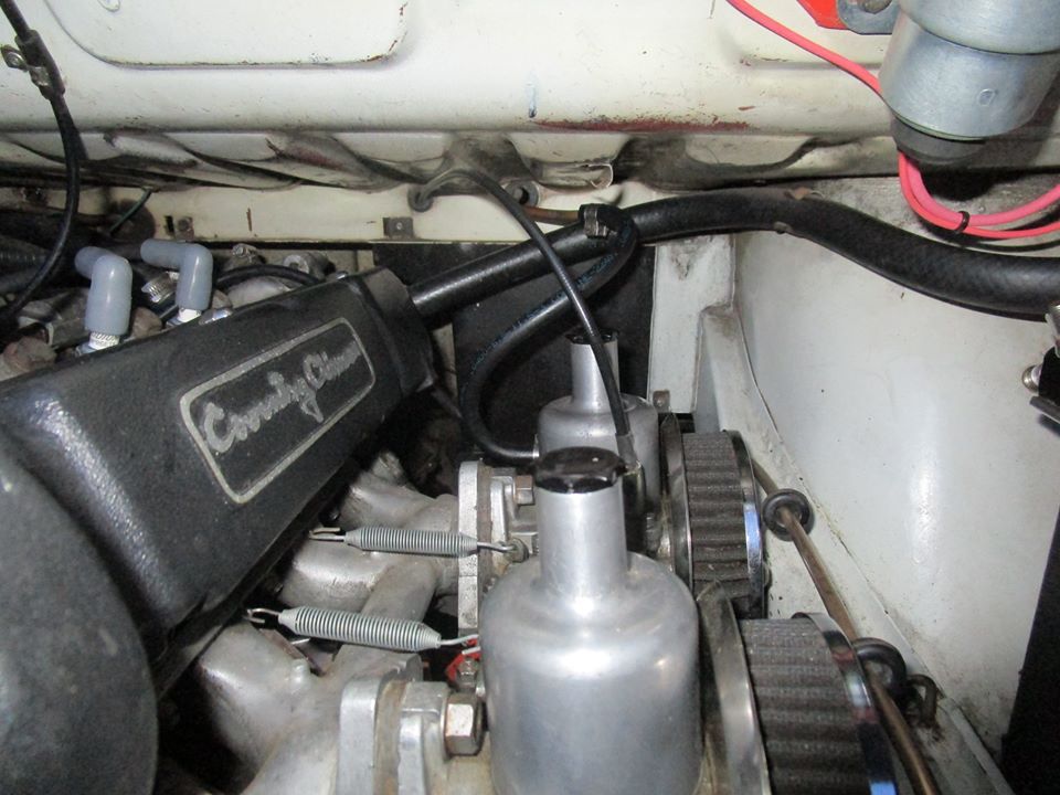

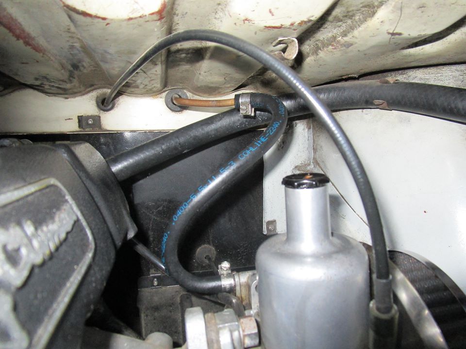

    Pipe ive used is Cohline 2240 . It Can withstand petrol, E15 rated flexible fuels, Ethanol, Diesel and Biodiesel fuels and has as a working temperature range of -40°C to +125°C.
    Also has a working pressure of 10 Bar with a burst pressure of 50 Bar so i recon it will cope fine with 2 psi
