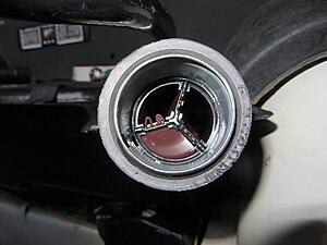

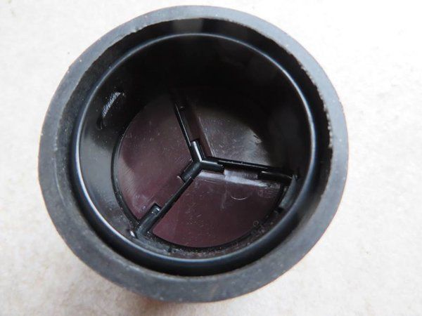

    Anyway this one way flappy tank valve solves all the issues , mines been in since 2016 with no ill effects other than you need to fill up a tad slower .
    Valve is for a MK2 / 2.5 Mazda MX5 - part number GE4T- 42 - 270B , Available from Mazda or i got mine from here

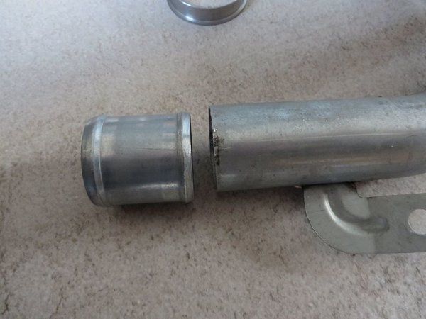

    Chop off this end keeping both swage bumps in place

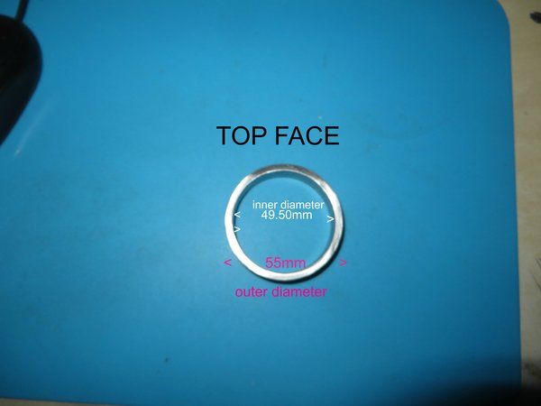

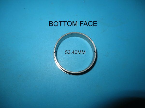

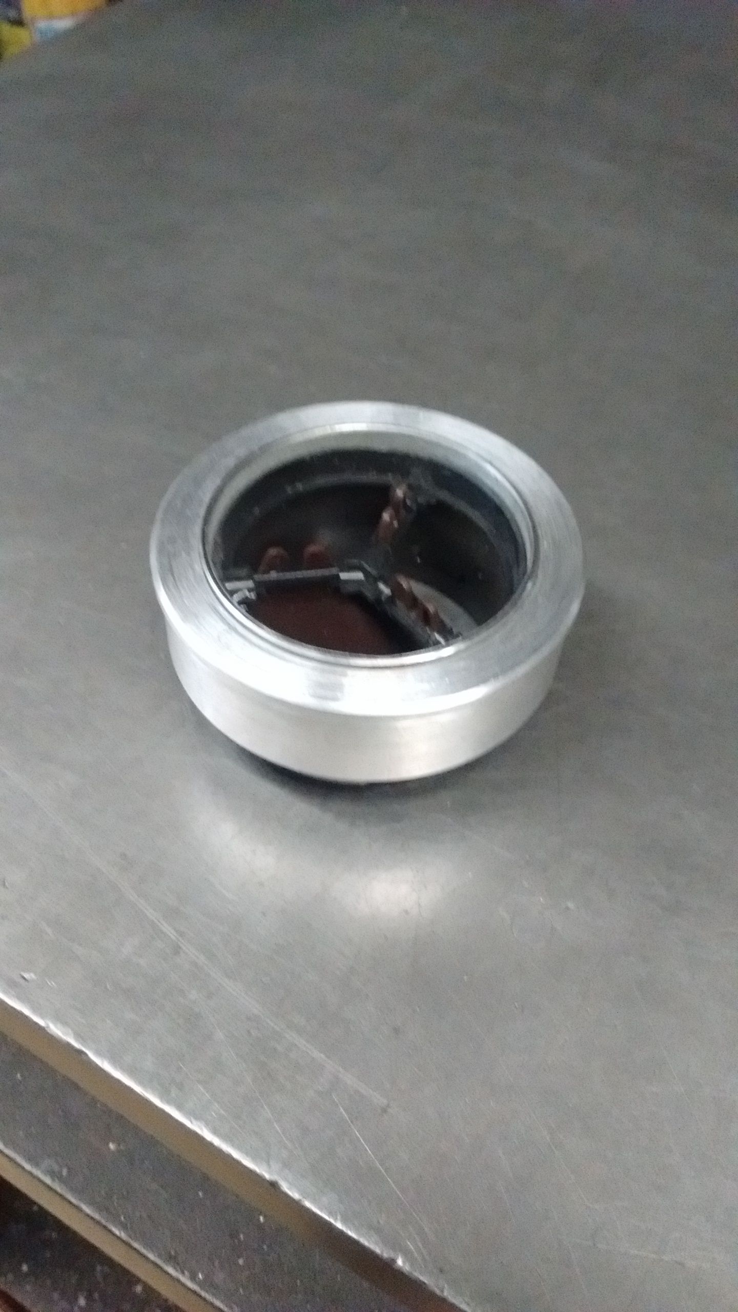

    Adaptor dimensions required , steel will be fine

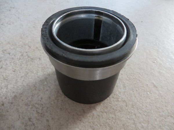

    Fits together like so

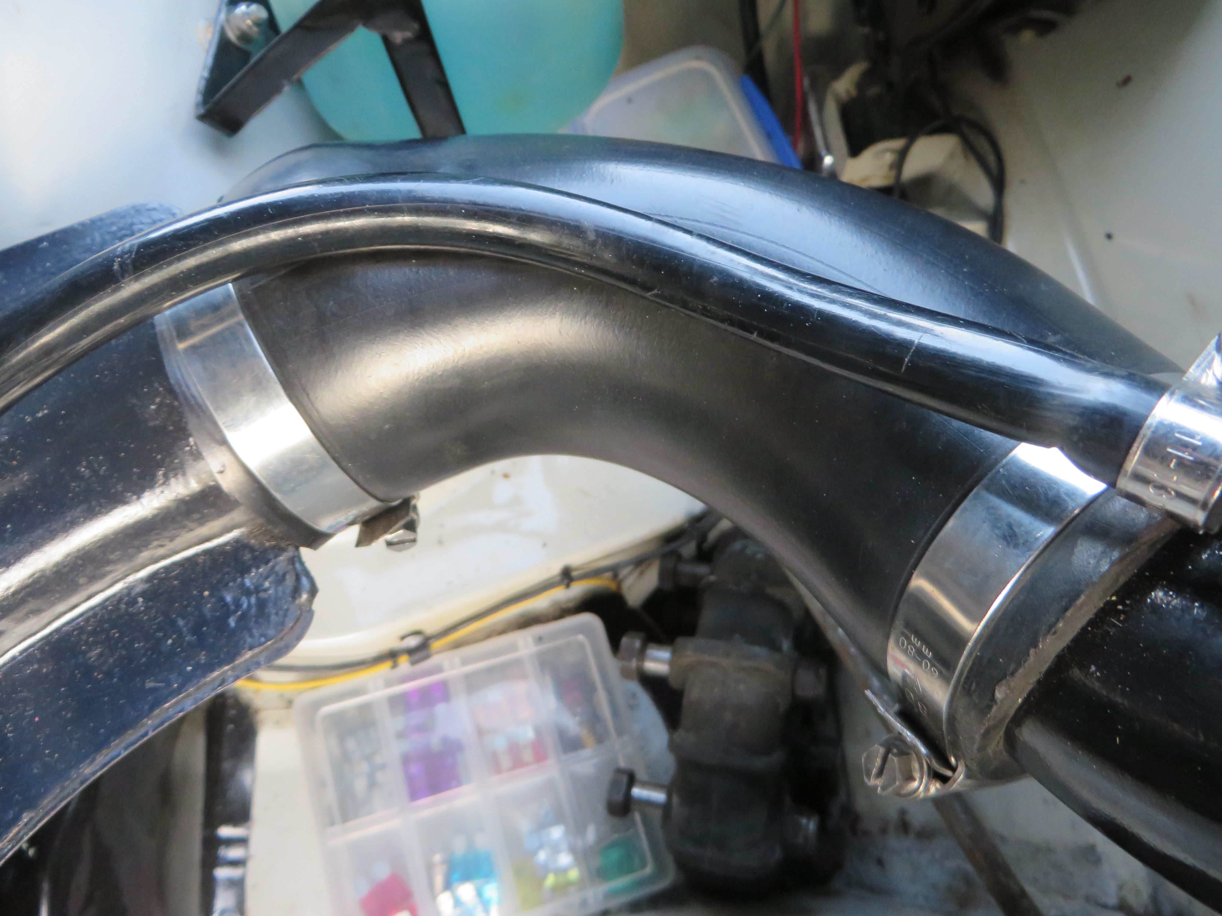

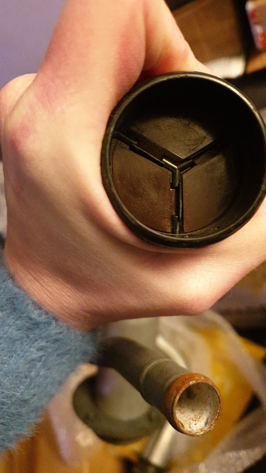

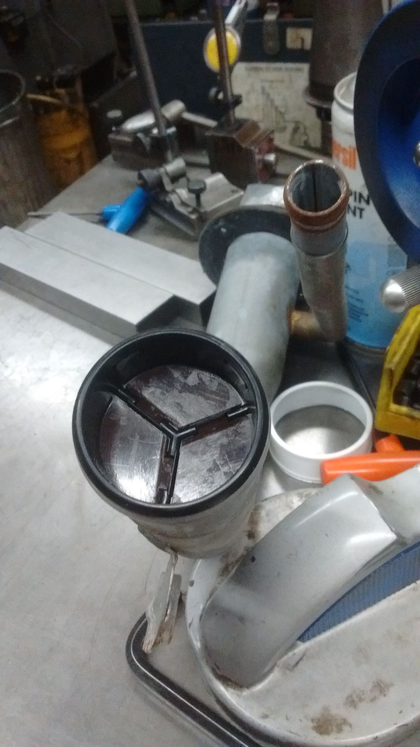

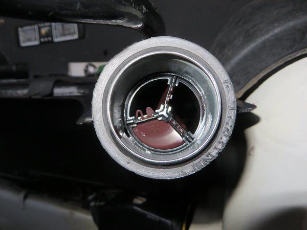

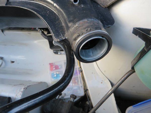

    Standard Imp rubber fuel filler hose just fits over it with no further mods required , flaps allow the fuel to go in but close if any tries to get out , even an emergency stop with a fuel tank resulted in no fuel smell whatsoever . Flaps remaion open under normal driving so tank venting is unaffected

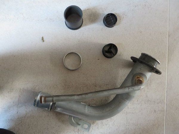

    The bits you need

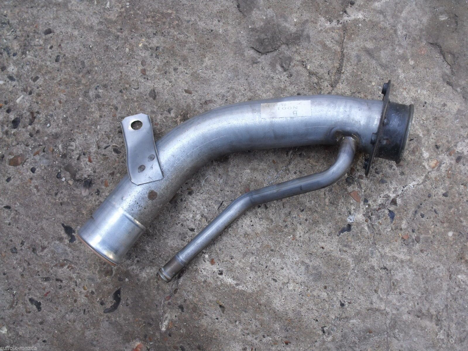

                      As a side note - the seller on ebay suffolk-mazda have confirmed that they have some pipework with 3 way valves in stock, if you email them on ebay and ask them to confirm they have stock, and then purchase a valve and leave a note to seller reminding them of the requirement of a 3 way valve - you can get it all for the princely sum of £14.03 delivered.

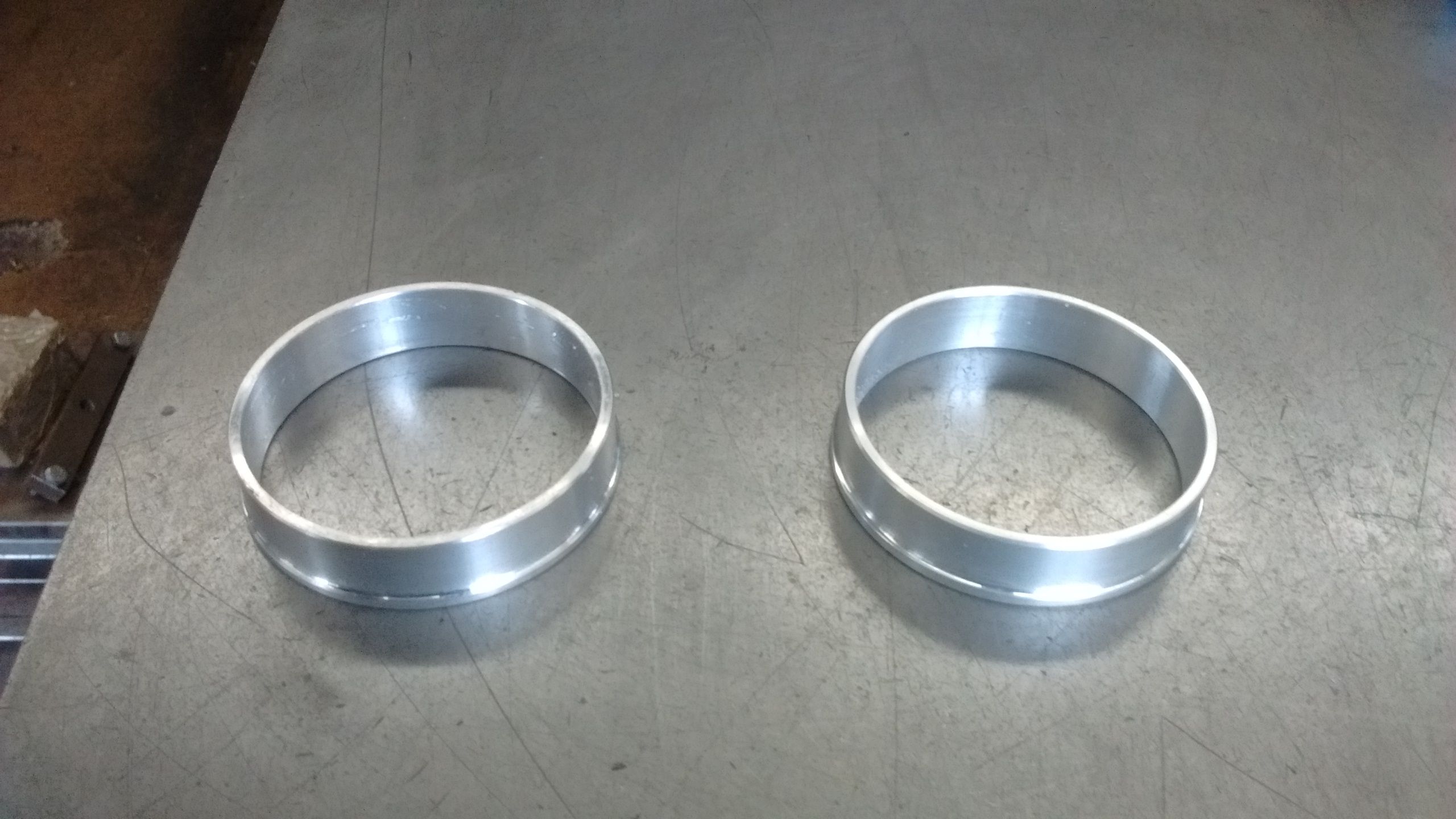

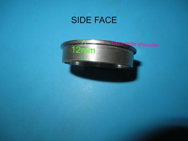

                            Today ,l've made a new ring to fit flappy valve to , hadn't ordered a rubber reducer so had a look at tank yesterday and decided l should be able to make a ring to suit , pictured . I had already made two rings for use with a rubber reducer, also pictured ,one for Martin and one for me , this is now no longer needed so if anyone wants it ? message me.
ID:	7210Click image for larger version
