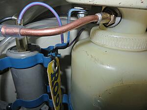

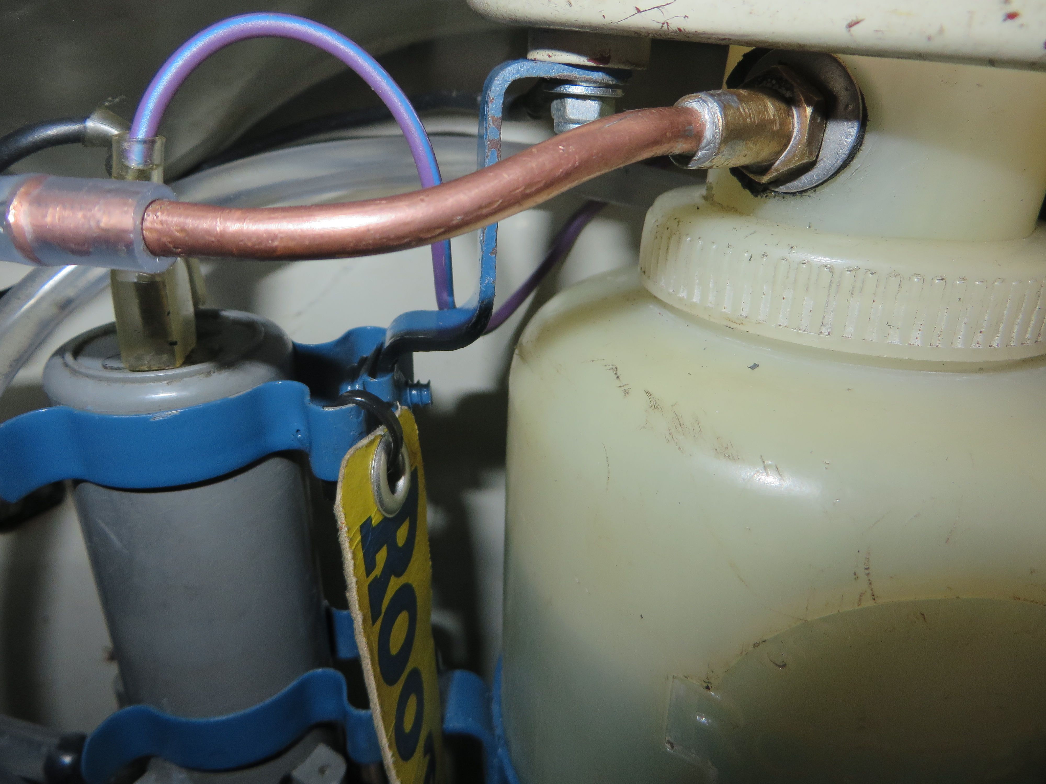

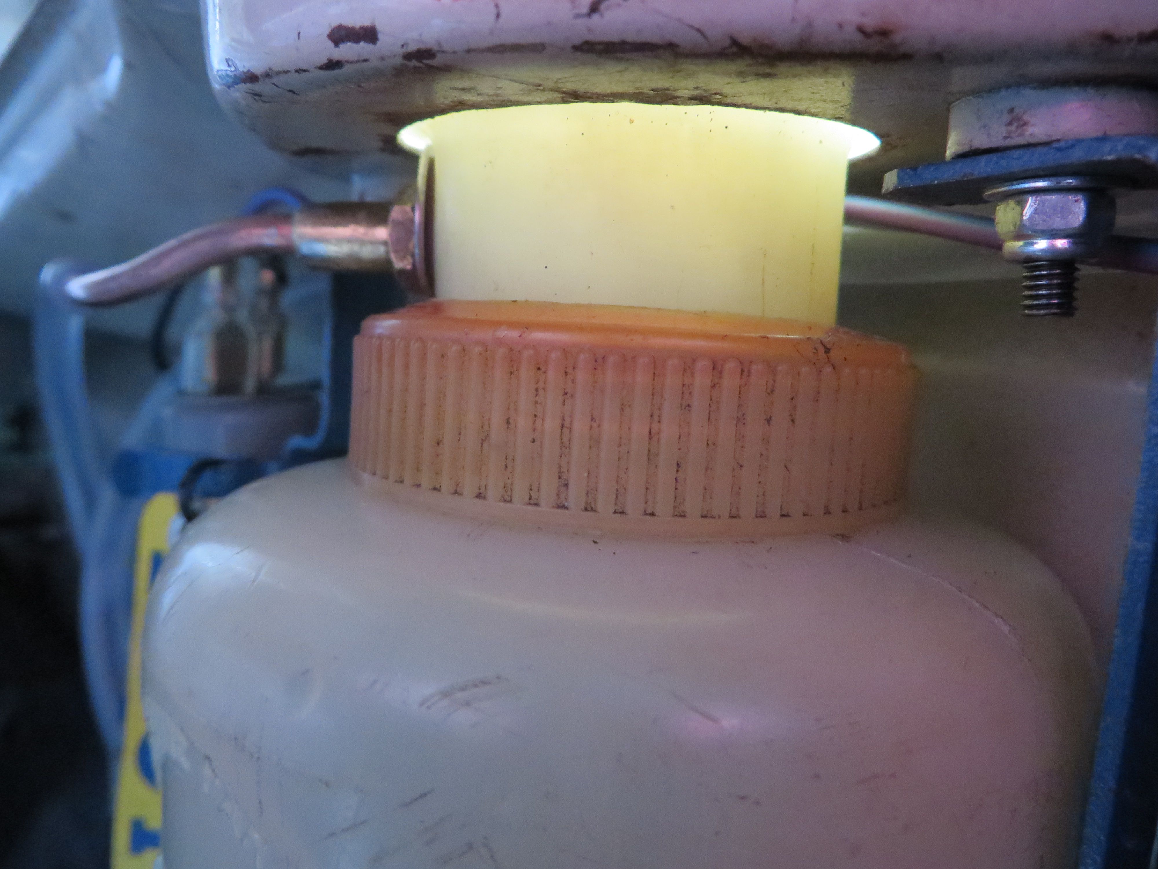

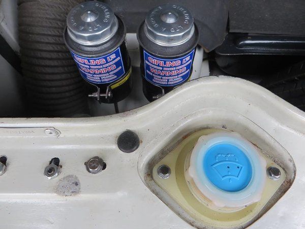

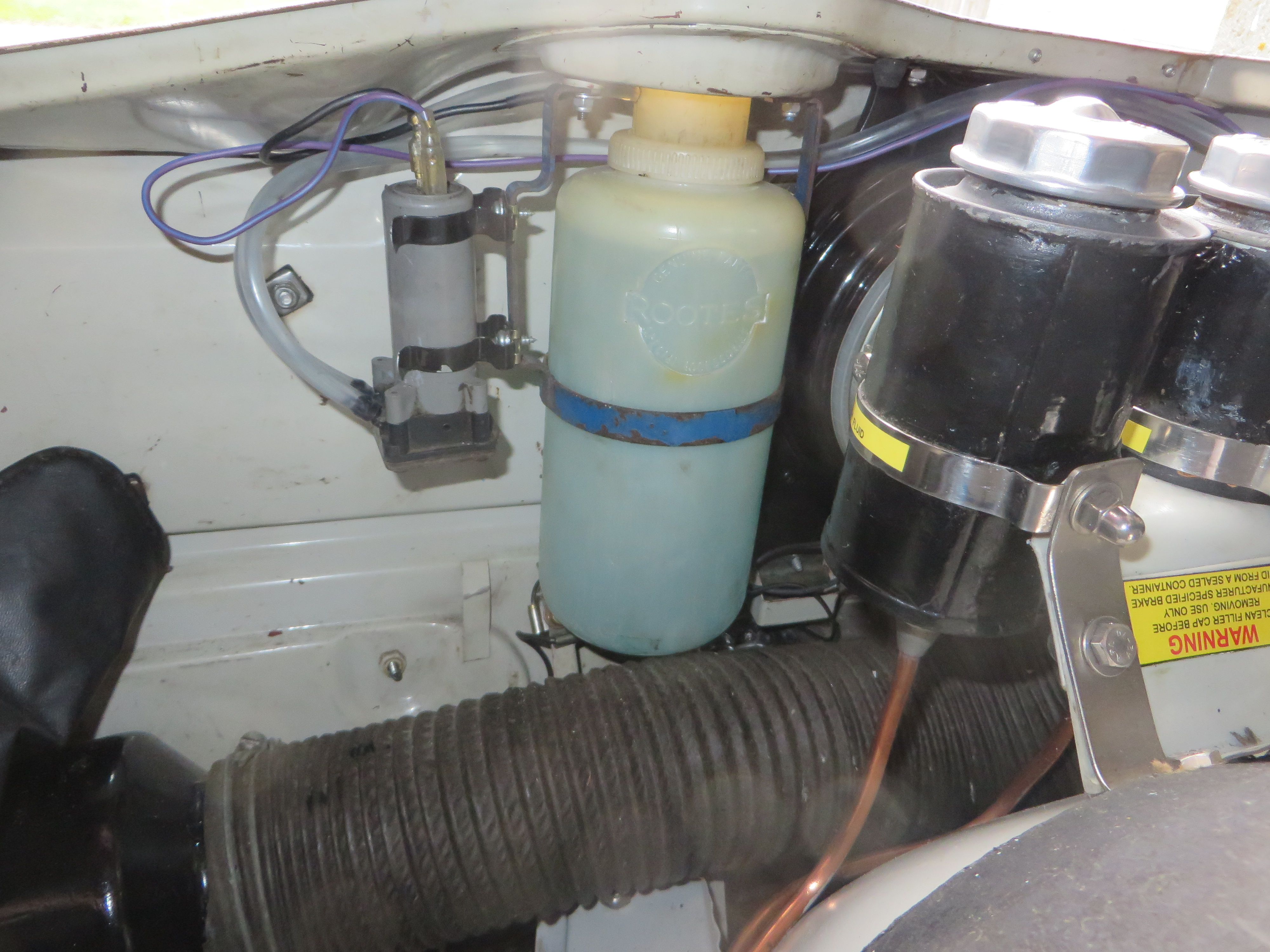

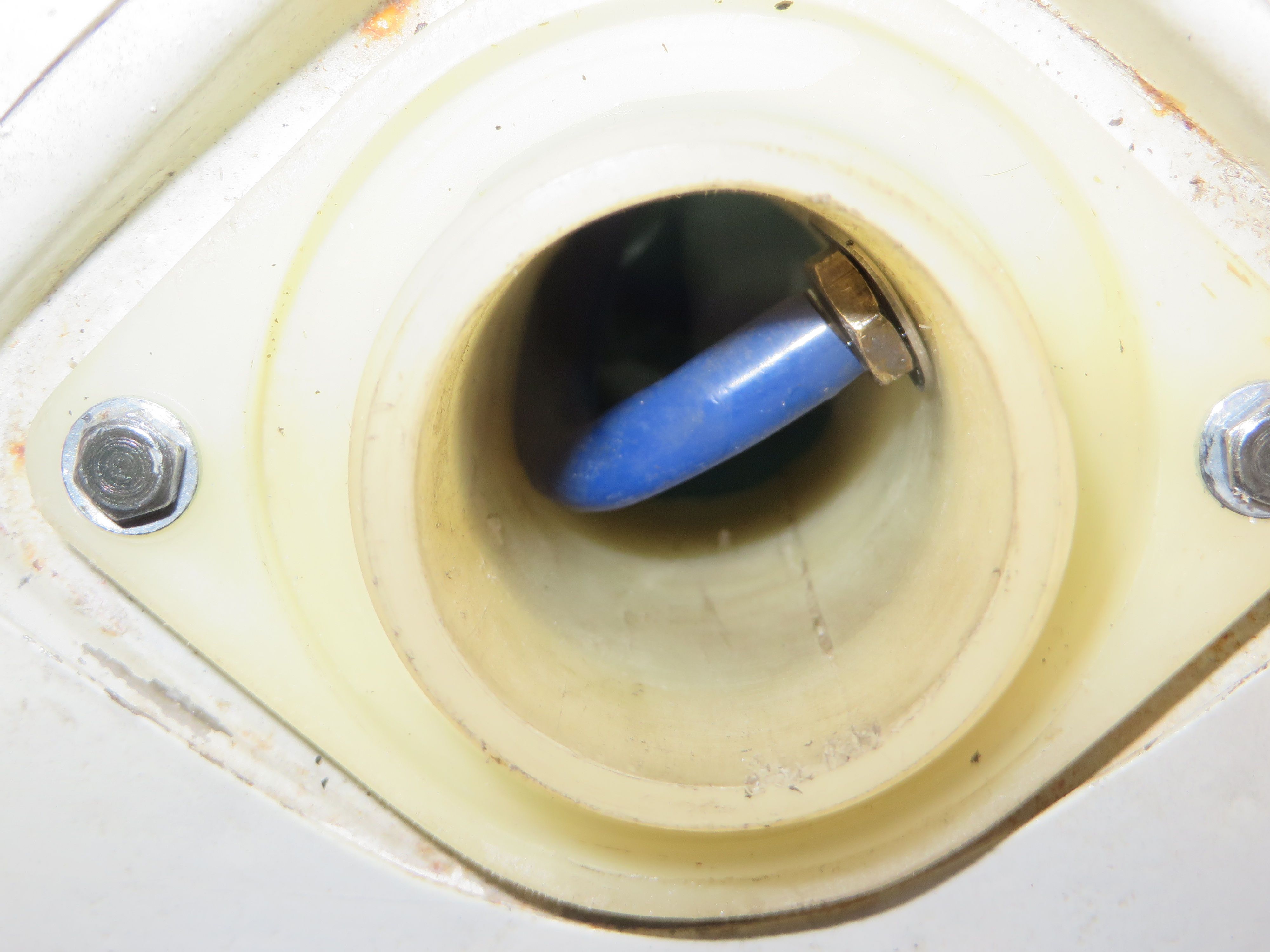

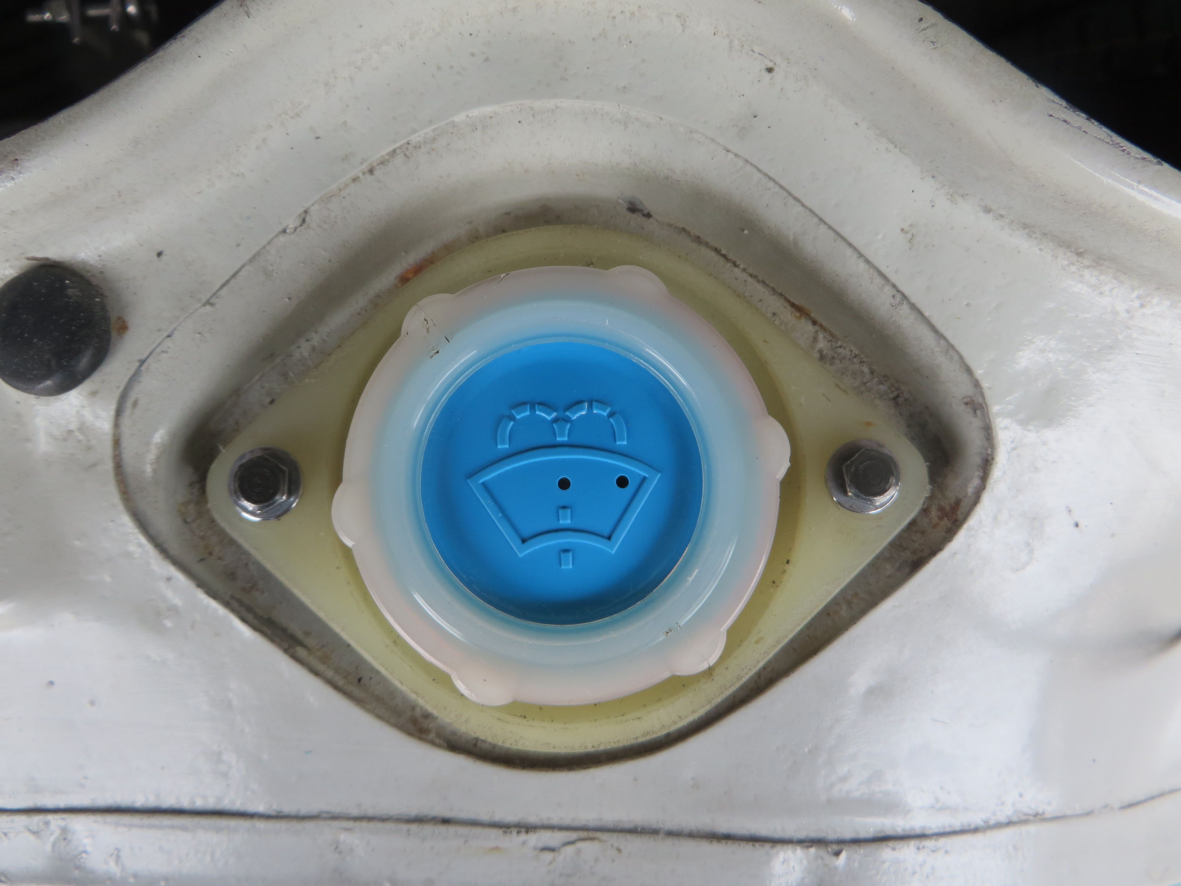

    Having moved the brake and clutch reservoirs it seemed a reasonable idea to use the vacant hole as a washer bottle mount .
    I used a genuine Rootes washer bottle , the old brake and clutch reservoir with the bottom and divider cut out.
    I cut a hole in the washer bottle lid so the reservoir went through it - adding a rubber seal that sealed the lid to the reservoir base .
    Mounted the bottle by cutting up the frame and mounting it upside down and used the original reservoir mounts to hold the lot together , washer bottle original mount was used to mount the motor .
    Finally i modded the reservoir lid so it read what its now for.
    Pics say it better than my waffling so here they are
