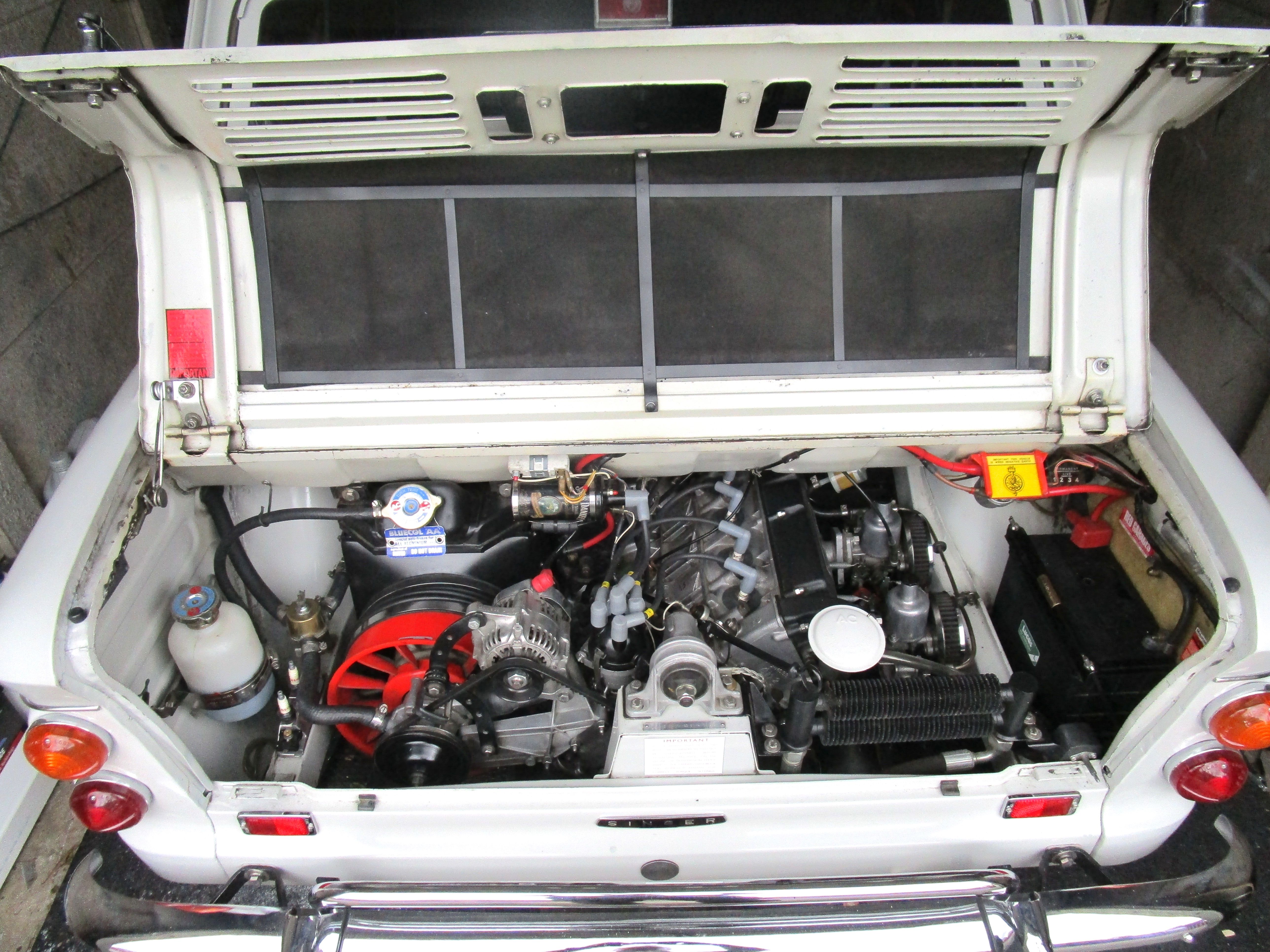

    Original rad if filled to the brim . As the engine heats up the coolant expands and it goes into the bottle , on mine the rise is around one inch . As it cools down when switched off a vacuum is created and the coolant gets sucked back into the rad . for the first few times the level will drop , this is because the Imps rad has an air gap due to the top being at an angle . After a while this air is got rid of and the imp rad is now really full with no air pocket in the rad at all .
    If theres a slight coolant leak - when cooling down the coolant in the bottle will still keep the rad full until the pipe is no longer in the coolant - again easy to spot .
    Its better if the bottle is lower than the top of the rad .

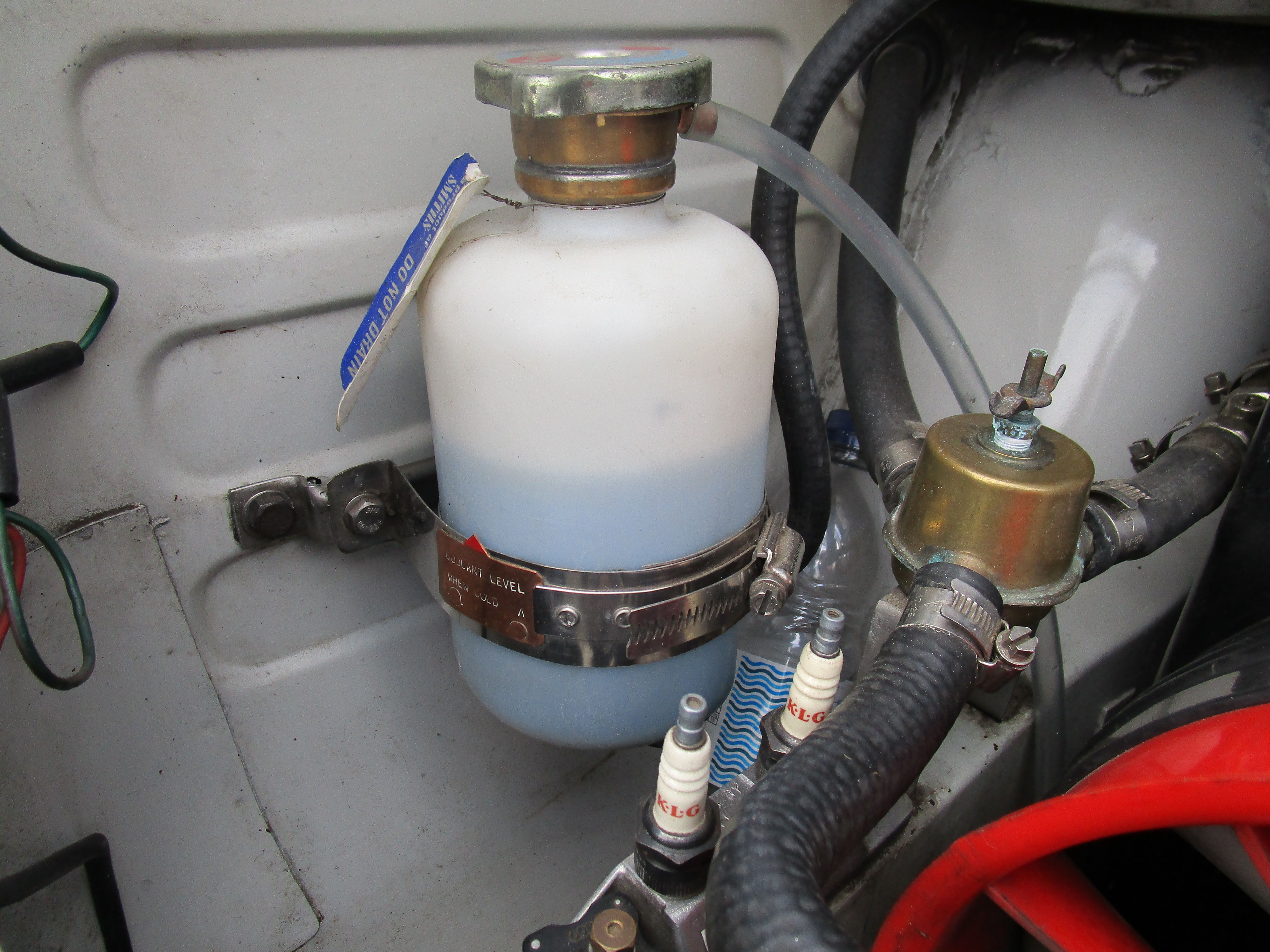

    Level when cold

    Level when hot

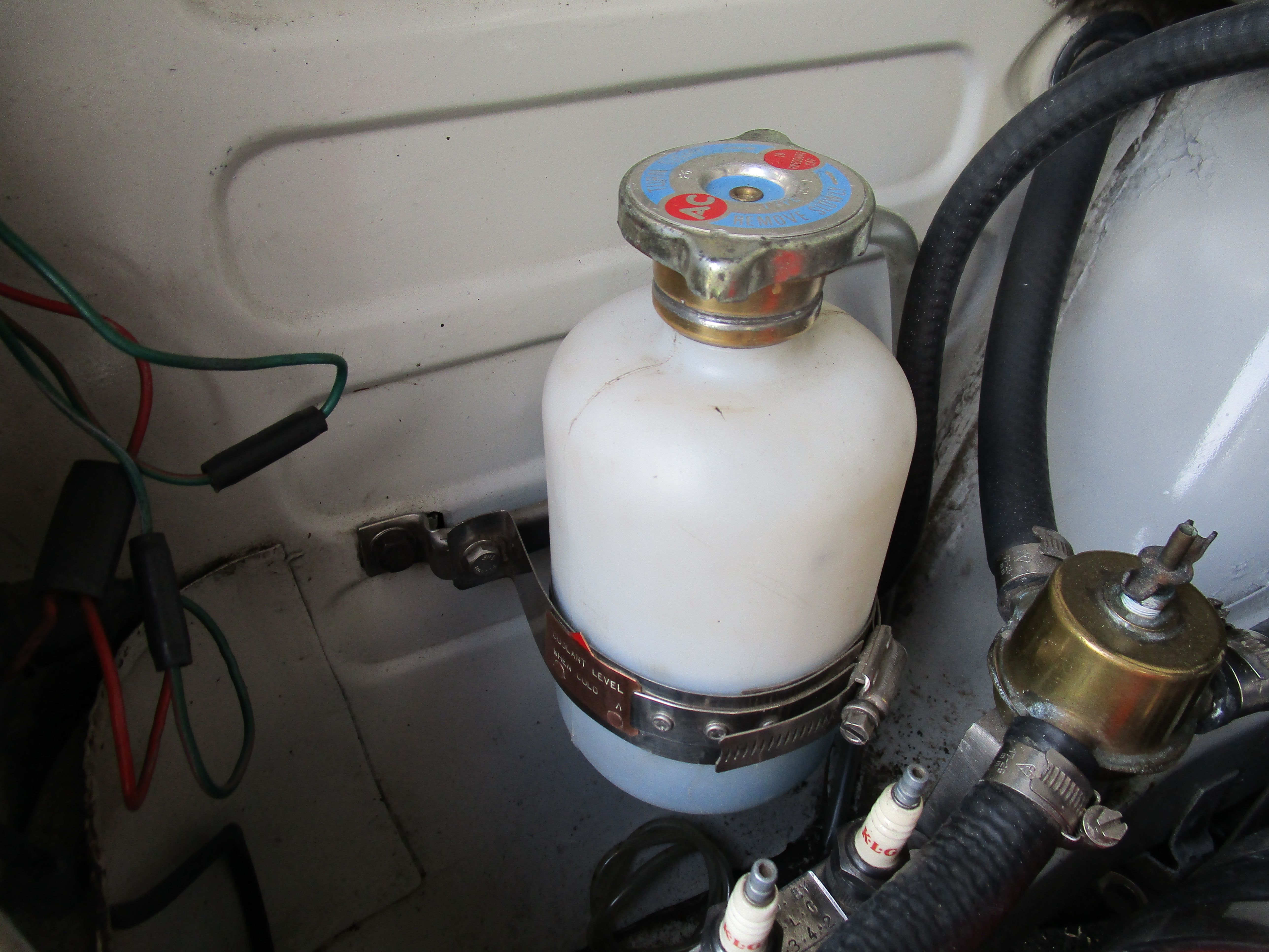

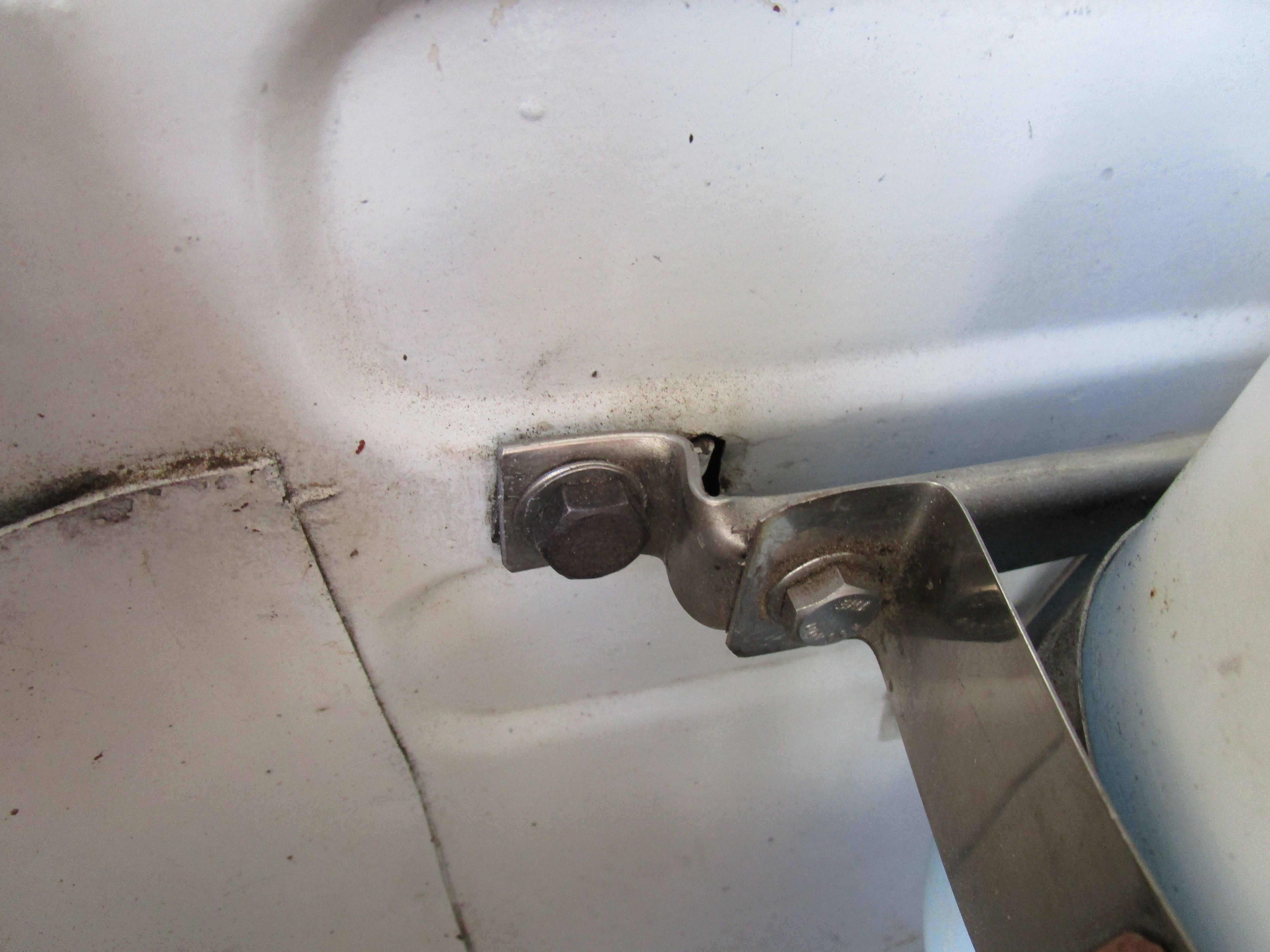

    Mounted using a couple rad mounting clips and bolts on a home made bracket . Bottle if from a Triumph Stag

    Nice Dave, how have you plumbed it in?
      One of my favourites, just looks like it belongs there, you can never tell it was an after thought. The coolant level marking are good as well Pat as it shows the height warm and cold

            Is the pipe on the neck of the bottle just to atmosphere, and the connection from the radiator overflow goes to the connection at the bottom of the bottle? Definitely a worth while mod - I know what Im going hunting for next
              MArtin
              Yes it is a non pressurised cap on top of the rad and the take off from the collar.

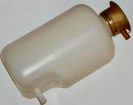

                i would like more details on the “plumbing” as the Stag bottles I’ve seen have a port on the neck and one at the bottom of the bottle like the one shown Click image for larger version  Name:	AF12AFD6-8B8D-4E26-B6ED-58C4B8346E2C.jpeg Views:	0 Size:	13.7 KB ID:	3784

                  Rad pipe goes to the bottom one , the one on the neck is just an overflow as can be seen in the second picture , correct the pressure cap is on the rad as normal , i used another pressure cap on the bottle but the centre valve in the middle of the main seal is jammed open

                      How does that work then, assuming the bottom of the expansion tank hose is connected to the overflow on the top radiator tank?
                      With the standard pressure cap on wouldn't the system have to get up to pressure where it was coming out the original overflow pipe (on outside of cap) on the radiator before it went into the expansion tank or maybe I've missed something?

                        Thats how it works , exactly as the Husky / van one did from the factory
                        Theres a small sprung valve in the caps centre , this opens as it cools and lets the coolant back into the rad

                          Call me thick but I'm still scratching head.
                          Is the cap on the radiator standard then?
                          I'd have thought not as the coolant would be stuck below the overflow until the pressure was high enough to blow the cap open so that it could escape.
                          Fit just any cap on the rad. with no stop then a pressure cap on the expansion tank should do it.
                          Have i got it or do I need to train my brain more?

                            Yep , totally standard radiator cap , 7lb short reach as normal , So it works like this - rad is full to the brim , engine heats up enough to move the cap so coolant goes into the expansion bottle , as the engine cools a small internal valve in the cap is sucked open letting coolant back into the rad . you can fit a blank cap on the rad and a pressure cap on the bottle , this works fine but means theres always an air gap in the top of the rad and of course the bottle is pressurised , either works well although sealing the rad with a blanking cap can be tricky as they only seal on the outer top edge which often isnt perfectly flat

                              I've got it now, so the tank is filled to the brim and it's the expansion when it heats up that moves it into the expansion tank not the pressure.
                              I wouldn't have thought it would be able to get back from the tank to the radiator with the cap. Didn't know about the internal valve in the cap.
