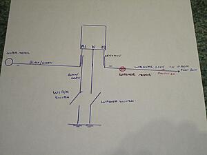

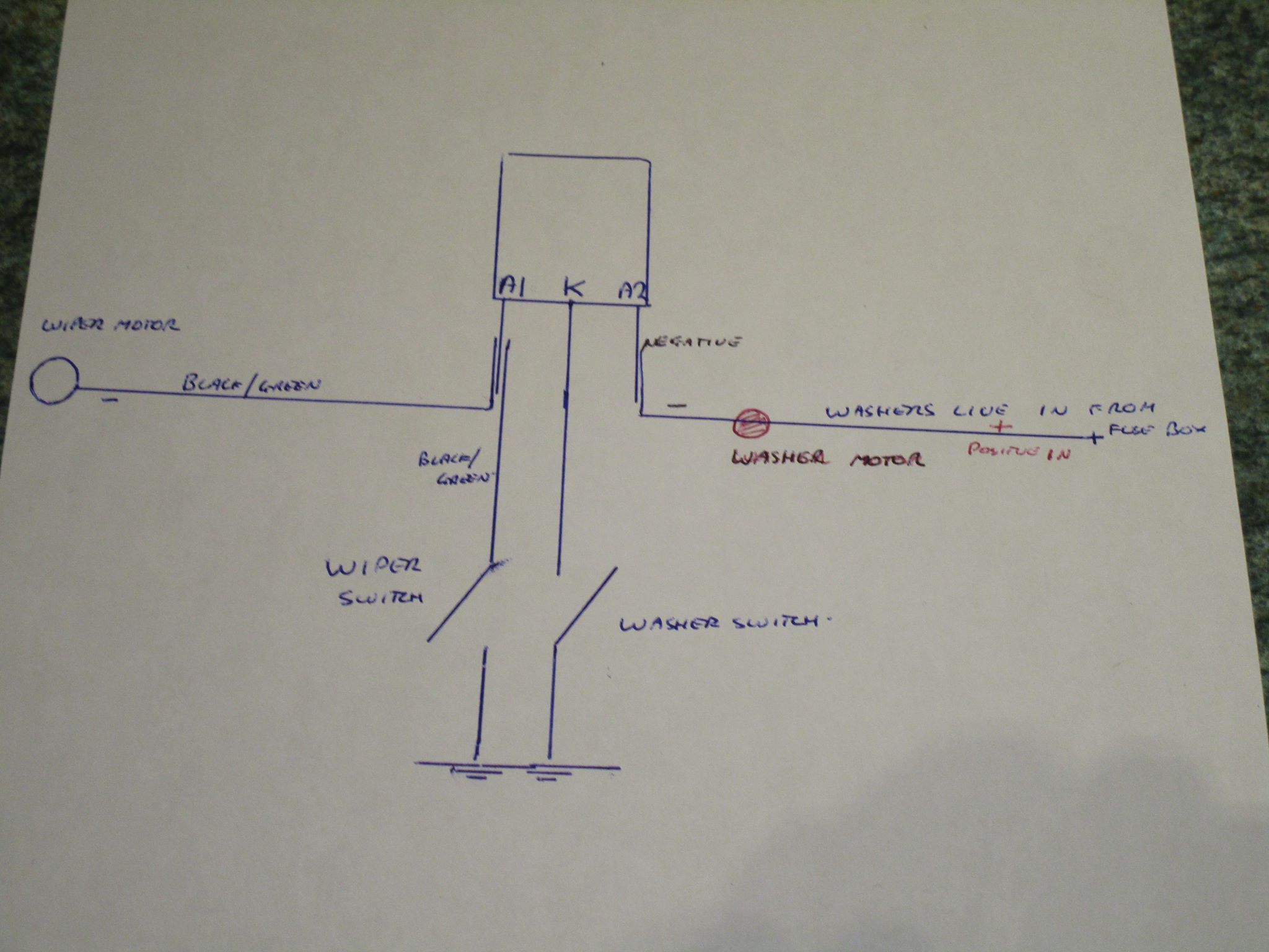

    One thing i like about moderns is when you operate the washers the wipers also work , Basically you press the washer switch and the wipers also work once , because the the washers are instant and theres a slight delay on the wipers the wipers never operate on a dry screen.
    This only works on the early DR3A motor as wiring wise as the live is on all the time the ignitions on and when your switching on the wipers you are in fact switching on the earth .
    Basically its a Schottky diode wired in costing a few quid . got mine from here
    https://uk.rs-online.com/web/cp/7815...08q-A-EuTQln70
    Part number is 781-5679P
    Youtube vid i did of it working
    https://www.youtube.com/watch?v=-RJ0...&index=52&t=0s
    Heres the diagram , looks complicated but its not .

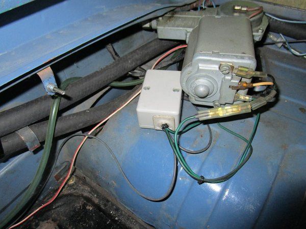

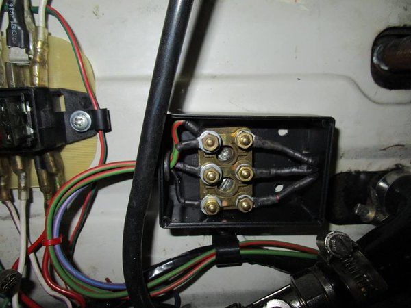

    I fitted mine in a small box like so
    Click image for larger version  Name:	42238208_10217581563070576_4461083685977849  856_n.jpg Views:	0 Size:	48.1 KB ID:	3835
    Click image for larger version  Name:	42236166_10217581563390584_3781379195553185  792_n.jpg Views:	0 Size:	54.5 KB ID:	3836

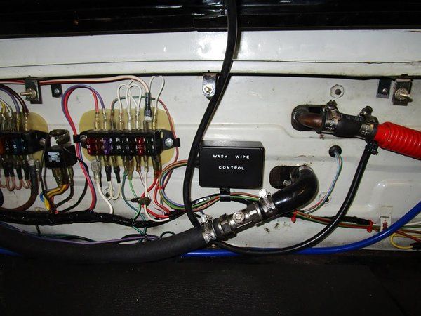

    On Barnaby the Vusky i put it here
    Click image for larger version  Name:	42229200_10217575958730471_4812718418052513  792_n.jpg Views:	0 Size:	52.5 KB ID:	3837

    That's very neat, good idea, sure John will be along soon to have it added to Boris.
    On Mildred I'd need some sort of pressure switch that detected when the little rubber squeezy button was pressed.
    Folk do laugh though when they see how the washer was operated on these old cars, part of the fun.
