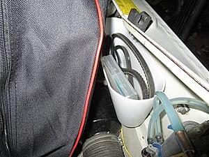

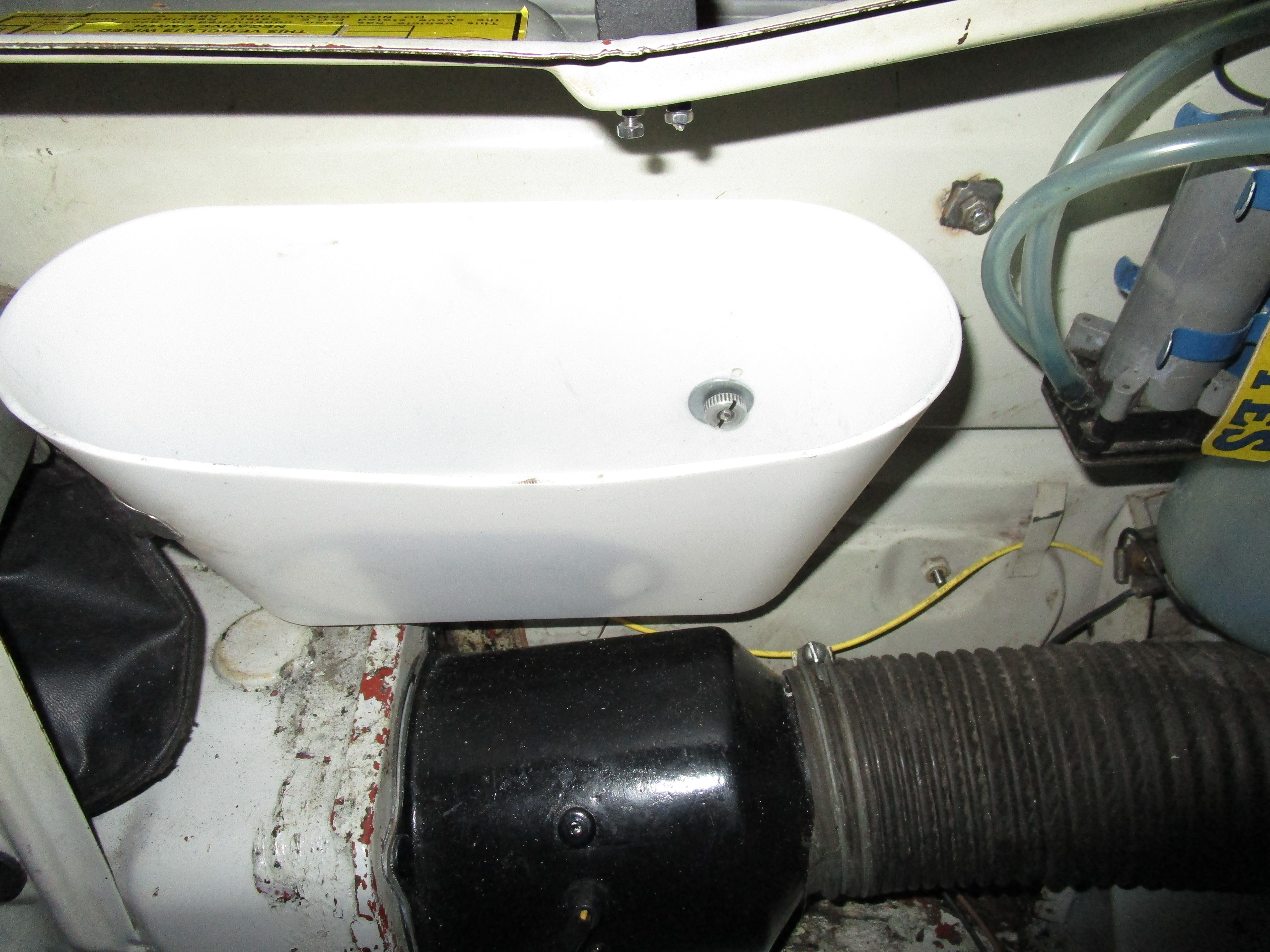

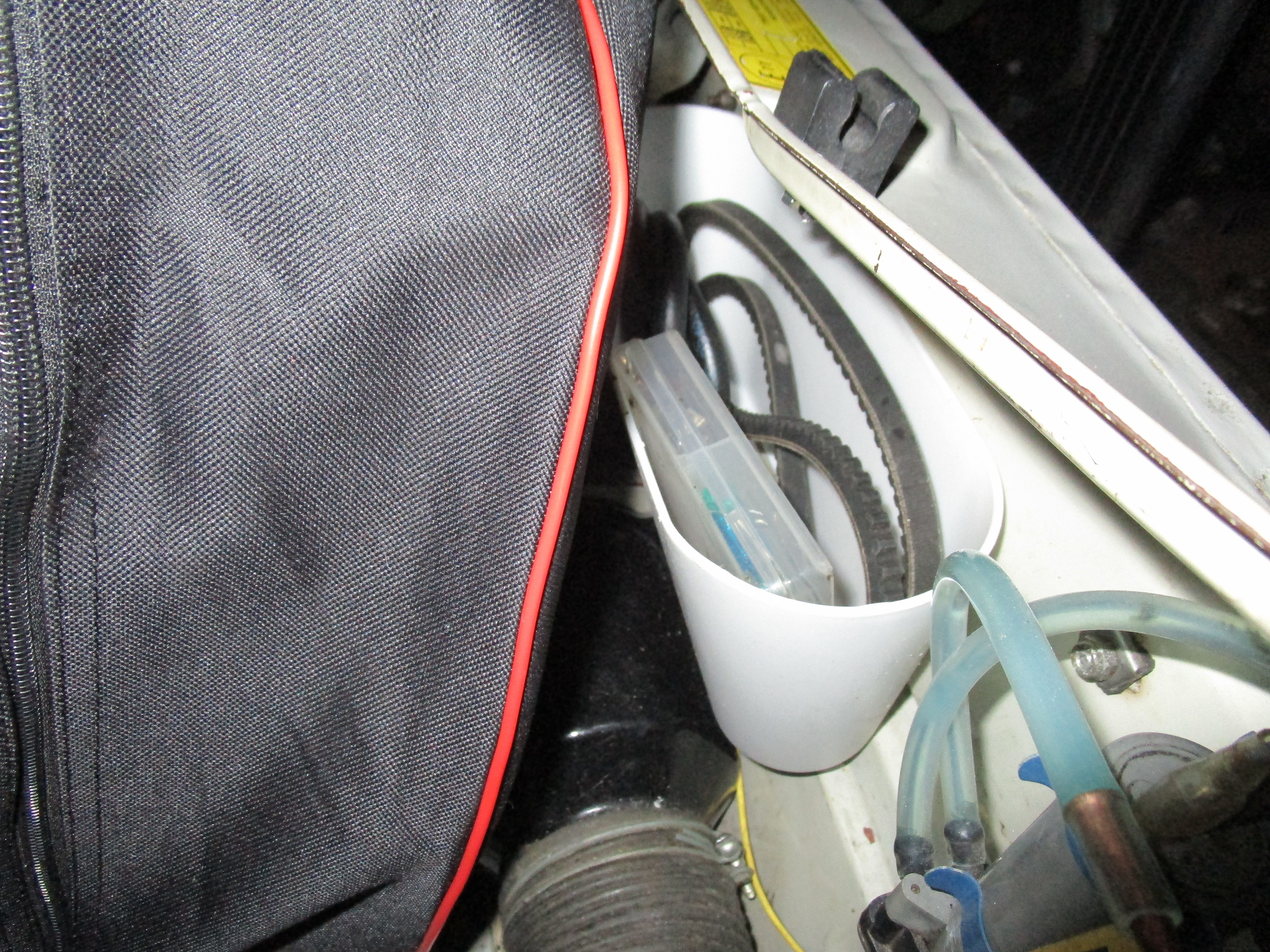

    Given these cars are small every available nook and cranny needs to be used .
    John Ross gave me the idea of a boot one so heres the first prototype attempt , no holes drilled , just used a stud off the dummy grill
ID:	4536Click image for larger version
    Spare wheel still fits fine , not sure if its staying as yet , il see what use it is and wether it gets in the way but anyway its an idea at least

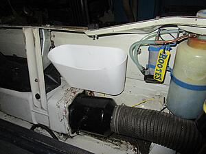

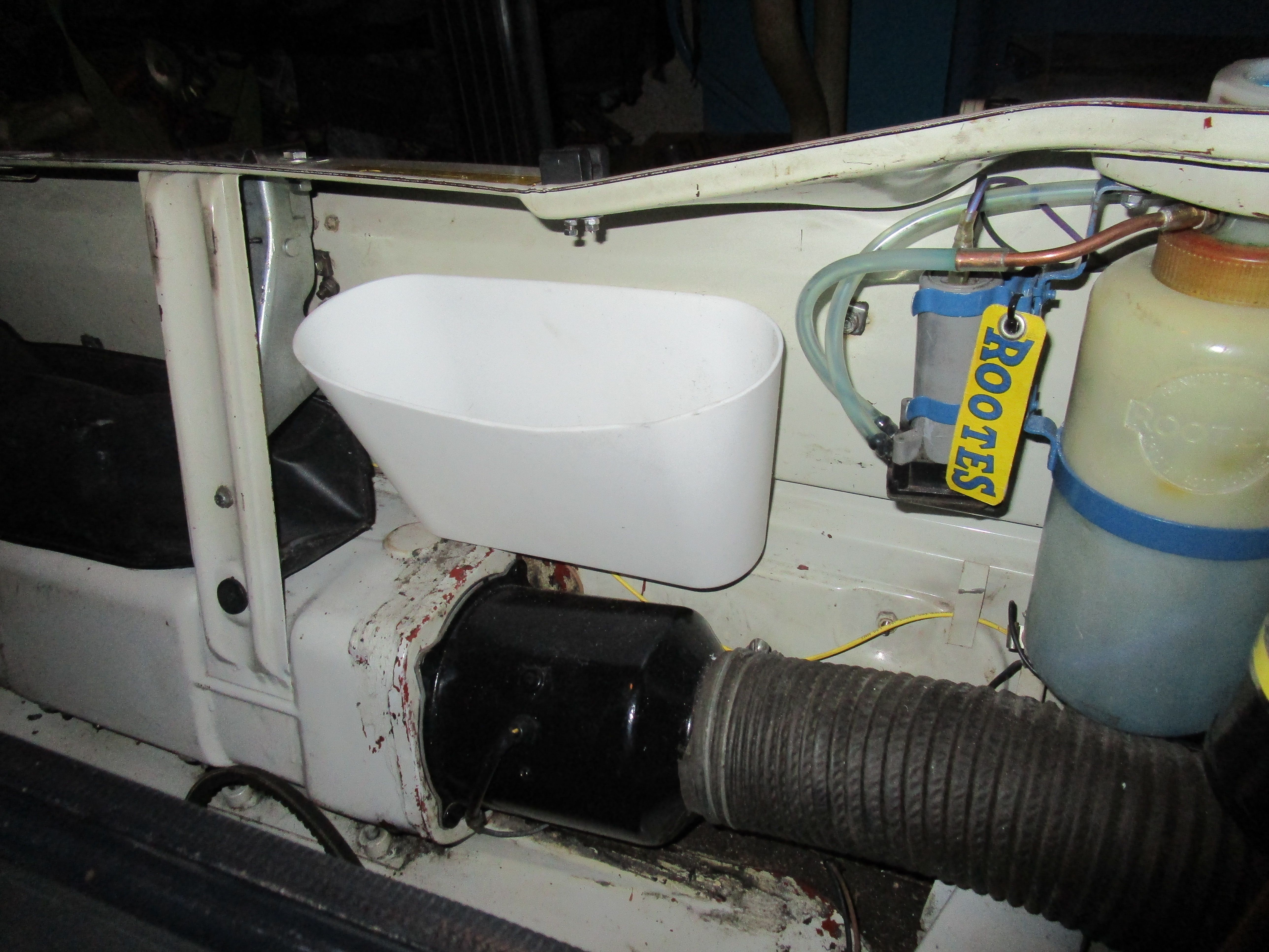

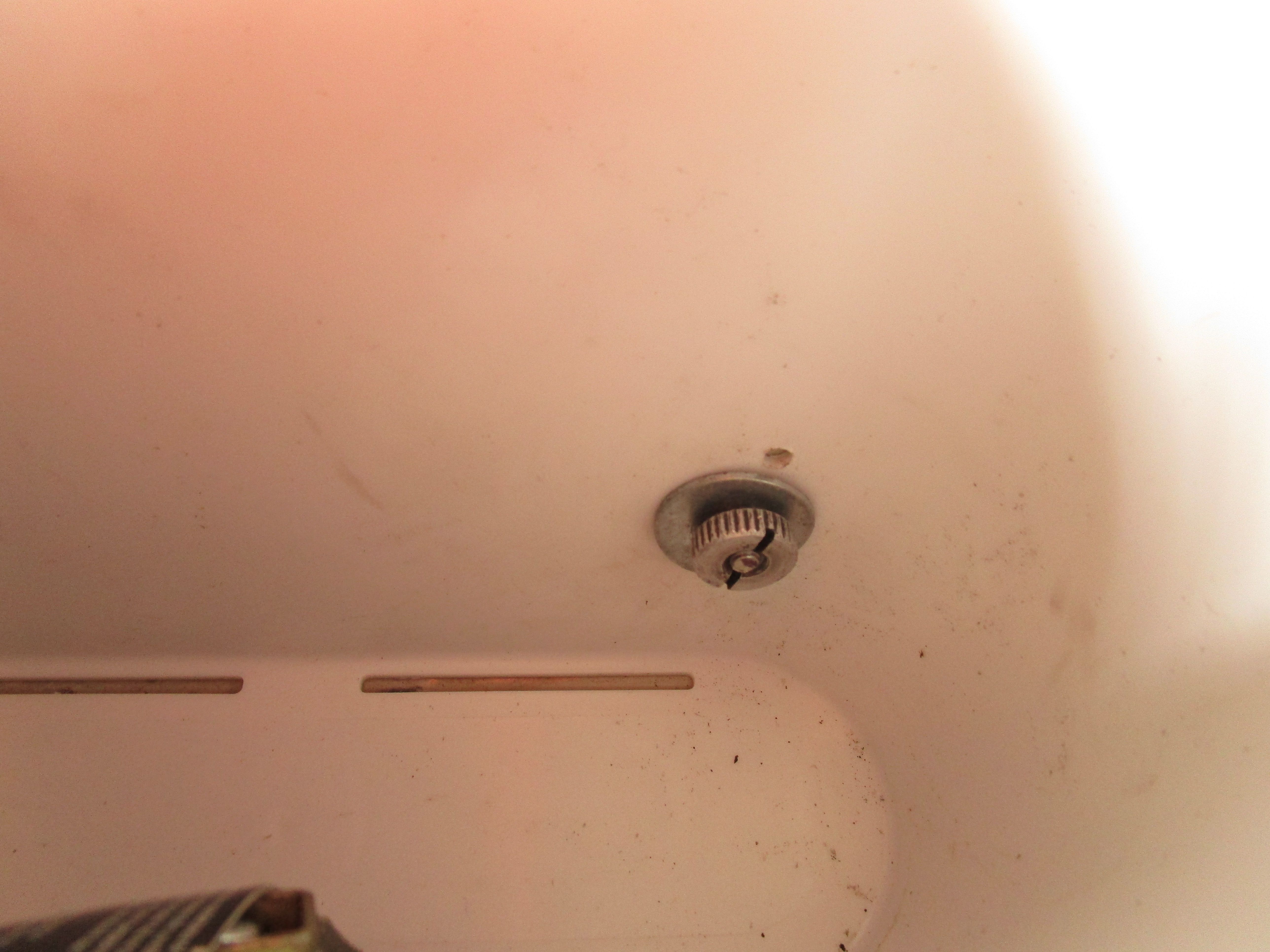

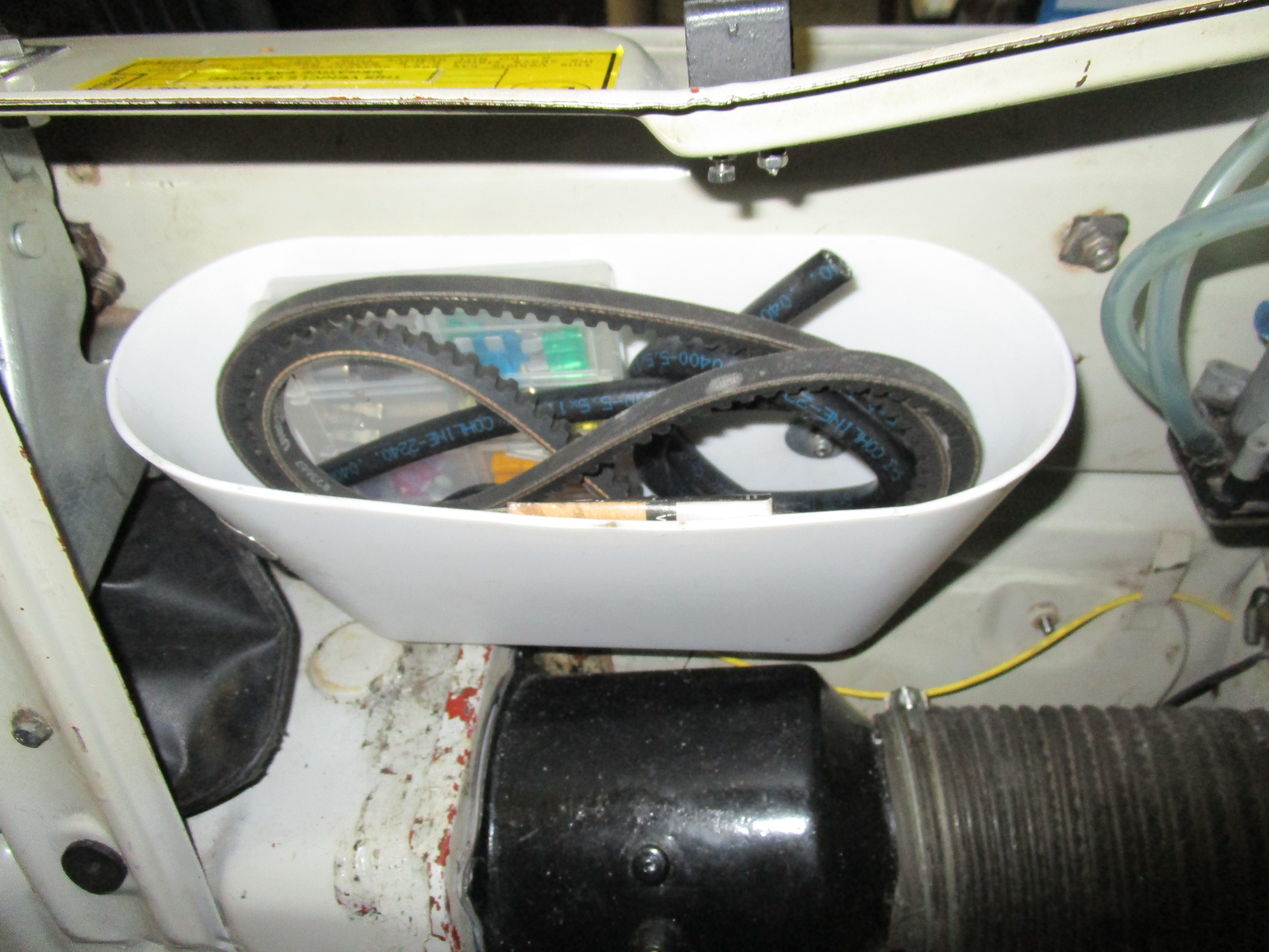

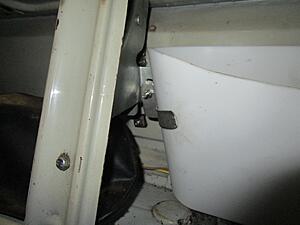

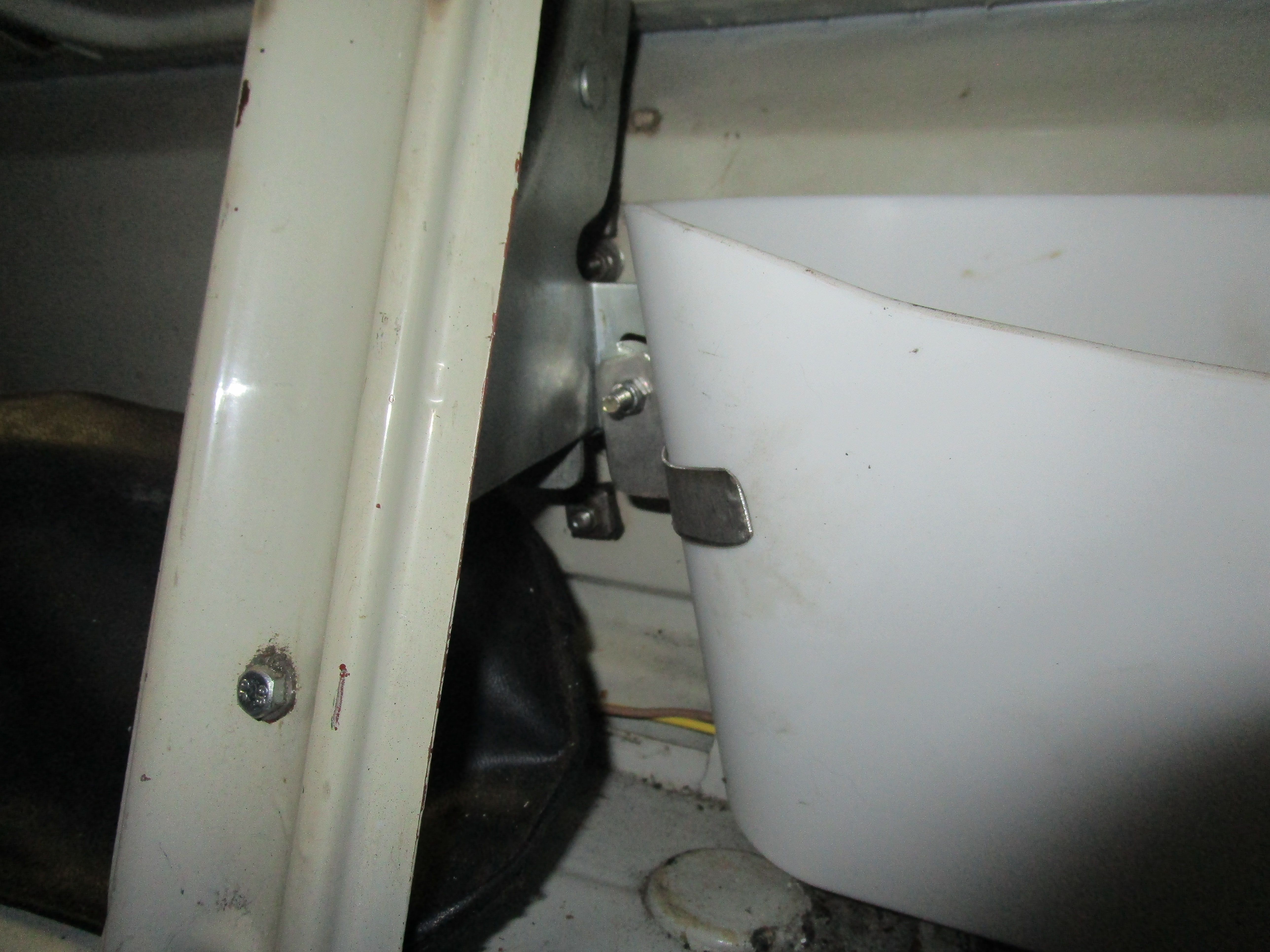

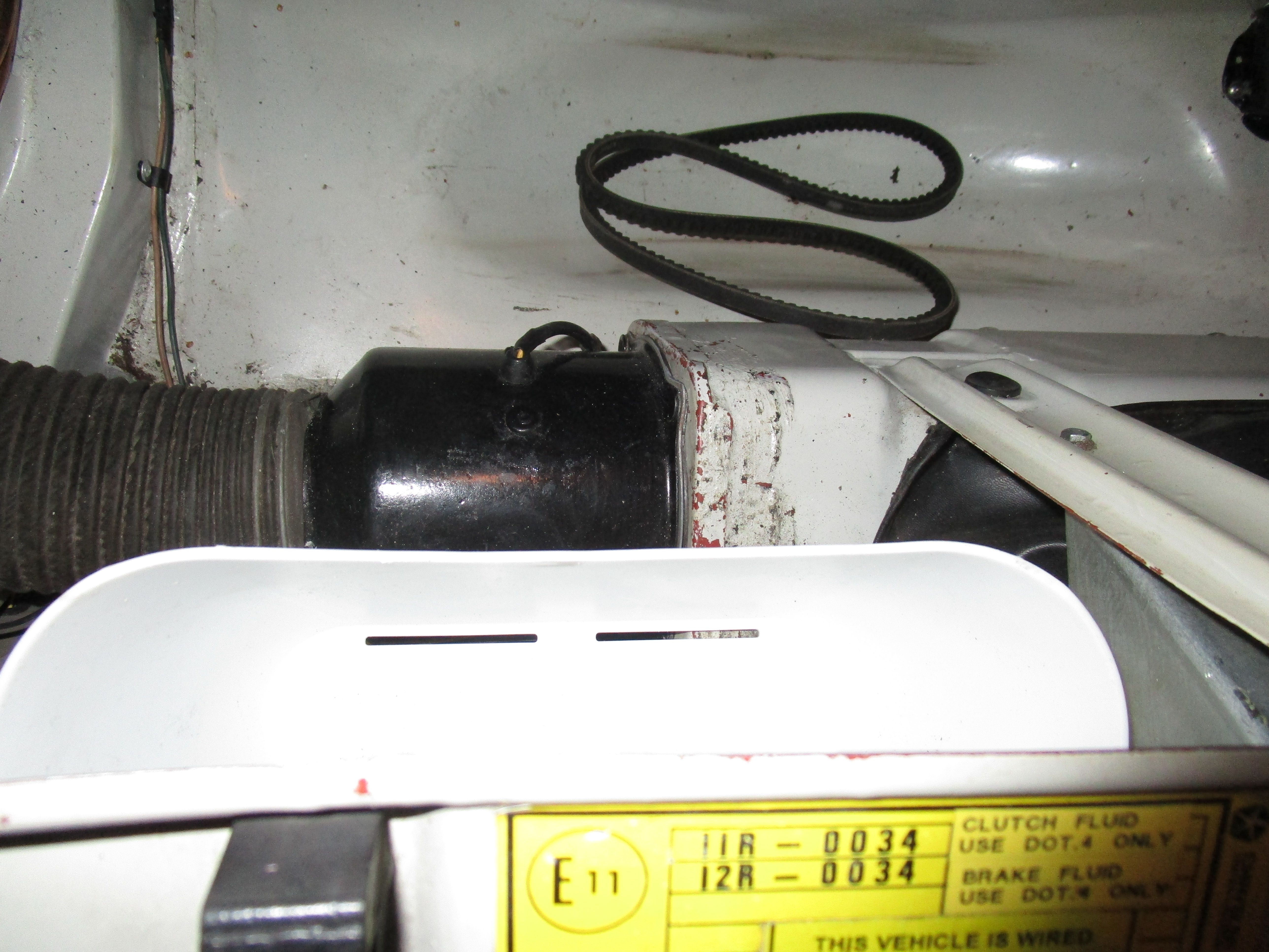

      Further to this storage box . i made up a sprung bracket for the other end which keeps this end in situ , its just held on the front lock mounting plate so no holes drilled , I also rethreaded an old dizzy vernier nut to the thread on the grill so now the box is quick release and comes out in seconds . base is sat on the heater box and the front panel edge
      Click image for larger version  Name:	IMG_2134.JPG Views:	0 Size:	1.80 MB ID:	4570Click image for larger version  Name:	IMG_2140.JPG Views:	0 Size:	1.90 MB ID:	4571
      Click image for larger version  Name:	IMG_2138.JPG Views:	0 Size:	1.88 MB ID:	4572Click image for larger version  Name:	IMG_2141.JPG Views:	0 Size:	1.75 MB ID:	4573
